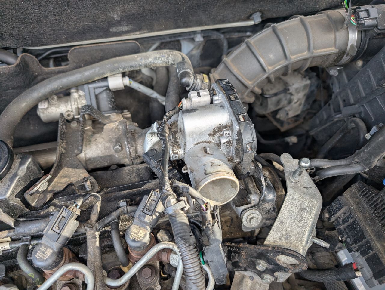

I fancied doing some pottering. Mostly because some post arrived. I was watching some generic k9k videos the other day and this part blowing apart/splitting is a common occurance

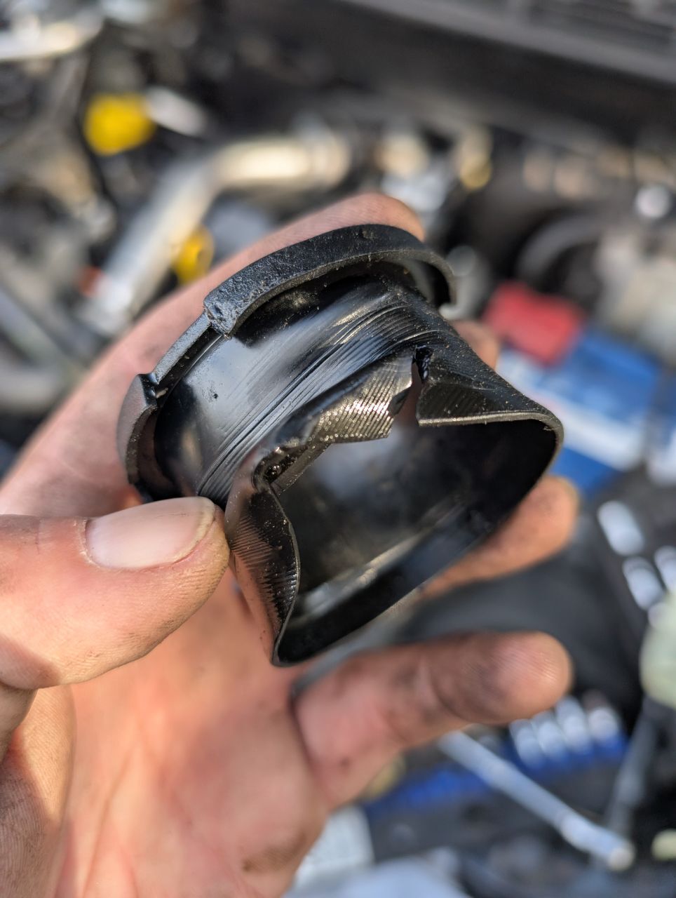

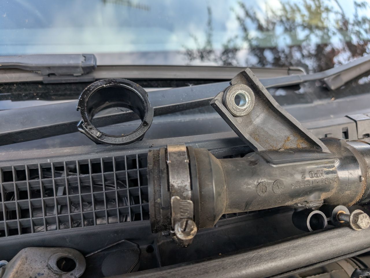

It has always been misting out oil, so I took it off
The inner rubber seal was all folded back on itself, that won't be helping. But we're going further quickly. Covers off!

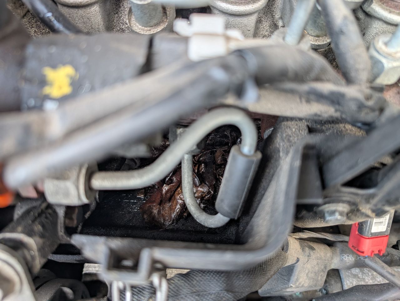

I dropped a shit load of oil down here and from the looks of it wasn't the first person to do so
What I also wanted to do was remove the big pile of dead leaves gathered in the lower engine plastics. These were bone dry when I did the cambelt but luckily* alot of the oil spillage must run down here as they were covered in oil
Got my cordless shitter vac out
And sucked it all up, I cut down a little bit of hosepipe and sucked the oil out of the holes too
That done, I put the covers back on and cleaned this all up a bit

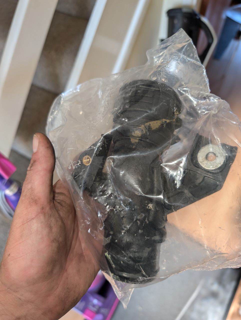

Got my new shiny £8 part
Aaaaaand it's wrong 😡
I took a closer look at the rubber seal, which wasn't very rubbery anymore
So I pretended it was a rubber hoover part, the bellows say from a 1950/60's vacuum and dunked it in boiling water and washing up liquid
I'm now drinking the cup of tea next to it whilst it heats up and hopefully goes more round.
  • beko1987 changed the title to 2009 CashCow - Ignorable oil leak* fixed?

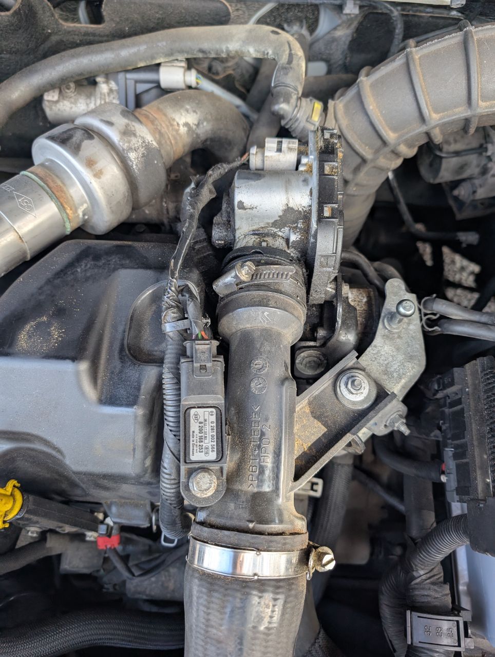

It went back into shape well enough
Once I looked at it clean it was clear it clips over the end of the plastic pipe which I did, making sure internally wasn't bent
And fitted it nicely on. Everything clamped and bolted down and I wasn't noticing an air leak before, will see if I notice there isn't one when I next drive it!

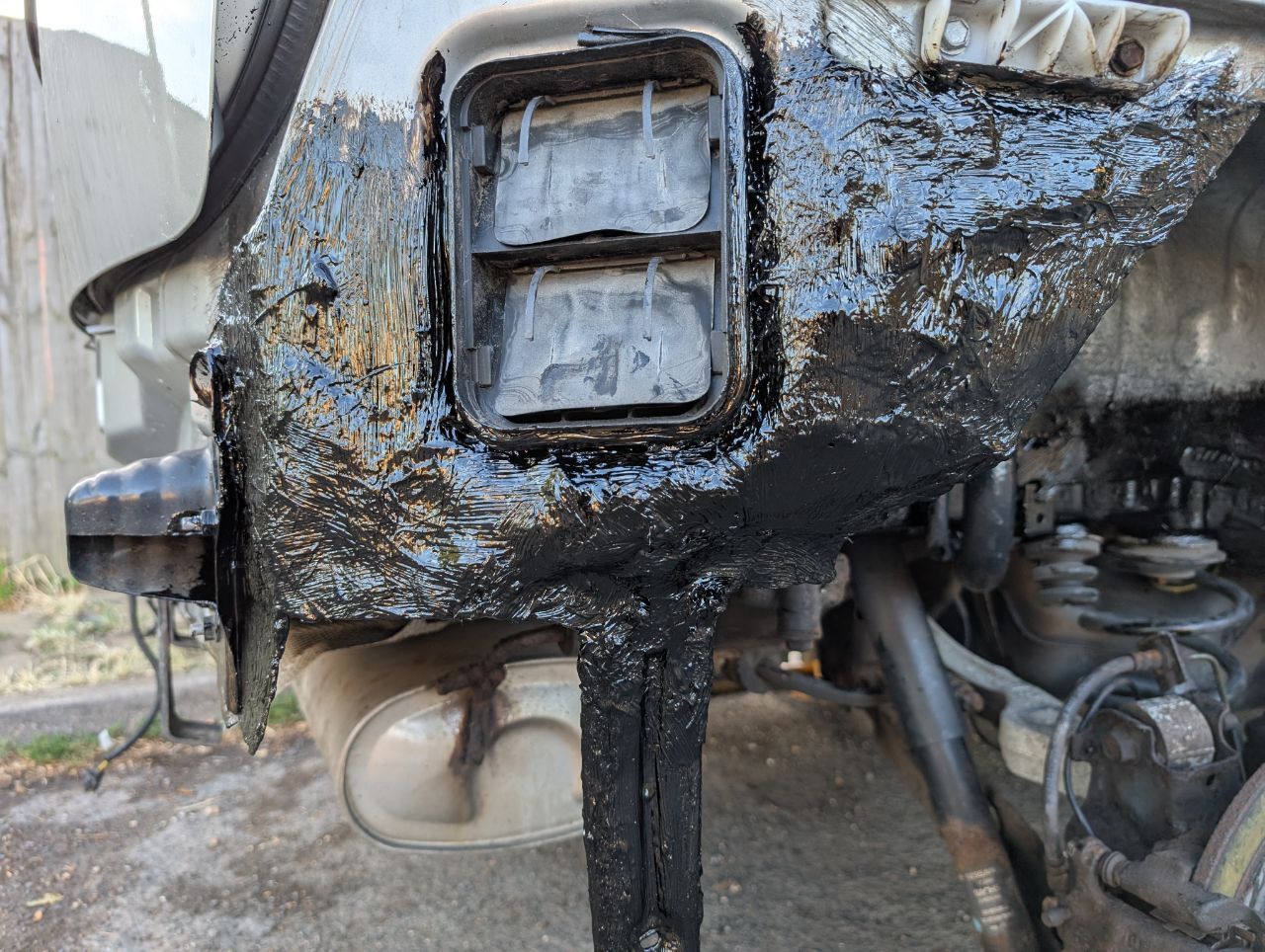

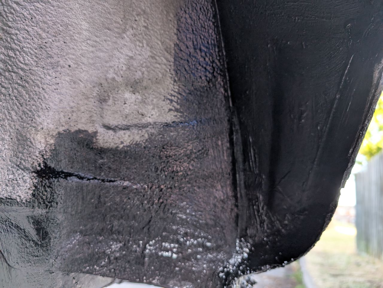

So, I spent 20 minutes taking ALL the rear plastics and bumper off, and got the pressure washer out!
The short lance made quick work of blasting all the remaining mud and shite out, I got all the back subframe and the fuel tank too. Came up nicely
I'm going to have my dinner then in about half an hour it should be dry to start painting the hammerite on 👌 I'm planning to do an coat over both back wheel wells entirely, then build up a few layers at the back.
  • beko1987 changed the title to 2009 CashCow - Hiding all the (known) sins
It's like painting with clay 😂 I've used a quarter of the tin and done a big thick coat over everywhere I want to go. I was spooning it over where I did the Fibreglass and it filled all the little voids really nicely! Done the entire back corners of the body underneath, and did the big rail on the body and some other part. Hoping I can do another coat tomorrow morning when this has dried a bit
I bought 50 brushes for £8 posted. Used 3 so far
Woke up this morning and got back to it! Put Charlie in some disposable clothes and he did the passenger arch and I did the drivers side
The thick coat yesterday had gone nice and solid, so we did one nice coat over everything, 2nd layer over what we did yesterday too
Hopefully it'll stop the noise of all the little stones flinging out of the tyres and clattering around the wheel well too 🤞

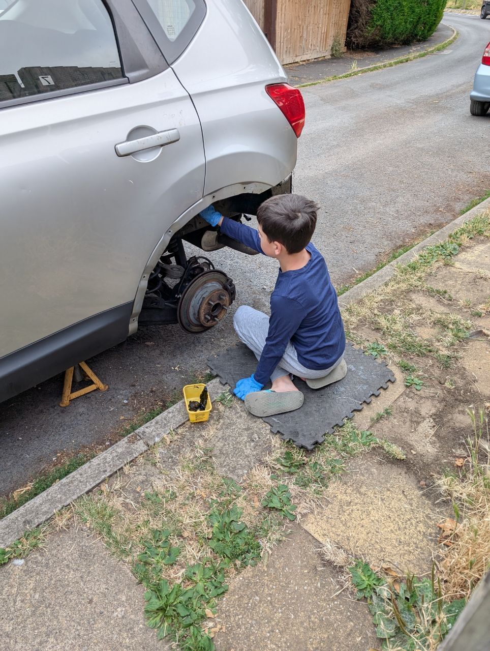

Needed both back wheels off in turn to adjust it more! First test run the passenger side locked on and skidded the wheel but was still mega uneven so backed that side off a turn, put a turn on the driver's side and now it locks both wheels up pretty evenly and will drag the back end down the road (at low speed) at click 3 😉 Car is immobile on click 4
Obligatory high speed run check to make sure the shoes aren't dragging on the disc inside is still needed but it feels fine for now!

What specific Hammerite product is it? Assuming the ‘underbody seal’ in a tin?  Nice finish - I’ve used the aerosol on previous cars but it doesn’t really give a thick covering like this, which would stave off stones etc.
Seeing Charlie painting that car remaindered me of my dad sending me under Cortinas in the sixties armed with mastic paint to try and stop them rotting.
https://ebay.us/m/EhRa9g
This exact listing. I've used half the tin but did all up under the back chassis rails and very VERY thickly 😂
I've been out twice too as eva wanted to go to the next village to play with her mates and it's cut down a shit ton of droning I didn't really notice anyway as a nice side effect! If it passes the mot I'm going to do the rest of the body just for that! Having all the rear plastics properly fixed in has stopped some rattles as well! Got no reason to have the front undertray off atm but it would benefit too as I used a mish mash of the half broken original fixings to do it back in the spring. I'll probably have a weekend doing this to the front subframe at some point and do the entire front end of the car
https://ebay.us/m/lPCaLv
These are the brushes too. Again surprisingly OK. I scrubbed them out going around stuff before they truly died. No idea if any bristles came out as if they did it's added strength 🤷
Got 43 left...

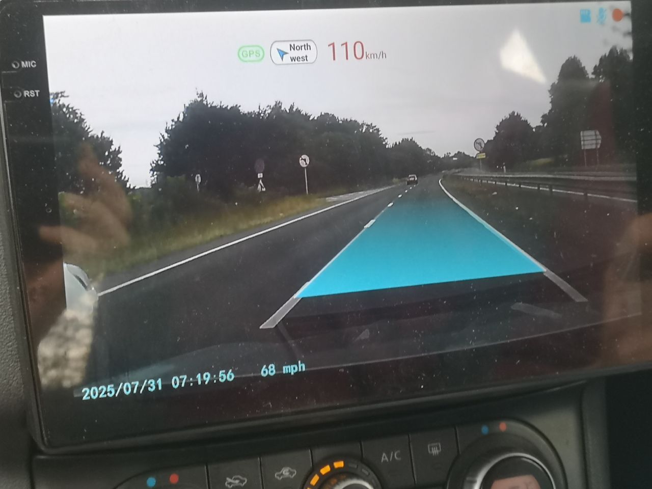

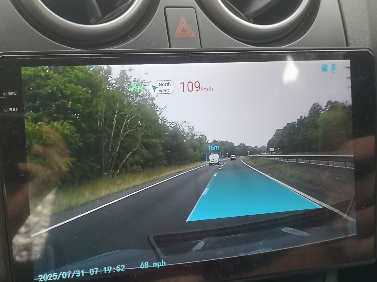

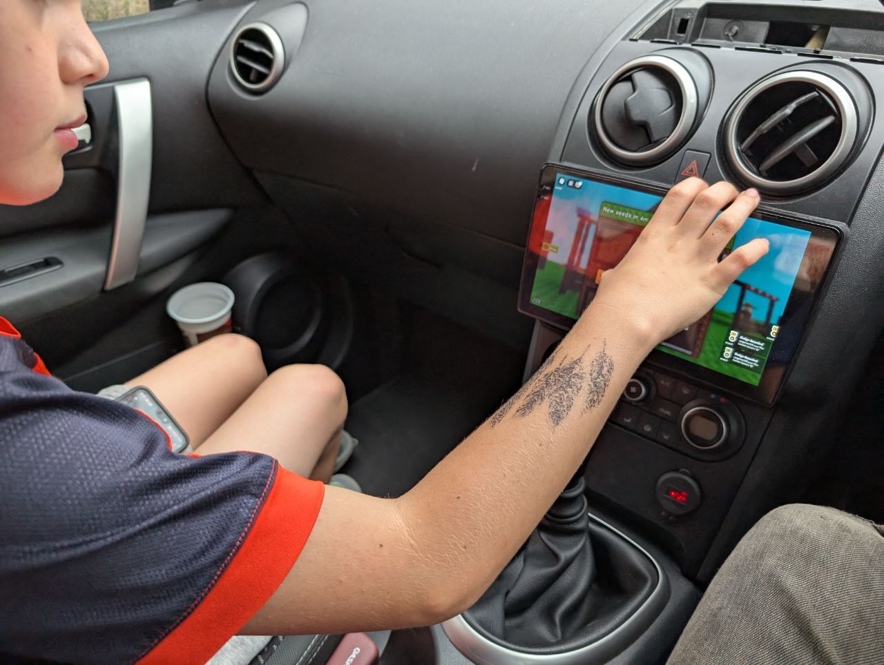

Off to the tip in the morning bright and early so packed the car up. Was sat playing with the headunit afterwards and the front camera software had an update!
And now there's lots more options!
I've now got lane guidance, speed limit sign reading, accident avoidance (I guess alerting) systems...all the things I hate about dad's car, but the Chinese version 😂 (that won't brake the car fucking sharply because it thinks it's a 30 when it's a 50 on the road we're physically on)
I got Charlie to run into the front of the car a few times and it did nothing, I guess it needs the GPS to be showing speed so we'll play with it on the way to the tip tomorrow, see if it does anything!
Another handy thing, possibly the most is it's switched/given the option to have the speed in mph not kmh
Im more amazed the built in app got an update and successfully installed it tbh

4 hours ago, wuvvum said:
What are the other options for the overspeed alarm note apart from Dangdang?
Nothing, their just tick boxes. About to head out though so I'll see if it does anything
Its either DangDang or DangNothing I think
IMG_20250803_080824.jpg.d78f3bcd834dad6de109f0e4fc5373ca.jpgIMG_20250803_080828.jpg.b35eb18cdeb3328595ea670cdbe3c576.jpg
It worked/does some new stuff! It took half a mile for it to calibrate itself, but when it did the lane things as above started showing, and other cars! It speaks as well (which I want to turn off). Doesnt seem to read the speed signs or give any indication of the multiple times I was speeding, but it's fun to see! Charlie took some photos and a short video, which is at the start of there, before the entire trip to the tip! I've not actually really looked at the footage from it yet, it's not great but on par with the £30ish the dashcam cost (probably sub £10 on ali express)
