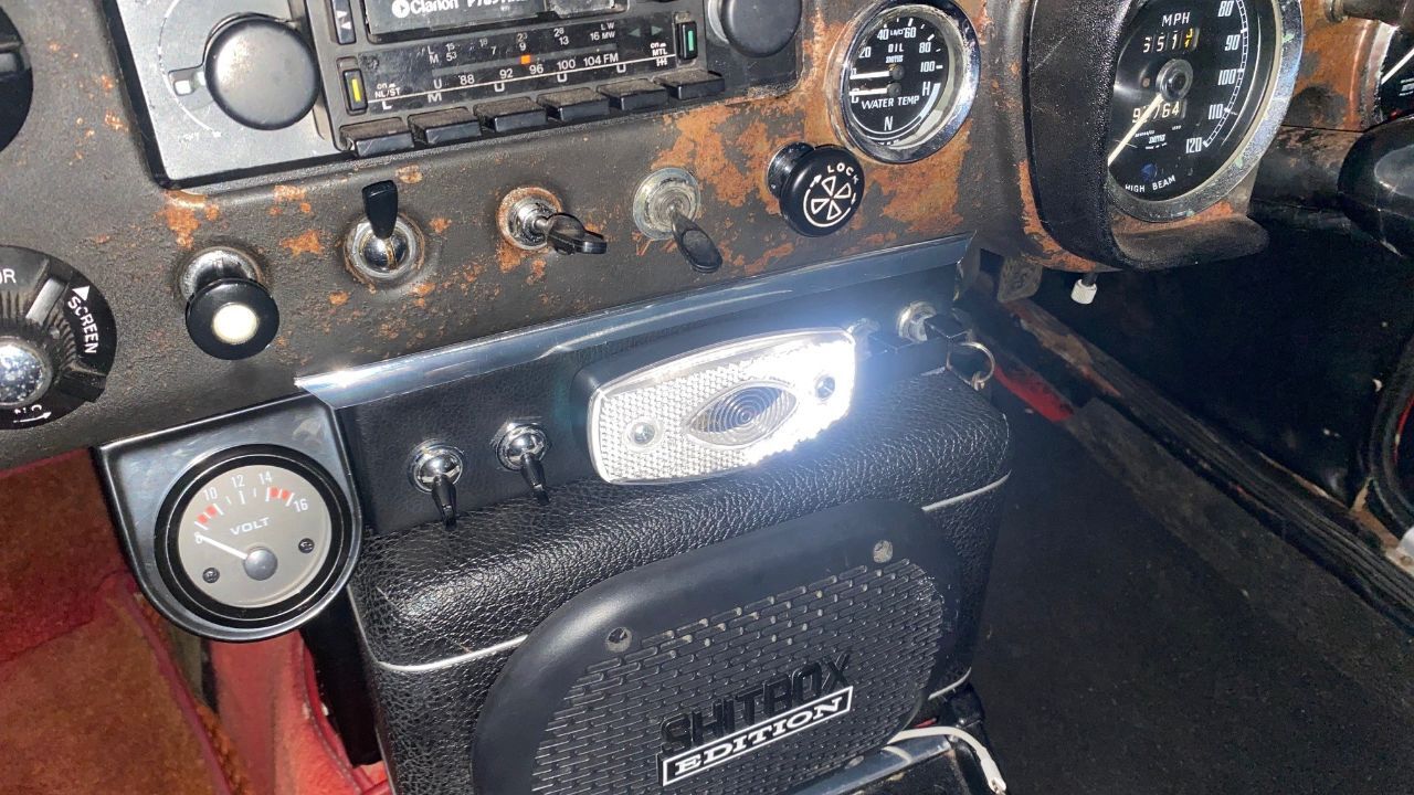

The strip in the centre of the console was an afterthought but it was necessary because some of the contact adhesive that I used to stick the vinyl to the metal has failed and the gap between the console and the underside of the dashboard became uneven. I've sort of made it better, see below. Regarding the gearstick knob, see below.

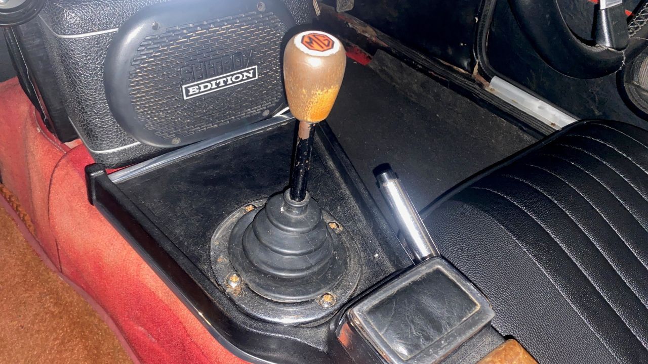

I must accept that the silver gearstick knob looked awful, it didn't suit the rest of the interior. It's gone and I have re-fitted the original, which at least has great patina.
I have cut the silver strip above the console at angles along both ends, to make it look less like an afterthought. Still far from perfect, I know.
The inspiration for these mods came from bling that forms part of the MGB's original features.
There is a silver strip that extends across the width of the glovebox lid. It serves no purpose, other than to look pretty.
Ditto, the map storage unit is neatly finished with a silver strip.
I have not put the plastic chrome away and won't be adding anymore decorative features.

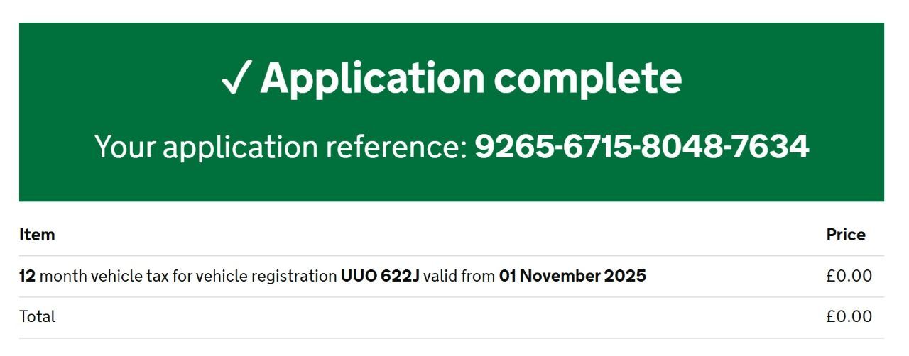

There’s something so delightful about taxing a 7.0 V8 for free😄
Hopefully that vile incompetent bint chancellor won’t fuck it up soon though.
Just remember you have to keep on taxing it every year for that 0p, otherwise it becomes untaxed!

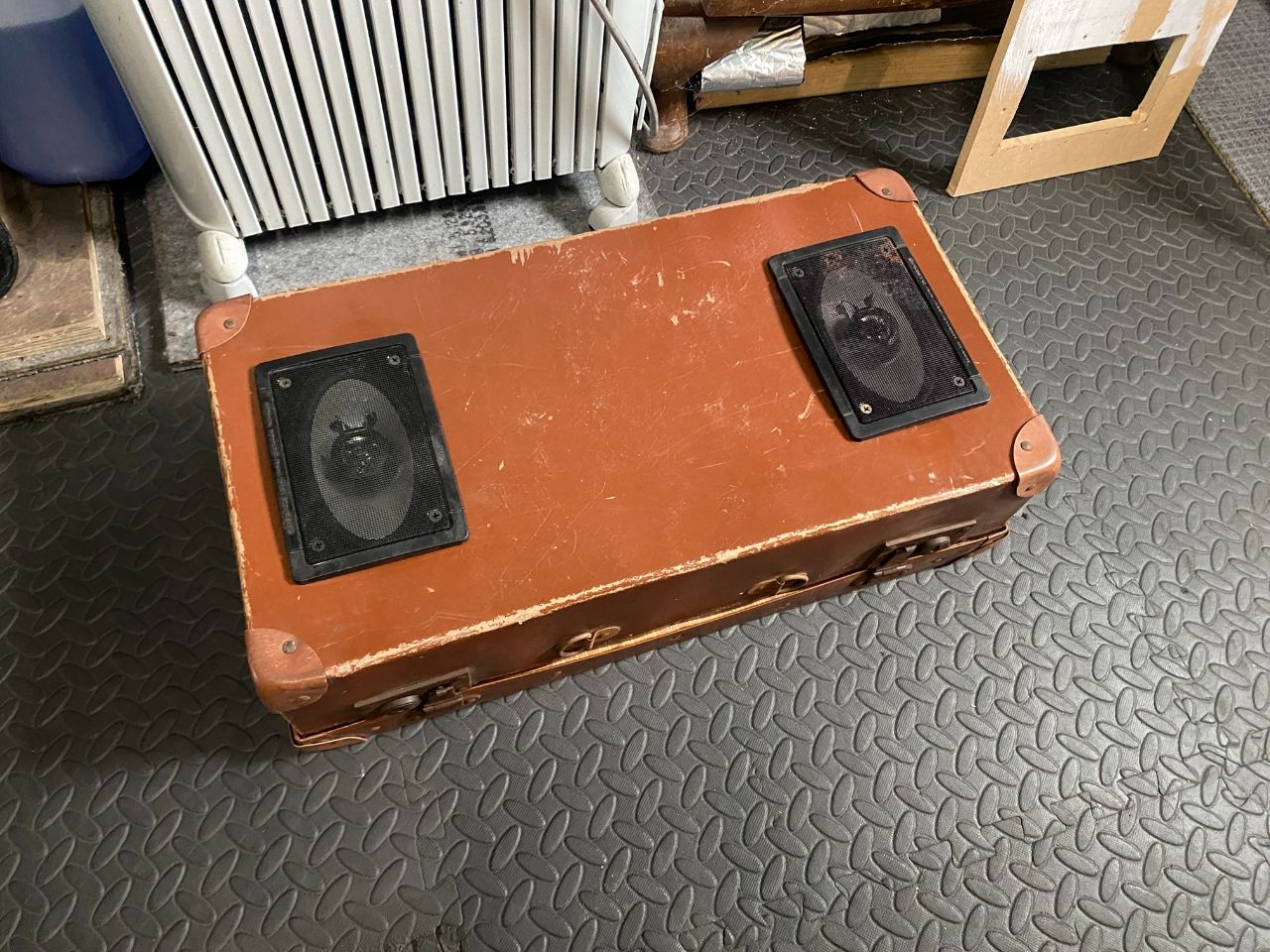

I had an old suitcase.
And a pair of 4x6 Alpine speakers, which I removed from a previous project car.
Trouble was, the Alpine speakers didn't come with any grilles. A bit more research on Google revealed that a pair of grilles for these speakers cost upwards of £20 and they look awful. I don't think they would suit the MGB.
Luckily, I had a pair of old house speakers, which sounded shit but did have nice old fashioned grilles.

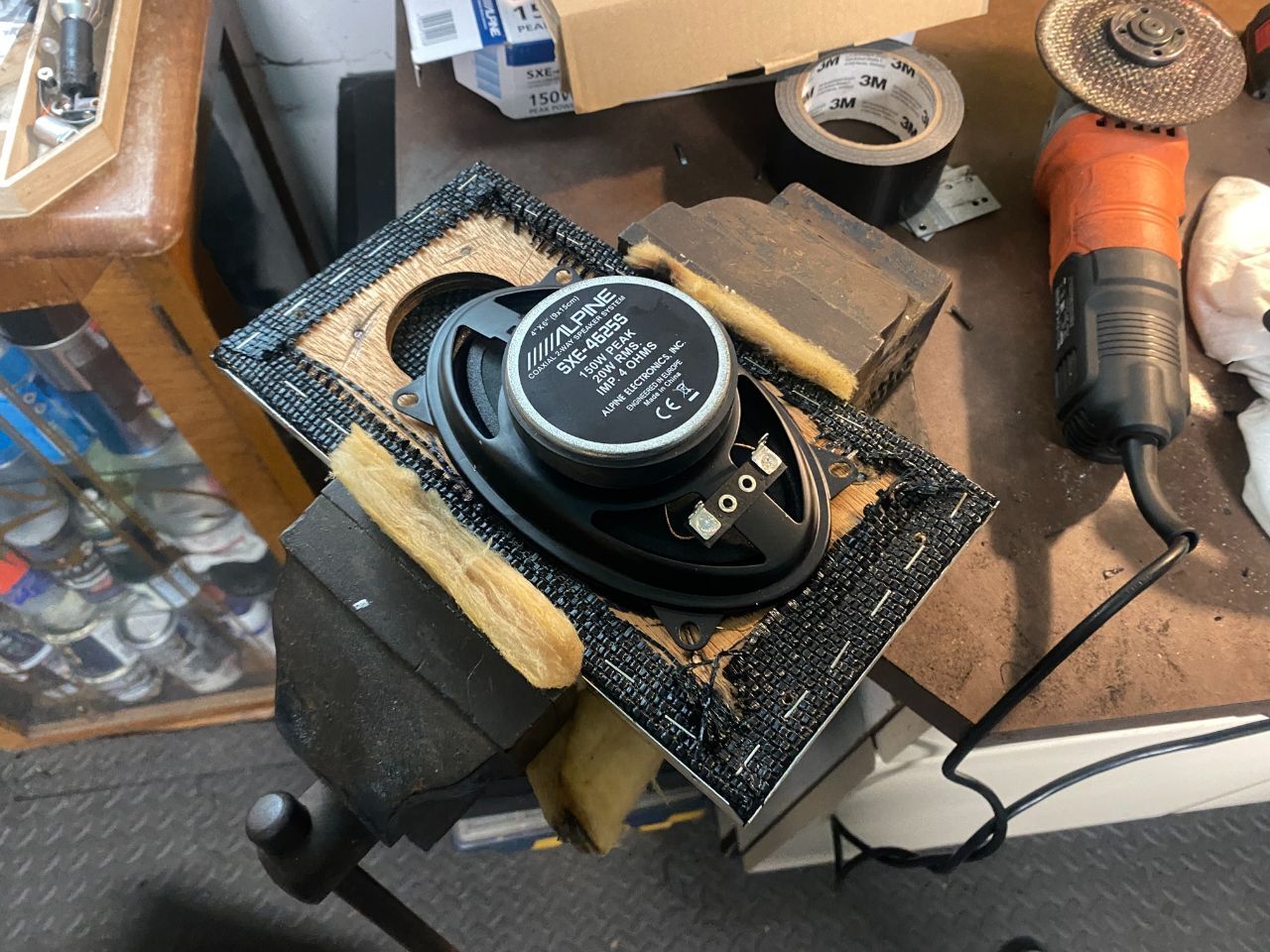

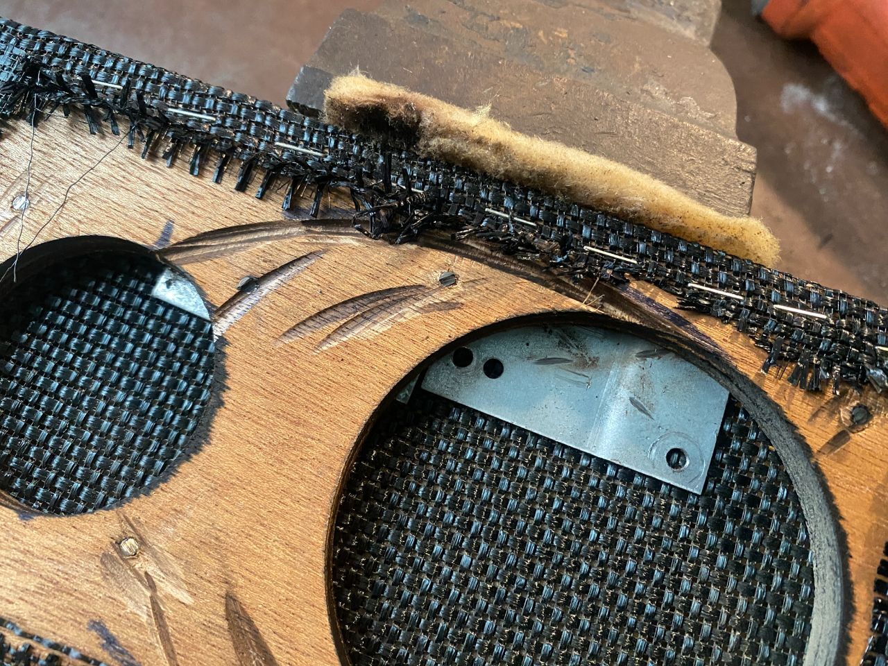

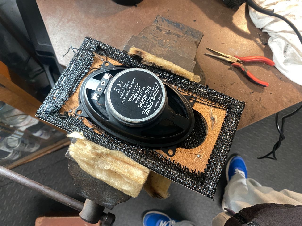

I carefully took the old speakers apart.
The eight fixings per speaker have been fitted in such a way that they cannot be removed without removing the fabric, which I didn't want to touch, knowing full well that once it comes off, it will never go back on properly.
So out came the grinder and hey presto, I had a smooth surface to fix the new speaker to.
I needed to cut the central piece of plywood to accommodate the 4x6 speaker.
I put metal plates between the fabric and the plywood (to protect the fabric) and got the grinder out again.
The speaker would now fit.
A bit of gaffer tape tidied up the underside of the grilles.
Originally I wanted to have the speakers mounted in the bottom of the suitcase, so they wouldn't be as visible and would be playing towards the front of the car. Unfortunately, the suitcase wasn't big enough, so I cut a couple of holes in the lid.
First impressions were good, however as the lid was saggy, there were large gaps between the grilles and the top of the lid.
So I made up an MDF panel, which adds a bit of strength to the lid.
That worked out ok.
And looks more interesting than a pair of modern speaker boxes.
If I find a slightly bigger suitcase, preferably in black, I would buy some decent 6x9 speakers and upgrade the installation.

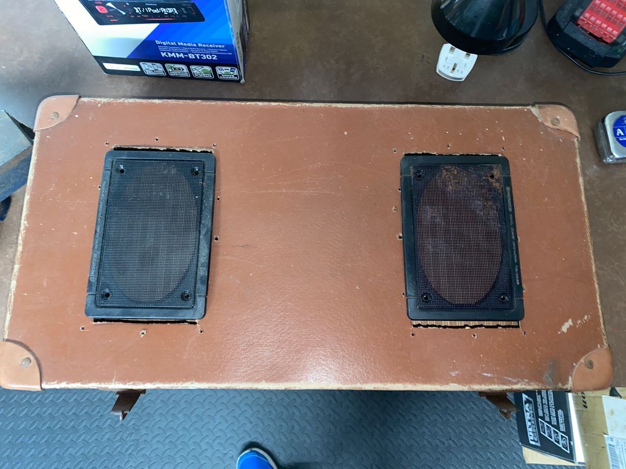

Firstly, a step back to the rear speaker installation. When I fitted the house speaker grilles over the 4x6 speakers, I was convinced that I was doing the right thing. Now I'm not so sure. The grilles are too big.
I went through my stash of old ICE stuff and found a pair of old Pioneer 4x6 speaker grilles.
Which fit the Alpine speakers perfectly.
I removed the big grilles from the suitcase.
Unfortunately, the speaker grilles do not cover up the holes that I made previously.
I now have two options.
Either, I can tape up these holes (I kept the bits of panel that I cut out) and fit the speakers and grilles to the underside of the suitcase, like this.
I'm not fussed about the suitcase being installed upside down, it's not as if I have much that I would want to store in it.
Or I can find a replacement suitcase. I've checked the measurements, the biggest that would fit measures 600mm x 350mm.

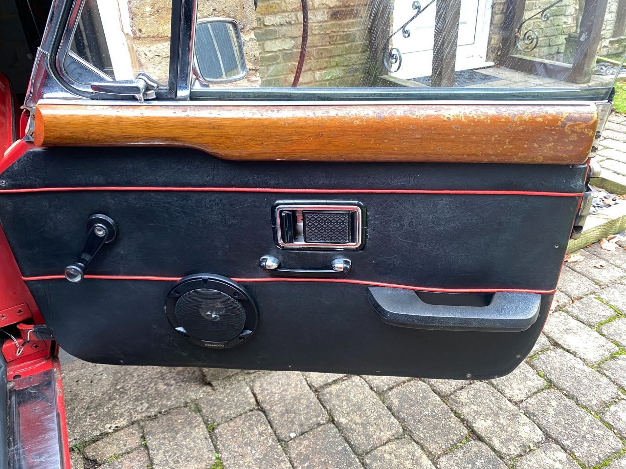

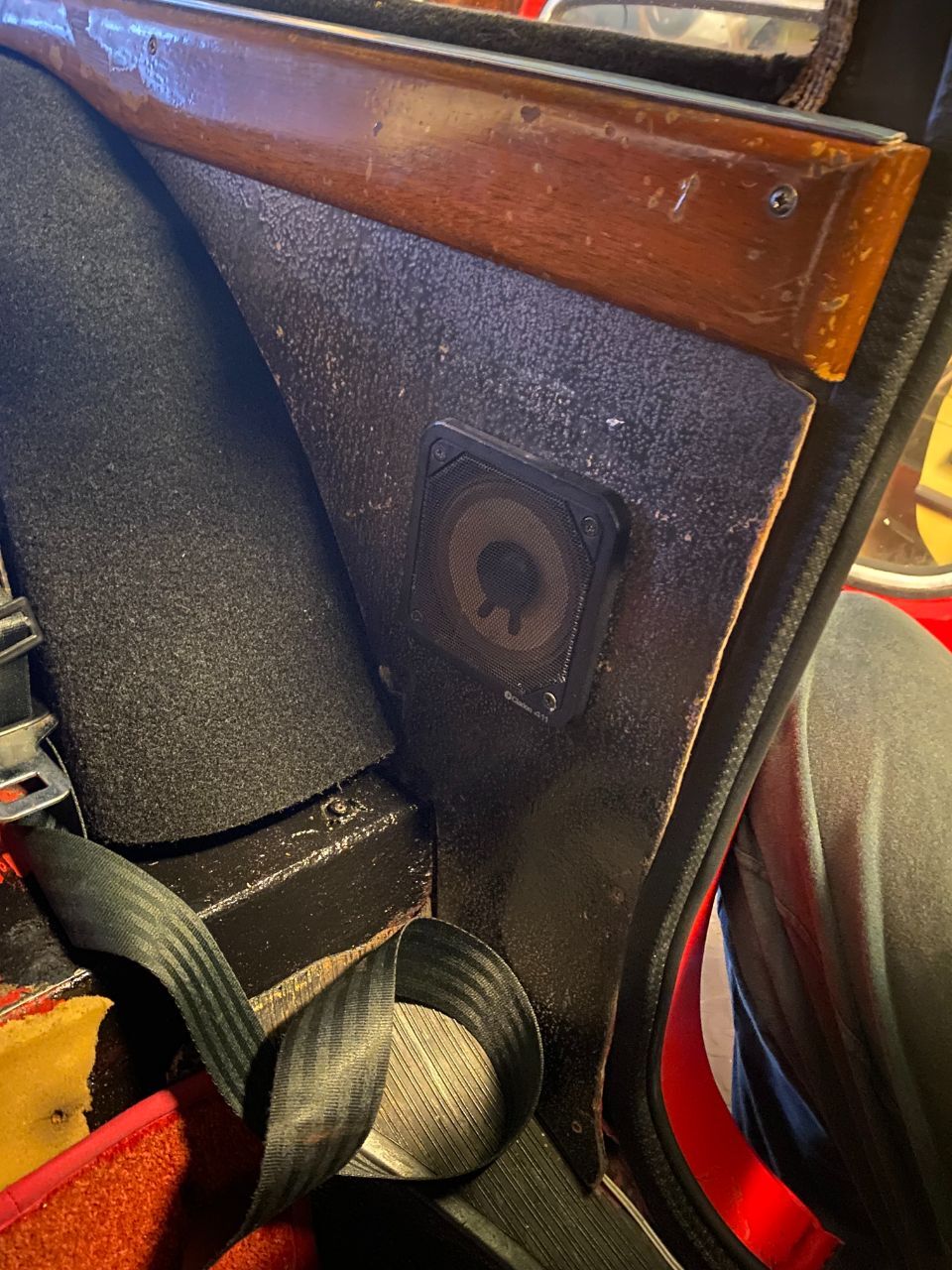

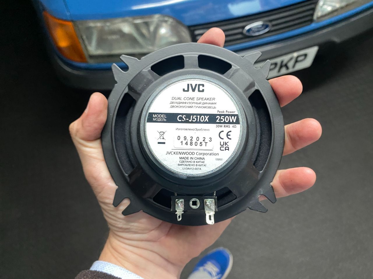

The old Clarion speakers fitted within the front door panels were knackered.
I have a pair of almost new 4 inch JVC speakers that would be more up to the job.
These were fitted in the front doors of the Sierra, before I upgraded them with these JBLs.
The JVC speakers fit a treat in the original holes.
Unfortunately, the JVC speakers came without grilles.
I couldn't re-use the Clarion speaker grilles as they don't fit over the JVC frames and screw tabs.
For the same reason I couldn't make use of these old Pioneer grilles.
And ditto these Vibe grilles, which I was happy to spray black, had they fitted.
Fortunately, these Kenwood grilles fitted just fine.
The speakers and grilles took two minutes to fit.
Job done.

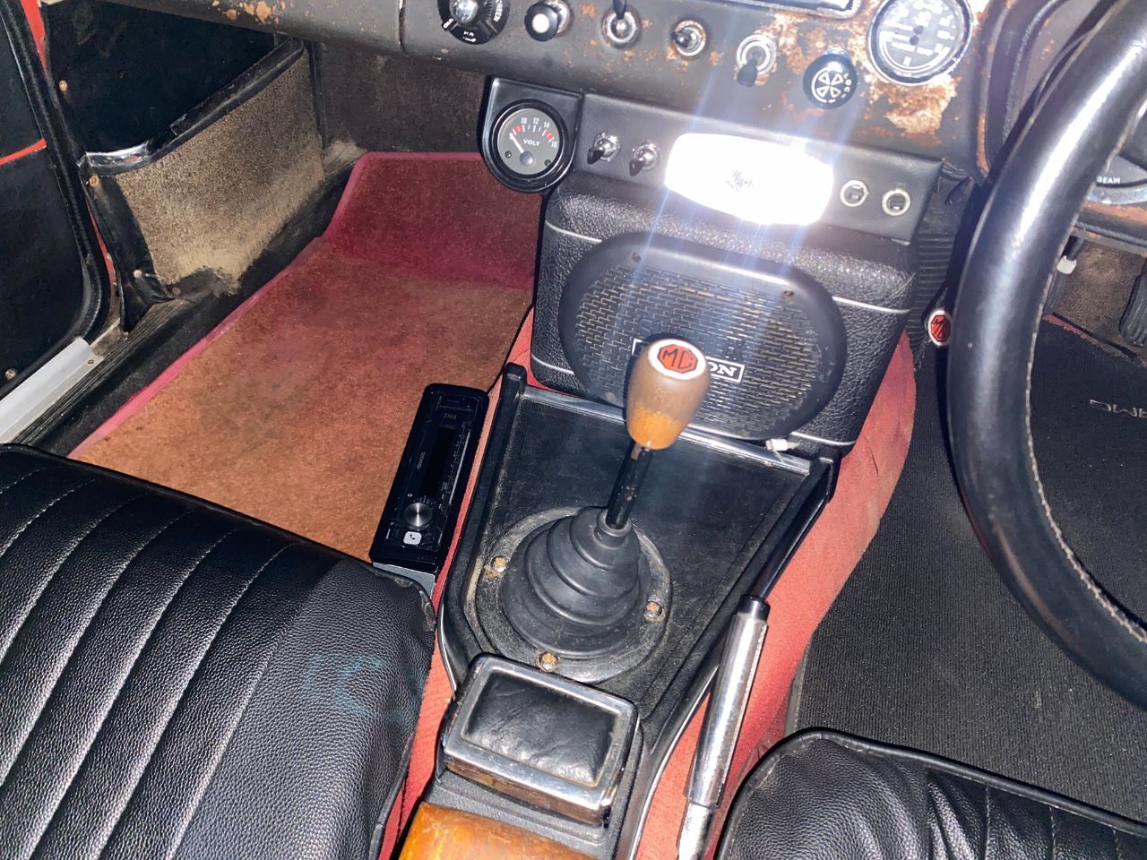

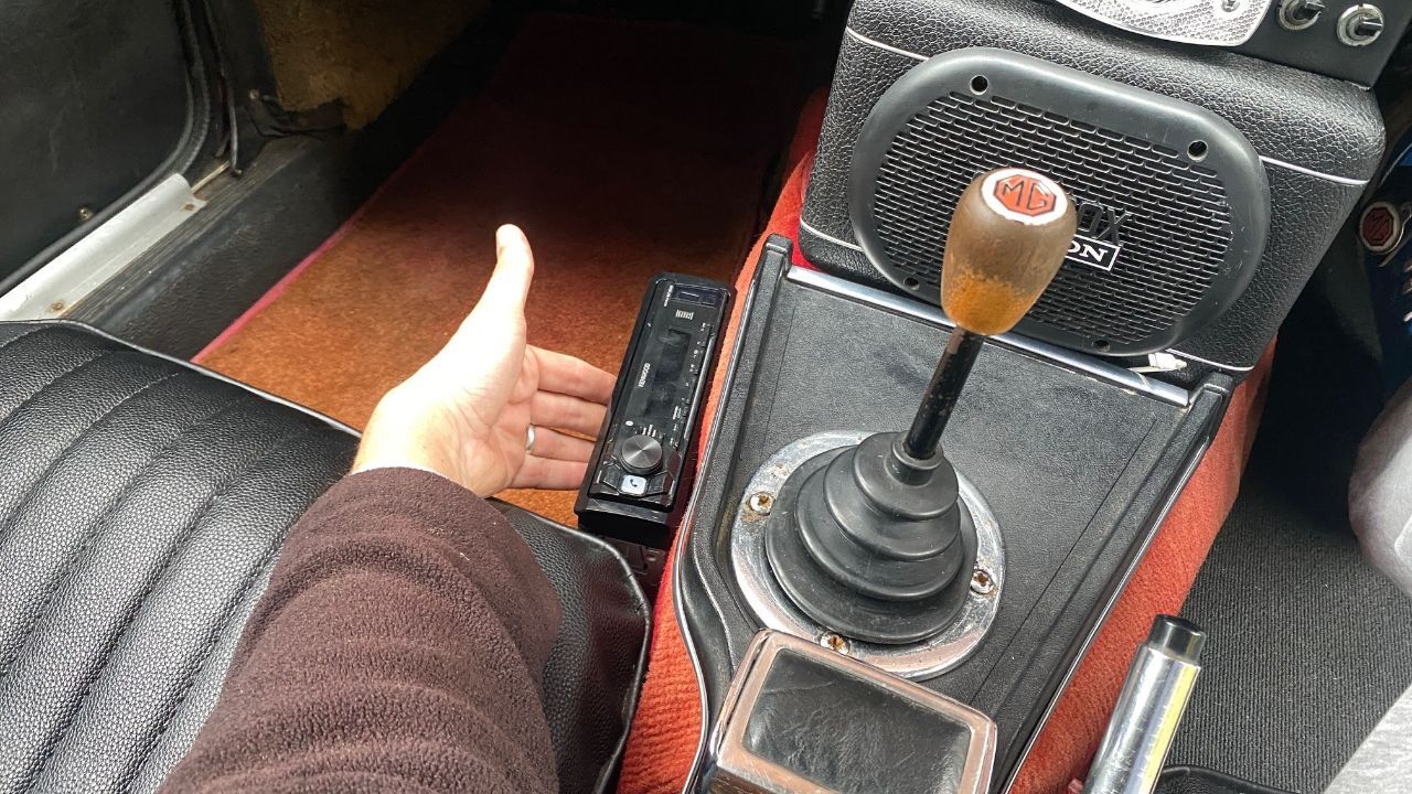

This is the original Clarion radio cassette player. It looks very happy in the centre of the dashboard and it is staying there. It will play via the central front speaker and two speakers that are fitted in the rear side panels.

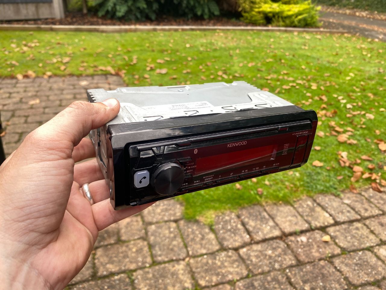

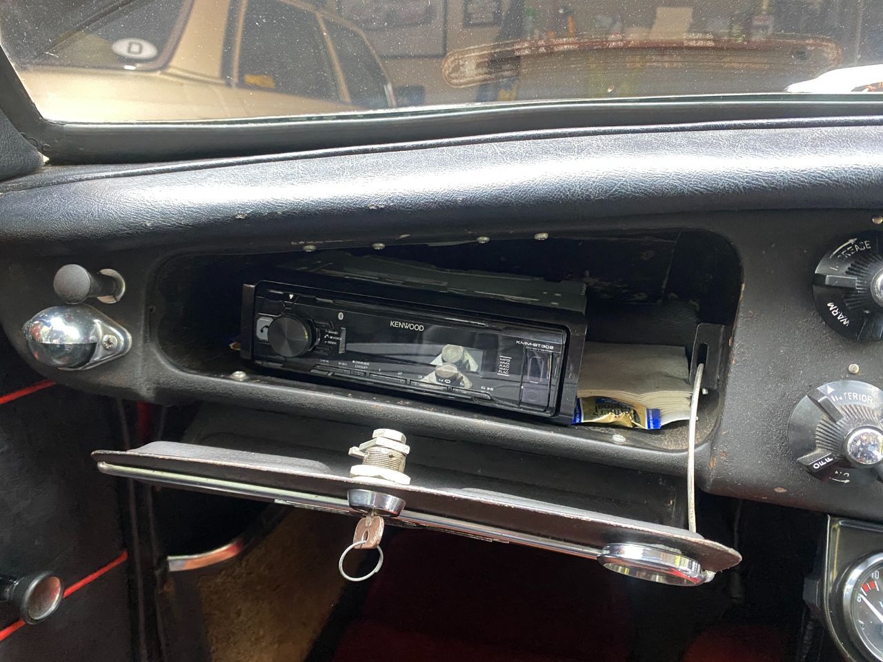

And this is the mech-less Bluetooth Kenwood head unit that I propose to fit somewhere where it won't look offensive.
Putting it in the glovebox won't work for two reasons. It won't fit without cutting the back of the glovebox and I don't want to open the glovebox each time I want to change a setting.
I could fit it vertically up against the A post but that would look really shit.
I could fit it alongside the central console, on the driver's side.
Or on the passenger side.
Or have it completely out of sight, under the driver's seat.
Decisions decisions.

I’ve always wondered about fitting a more modern head unit into a classic inside the original radio space, but further back slightly inside the dashboard. Then get an old period looking radio, take off the entire front face of it and make that into a cover plate to hide the newer head unit. Maybe use a small piano hinge or something to attach it to the dash so it can hinge open for access to the head unit underneath. Best of both worlds then! Classic appearance but modern sound system.
@danthecapriman
I hear what you’re saying but that sounds like a complicated to assemble solution. Also, I want to keep the old radio for when I park up and get cosy with a cuppa.
I wondered what you were going to get cosy with for a moment! How about below the glovebox, tucked back a bit to allow for the hinge? Discreetly visible and in reach to change settings from driving seat. (Stationary, obs!)
@High Jetter
The bulkhead gets in the way for the unit to be fitted far back enough to make it less visible and in that position it would be too far away to reach comfortably.
You could mount the new head unit in the suitcase, accessible from between the front seats.

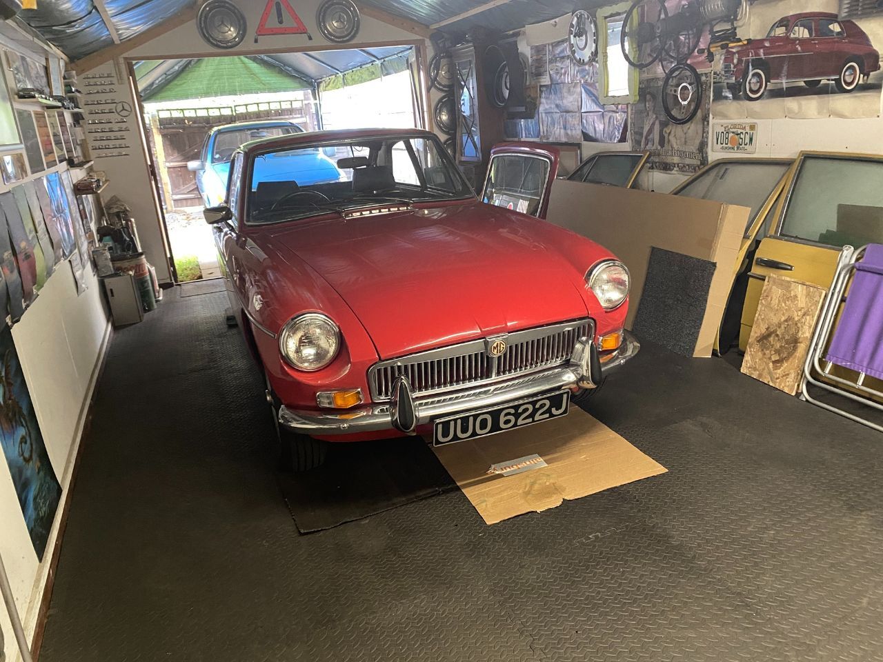

ICE install part 3.
I have a week off now, 9 days including the two weekends. On this occasion we are not going away and I propose to spend as much of my time off in the garage as possible, tinkering with the MGB, the Sierra and the W123.
The MGB was in first. Unfortunately, this means that the Sierra must stay outside, under the carport, for a few days.

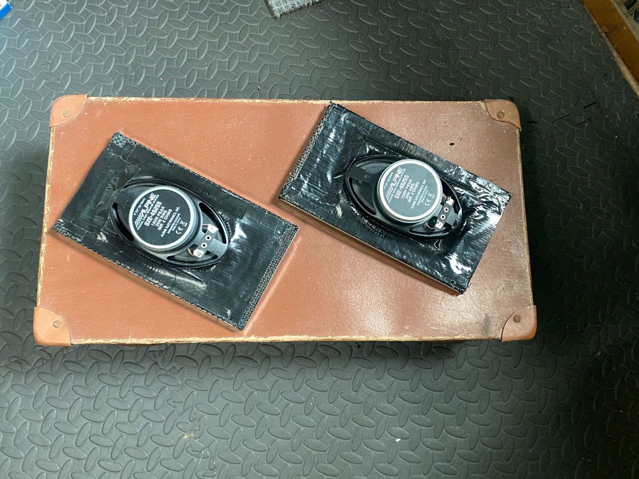

First, I taped up the oversized holes in the suitcase.
Holes, what holes?
Then I fitted the 4x6 speakers and the old Pioneer grilles.
Next, I had to make a mount for the head unit.
I'm becoming quite the craftsman.
Perfect.
With all wires fed through and tucked in under the passenger floor mat, the job was done.
I even like the metal finish of the mount.
The speaker box suitcase will do for now but will be upgraded in the future.
The head unit is within arm's reach but does not interfere with the ambience of the patinated dashboard. Exactly what I wanted.

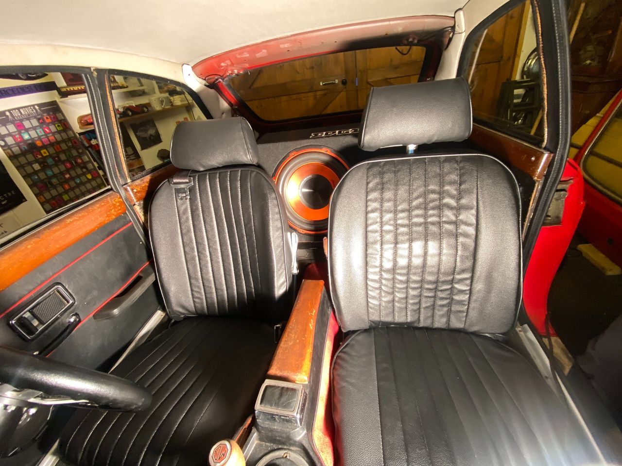

I wasn't happy with the ICE install. The speakers in a suitcase idea would have worked fine if the suitcase was bigger and I fitted a pair of meaty 6x9s. I love my music and most of it only sounds good if played on a decent sound system.
The original install featured a pair of 4 inch Clarion speakers, which were fitted in the rear quarter panels.
I removed these speakers, enlarged the holes in the panels and fitted the Alpine 4x6 with the old Pioneer grilles, which complement the condition of the MGB's interior. Perfect.

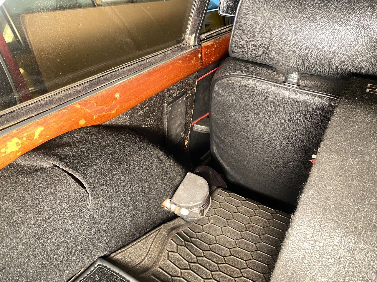

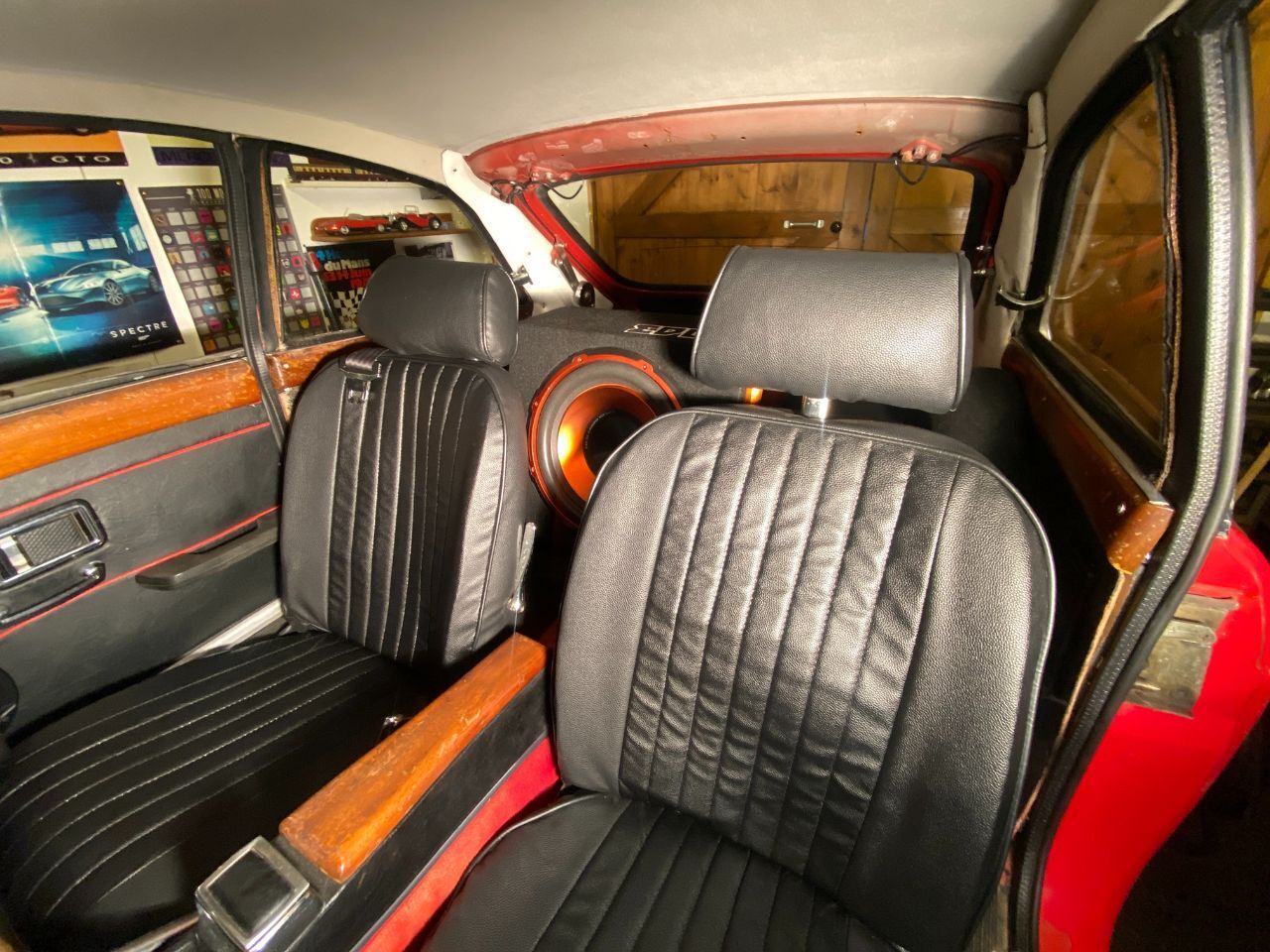

And I fitted a 12" active subwoofer.
To enable access to the battery, I installed a pair of hinges, which enable the sub assembly to tilt forward. The hinges are re-purposed from the MGBs back seat. Nice touch.
And here is the sub in all its glory.
In service mode.
And in fun mode.
It fitted behind the seats with a few millimetres to spare.
I have set up the crossovers on the head unit to play mid and treble through the four speakers and left the sub to take care of the bass.
Ok, it's only a 12" Vibe, nothing fancy but as it's positioned a few inches behind my left ear, it sounds superb, deep and punchy. The four speakers are much happier, now they don't have to play low frequencies anymore.
Total cost of the install is £0. I had all the hardware and cables in my workshop, leftovers from previous projects. The sub's amp is connected directly to the battery, which is fairly new and the alternator is also brand new, so the charging system should cope ok with the extra load. The old Clarion radio cassette player now plays only through the central dashboard speaker, as was the norm in earlier MGBs.
Having a fuck off subwoofer in the back of an MGB will not be to everybody's liking, noted but I don't mind how it looks and love the way it sounds.

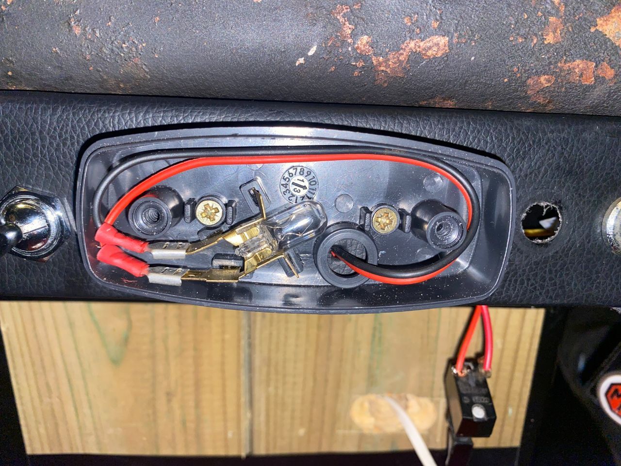

The recently installed dashboard light stopped working yesterday.
Evidently I'm not an expert when it comes to electrics, even whilst dealing with just two wires.
See here:
https://autoshite.com/topic/65354-why-light-not-working/#comment-3360069
Now sorted. Oddly enough, I haven't touched the original ground cable and I have no idea why it stopped working.

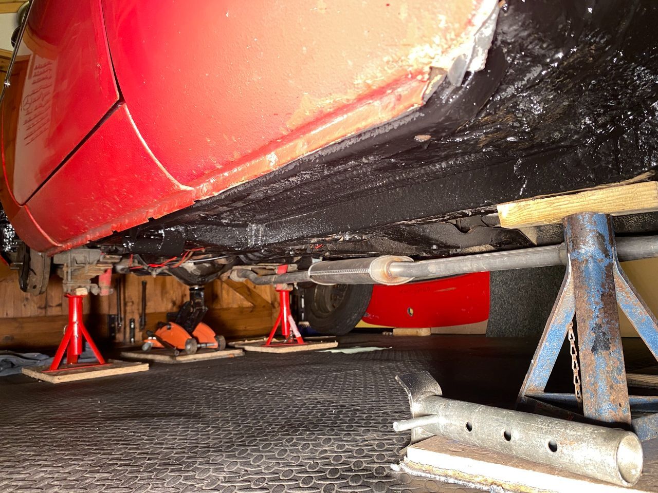

I lifted up the MGB to have a look at the condition of the undersealing that I applied around this time last year.
I am pleased to confirm that the Rust Oleum coatings remain firmly attached and there is no evidence of any exposed corrosion.
