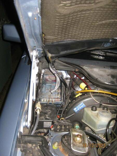

Rusty Pelican Posted December 18, 2023 Author Posted December 18, 2023 Got the whole washer system working , new pipes , one new pump ( headlight one ) and connected some random wires back together that were poking out the bonnet , probably wash jet heaters but ive no way of testing if the workĀ Dyslexic Viking, sutty2006, tooSavvy and 1 other 4

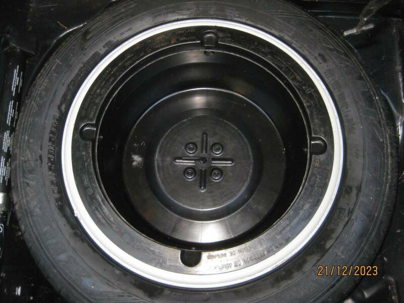

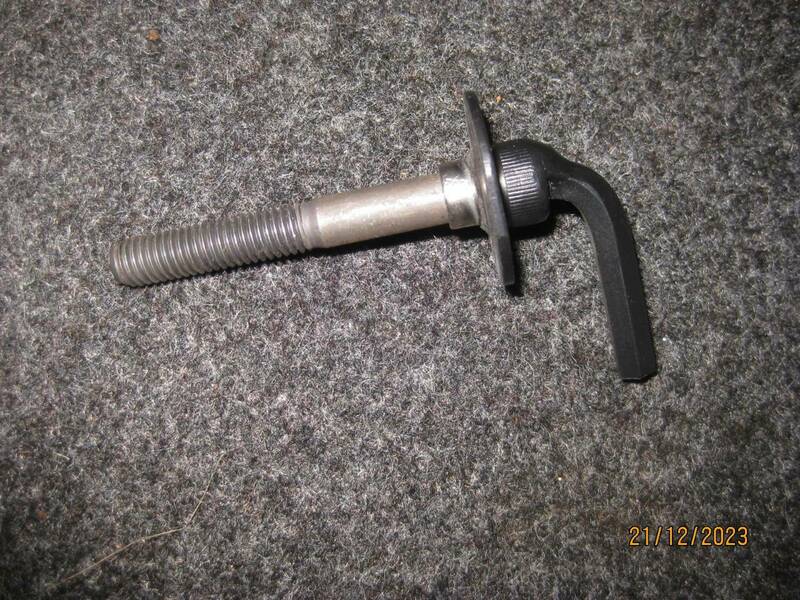

Rusty Pelican Posted December 21, 2023 Author Posted December 21, 2023 Abject bodgery . So the car came with a rusty steel spare with a tyre the wrong size dated 95 with more cracks than a busted window . Anyhoo i did get a proper alloy spare and got the correct sized tyre fitted so all good there . However the washing up bowl holder inner / junk pot dont fit anymore , alloys too deep so the threaded bit wont reach and also the the tops too high so you cant close the spare wheel cover š³ So to the bodge bit . First off cut the washing up bowl so it actually fits lower than the new wheel . The top you cut off will fit over it still . Fit bowl and bang it down so it hits the wheel and the top does the same . fix in place with some trim clips / nuts and bolts / self tappers / chewing gum - whatever you got really . In the middle of the original threaded mount it used to screw too theres an M8 thread - I just made a bolt with a handle and used this . Result - all fits together well , i still have the washing up bowl / junk pot fixed in place with the correct alloy
Nullzwei Posted December 21, 2023 Posted December 21, 2023 The more sporty w201's fitted with wider alloys came with a hump in the boot floor cover to accomodate the wider J spare . Now unobtanium i would imagine.
Rusty Pelican Posted December 21, 2023 Author Posted December 21, 2023 3 minutes ago, Nullzwei said: The more sporty w201's fitted with wider alloys came with a hump in the boot floor cover to accomodate the wider J spare . Now unobtanium i would imagine. Yep , got the hump in the plastic cover and the carpet , couldnt find a shallower washing up bowl for the wheel though , seems you just didnt get one Nullzwei 1

Rusty Pelican Posted December 28, 2023 Author Posted December 28, 2023 So im a twatting ejit . Got the cheap alloy spare and had a new tyre fitted then noticed the NSR tyre going down . Nae bother il fit me new spare except --- Wrong feekin offset so it sticks out enough to potentially rip the arch off . so gotta find another wheel but at least this time im not guessing - because part number and offset taken off the leaky wheel . So still no spare wheelĀ tooSavvy 1

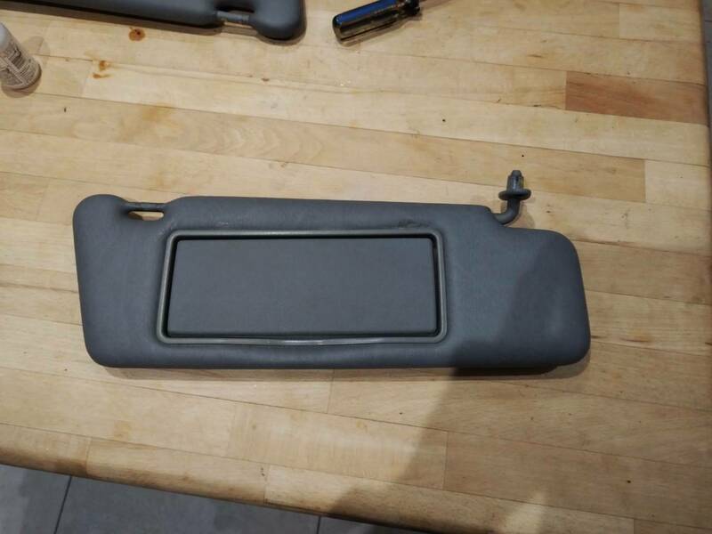

Rusty Pelican Posted January 4, 2024 Author Posted January 4, 2024 New / another wheel obtained , tyre fitted and we finally have a spare wheel that fits. Weather has been appalling lately so not done much however I have fixed the drivers side sunvisor mirror / light effort . First time i used the visor the mirror cover fell on me . hinge busted clean off both sides , recon it was just placed on . Try and find a drivers grey twin light vanity mirror for a 190E thats not busted - no feekin hope , did find a pair of black ones in the EU at wallet melting cost so thats out. I did however find a visor for a W140Ā Right colour = checkĀ Perfect mirror assembly = checkĀ Fits perfectly = no chance in hellĀ Plan was to remove the entire mirror and light from this and fit it into the 190E one - And it only feekin worksĀ š. Lots of faffing involved and the W140 ones light unit is shallower on the top so wouldnt clip in , no issue as self tapping screws to the rescue Ā Rust Collector, mk2_craig, Stanky and 2 others 5

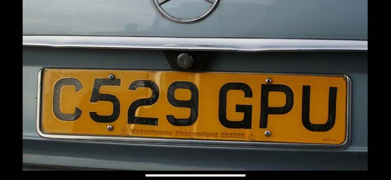

Rusty Pelican Posted January 23, 2024 Author Posted January 23, 2024 Sod any important stuff . Lets fit the repro dealer plate on the rear . wwwtandbclassics.com is hardly 1991 𤣠Original threaded inserts were long gone and probably why the plate was stuck on ( just ) Still the holes left were perfect for M5 Rivnuts so its mounted as factory again . Not sure how accurate the font is but its the best i could get wesacosa, Dick Cheeseburger, Rust Collector and 10 others 13
mk2_craig Posted January 23, 2024 Posted January 23, 2024 That looks absolutely spot on. Who supplies these?Ā
Rusty Pelican Posted January 23, 2024 Author Posted January 23, 2024 1 hour ago, mk2_craig said: That looks absolutely spot on. Who supplies these?Ā Got them via facebook from a company called Retro Plates. When i asked if they could do it they already had the info including the phone numberĀ https://www.facebook.com/retroplates mk2_craig 1

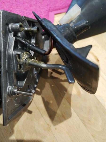

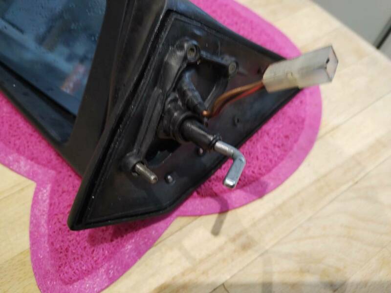

Rusty Pelican Posted January 25, 2024 Author Posted January 25, 2024 And for my next repair . Drivers side ( UK ) mirror handle adjust in and out up and down handle doodab thingy . Busted clean off well before I got it. New handle aquired from ebay ( from Poland IIRC ) . Fitting its easy , getting the broken bit out is a right nightmare . Its riveted to the adjuster doofer and getting that outs a nightmare . basically file the top off , prise the busted bit off . File the bottom bit and punch the pin out . Fitting the new arm is the easy bit although you cant reuse the pin .In the end I used a pop rivet with a washer that only just fitted the rivet at the far end therefor pinning it altogether . pop rivets hold well but not solid so it all still pivoted OK . Loads of greas added . To compound the hell the top mirror mount screw had previously sheered off . couldnt get that out so sawed the stub off , drilled right through and locked in an M4 bolt. Anyhoos it all now works perfectly Shep Shepherd, Rust Collector and mk2_craig 3

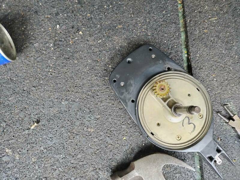

Rusty Pelican Posted February 3, 2024 Author Posted February 3, 2024 More Merc mayhem This time disassembly and re greasing the mono wiper . Its been running slow and sometimes refuses to operate . Absolutely no grease in there whatsoever save for the remains of some sticky goo . Lacquer Peel 1
