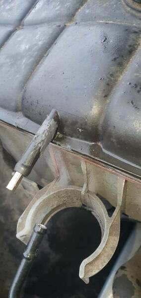

wesacosa Posted December 22, 2023 Author Posted December 22, 2023 I suspect it broke because the sleeve wasn't fully pushed inside the plastic. I have slid it back and used JB weld over the crack so lets see if that works N Dentressangle, chaseracer, Rust Collector and 3 others 6
SiC Posted December 22, 2023 Posted December 22, 2023 Probably be fine but for only under 40quid delivered next day I'd probably still order a replacement tank. Glass reinforced plastic can be a right bugger to stay repaired. Would be a right pia to have it fail when under the most pressure. That'll be when sat stuck in traffic and its sitting there getting hot idle.
N Dentressangle Posted December 22, 2023 Posted December 22, 2023 Kwality repair - got to be worth a go! 🏆 But yes, it will explode in heavy traffic when you're late for something important, have nice clothes on, and someone in the car you're trying to impress Rust Collector 1
wesacosa Posted December 22, 2023 Author Posted December 22, 2023 yeah will order a replacement but fingers crossed this might at least keep mobile for a few days
wesacosa Posted December 22, 2023 Author Posted December 22, 2023 ordered that part, thanks again @SiC The stat is on the to do list too so if it arrives on time tomorrow I will try and hit both in the same job. Fingers crossed we will be back on the road soon Pat Earrings, chaseracer and SiC 3
SiC Posted December 22, 2023 Posted December 22, 2023 Febi seem to have a lot of parts available next day on Amazon. It's been a life saver when something has broken and I've been impatient to get the car back on the road. wesacosa 1
rob88h Posted December 22, 2023 Posted December 22, 2023 That’s only a degas return line to the bottle, will be minimal flow. So long as your repair is stronger than the pressure rating on the cap then it’ll hold no worries. I think slam the bonnet shut and never go in there again. Enjoy winter commuting in blissful ignorance before finding anything else 🤣 N Dentressangle and wesacosa 1 1

SiC Posted December 22, 2023 Posted December 22, 2023 2 hours ago, rob88h said: That’s only a degas return line to the bottle, will be minimal flow. So long as your repair is stronger than the pressure rating on the cap then it’ll hold no worries. I think slam the bonnet shut and never go in there again. Enjoy winter commuting in blissful ignorance before finding anything else 🤣 Minimal flow but will have all the pressure. Probably a good 10psi or so on a modern system? Not a huge amount but not inconsiderable. But if not completely air tight repair then the pressure (and evaporating coolant) will escape. Lowering the boiling point and risking the cooling system boiling over in traffic. For the price of the bottle Vs the the pia if it does fail, it's a no brainer to lob a new one on there imo. wesacosa 1

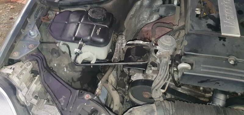

wesacosa Posted December 23, 2023 Author Posted December 23, 2023 new tank, stat and housing on. Not leak tested yet. Minimal* coolant spillage on the drive SiC, Rust Collector, Rusty Pelican and 7 others 10

wesacosa Posted December 24, 2023 Author Posted December 24, 2023 initial run up to temperature and run around the block. No sign of any coolant leaking so far and no sign of the poor idle or milf light. Too early to call success but hopefully encouraging Dyslexic Viking, Pat Earrings, Volksy and 5 others 8

wesacosa Posted January 4, 2024 Author Posted January 4, 2024 First proper drive since doing the vac hose and the stat Happy to report a very smooth idle and no MiLf light action so far. car now also runs about 20 deg hotter now. Cracked 40mpg average on this mornings run do about 7mpg up on what I got before, but there was no traffic at all so might drop a bit when there is Interestingly the abs light didn't come on either, although it did stay off for a short period once before so not calling that just yet. However it does suggest the sensor that caused the last fault code can't be totally knackered if the light stays off sometimes I have bitten the bullet and ordered replacement cam VCT magnets, they are leaking pretty badly both down the front of the engine and oil wicking up the harnesses into the ECU. Sadly the blocker harness from @Stankygot lost in the Christmas post so need to source replacements. Could try just cleaning and replacing seals I suppose first thing but autodoc have pierburg magnets including seal kits for less than £30 each so may as well just change them chaseracer, yes oui si, Volksy and 3 others 5 1
