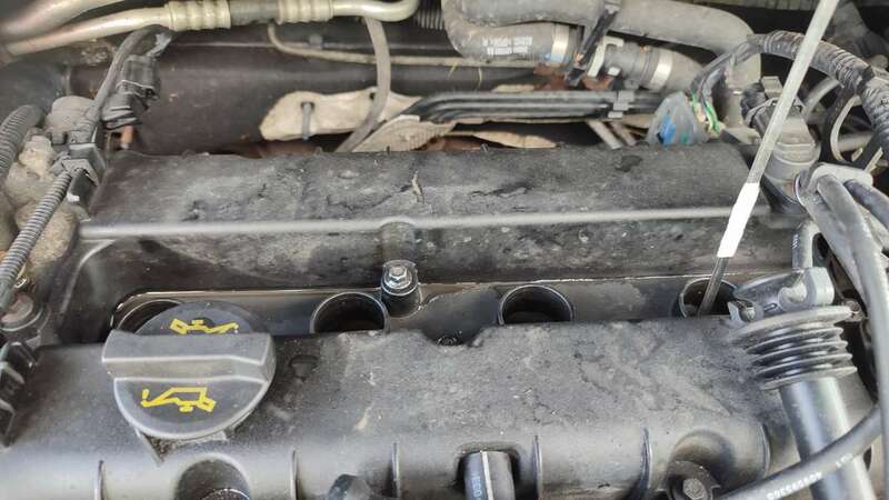

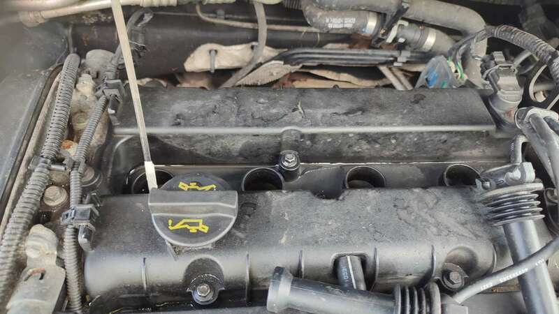

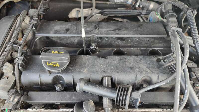

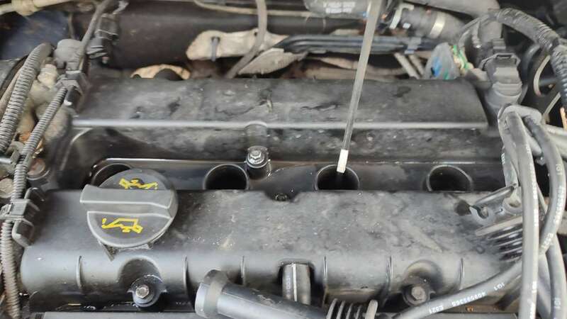

RoverFolkUs Posted June 20, 2023 Posted June 20, 2023 So, after an unfortunate incident involving water entering into my Focus's engine, and killing it very well indeed, I'm faced with 3 options. 1) - scrap the car 2) - swap the engine 3) - do an "Autoshite rebuild" I initially said it's curtains, but now I've had time to reflect on the situation, I have decided that I am not going to give up on the car immediately, and give things a chance. What is an Autoshite rebuild you may ask? Well, it will be a cost effective engine rebuild. I have the tools, equipment and knowhow. The time? Not really, but I'll make something work. This thread will be a diary keeping track of things. Don't expect regular updates, I'll be attacking it as and when I have time. Plans may change along the way, but I've opted to do an Autoshite rebuild. Second hand parts will be used, items will be reused. If anything about this concept upsets you, this isn't going to be the thread for you I'm afraid. 😅 ,- It's a 17 year old Ford Focus, worth probably no more than £1500 as a going concern so I'm applying a very conservative £500 initial budget to include the consumables and service items along the way. Whether I buy another engine for spares and make a good one out of the two, or only buy the spares I need is to be decided. I'd really not want to buy a complete engine because you don't know how good it is, how long it would last, how well it's been looked after and, particularly important for a Duratec, how much of an oil burner it is. This kaput engine was absolutely perfect before this, so I'd like to retain everything that isn't broken, ideally. For those who are interested in the rebuild, great! But if nothing else, it will be a helpful place to write everything down so I can remember important details along the way... Stage 1 - Diagnosis So, what was the damage? Ordinarily, I would whip the plugs out and whirl it over to remove as much water as possible. (After trying by hand at the crank pulley first, of course) This is the first hurdle, the engine has locked up even with the plugs out. Upon further inspection, we have the following results. Hmmm, we've either got at least 2 extremely bent rods there, or broken ones.. Predictably, the engine is simply locked up despite having no water in the cylinders now. Shunting it in gear did free it off a bit but it then locked up again What next? Stage 2 - Teardown, inspection and parts inventory to follow... rob88h, nomiST, AnnoyingPentium and 33 others 36
