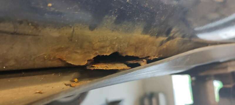

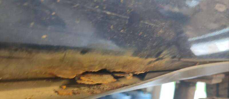

RoverFolkUs Posted July 26, 2023 Author Posted July 26, 2023 Been slowly getting the little bits back together on this. There are lots of fiddly things to do, like refitting clips to wiring, hoses, pipes etc and go around checking nothing is fouling, and everything is routed correctly, etc etc Lots of faffing around with the underbody heatshields, the flood water ripped some of them off their fixings but I've refitted them with repair washers as I'd rather not remove them altogether. I had the car on a different ramp this evening, and something rather unpleasant caught my eye.. (The nearside was facing the wall before, so it hadn't caught my eye, but today the offside was facing the wall so I was walking past the nearside a lot more. When it was airborne, I found this...) Hard to describe, but that suspicious tide mark is kind of facing at a 45 degree angle downwards, so when the car was on the ground I never noticed this. Oh dear.. Didn't take much poking to find a hole Better get that welded up as well then... 🤬 beko1987, Popsicle, GMcD and 5 others 2 6
sierraman Posted July 26, 2023 Posted July 26, 2023 Shit! At least the sill cover will hide the patch. This is part of the reason I’m moving my attention to the Mk3 as a lot of Mk2 seem to be very rusty now. RoverFolkUs 1
RoverFolkUs Posted July 26, 2023 Author Posted July 26, 2023 6 minutes ago, sierraman said: Shit! At least the sill cover will hide the patch. This is part of the reason I’m moving my attention to the Mk3 as a lot of Mk2 seem to be very rusty now. Yes that's a good point, I think those sill covers are totally pointless as well I think it seems to be fairly isolated. I was really surprised to see it as it's the only structural rust on this car, the offside sill and all the underside is structurally solid, and I can't see any evidence of it having had any welding before The rear suspension looks like it was fished out from the bottom of the ocean, as they all do, but the rest of it is solid structurally! The bottom of the drivers front wing is beginning to dissolve. No holes yet but if I poked it I bet it would create some Not bad for a 17 year old Ford to be honest, but yes like you say, a lot of them are getting really rusty now Split_Pin 1

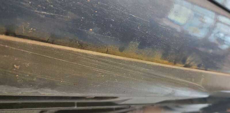

RoverFolkUs Posted September 25, 2023 Author Posted September 25, 2023 Enter this excerpt from the news 24 thread: 2 hours ago, RoverFolkUs said: Fuck. Right. Off. 😐 Decided to remove the sill and wing covers to inspect the extent of the rust that I need to repair. ^ You can see how much that's going to snowball into one I do a *bit* more poking... I was thinking about replacing the front tyres due to the questionable wet performance and worsening perishing. That's decided that for me then... Yeah, I'm really annoyed about that rust. Removed the god awful fucking sill covers which the factory put on. No idea why, all it's done is trap shit and it's caused that. Not too sure why I didn't think to remove them and fuck them off entirely when I first got the car more than 4 years ago tbh.. but there we go. That entire section of the sill is totally fucked, the rot runs all the way along, I've just not poked at it enough yet. I'm glad I've caught it before the sill completely disintegrated though!! The underside has lots of surface corrosion, particularly the rear suspension, which will greatly benefit from being cleaned off and waxoyled, so I'll do that soon. There's a positive to everything though, despite the nearside sill being fucked, the offside is a lot further behind and I've caught it just in time to treat it before it turned to swiss cheese. Clouds, silver linings etc. 🙄 Not totally decided what to do with the wings yet, because it's not structural I'm thinking of cutting out the rot, painting it to prevent anything further, then repairing* it with filler and then doing as nice as possible paint job on it... I think that sounds about right? The obvious answer is to get replacement wings, but pattern parts won't fit as well, and then I'll either paint them myself which will look shit, or source second hand ones in the same colour that aren't fucked? It's not a common colour so there's a first hurdle, and they all rot along the bottom, so I think that option is out the window. Oh, icing on the cake, thought I'd address the MOT advisory I've ignored since, erm, January, by replacing the discoloured indicator bulbs, upon twisting the holder it decides just to snap so now that's fucked as well. I cursed it, but a temporary repair with super glue got me home, but that means I'll be on the blower to the stealer in the morning expecting to be relieved of about £20 🫡 I resurfaced my "which tyres" thread in the ask a shiter section as I thought about getting a new pair for it a bit sooner than anticipated, well, now it's even sooner than anticipated as the drivers front has picked up a puncture.. It's already got a temp plug in it (unbeknownst to me until recently) - unfortunately the bargain priced clearance Michelin Primacy 3s are not available, as predicted, only the Primacy 4s at a! eye watering (to me, as a bit of skinflint) at £90 a piece.. wholesale price! Not fitted! That's too much for what this car is, a 2nd car/runabout... So trusty Toyo proxes it is then at a much more manageable £50! I'd like to say that's all for now, but it probably isn't.. needy bastard. I really like it though, as it's a brilliant "an car" so that's why I'm persevering with it. Rust Collector, RayMK, AnnoyingPentium and 6 others 6 3
