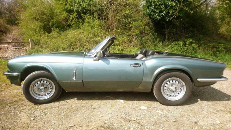

Busy day at the SiC household. With the Rover gone, it was time to pick up it's replacement. Due to an insurance timing fuck up on my part, @N Dentressangle kindly delivered this for me.
Just done four hours of driving going back and forth so I'm now a bit knackered. I'd usually sit in it and have a fiddle but I might end up falling asleep in there.

I bought it because, unlike what I usually purchase, this is (almost) fully working. Tried and tested from ND commuting in/out of Bristol so I know I can rely on it to not let me down. I'd really like an orange, red or yellow one but I like the fact this colour isn't original and different. A bit like the blue 1100 we had it's eye catching.
Plans for this are to actually just drive it. As typical when selling any car, the electric cooling fan controller decided to play up just before collection. I have a spare mechanical fan and I'm quite tempted to fit that back on and put an Otter switch in the cabin for the electric as an additional backup.
Only other thing that I want to play with is the Speedo under reads by 10mph. We believe the wrong overdrive Speedo drive gear is fitted when it was restored. Possibly for a Dolomite with a higher ratio diff. So I'll have to pull the current one to see which colour it is and then match with the correct diff. That said, it's probably going to be easier to source a different diff than try sourcing the right Speedo drive as many are NLA.

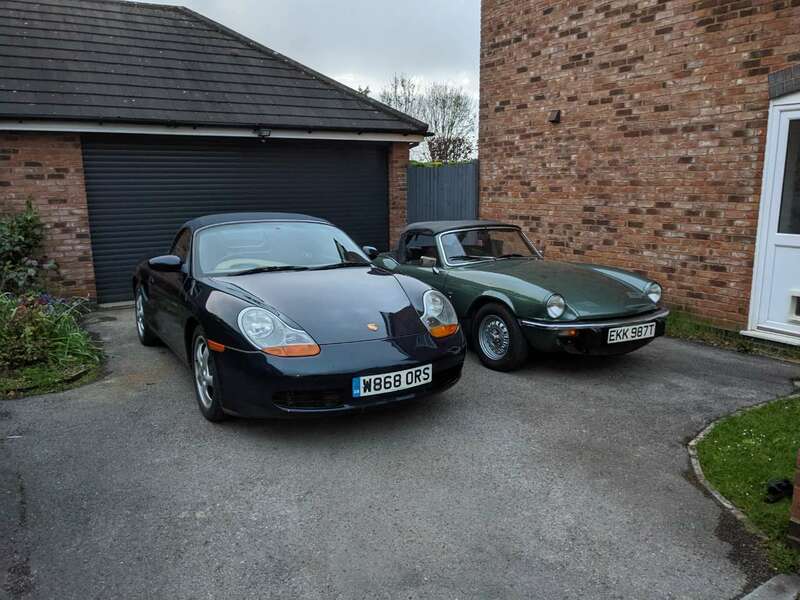

Hopefully ND doesn't mind me posting these but his photos are much better than the ones I took recently. Give a much better idea of the colour and the car generally.

So as mentioned at the start of this thread, I had an insurance timing issue. Basically I phoned Hagerty on Saturday at 1255 but their lines shut already (should have been 1pm). Hence having ND needing to deliver it for me.
I've been pretty busy at the weekend so I didn't get a chance to do too much. I'd love to have gone for a cheeky drive on Sunday evening but no insurance. Monday was not only a write off with the weather but also I had to emergency fix a leaking drain behind the washing machine. I hate plumbing and I hate even more fixing previous plumbing mistakes. Dehumidifier is still whiring away in the utility.
Anyway today I spent 3 hours on hold to Hagerty and eventually got through to get insurance. Didn't really want to broadcast it was sitting on my drive uninsured until sorted for obv reasons.
