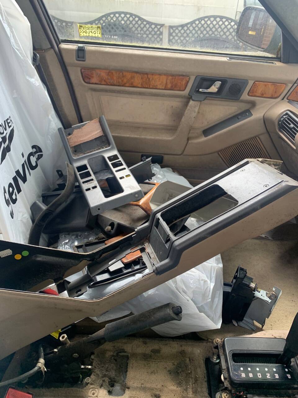

Had an hour to look at this today.
Thanks to @Marina door handles I had a better idea (and head) to get the the centre console out.
All of this shit had to come out to get this far.
Yeah I broke some veneer, it’s wood. It’ll be easy to fix.
I couldn’t really get to the bit I was looking for as the Haynes BOL says you need to go under it etc and I’ve no Jack or stands here so I can’t take that out.

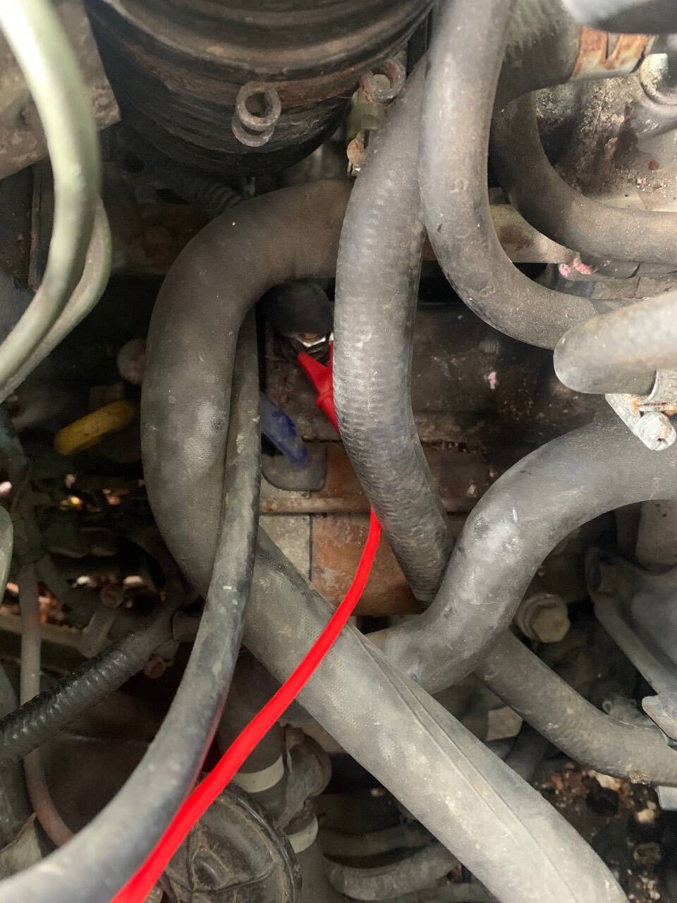

I did ask my sister though to start it, as I could hear clicking. There is clicking from the engine bay, I think it’s the ABS pump being primed.

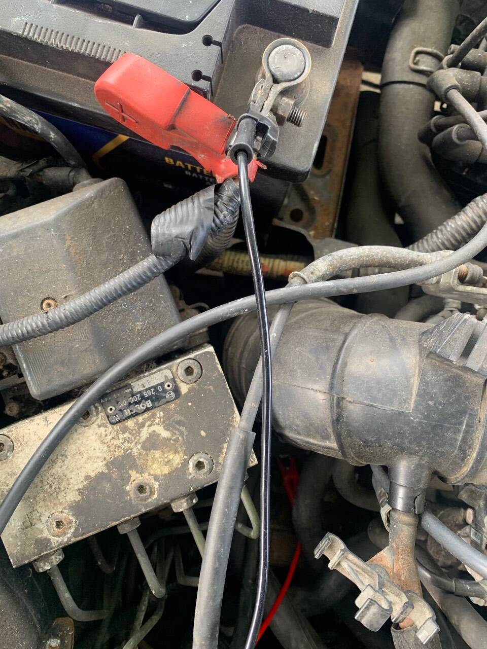

Forgot though I bought crocodile clips for my multimeter, so I hooked it up.
Zero volts at every point. So there is no power going to the starter.
Should also say that when I put it in reverse the reverse lights come on aswell.

It's not quite clear what you are doing with the multimeter.  The battery terminal you show has a red i.e. positive cover on it.  Is it the positive or negative terminal?
Main positive (probably brown) battery lead to solenoid should be live at all times, it does not go via a relay.
I had the red of the multimeter going to the starter, then the black/negative goes to the positive of the battery.

If you want to measure voltage there you need the black on the negative of the battery, or a suitable earth, and the red on the point you're testing.
Thought so.   As said  - red of multimeter to starter, black of multimeter to negative of battery, or engine/body earth

Ok check again for voltage at the starter solenoid terminal.
If all Ok, next thing, go to the other wire on the solenoid - probably brown/purple.  You should get a voltage between this wire and earth when the key is turned to start.
If you do get a voltage, the next thing is with ignition off and gear in neutral, carefully touch a wire between the large terminal and the small terminal and see if the solenoid operates.

You were actually trying to do a volt drop test there instead so all was not lost, only executed incorrectly :)
