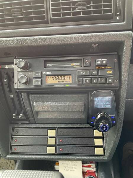

A little upset this evening. The sharp tape deck has failed. Ruthie said her tape broke on Friday but it’s the deck that’s broke the tape.
I need options folks! These dash boards don’t like taking full size CD players, so I’m happy to replace it with something that’s Bluetooth or has usb/jack aux point. Or is it possible to have this one modified so it can be Bluetooth etc?
Has that deck ever been cleaned? I use an Allsop 3 head cleaner on all my tape equipped cars & home tape decks, & have been for the last few decades, to good effect, or, you can strip it & clean the head & rollers with cotton buds & alcohol manually.
That said, tape snappage/unraveling can also be down to stretched belts & other more serious issues, so it may or may not work in this case.

We have radio!!!
for the first time since 1989, FM radio comes through the ultimately crap gm speakers!
ok, so it’s not a 751, but it’ll do for now!
where can I get a tape deck cleaning kit from? Or does anyone have one we can run through this bad boi?
EBay have them, nearly got one myself until I found my replacement radio which works fine.
It used to be said that cleaning tapes wore the heads, so cleaning fluid on buds was best.

Oooh! Fisher C Box too, very thrusting 80s exec! 😛
If you can be arsed digging it out the dash again I'd take the top off and go for Q tips and isopropyl alcohol to clean the tape heads and rollers, they'll likely be more manky than a head cleaning cassette alone can deal with.

I’ve succumbed.
the Philips 752 is shite. Radio is full of static and the tape deck is naff. I know these cars don’t have a lot of room for CD players, so I spent 13 quid on this.
it’s very shallow
it does FM. Bluetooth, usb etc..
looks easy enough to wire up too.
m the FM transmitter I was donated will be fitted into the discovery, because the original radio just “died” and the replacement has a retarded tape deck. So it’s a bit of a shuffle round!
