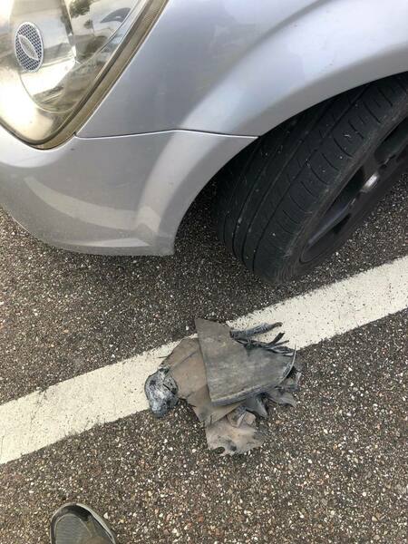

The only issue was a wheel arch liner that made a bid for freedom somewhere around Baden-Baden. Chopping it out got some odd looks at the services.

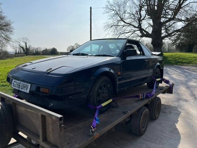

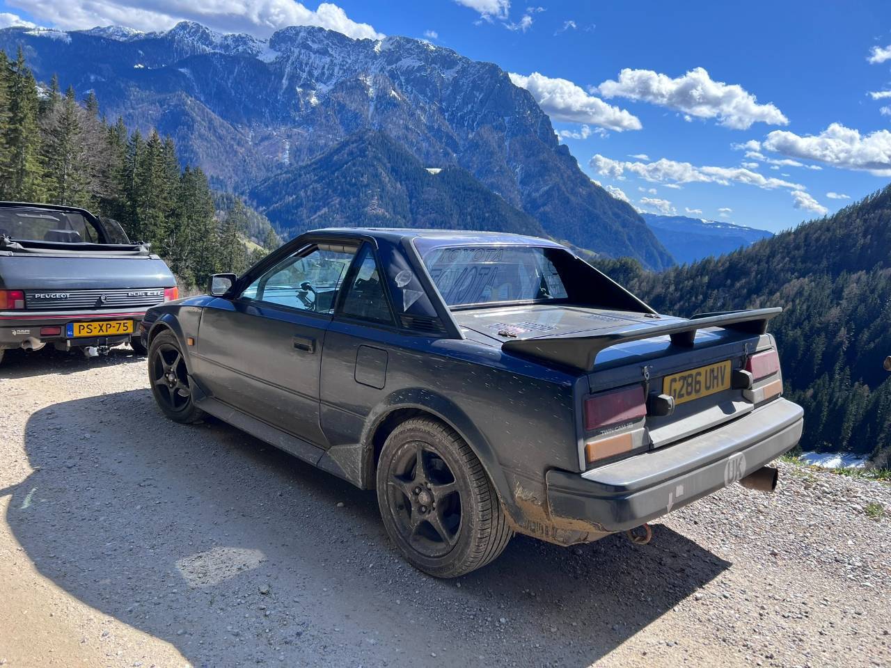

Now for the newcomer- a 1986 Mk1 MR2. As much as I wanted one I wasn't really looking for to buy one at the moment, I was mostly looking for something to use as a winter commuter. However I have @Schaefftto blame for sending me this(as seen in the ebay thread) , and who could resist a cheap Mk1? It's a 1986 so is a bit of a crossover bewteen Mk1A/B versions.  No real collection photos as I got it delivered after taking a quick look earlier in the week. Someone had already shown an interest as an engine donor, but vanished before stumping up the cash.
It photographs well, but does need a fair amount of work. It's not been on the road for 10 years, and while previous owners have done a lot of rust repair, according to the stack of recipts that came with it that was all in the late 90s so it  is coming back.  At some point it's had heavy underseal applied, I suspect after the last batch of MOT repairs in 2010. Stripping all that off will be fun*. The wheels will be going, I've had a set of these TSWs on the Ignis and they must be filled with lead for how heavy they are.

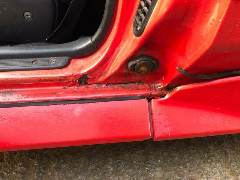

Sills look like they need attention, and have been repaired before.

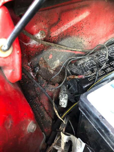

Hole in the inner wing by the fusebox.

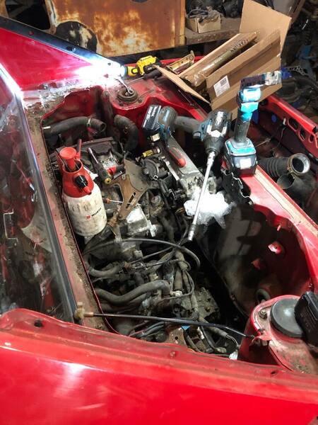

Ignis. As the roadster is out of action that means the Ignis actually gets some use. Other than a getting an MOT a month or so ago it mostly just sits gathering moss.

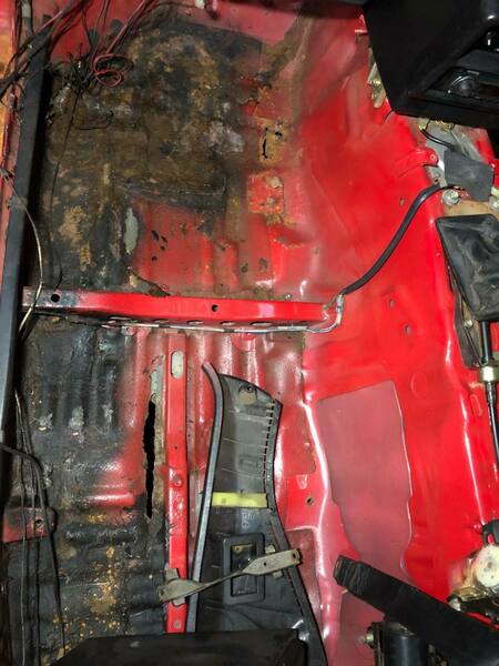

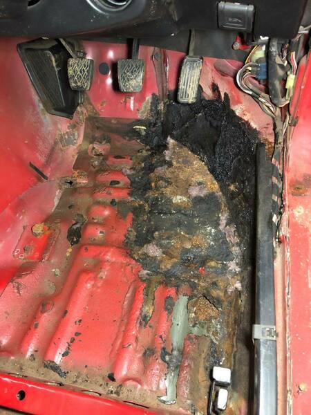

I’ve now dug in to it and it’s going to need a lot of work. Both floors, Passenger sills, rear quarter and inner wings. Possibly more one I get it on the spit. I did buy a new welder so I may as well get as much use out of it as I can.
Ventilated floors!
That’s the leading edge of the passenger footwell, looking rearward. This is by far the worst area, and shows what underseal can do. Peeling it off and it was wet behind it. I have replacement floors and sills now, but this is going to be a longer term project.

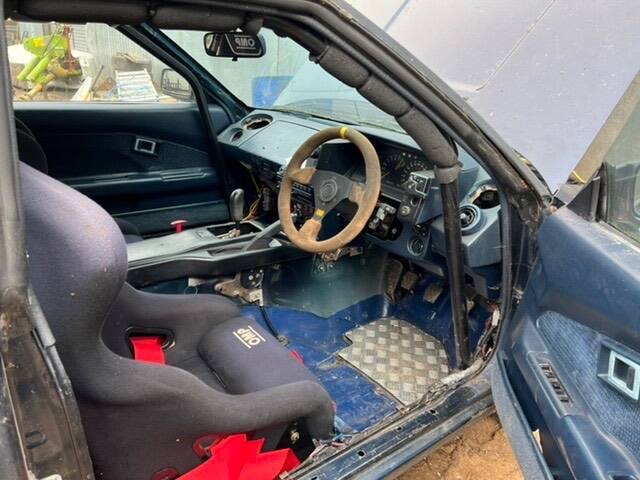

Luxurious Accommodation. Seats/Belts/Fire system are out of date now, but still find for targas and stuff. It does need some interior parts for that. The cage is a Safety Devices one, though I’m not sure if it would pass for a logbook however that would be a long way off.

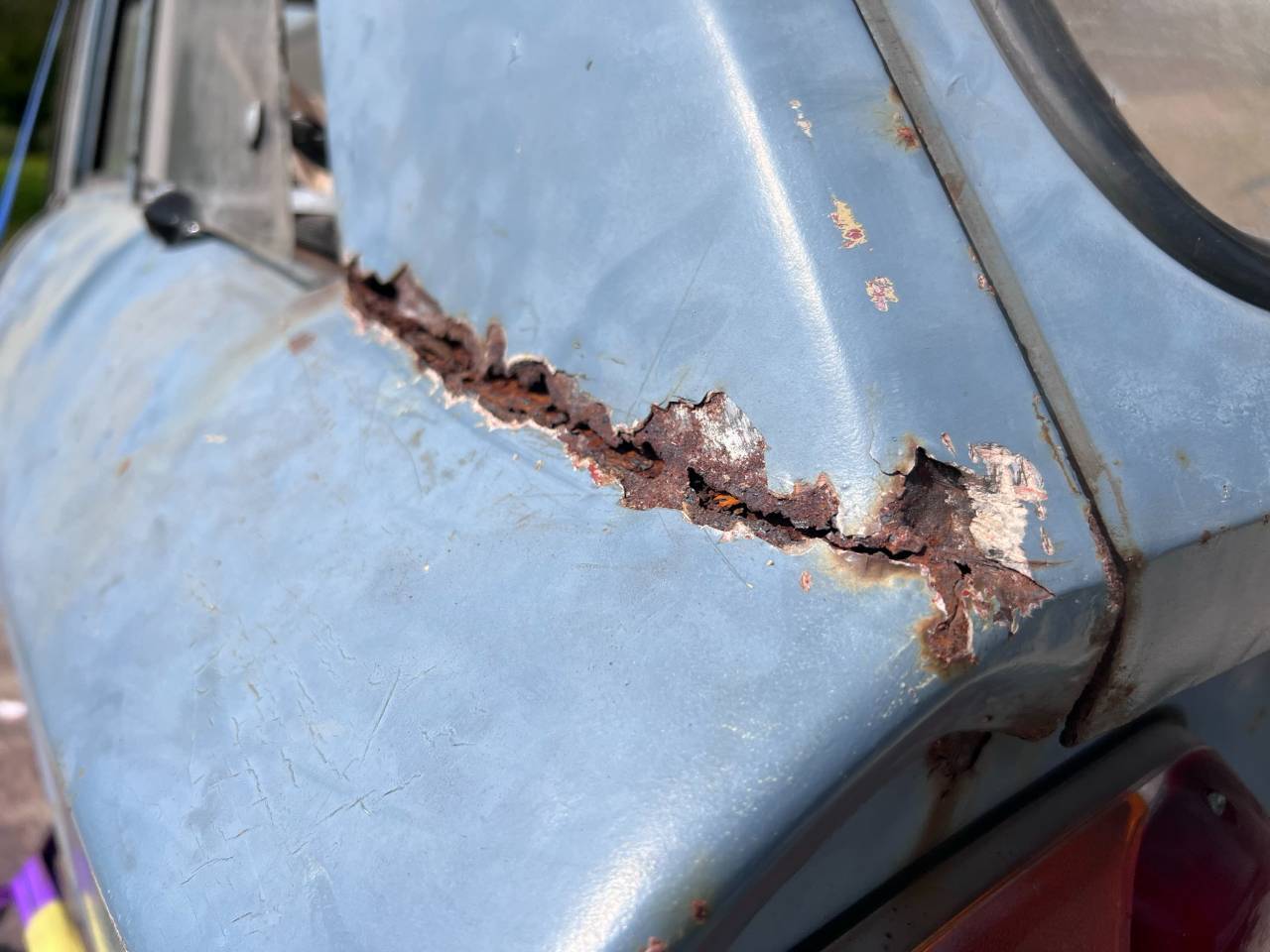

The worst area is on the drivers side rear arch, there’s a lot of wob in there. It could be from a shunt as opposed to rust, either way it needs some attention to get through a test. The sill is solid, its the quarter panel over the top that’s the problem. For now I’ll patch it so the sill and panel are attached to each other and cover up the step in the filler with the sill covers. The front wing needs a bit of love too, but that’s a much smaller issue.
Taking it around another farm tracks it’s a riot. The engine was rebuilt by the last but one owner, the cams look new and it’s plenty fast enough.

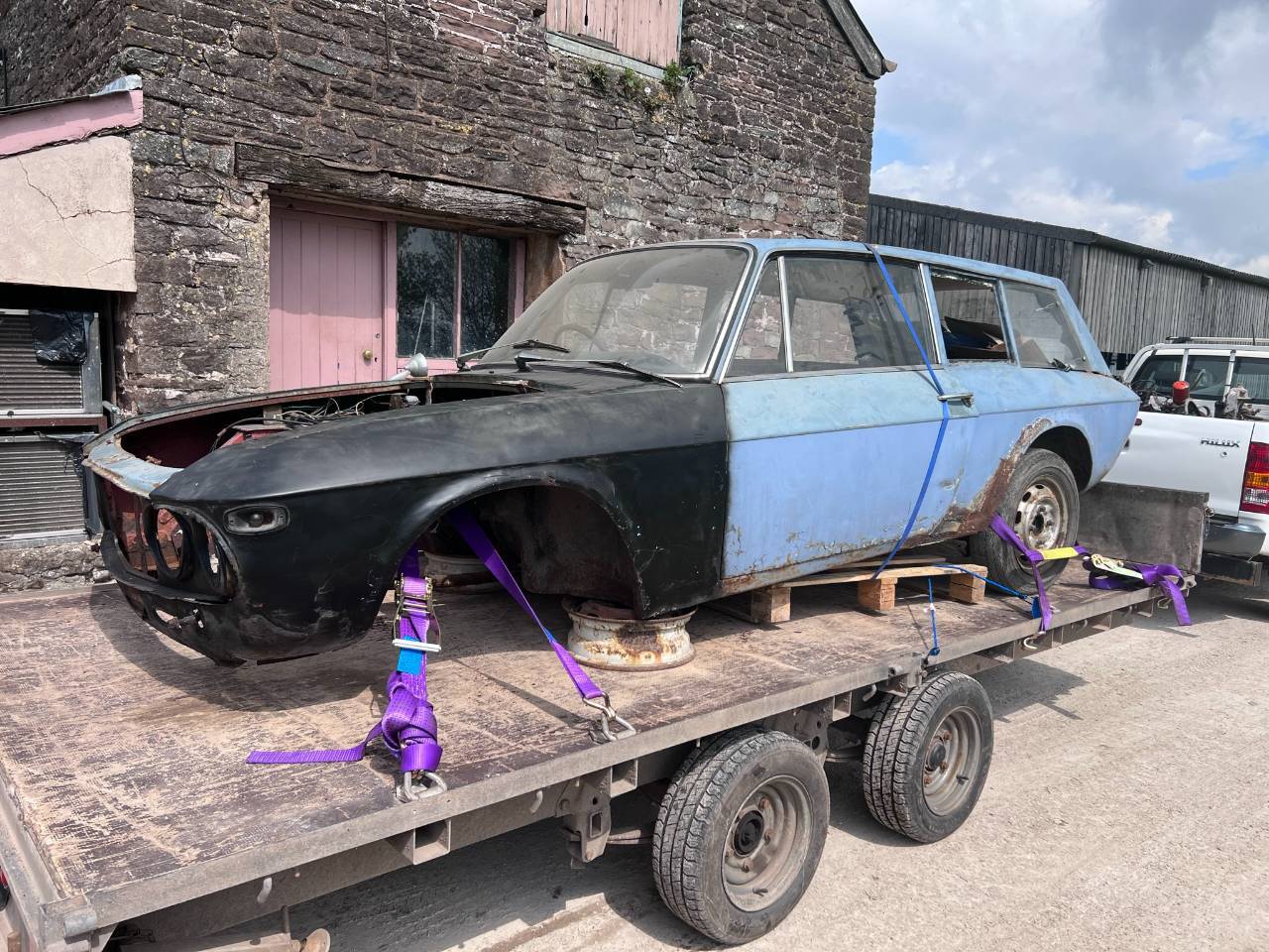

Yes it's another weird fibreglass wedgy thing! Looks like a shed, but it's actually really solid, which is the critical thing for these.  It was imported in 2021 having previously lived in Angoulême. The guy selling it had another under a tarp, as well as a parts hoard, some of which I made a return trip for. So far I've stored this away as something for next year, it did come with a 1442 but I'm wondering about going for something more potent as the Simca engines were never the strong point.

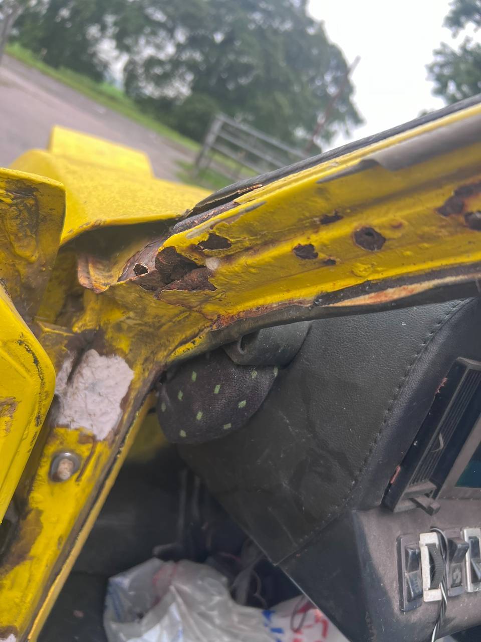

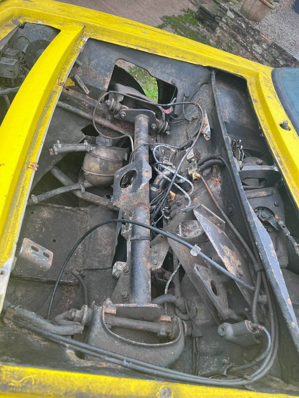

Some Photo's of the Lancia's current condition
I am not sure what the utility of this patch on the sills was.
That's the rear spring mount, which is probably the worst part of the car.
Previous repair is not so good now.  From the old photos the doors have never fitted well, it looks like this panel was replaced but positioned too far forward so the door doesn't sit inside. IMG_8964.JPEG.3b9ec3b1af5138eadb7492d190fe6584.JPEG
That's where the subframe top mount sits. There's a parts shop in Italy that has replacement sections for here. IMG_8951.JPEG.f33670514e4e086b9c22caecb91243b8.JPEG
The join between the GS and Fulvia has rotted through on both sides. The GS cut I have is long enough and the Fulvia panels for here are available. Will be a lot of fettling to join them up . The actual roof panel is very solid and will probably stay,
The floors need work, but that's the least of the problems. A lot of the work will be replacing previous repairs, especially on sills and arches. It's certainly a big project and one that makes no financial sense, but it deserves to be back on the road.

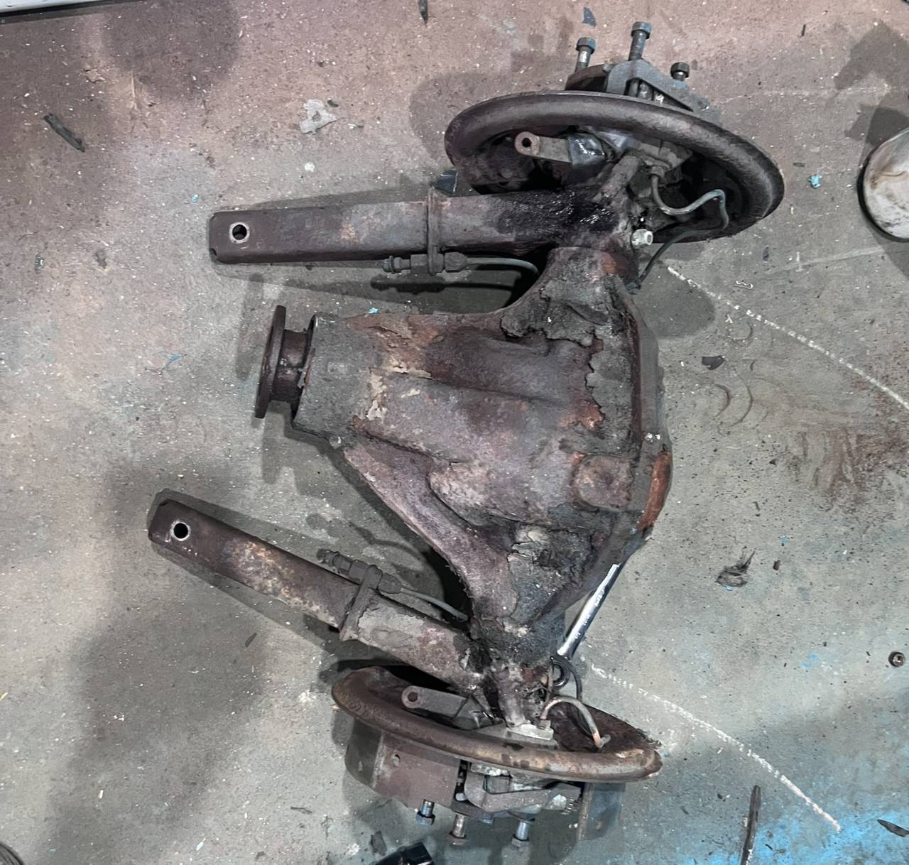

Today was mostly finally pulling the diff to change the brake cylinders. Fantastic* design involving much swearing. I only needed to cut an access panel in the tunnel and cut one of the diff mounting rods off- the whole process has taken a couple of months of avoiding the problem.  The diff oil was decently clean so with no other way to check this one can be cleaned up and put back in. I do have a spare but really don't want to go through that again!

Luckily the weather yesterday didn't fully dissolve it on the way home. It was originally an Italian car and has around 62k km on it- last on the road in the early 2000s and brought over sometime after that. The body panels are in a better shape than my other one which needs quite a lot of small fibreglass repairs (had some practice with those!). The floors and cills have been done in the last couple of years, but the main areas of grot are in the A pillar. IMG_5365.JPEG.e24f9c6667a7ff5ddba288fca6afe30d.JPEG
Had a quick poke around underneath and while there's some work needed it's not to bad. The boot floor is squishy though- it's a weird double skin design, the outer seems OK, but I guess water collected in the bottom and couldn't get out. New replacement panels are available (and a lot cheaper than the Fulvia ones!) I suspect that once the panels are off a lot more will be revealed.
Some suspicious fiberglass in the front tyre/battery well.

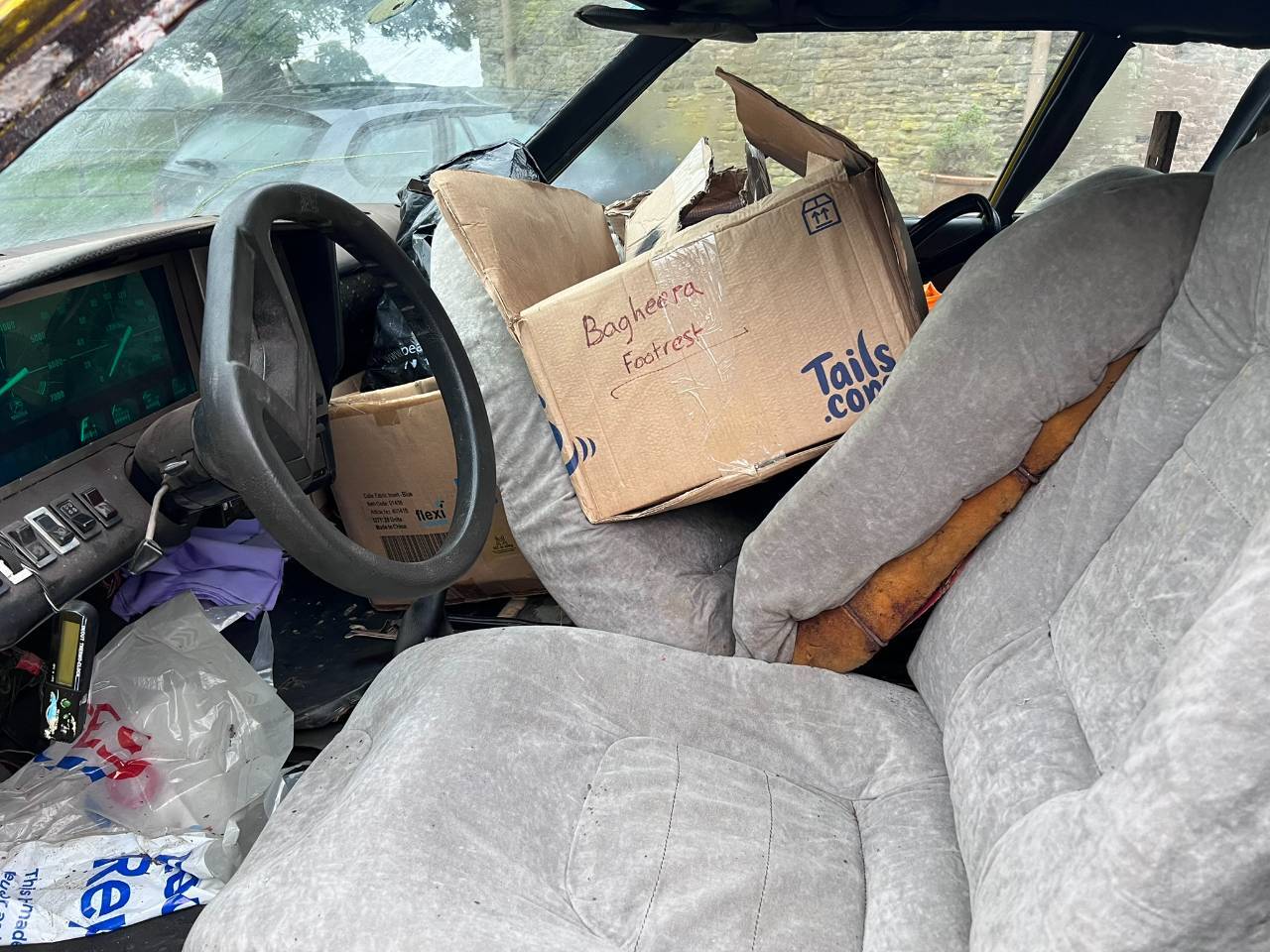

No idea on it's running state, it's obviously been sat for a long time but maybe ran a few years ago. It had an LPG conversion at some point, not sure what remnants of that are still about other than the tank guage under the dash
Interior is slightly mouldy in places, but is complete. A lot of the other missing parts are stashed in here.
For now it's just being stored until I can get to them, the priority is to get the Lotus finished*, then put a lot of work into the Metro and Lancia over the winter.
