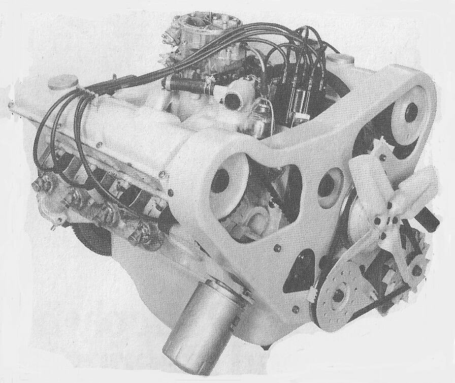

There were plans to put a V8 into the FE series but the 1973 oil crisis put a halt to that.

@Rocket88  that would have been amazing. I'll dig out the link but Vauxhall had a raft if 4 6 and 8 cylinders planned that got shelved. Tho.. even in it's out if tune state this one  has a fair amount if pep and if the gravel marks  in the tarmac acces road behind my garage are indicative probably has an LSD fitted (2 scrapey stripes not one)
