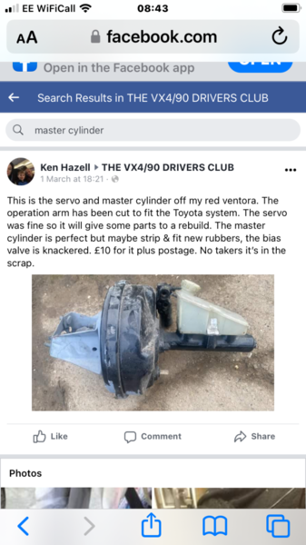

Ref brakes…… there’s a conversion that’s being done by a few of us with these using a Toyota master cylinder with improves them beyond belief…….

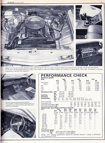

Sorry, it's not VX4/90 but it's interesting if you haven't seen it before. We've seen this road test elsewhere (thanks Trigger) and I think someone mentioned what happened to the car, but I don't remember the outcome.  I think it was stripped for parts.  Two were built.
(Text is blurry but click on the pic).  Note position of gearstick.
Fuel consumption, -  standard Ventora  20.8mpg / Black Prince V8 13.0mpg.  Ouch.  Bet it sounded lovely though.
Roadtest is dated June 1972 so any further conversions would have been on the FE Ventora.  (Unless they bought a stock of the outgoing FD Ventoras at bargain prices).  The newer FE Ventoras were around £2000 when introduced in 1972, a new Granada GXL was around £2300.
