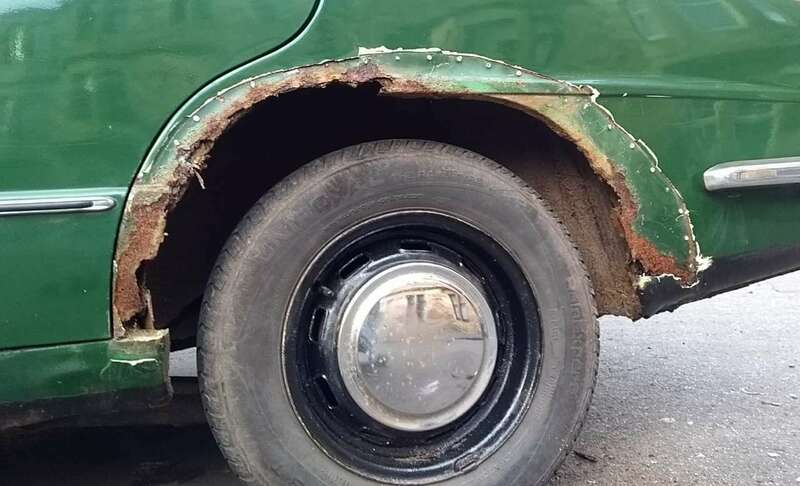

Started on the rear arches.
It's never good when you hit something with a hammer and it does this.
Or you find screws under the filler.
Or another arch panel under the one you just took off.
Oh look.
Rust.
I've been cutting the arches out by cutting through both the repair panel and the car, so that the repair sections will fit neatly.

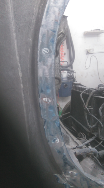

This is the bit where I wish I had some metalworking tools.  Fixing the inner rear arch is a pain as it's a nightmare to actually fit your head in the space and weld it up. I decided the best way to start would be to make the most difficult part on the bench.
This fits inside the outer arch panel.
It then means I have a structure that I can weld to, and the parts will just be simple patches rather than trying to make a complex bit fit.
3 more of those.
Those then get plug welded to the outer arch panels and the slits welded shut.

While working on the rear arches I was plodding along, whistling an inane tune, thinking, hey this isn't going as badly as I thought it would.
Then I put primer over it and thought fucking hell.
So here's the driver's side welded up and flattened down.
Bit of filler. Frankly, these repair sections are pretty shite. They do not fit well in the slightest and need a lot of bending and cutting to even fit in the space they are supposed to.
I don't know, the picture doesn't really convey the lumps and bumps, but I'm going to need to put a lot more work into this.  Thankfully at this moment in time I don't really give a shit, and I'm likely to run the car looking like a complete heap for some time until I get all the kit I need to fill and flatten things properly. At that point in time it's going to be a full paint job so it's quite a way off.
Here's the other side welded in.
Flattened.
This turned out a little worse than the other side actually, but I think on the whole it just needs going over with the flap disc again, and a bit more filler on the low spots.
The important thing I guess is that it's all metal now.
