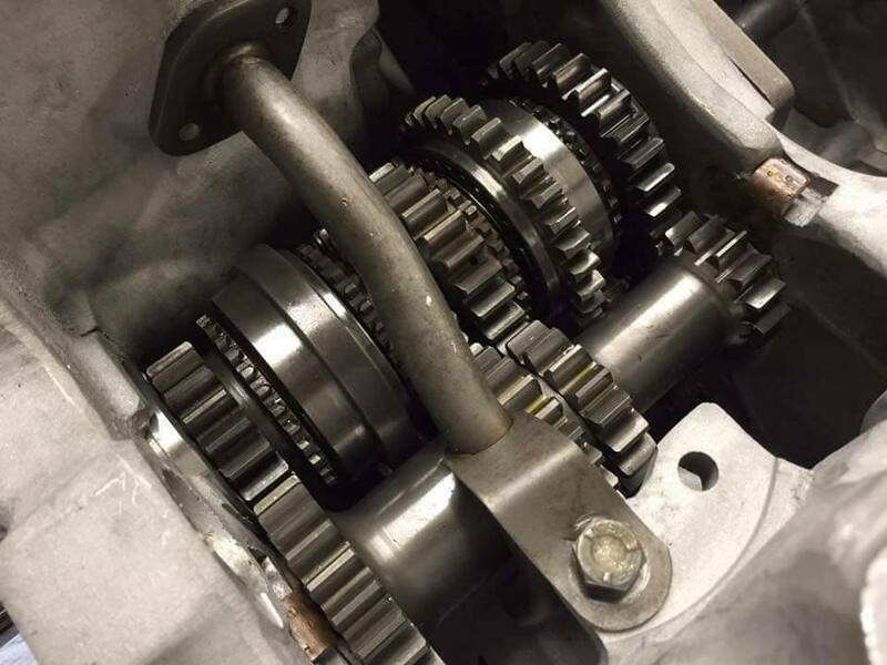

I suppose the killer bit is the engine itself! It's a 1293cc overbore from a Metro Turbo. Forged pistons, standard rods and crank but running a modified centre bearing cap. Lightweight steel flywheel with a twin spring clutch to take the torque. Gearbox is a straight cut gear set but with helical drop gears. In simple terms it has classic straight cut whine in 1st, 2nd and 3rd but 4th gear is direct drive from the drop gears and therefore entirely helical and quiet. It's a compromise considering the power it runs but I do drive to a lot of shows and am already pretty deaf without making it worse.
