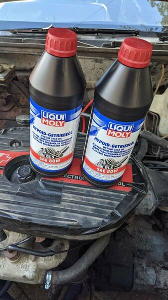

Two litres of fresh SAE 80 hypoid gear oil. I even went for the good stuff!
