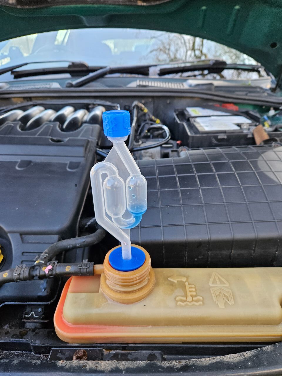

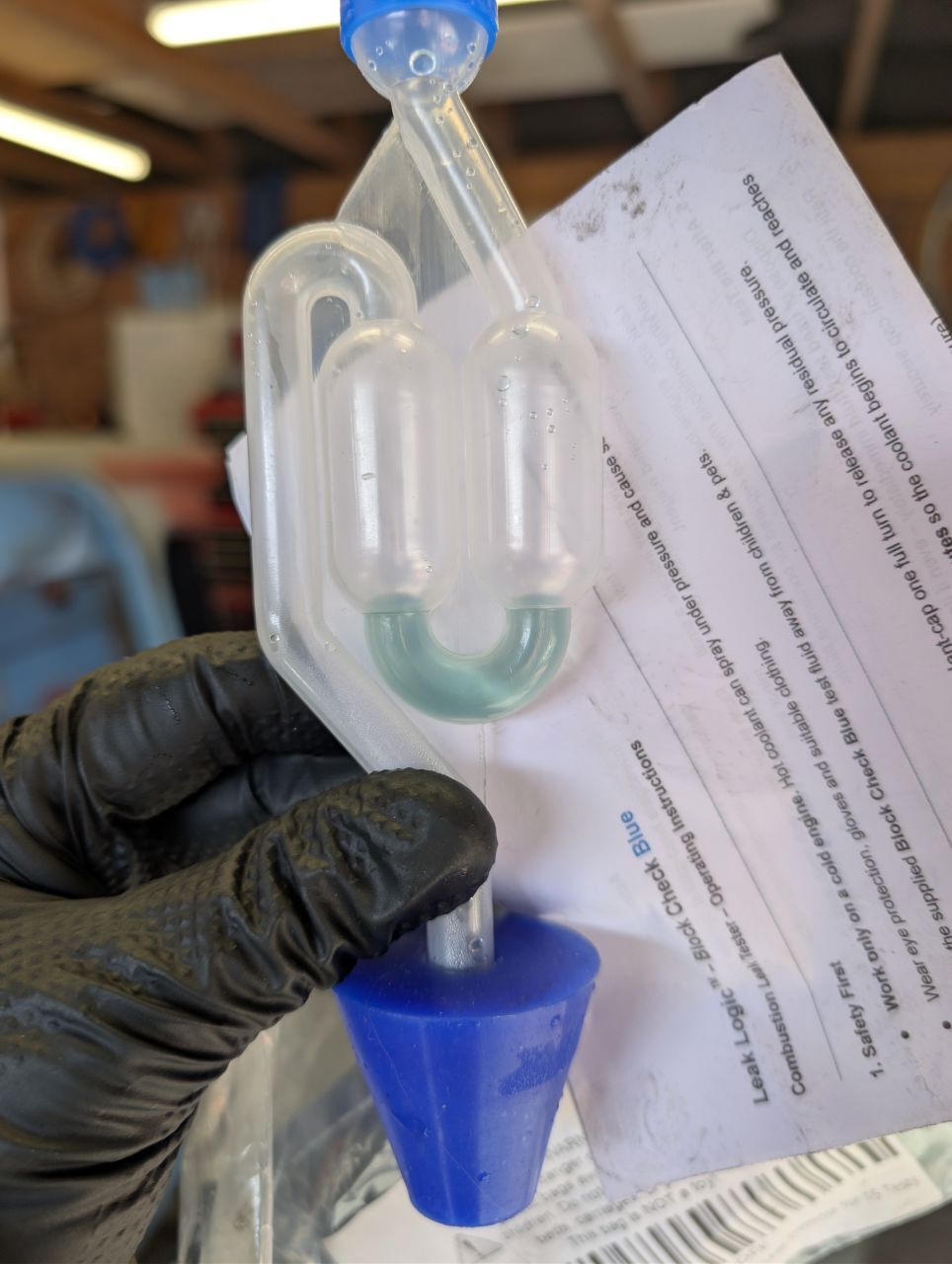

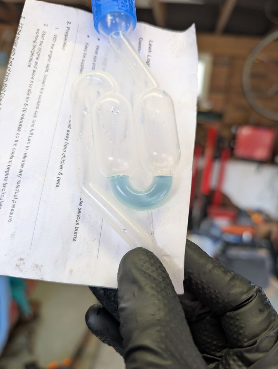

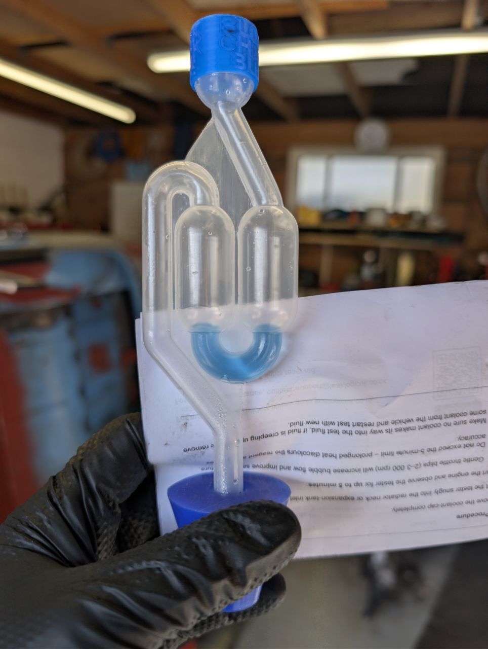

Crackers Posted February 15 Author Posted February 15 HGF? Dunno m8. Fluid Was meant to turn yellow if it's got combustion gas in it. The instructions sheet says "Green = Inconclusive", so that's brilliant. Lost several litres of water running it with the cap off (don't how normal that is?) but according to the digital readout on the dash, it never got hotter than 93deg. Didn't notice the cooling fans come on although I wasn't really paying attention as I was on the phone. Definitely didn't overheat. Might try a new coolant cap before any more drastic measures. Notice how clean it looks? My mate waxed it for me and it looks amazing now. To counteract that, the headliner fell down. Fucking cars. Rust Collector, Split_Pin, Westbay and 3 others 1 5

SiC Posted February 16 Posted February 16 21 hours ago, Crackers said: The instructions sheet says "Green = Inconclusive", so that's brilliant. I kept getting this on the Astra H that I fixed this weekend. That had boiled over at least 6 times (she admitted that it was actually far more than that). After I fixed the fault (thermostat jammed shut) and replaced the cap which broke, it's done ~35 miles fault free. She's now going down to Cornwall in it, so we'll see if it's still consuming coolant. How long are you doing the test for? My instructions say an absolute maximum of 5 minutes as the heat from the coolant will affect the test result colour. I did the test three times (actually four but one I had it too hot and it boiled all it's coolant out) and got the same result. New fluid for colour comparison under the light I was taking photos in. Results This last one I kept religiously to the instructions and stop the test in just under 4mins. To me this is still the most blue. Looks to be a similar result you are getting? Maybe not all lost and at least not yellow. 21 hours ago, Crackers said: Lost several litres of water running it with the cap off (don't how normal that is?) but according to the digital readout on the dash, it never got hotter than 93deg. You'll get evaporation when the coolant is that hot with no cap on. Sounds a fair bit more than just evaporation though. I assume it's not pissing out anywhere else? Had a Golf Mk5 GTI with a thermostat peeing out onto the hot exhaust which instantly evaporated it and the engine fans blowing didn't make it obvious. 21 hours ago, Crackers said: Might try a new coolant cap before any more drastic measures Definitely try that. Just to check, I assume it's not fallen apart inside? Again on that Astra H it had and so wasn't holding a pressure. With a thermostat opening temperature of 105c, that car will always boil over without a working cap. Crackers and N Dentressangle 2

Crackers Posted February 16 Author Posted February 16 9 hours ago, SiC said: How long are you doing the test for? My instructions say an absolute maximum of 5 minutes as the heat from the coolant will affect the test result colour. I did the test three times (actually four but one I had it too hot and it boiled all it's coolant out) and got the same result. Yup, about the same, I had to take it out the tank a couple of times as the coolant started creeping into the tube, but wouldn't have been more than 5 mins total. I've ordered a new cap today, for the sake of £15 it's worth a try as it didn't exhibit more HGF symptoms when I was looking on Saturday. SiC and N Dentressangle 2
ruffgeezer Posted February 16 Posted February 16 If that is a cheap block testing kit, be very wary of trusting it. I've known a place diagnosed a headmaster using one, but then test 3 or 4 other cars on the forecourt all of which showed failure too - and no, it wasn't a Rocer specialist!

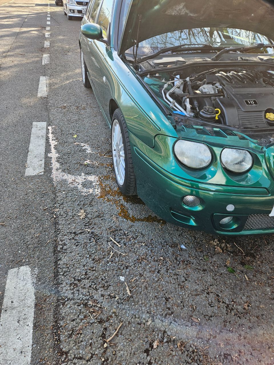

Talbot Posted February 16 Posted February 16 On 15/02/2026 at 11:11, Crackers said: Lost several litres of water running it with the cap off (don't how normal that is?) but according to the digital readout on the dash, it never got hotter than 93deg. It's not normal at all. I've regularly run cars with the pressure cap loose/removed as there has been a small leak somewhere, and allowing the coolant to pressurise means it jets out rather than just weeping. Even with a weepy leak somewhere, with no pressure in the system and the cap missing, you'd expect to lose a little bit of coolant. Maybe a litre for every thousand miles driven. I've been running the C6 like this for a while as it had a split in the de-aeration chamber, meaning if you pressurise the system, it all leaks out. But with the pressure cap off, it's a mere dribble. So, the fact that you lost several litres while running with the cap off for such a short time suggests heavily that you have a leak somewhere. A big one too. If you have bought a new cap, a lovely test to do is get the old one, drill out a hole in it, and connect it up to a compressor. Put 15psi into the top of the header tank on a cold engine, and see what happens. it will be one of several options: You immediately spot a big leak coming out from somewhere obvious. You spot a leak that would normally be onto something hot, so it's less obvious. You pour a load of coolant into the exhaust manifold : A split EGR cooler is the issue here. You hyrdolock a cylinder : HGF mate. You notice a weep from a spot on the engine: Either a split/corroded core plug, or something has gone porous. The coolant level stays solid for several hours: No issues. Or at least no issue that happens when the engine is cold. It's a very powerful test. Which if you need assistance to run, I'd of course be glad to assist! N Dentressangle, scdan4, artdjones and 2 others 5
Crackers Posted February 16 Author Posted February 16 21 minutes ago, Talbot said: So, the fact that you lost several litres while running with the cap off for such a short time suggests heavily that you have a leak somewhere. A big one too. OK, now I'm home I can upload a vid, the coolant does not appear to be coming out anywhere other than here. Engine wasn't overly hot when this clip was filmed but the behaviour is more or less the same from cold to operating temp. This is one of the things that suggests to me that a cap won't miraculously make the problem go away. If its run with the cap on, when taking the cap off after it cools down there is a bit of pressure behind it but not masses. With the tester in the hole, there's a bit of gas bubbling through the fluid, but not a huge amount. Doesn't seem enough to push so much water out as shown in the video. I've not experienced this sort of thing before as obviously all my previous cars have been perfect* and faultless*.
SiC Posted February 16 Posted February 16 Are these prone to air locks when bleeding? I tend to vacuum fill coolant systems nowadays. Bought a kit for £60 off Amazon that also has a pressure test pump. Perfect for testing to see if a system holds pressure and also makes filling quick+easy. If it's only bubbling out when hot, I'd strongly think it's not HGF as that should be doing it all the time given an engine is a pump. But never say never with cars I've learnt over the years 🙃 How strong is the coolant now? Again that Astra H would boil over at 100c when it was effectively straight water (as topped up so many times) as obviously that's the boiling point of water which is a lot lower than mixed coolant would be. Evaporation will be more with straight water versus mixed coolant. Also far more likely hot spots that bubble out inside the cooling system if not under pressure.
SiC Posted February 16 Posted February 16 14 minutes ago, Crackers said: OK, now I'm home I can upload a vid, the coolant does not appear to be coming out anywhere other than here. Engine wasn't overly hot when this clip was filmed but the behaviour is more or less the same from cold to operating temp. This is one of the things that suggests to me that a cap won't miraculously make the problem go away. If its run with the cap on, when taking the cap off after it cools down there is a bit of pressure behind it but not masses. With the tester in the hole, there's a bit of gas bubbling through the fluid, but not a huge amount. Doesn't seem enough to push so much water out as shown in the video. I've not experienced this sort of thing before as obviously all my previous cars have been perfect* and faultless*. To me that looks just as likely an air lock. Googling suggests the KV6 can be a bastard to bleed and is air lock prone with special bleeding procedures. (Or nowadays use a vacuum fill as they're far more affordable than they used to be) I'd be interested to see what others think. N Dentressangle 1
SiC Posted February 16 Posted February 16 Googling suggests the KV6 can be a bastard to bleed and is air lock prone with special bleeding procedures. Christ... Secondly, with a KV6 you must follow the MGR procedure for refilling as follows: - Apply Loctite 242 to first three threads of cylinder block drain plug. Tighten to 20 Nm. - Remove bleed screw from radiator bottom hose. - Remove bolt securing expansion tank and raise as high as possible (approx. 125 mm). - Fill cooling system keeping level at expansion tank neck until a steady stream of coolant is emitted from bleed screw hole. Fit and tighten bleed screw. - Continue to fill expansion tank until level reaches neck and remains static. Refit tank to body, tightening bolt to 5 Nm. - Press 'Econ' button to switch air conditioning off [this is to prevent the radiator fan from running continuously]. - With expansion tank cap off run engine at 1,500 - 2,500 rpm, filling as necessary to keep coolant level just below expansion tank neck. When level starts to rise, fit cap. - Continue running engine at same speed until the radiator fan starts, then reduce to idle until it stops. [in practice this may not be achievable, in which case establish that the engine has reached above 90° by activating the IPK diagnostics.) - Allow the engine to cool for at least 30 minutes and top up the expansion tank no higher than the 'Max' marker. If this is not visible, remove coolant until it is. [in practice, topping-up will be necessary three or four times after a journey.] You'll need at least 7.5 litres of coolant. They're also apparently prone to leaking between the V - which I imagine will be hard to spot. mercedade, Brigsy and Crackers 3

N Dentressangle Posted February 16 Posted February 16 1 hour ago, SiC said: To me that looks just as likely an air lock. Googling suggests the KV6 can be a bastard to bleed and is air lock prone with special bleeding procedures. (Or nowadays use a vacuum fill as they're far more affordable than they used to be) I'd be interested to see what others think. I agree - that looks like fairly normal water pump 'surge' to me and possibly an air lock somewhere in the system. The bad HGF I've seen had bubbles coming up through the tank and a jet of bubbling water shot out when revved! 🤣 That was a P38 V8 with a badly blown HG at any rate. My 924 did this thing when you switched off it would bubble and boil up, and spit a load of water out of the expansion tank pressure release. Had me slightly worried, but a new pressure cap fixed the problem completely. So it is possible. SiC 1
Split_Pin Posted February 16 Posted February 16 I agree theres no bubbles in that, its being purged out somehow. KV6 is a indeed a twat to bleed, the diesel just as much but as they run cool you can go for a bumpy drive and run the gauntlet against the temperature in diagnostic mode 😂 As said above there's a procedure for bleeding it. This is exactly the point in 75 / ZT ownership at which you either stay on the light side and get rid of it or come over to the dark side and actually enjoy the misery 😂 N Dentressangle 1
