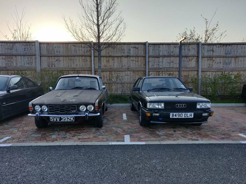

Crackers Posted April 16, 2021 Author Posted April 16, 2021 A lovely drive over to a classic specialist this afternoon, I'm leaving it with them for a few days to give it a proper inspection on a ramp and assess the situation regarding the few issues I'm having with it. If their repair quote is not too ridiculous I'll have them do the work as I'm lazy and I would almost certainly make a mess of it anyway because I'm an idiot. Forgot to take a picture as I was in a hurry and also managed to park it in a stupid place so the photo would've been crap anyway. I did, however, take it to work today for a change, and agreed with a colleague to bring his rather lovely classic in too. Annoying the photo opportunity was ruined by the seagull that took the liberty of leaving an ENORMOUS deposit on my bonnet 🤬 so this will be repeated soon when the car is both fixed, and cleaned. gadgetgricey, Shite Ron, crad and 11 others 14
Mrs6C Posted April 16, 2021 Posted April 16, 2021 39 minutes ago, Crackers said: I did, however, take it to work today for a change, and agreed with a colleague to bring his rather lovely classic in too. Is that an E46 M3 coupe to the left as well? Not many E46 coupes around these days either, especially nice examples...
Crackers Posted April 16, 2021 Author Posted April 16, 2021 Just now, Mrs6C said: Is that an E46 M3 coupe to the left as well? Not many E46 coupes around these days either, especially nice examples... No, it wasn't an M3. To be honest I didn't have a look at what it was, but it might have been a 330Ci Clubsport. There's lots of older modified BMWs in the car park so it could be anything really, if I see it again I'll have a look. There is a bona fide E46 M3 in blue there from time to time which is very very tasty. I should really take some photos of the stuff around the various car parks - there's all sorts - although I'm not sure how well that would go down if they found out. Mrs6C 1
