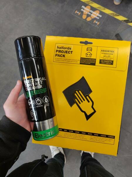

Broadsword Posted March 27, 2021 Posted March 27, 2021 Those don’t look great, not terrible either. Try rubbing them clean with emory cloth and see if that makes a difference. Love the car by the way. Crackers 1
Crackers Posted March 27, 2021 Author Posted March 27, 2021 "Where did I put that contact cleaner when I moved down here?" I didn't bring it with me it's 50 miles away. Cue Halfrauds trip: Broadsword, Six-cylinder, louiepj and 1 other 4

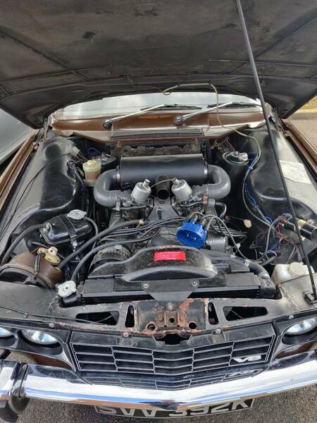

Crackers Posted March 27, 2021 Author Posted March 27, 2021 Haven't tried starting it yet having cleaned the Dizzy, but I've just found something which I need some opinions on, and could definitely be causing the poor starting but perfect running! I'm trying to upload a video at the minute, but in words I can describe this: Pulling the choke cable pulls the cable through down to the carb, but no linkages move on the carbs themselves, it's like either the cable has too much slack or isn't attached on one end. It also doesn't move the throttle which I believe should happen with the choke on these. Pulling the cable at the carb-end seems to move things nicely, so I'll see if I can adjust the cable. Edit: here's the video. This is two operations of the choke to its full extent, followed by a couple of pumps of throttle so you can see which bits move.
Crackers Posted March 27, 2021 Author Posted March 27, 2021 Right, so, I'm 99% that my starting problems are caused by this choke cable doing the sum total of nothing. Trouble is, I can't figure out how to fix it? The lever on the dash pulls in and out nicely. At the other end, there's no movement. The cable attached to the carb doesn't look like it's slipped, but the cable sleeve visibly moved when I pulled the lever (as seen on the video) while the cable itself barely gained any tension when pulled, which suggests to me one of two things. Either: - The cable has stretched internally and no longer has enough rigidity to push/pull itself back off the carb body. or, - The cable has come un-anchored from inside the dashboard and is therefore just pushing the sleeve in and out, therefore causing no movement of the internal cable. I will go back out in a bit to try and get a picture inside the dashboard of the choke cable mounting, as I can't get my head in there to look... LightBulbFun, crad, Twiggy and 1 other 4
