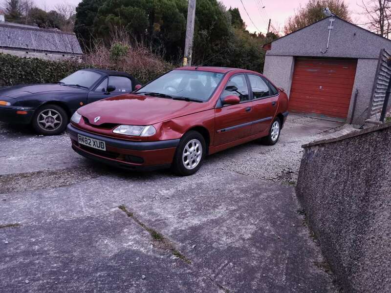

Choice of conveyance after the Laguna decided to shit a wheel bearing
Chod spotted at Exeter
PC: 1 hurried along by coffee.
Sent from my VOG-L09 using Tapatalk
Shat a wheel bearing or ignored for the last 3 months cos local ?
Surprisingly, the latter. First heard it when getting dropped off for Good Thursday.

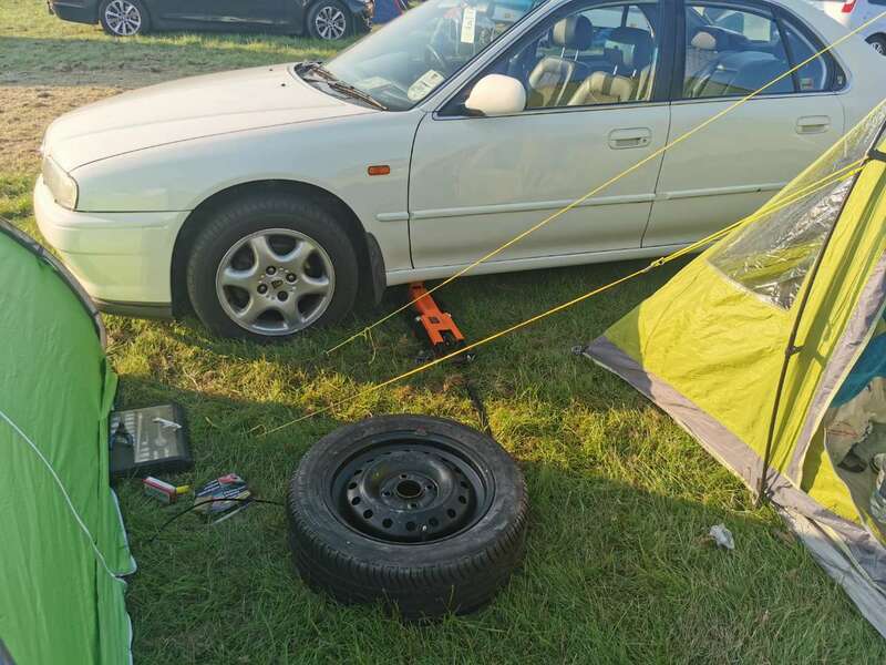

Motor de-boned prior to heading home
Filled both motors and hit the road

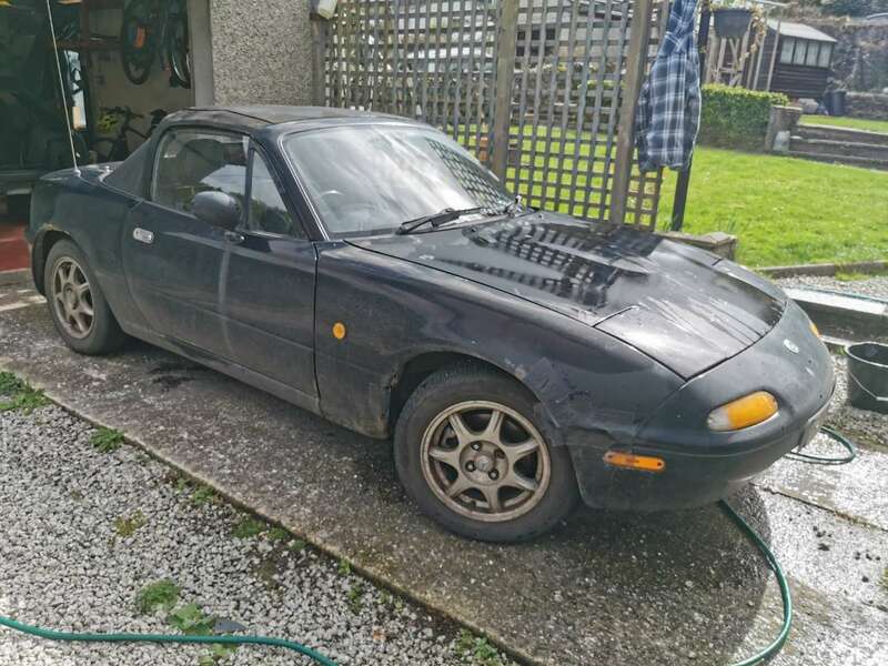

There were a couple of days of no rain, which was enough incentive to take the hard top off the Mazda. Absolutely needed a wash there as despite the torrents of rain we had over the winter, Cornwall is still on a hosepipe ban.
IMG_20230305_123132.thumb.jpg.887fdc090839f161cde5861d266f6dbe.jpgIMG_20230305_123500.thumb.jpg.fb073677e347bce17779986be520babd.jpg

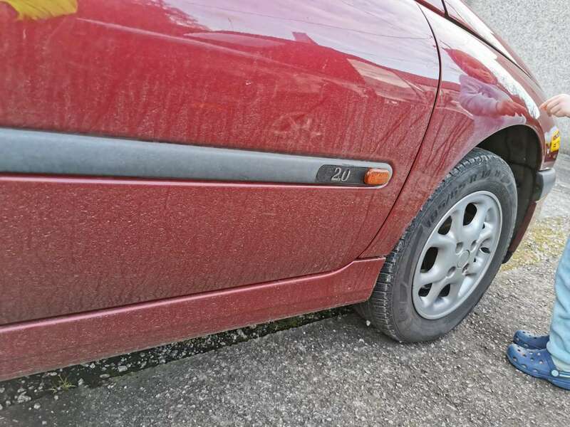

Speaking of grubby motors, the Laguna was beyond filthy, both inside and out:
IMG_20230305_124442.thumb.jpg.3c41bdb0a8da956b6f9d35f8010955fe.jpgIMG_20230305_124435.thumb.jpg.ed605ff98ddabd81cbf631ac4afdba6f.jpgIMG_20230305_124709.thumb.jpg.dd1e7e0f064036f3869b8bf759d9e880.jpgIMG_20230305_124459.thumb.jpg.4c3e79fdcb7b727a29430520a2c7ad7c.jpg
Some proper graft with a wash mitt and some of those wheel scrubby brushes brought out some decent results:

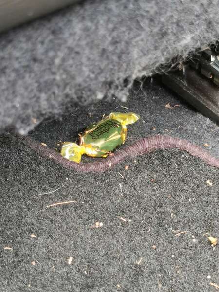

Forgot about this old phone! It was in the seat pocket. Finally binned it.

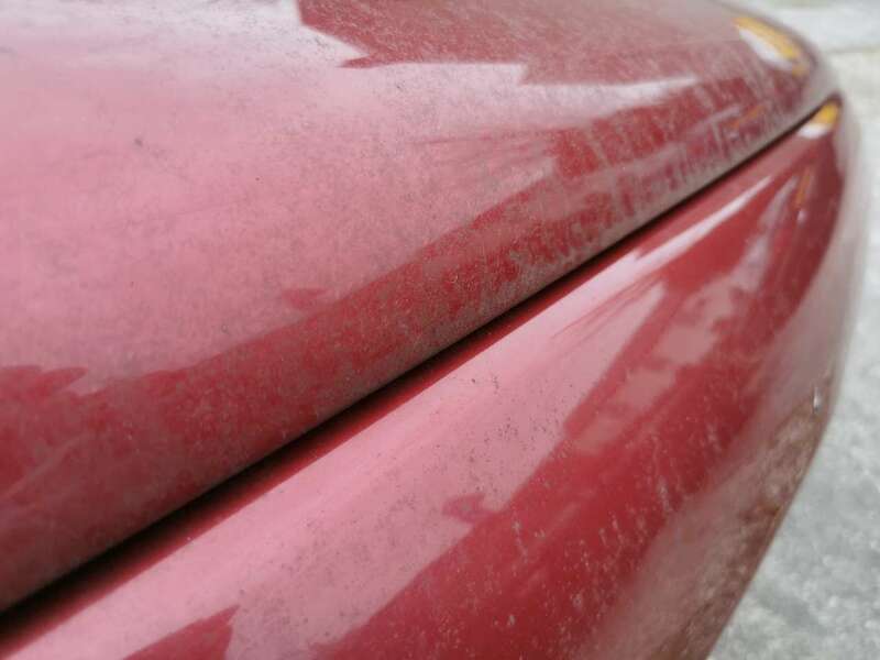

Naturally though, after one school run:
Needn't have bothered.

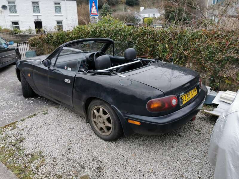

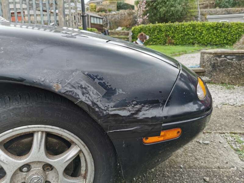

The Mazda was finally washed and had a looking over for the MOT the following month. It was absolutely gipping.
Took two full washes, but it came up all right. The tape covering the front wings was due its annual change though, so I whipped that off. The metal garden wire I used to secure the bumper had snapped too, so that needed replacing with a stronger type of wire.
IMG_20230324_164303.thumb.jpg.f74ebd0ee437815fcfcfbbf2664c4de1.jpgIMG_20230324_140727.thumb.jpg.51e83aa9add353bdfc980af7305cf270.jpg
Once the wire was re-applied, the tape went back on, and the car deemed ready for an MOT. New wings this year though, definitely.

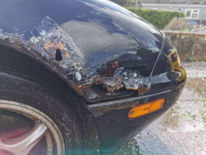

Finally, on the commute home one day, there was rather a large traffic jam. When I got to the front of it, I pulled over, as I recognised the person, and the car.
Yes, t'was my nemesis, the Fiesta. I had noticed it had kicked a wheel out of bed, in the same area I was working in a few months ago! Fearful I had fucked up when changing the driveshaft, I had a look in the afflicted area and felt exonerated.
Yep, the lower arm had snapped. Mercifully, that was the final push they needed to make the change, and the Fiesta was duly scrapped thereafter, replaced with a 2007 Civic diesel.

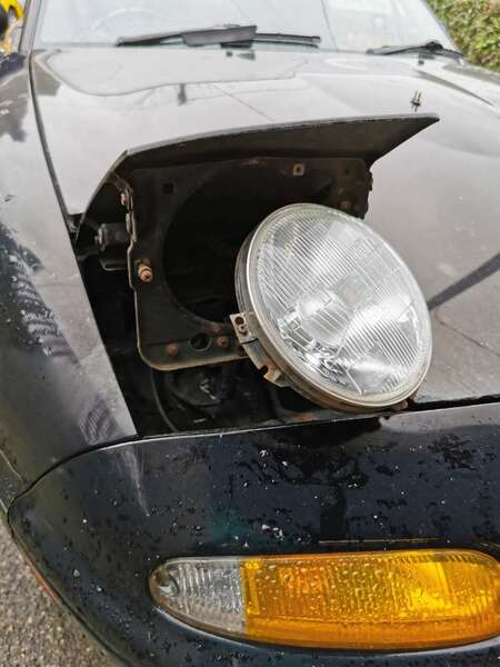

Straight into the headlight fault then. The edges of the beam were marked on the garage door and adjustment attempted, but you could feel something skipping within the threads, so it made sense to dismantle and investigate.
IMG_20230405_094346.thumb.jpg.3f1de0485078fdf9121a22e5c15dbf16.jpgIMG_20230405_093208.thumb.jpg.02b26e61d36eb5e680cc6afbf90d6c18.jpg

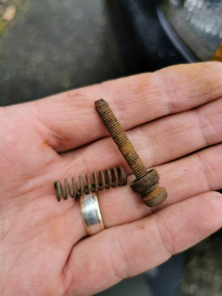

The threads on the adjusting screw were crusty, but otherwise solid, so were wirebrushed and greased up. This left the plastic barrel nut at fault. I had a scrap headlight frame assembly in the metal pile which was liberated from their precious  cargo. Once fitted, the headlight was adjusted to the original position, the lowered again slightly against the marks on the door:

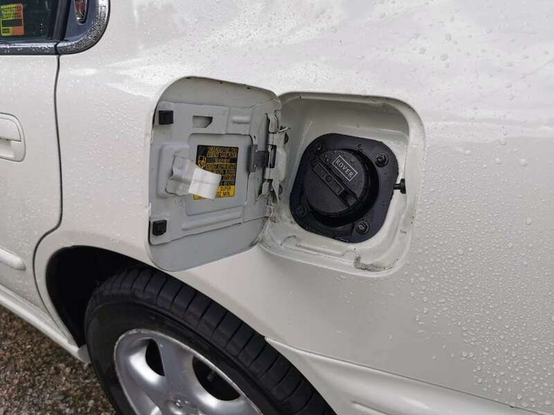

Love finding stuff like this in the service history 😀
Turns out it started life as a Rover Group manager's car!

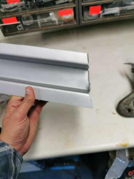

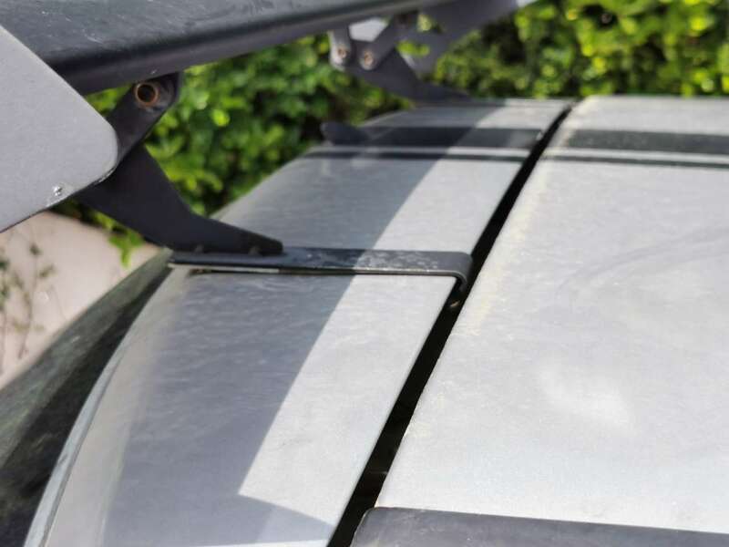

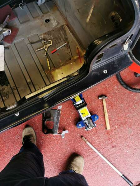

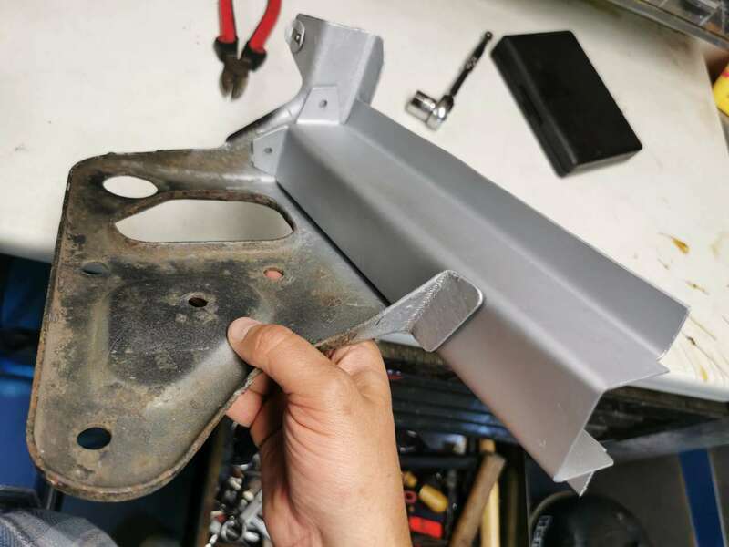

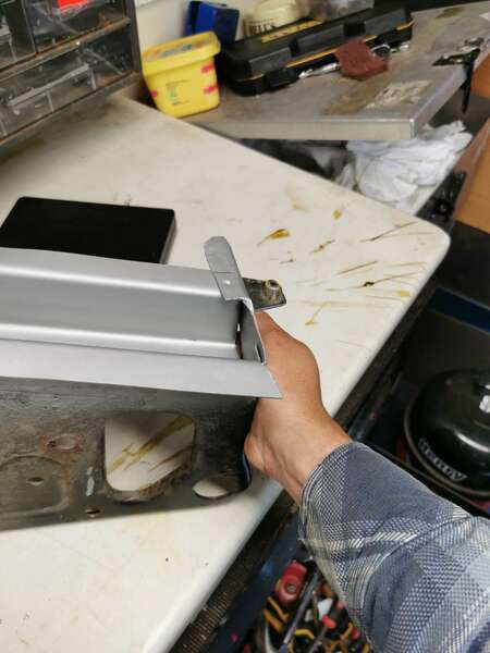

Finally had a  couple of hours free to further modify the chassis/boot reinforcement rail I had made the previous year.  A bit more bending, fettling and drilling produced this final effort:
This would allow the rail to meet the rear boot vertical closing panel at a slight angle, negating me having to find some way to induce a curve in the rail to match the original.
IMG_20230608_154754.thumb.jpg.0e7f79a48a4f8db953e5084753267066.jpg IMG_20230608_154807.thumb.jpg.8679b50269809f9dd96a64d81ee154c0.jpg
A 'step' was added to the top face of the rail, to allow it to sit flush with the existing metalwork at the top, and some spot weld holes drilled into the boot floor:
IMG_20230609_094346.thumb.jpg.fd68cce2d8b55275d5a2f54738284b4a.jpgIMG_20230609_101133.thumb.jpg.5ed6f692d73bf7aa6b28ef8c4ad53fdb.jpg
Once that was all done, there was nothing left to do than to clamp the rail to the existing bracket (very tight, to straighten the bracket) and weld it together.
IMG_20230609_111729.thumb.jpg.cf02b1cfcb40b4ffe2f8905bf48df646.jpgIMG_20230609_113731.thumb.jpg.f24509d07e39691ab6966d86e66f7c84.jpg
Now it's all prepared, it is an insert-interference fit into the existing rail and when I get some more free time, I'll get the surrounding metalwork prepped ready to weld in in permanently. Hopefully sooner than next year!

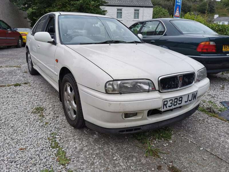

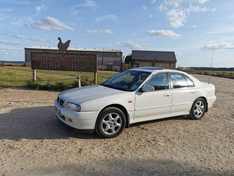

What a whirlwind three weeks this has been already!
I had a quick check of the paintwork when I got back from the collection and attacked a section of it with some cutting compound - this had little effect and I'll revisit this at some point. Very peculiar defect though, appears to be below the lacquer.
The day after, it went to it's first show as an exhibit, completely unprepared and unwashed. It did draw considerably more attention than I was expecting!
IMG_20230625_124852.thumb.jpg.8eba04166d6fff335758db3cb453bec4.jpg IMG_20230625_191424.thumb.jpg.30f9b794fbf71a0cd8850f19f0f5c1bd.jpg
And unlike the Beat, this had room for the entire family! My daughter finds the atmospheric dump valve PSSSHHHH'ing hilarious :mrgreen:

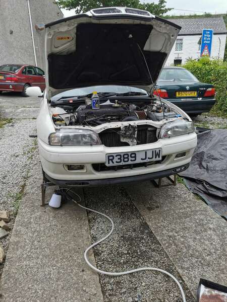

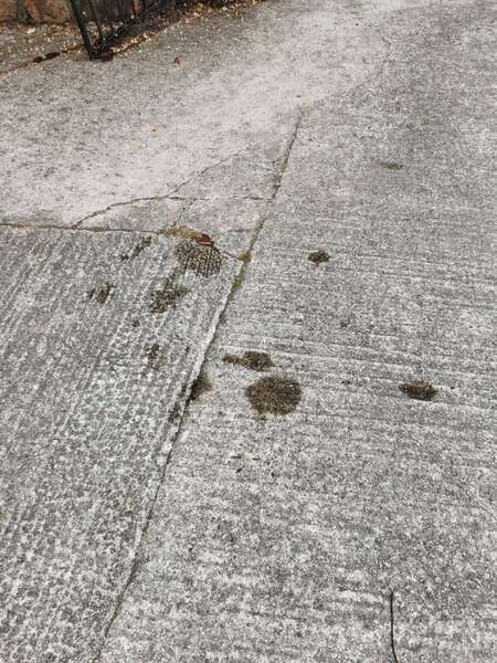

Didn't take long to find the cause:

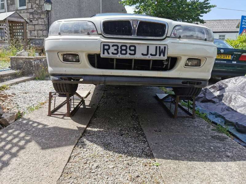

Yep, a power steering return line leak. So it was time to test out the ramps I acquired from FB marketplace and get on with a fix. Power steering return lines are NLA on 600's and pricey when good ones come up.
IMG_20230701_154317.thumb.jpg.89b3a6028afc23841f8cfbc730b66c2a.jpgIMG_20230701_154743.thumb.jpg.e6385766b0d6a9cbbbfe23fc9ab660ef.jpg
The bumper came off with minimal confusion and after a bit of faffing, the power steering return line was removed:
IMG_20230701_164056.thumb.jpg.a22de16ee43c05afc3a5f9dd415db700.jpgIMG_20230701_170349.thumb.jpg.6b4ae1f84641f5fa28522baa4f5752d0.jpg
Five seconds with a wire brush found the pinhole cause of the leak. A tale as old as time, and unfortunately my usual repair of self-amalgamating rubber tape and ty-wraps wasn't going to cut it this time.

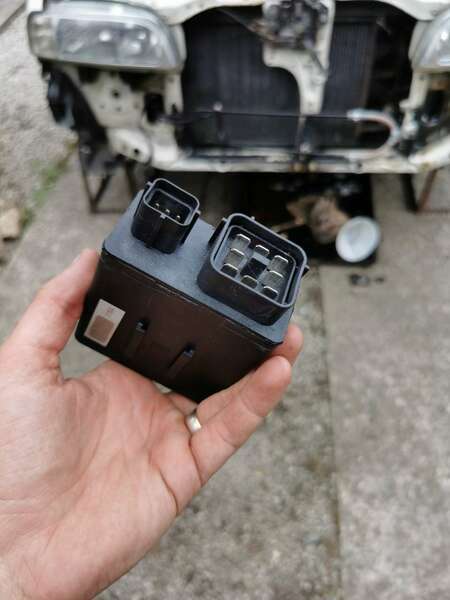

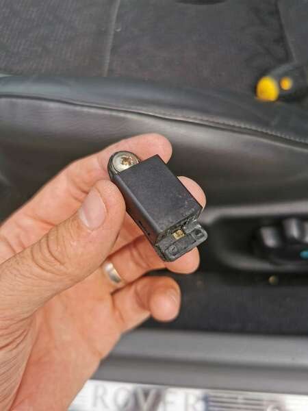

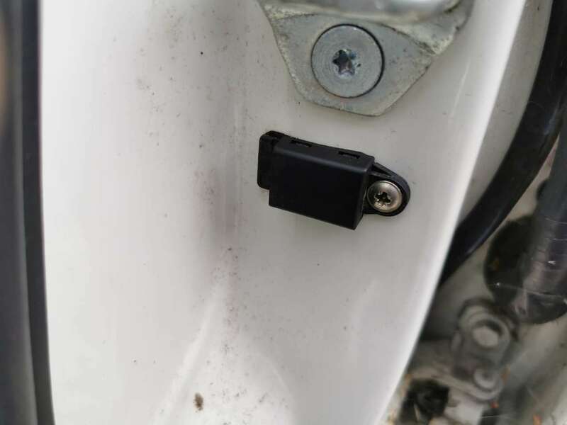

Found this weird box in the passenger doorcard - a quick ask of the 600 owners group told me it was a box holding several relays and that owners tend to keep a working spare in the car.

The lower intercooler hose clip had to be cut off when I removed the intercooler the day before, so a new one was sourced. Bit nervewracking trying to angle grind a jubilee clip off whilst in situ!
Whilst in the area, the brake and clutch fluid was flushed through and bled:

Other work carried out (but not photographed) was removing the washer jets and blasting them with HP air to clear a blockage, re-mounting the wonky third brake light and taking up some slack on the throttle cable.
With the intercooler pressure washed and refitted, the front underside brushed with used engine oil for rustproofing, and the engine ran/power steering system bled and successfully leak-checked, it was time to re-fit the front bumper. I elected to replace the forward plastic fixings, as they were clearly not the originals, and ineffective in their job.

The following morning at 0300, we were woken up by the sound of a car alarm going off in the village.
Assumed it was just somebody in the village, until it went off a second time and I looked outside and saw indicators flashing on my driveway. Oh dear.
This was quickly narrowed down do a faulty door open switch, which was already snapped when I got the car.
Whilst a new one is on order, the internal contacts were removed to prevent it from operating and setting the alarm off inadvertently, this meant I wouldn't risk losing the electrical connector in the door pillar.
 IMG_20230705_115809.thumb.jpg.055e4e67ccd79c9369101fca621e2dae.jpg  IMG_20230705_115928.thumb.jpg.532380aa374706f3fe440825ce8eb58c.jpg
I was more surprised that I didn't know it had an alarm until that night :lol:.

Unfortunately, as I was stretching the legs on the Rover down a dual carriageway about 10 miles from our destination, there came a thunk.
Shortly thereafter, there was a loud bang and my gearstick retreated downwards into the centre console, with sparks flying out of the back!
There was a layby about 1/4 mile away, so I sheepishly limped it up onto a kerb, and adopted the position, with all the passengers and Alex showing deep concern for what was happening.
IMG-20230706-WA0029.thumb.jpg.c139c0f7167b0eedb028588c6d51d73b.jpgIMG-20230706-WA0028.thumb.jpg.53c8ea8e50a8b124c328aa66ecfe9e9d.jpg
IMG-20230706-WA0027.thumb.jpg.b2156e594ba4b3093b5dab60c922ee50.jpgIMG-20230706-WA0031.thumb.jpg.0b0c07f021888d99d7ecc0f0e2043e28.jpg
Oh no wait, the other thing.
This was the sight that greeted me:
The bolt for the gearshifter steady rod had undone itself over time, fallen off and the rod twisted itself off the gearbox. Not ideal.
Luckily for the passengers, Alex had a stash of beers in the boot, so they cracked on whilst I cracked on with a temporary repair. The bolt had long since fucked off and I wasn't fancying doing a loost article search of a dual carriageway for some reason :lol:, so the rod was pushed back onto the gearbox and two tywraps were used to hold it in place.
Eventually, keeping off boost and taking our time, we eventually arrived onto the volunteers campsite.

Roll on this Friday - it's my turn to pick the boy up from school, and I decided last minute to take the  Rover to do the collection duties. I parked it about 1/4 mile away at the top of the hill behind another car, and a red Fiat immediately parked behind me. I bimbled down to grab the lad.
On the way up, I noticed a bit more traffic. Eventually, I noticed that traffic going up the hill were swerving to avoid an obstacle in the road.
My arse collapsed when I saw what the obstruction was:
THAT WASN'T WHERE I FUCKING LEFT IT. I told the boy to stick to the pavement and keep going uphill whilst I did big sprints to get the car out of the middle of the road.
First thing I did was check I wasn't being an idiot and leaving the handbrake off.
Thankfully I had applied it - I even went back to the car to grab a brolly before heading down to pick the boy up and there were no untoward creaks.
A quick inspection showed only minor damage.
I know, I know - I should have left it in gear, wheels turned etc, but I changed cars last minute (Herman is an auto) and I was in autopilot mode. No excuse really, but it never gave any indication of only being on slightly.
The front bumper is pushed in a bit, and the headlight protector is damaged, but this car is definitely fighting me at every opportunity.
However, this situation played itself off as good as it could be - the only damage was to my car - I'm extremely grateful that it didn't hit anyone else's car - or worse, especially given the length and slope of the hill. Definitely changing my parking habits from now on!
