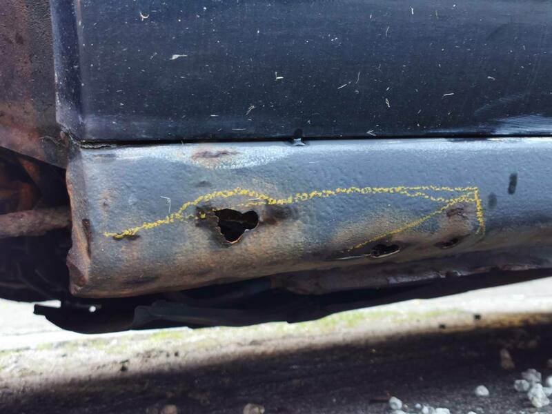

26 minutes ago, fatharris said:
Eagle eyed viewers will spot the yellow crayon markings.
At least this rusty Japanese car is black, so that the yellow markings stand out.
Not many photos as I was on a tight schedule but:
And now parked up at home.
Full inspection/write up to follow. It drives absolutely lovely but it's not without fault.

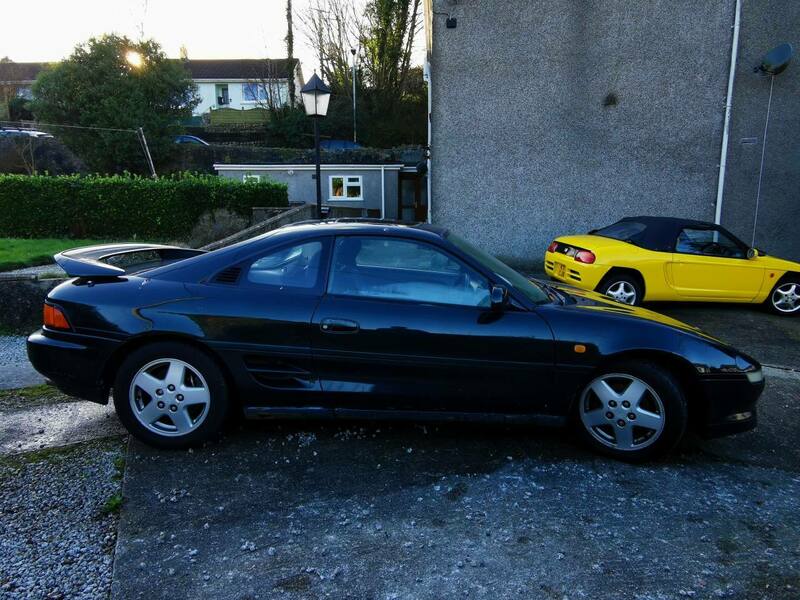

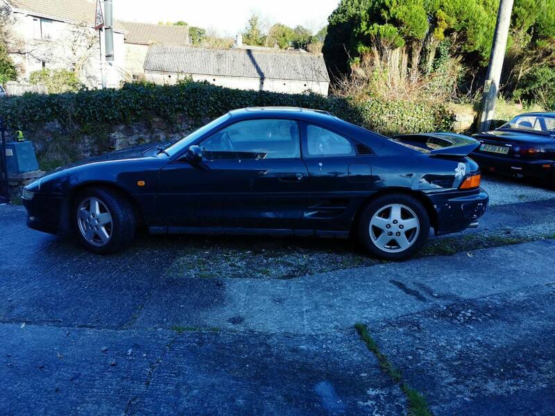

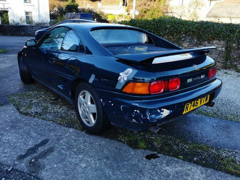

The car itself was a 1998 Toyota MR2 2.0GTi-16, with a sunroof instead of the targa top. Owned by my friend Joe for several years, he had gone through a few issues with this particular car over the years, notably the water pump shitting the bed, which necessitated an engine change, and more notably, the body modifications brought on by that old classic characteristic of the SW20 MR2 - snap oversteer. In this case, it was approx 25mph  at a roundabout. A hydraulic press was rudimentally used to roughly get the shape back, slapped on a new rear light and cracked on.
Sadly, an MOT failure for rust, coupled with a recent house move forced his hand and he wanted to scrap it. I intervened, a deal was made and I picked it up for scrap value, driving it back from Plymouth. I found it drove very nicely but wasn't without faults, notably the tacho needle would start dropping back down if the revs went about 2500rpm and the passenger central locking solenoid wouldn't operate.
The positives were the Toyo Proxes had loads of meat all round, the replacement engine had a recent timing belt and water pump, and the interior was exceptionally tidy.

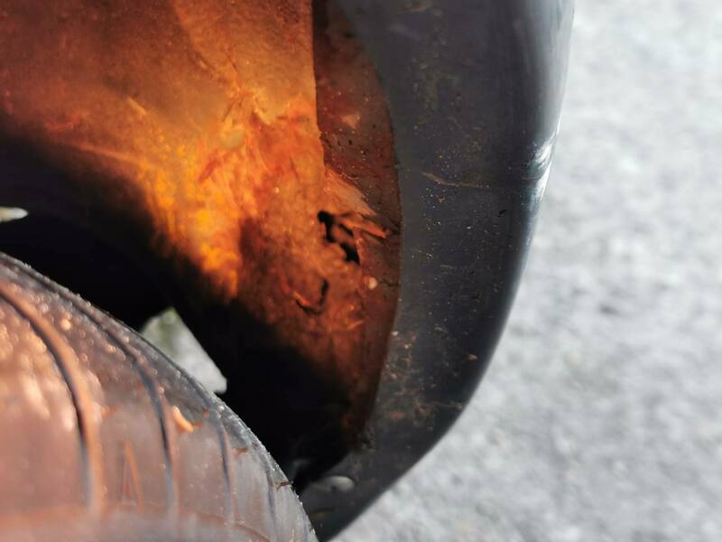

I took loads of photos of the rot, and bought some steel.

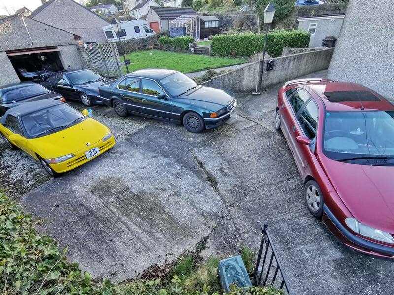

Completed the driveway shuffle too:
Too many key bundles to move the cars around.
Sadly, I then had a rare bout of sensibility and realised a married father of two does not require a third Japanese two-seater car. I put the car up for sale on Facebook for £1200, endured enquiries from a vast number of fuckwits expecting a concours vehicle, before selling it to a shipmate for £600 who is planning to restore it. I sent some of the proceeds back to my mate Joe to put towards either a new car or some new appliances in his home. He chose a vacuum cleaner 😂
So, we were back down to a much more manageable 5 car fleet, but I didn't fancy working on the BX for a while.

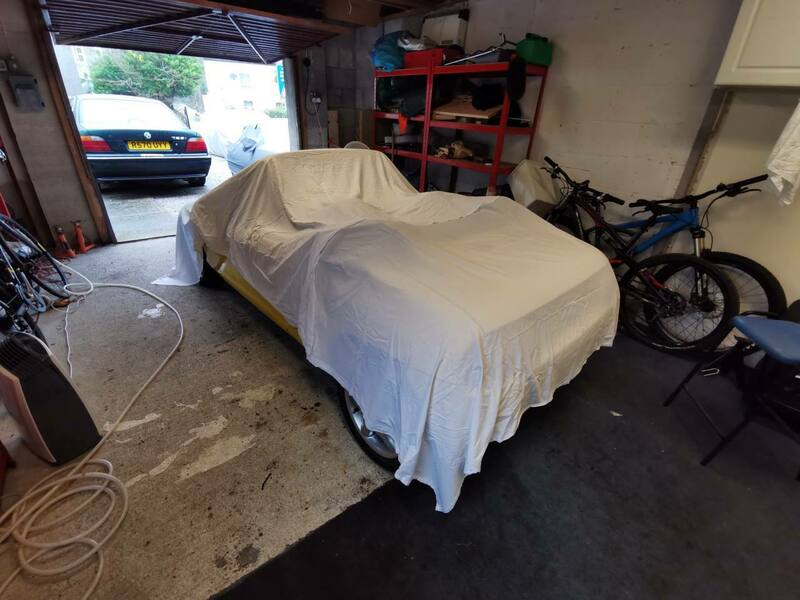

The Beat was washed and parked in the garage overnight with a dehumidifier going to dry it out thoroughly:

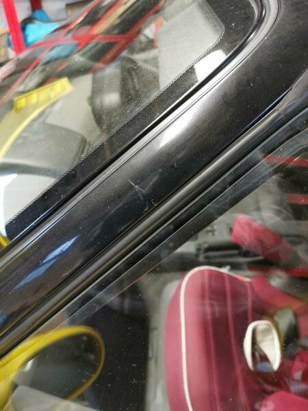

A small section of black vinyl missing from the windscreen pillar?
EASY! Just get a Sharpie 😂

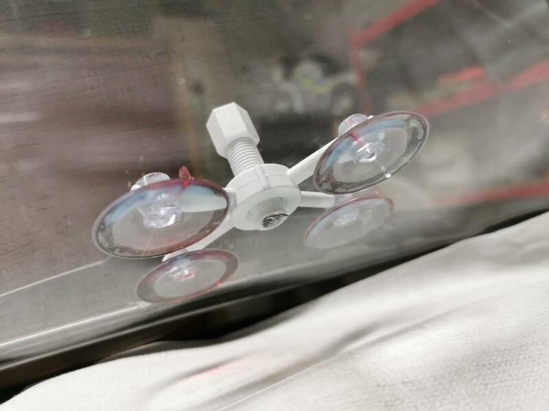

Next up was using this absolutely cracking tool:
Crammed myself into an awkward position (Did not want to take the roof off!)

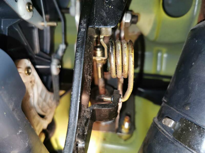

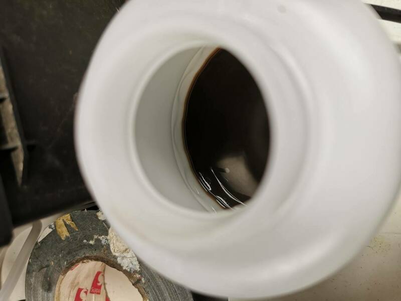

And did a full clutch fluid flush and change (was like muddy water in there!)
The biting point still wasn't what I was expected or wanted, so I adjusted the clutch cylinder rod at the pedal:
It's still not perfect and I think the  fix would be a replacement master cylinder, but I'll keep at it.

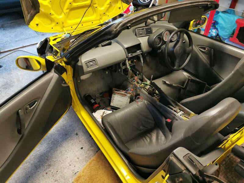

Either way, that evening, we were left with this:

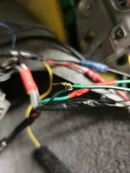

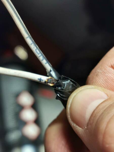

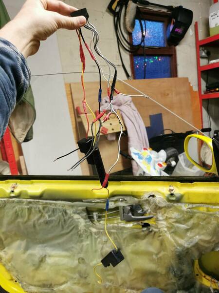

It doesn't take a blind man to notice there is a LOT of red on that stereo loom, and you'd be correct - this has been completely butchered:
Red tape hiding a whole multitude of sins:
Even black tape hiding - can you guess?
Wrong! It was somehow worse.
Clearly, there was going to be no real way to save this loom, nor would I want to as there's nothing good about it.
Whipped it all out at the handily inserted chocblock connectors and yeeted the entire lot into the bin:

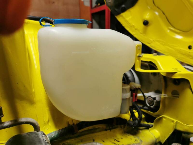

Such as with this dirty, lumpy washer bottle.
Bit of scrubbing and it came up very nicely.
Co-incided nicely with replacing the windscreen washer pipes.

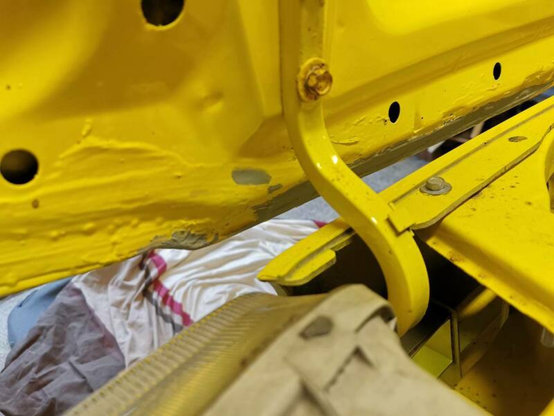

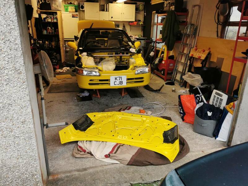

After the inital wash of the Beat, there were traces of rusty water leaving the bonnet. The bonnet was repaired as it was completely rotten and repainted - although paint can't get everywhere as this little orange giveaway shows.
So, I applied an entire can of cavity wax to the internal skin of the bonnet, propped it up and let it dry, leaving the front end draped in bin bags to protect from run off.
In order to speed up the drying process, in the evenings a bedsheet was draped over the bonnet area and a dehumidifier placed in the spare wheel well. Worked quite well.
Once dried, seam sealer was applied to any areas of the bonnet underside with orange bits, showing either rusty water or wax has seeped out. Will paint at some point.

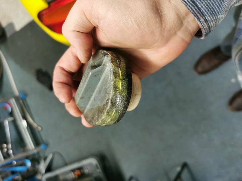

Not everything cleaned up nicely. This fuel cap was not getting any better!

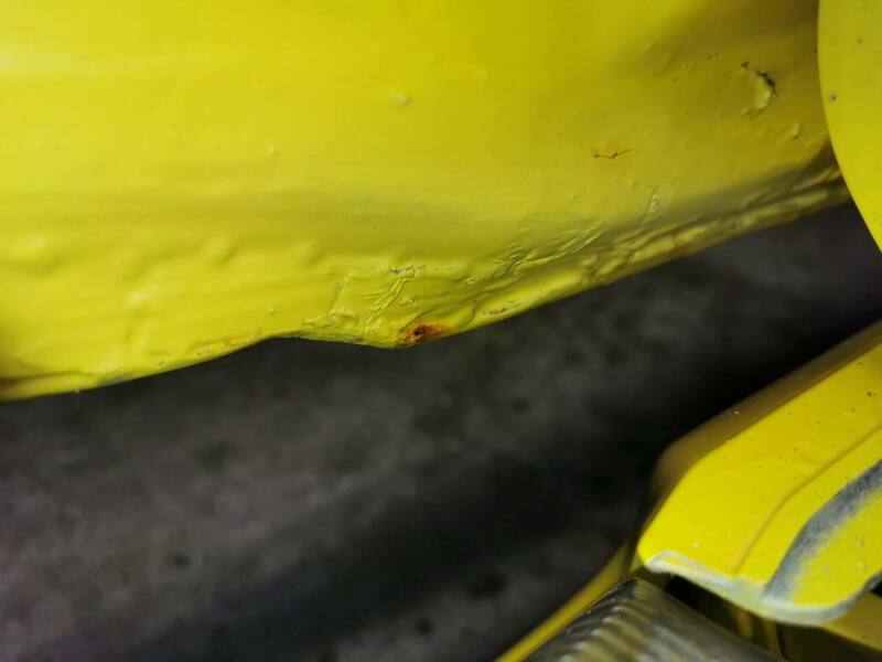

With the car up as high as it'll go on axle stands:
There was evidence of surface corrosion in some of the crevices where the bitumen stuff hadn't quite reached. The areas I wanted to work on were the front and rear inner arches, the floorpans and the inner sills where it meets the floorpan, plus any other bits encountered along the way.
There aren't many photos of this because it's boring as fuck, but Kurust applied:
Then straight to rust/metal primer:
Then, I applied two brush coats of grey epoxy stone chip. Once dried, I applied two coats of black hammerite because I obviously bought the grey stone chip paint by mistake!
You can also see I fitted a rubber bung in the inner arch on both sides - they must have gone missing during the rebuild. There was also a bung missing in the rear of the drivers footwell - evident by the perfect circle of tar on the underside of the drivers carpet! Once all this was done, the bottom of the outer sills and the front wing bottoms were taped off and the lower sections had hammerite applied - this had been previously bitmuen'd and was coming off, looking quite unsightly.
Naturally, whilst working in this area, the inner sill cavity box sections got absolutely drowned with cavity wax, as did the area inside the side grille panels. I'll look to make some foam blanks up to go in the grilles during washing as the water will just sit in the area otherwise - clearly a very obvious rot trap!

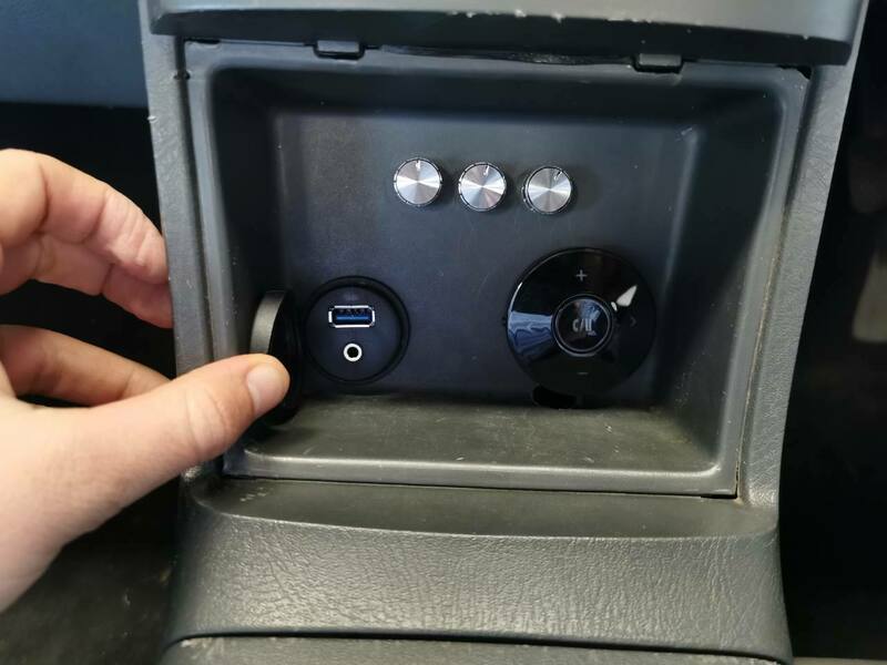

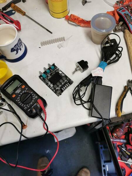

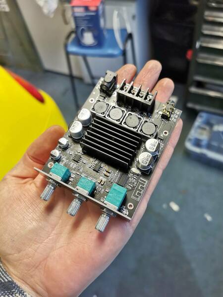

During all this, the Amazon man arrived with all the parts I needed for my stealth stereo install.
Most important was this wee fella, a Bluetooth amplifier board.
This little box of magic is powered by 12V DC, and contains a Bluetooth receiver, 3.5mm Aux input, two speaker output, and adjustment knobs for volume, bass and treble.
My wishlist for a stereo was quite simple - I wanted Bluetooth, an Aux input, and I wanted to be able to control the music. This box did most of what I wanted, and there were simple workarounds to get exactly what I wanted.
A quick rummage through the house found a suitable electrical connector from a surplus power brick (Blue tape means it hasn't been used since we moved house in 2016 - clearly not needed!):
A bit of soldering action:
Using some spare accessories I had loafing in different cars:
Produced this as an end result.
Now to try and explain it!
I wanted to be able to control the music playing over Bluetooth, but the amplifier board's inbuilt Bluetooth did not have that facility - all you can do is adjust it on your phone if connected as there are no buttons. However, the aux input meant I could connect a standalone Bluetooth receiver, complete with external controls. This receiver, pinched from the MX5, is powered via a USB connector, so some live and earth leads were soldered onto a double USB cig lighter connector and taped up, and the live/neautral lines connected respectively up to a 3-way Wago connector for connection to the switched live and earth lines sat at the chocblock in the car. As the speaker wiring is relatively low voltage, I was content to just replace the chocblock and connect it that way. The circuit board of the amplifier unit was also coated in a protective electrical lacquer to hopefully stave off any corrosion issues.
The benefit of this system is I have control of the music playing through my phone without touching the phone, and the inbuilt Bluetooth takes priority over the auxiliary input, so if my passenger wants to play their music from their phone, they can just connect directly to the amp board and control it through their phone! Everyone wins!
Next, mounting it. The stereo cubby was the only logical place for it -
After a lot of drilling, sanding and filing (The panel was very thick so an air file was used to reduce the thickness to allow the board to be successfully mounted), this was the result:
Once fitted and connected, it was time to give it a proper test (It was Burns Night the night I was working on this - there's a can of Tennent's just out of shot!)
Once tested, I remembered that the drivers' side speaker was still in need of repair, so I got onto that too:
Both are refitted and sound much better with no hint of blowing! Result!

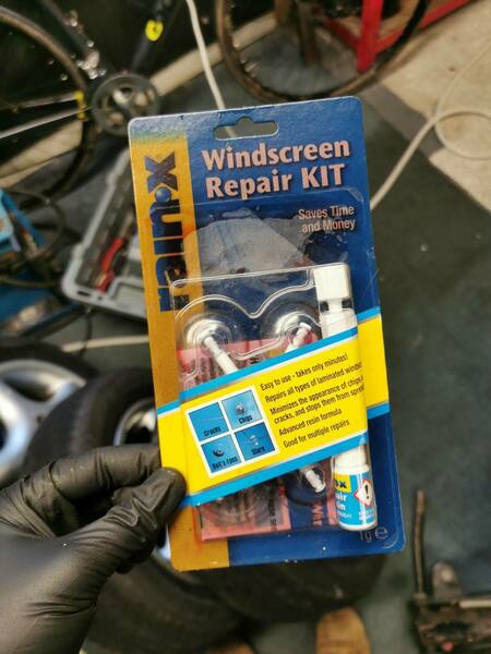

Next up, I used a kit that been sat in my inflam locker for years, getting covered in grease in the process!
This made the instructions 1000000 times harder to read, but I thought I did pretty well:
Till I got to the part where it said 'park it in sunlight'.
Not a problem, except a) the car was on axle stands and immobile, and b) it was well past sunset.
Thankfully I had a UV light from my phone screen protector, so that saved the day:
This did the job - it wasn't a flawless finish, but there were so many things against the job it's hard to say which part caused it. My fault, surely. Much better than it was though so who knows?

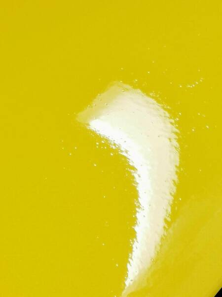

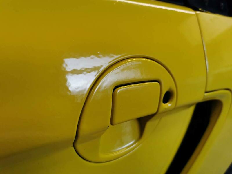

Finally, there was the job of giving it a thorough wax and polish. Now, the paintwork wasn't exactly applied in a dust free environment:
But that's no reason not to protect it. Two coats of Auto Glym SRP and two coats of some Simoniz hard wax that's been in my garage for nearly a decade:
And it's come up rather nicely. The wheels also received the same treatment.
As a bonus, I managed to get some deep scratches out of one of the tail lights with some metal polish, saving me from sourcing another!

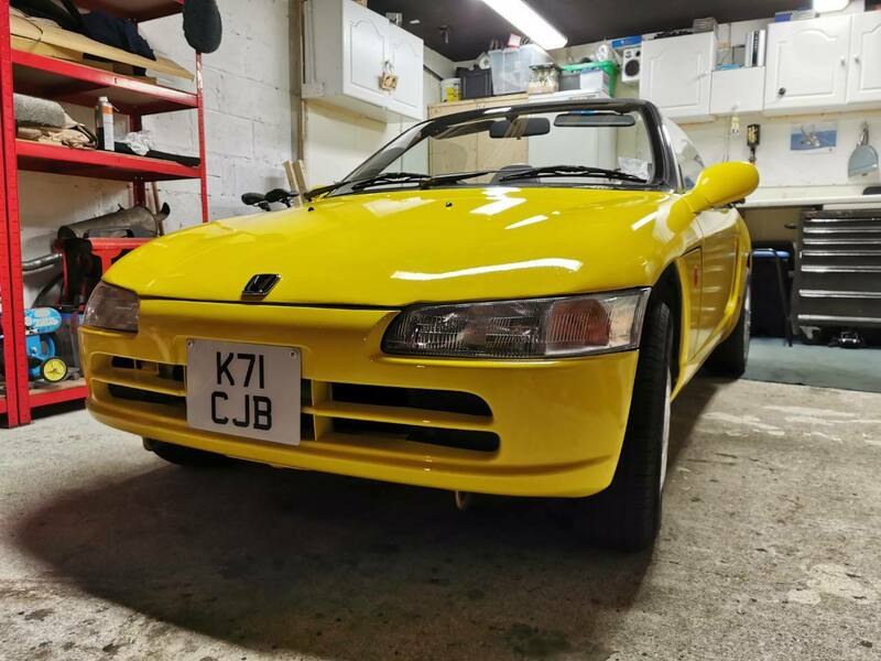

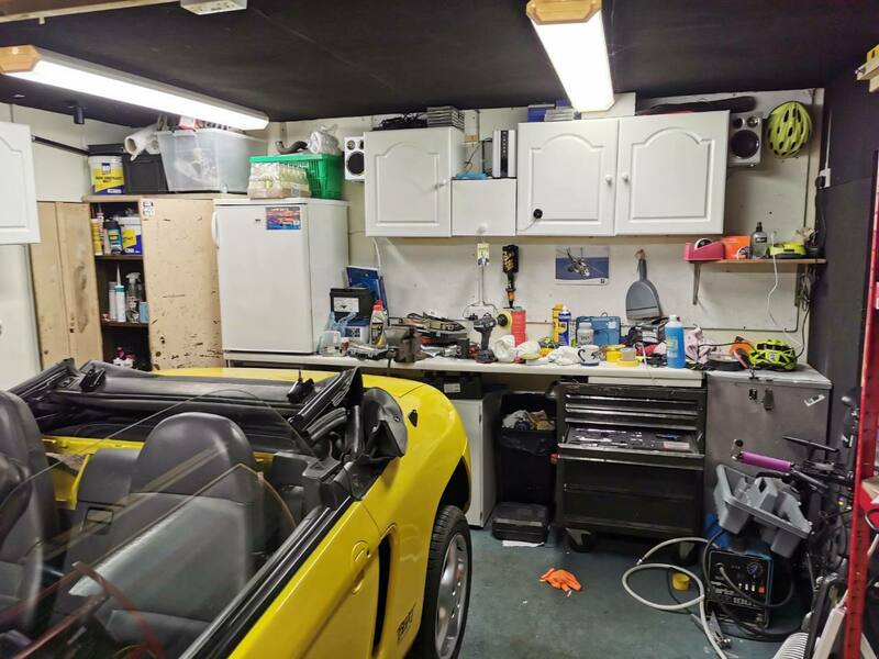

So, with everything done, all the tools I had been throwing around the garage -
were packed away, and I could take the car off the axle stands!
Noticed a couple of bumper grilles were missing - one will have been removed from when it was converted for a rear fog:
Found some extra interior plastics in the rafters too, so fitted them. No pics though, but its the vertical panel behind the seats in the next photo.

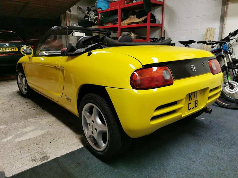

Finally, the boy was loaded up:
And we took it out for a test drive to get him a haircut!
It drove lovely, but the clutch pedal is still a wee bit stodgy. Once we got home, the car was washed and parked in the garage with the dehumidifier on:

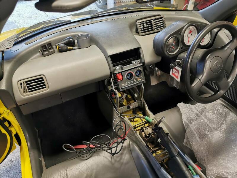

Which meant dismantling this again!
All my efforts were around the centre dashboard area again:
And this fella first:
Yes, I'd managed to source a replacement.

Suffice to say, he doesn't need a heater any more, so he sold me the heater and as a bonus, two brand new heater control knobs, which are unique to the Beat at a very reasonable price - what a legend!
All I needed was the plastic frame itself, so I transposed all the components onto the new unit.
It's not perfect, but it's fully functional and it's given me an idea with my old unit - to be continued, I'm sure!
Fitted it back in and onto the next job:
Once again, a drill was employed:
This was to accommodate the final piece of the stereo puzzle:
A USB and 3.5mm aux in extension. The USB was connected to the cigarette lighter connector and for the Aux-in, a splitter was fitted to the Bluetooth amplifier board, with the standalone Bluetooth receiver being connected to one output, and this 3.5mm extension being connected to the other. This provides yet another option to connect audio to the stereo via an iPod or what have you. As the input is shared, the only difference would be to ensure the Bluetooth music is paused before switching to the iPod. The USB is there to aid charging my phone etc, and a weatherproof rubber cover is fitted too.
All fitted back up:

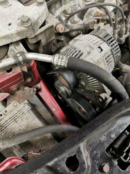

I've recently been using the Laguna to get to and from work, with this full tank dedicated to me doing an economy run. So far, it's going well, with over 200 miles covered and it sitting at approx 2/3 on the gauge.

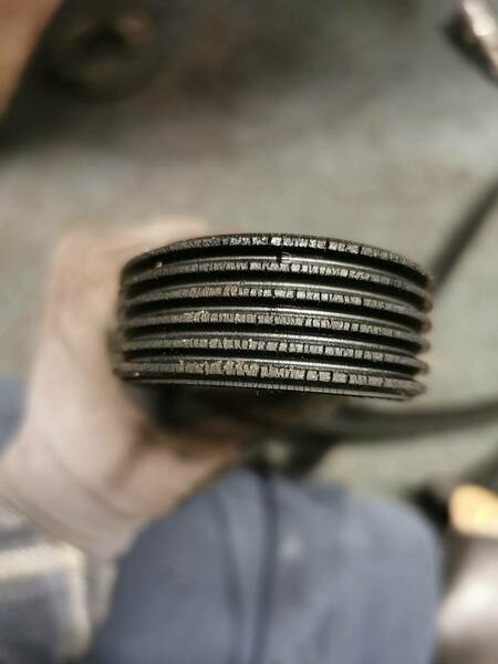

However, I had noticed a noise emanating from the engine bay, sounding like a squeal, changing with revs. As everything was still working fine, I saw no need to investigate further until the weather improved.
Then, I was about to pull out of the car park at work to head home when the power steering felt 'pulse-y'. No dramas, this cars got a persistent PAS leak so I grabbed the bottle from the boot to fill up.
Disturbingly, the level was fine, but a tiny splash more in the reservoir (and removing the reservoir filter) was just to make sure.
I suspected that the aux belt was a bit far gone - I'd never changed it in my ownership so why not now?
So, a couple of days later, I got my nonce slippers on:
And ran my usual route, but with a stop off at the local factors:
For a new aux belt.
Did a swap with the Beat to get the Laguna in the garage:
And immediately had to abandon the job as it required a 7mm Allen key to loosen the tensioner (pictured), which I did not. The belt definitely needs replacing soon though, it's all cracked.
So, instead I decided to take off and clean the bonnet latches as they are quite stiff.
Where I suddenly noticed the expansion tank was empty.
A bit more diagnosis found that the water pump was leaning which was causing my squealing noise. Picking one up on Monday.
Bugger! Reckon the Laguna heard us discussing whether we need to get a bigger car and decided to shit itself out of spite

Finished early, so at 0315 that morning, I parked the Laguna into the garage:
Unpacked the boot with all the bits and got started.
My allen key set arrived from Amazon - annoyingly, the short section of the 7mm one was still too long to fit into the bolt head as it was fouling the chassis leg. Bit of angle grinding reduced it to the required length!
Annoyingly, this entire evolution highlighted some problems with the layout of the garage, notable the positioning of the racking and the presence of mine and the boy's bicycles - not an issue with the Beat, but an absolute ballache to jack a normal sized car like the Laguna up. Once up on stands, the bottom hose was removed (Thankfully there was still some coolant in the system which shows it never 'ran dry' before I found the fault), system drained, plastic access fairings removed, aux belt removed and water pump pulley removed (a breeze thanks to me finally unseizing my free rattle gun last year) left me with this view:

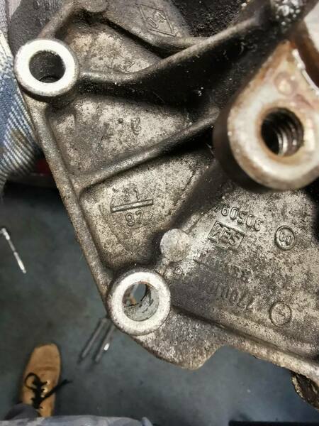

As you can see, the belt was already past its prime:
But 9 E8 bolts and a slight mallet tap later, and the old unit was removed and in my hands - remarkably, it's the original unit, from 24 years and 129,000 miles ago! The unit itself was sticking when rotated, with a bit of play in the bearings. Fired into the bin.
Then came the dull task of scraping off all the old gasket that had stuck itself onto the block. Came off all right eventually!
New pump was a budget ECP brand - seems okay though.
Didn't have a torque wrench that went that low for the securing bolts, so went for two white knuckles.
Then pulley back on and new belt fitted.
Once all connected back up, the coolant was filled and car started to begin the bleeding - success! The noise has gone away. Started bleeding the system at the one bleed point it has, when disaster struck:
One half of the bleed screw thread sheared off inside the pipeline, which hadn't sealed, resulting in a permanent slow leak of hot coolant. After much panicking and faffing, I managed to get the thread out, and found a spare bolt that matched the tread pitch and depth. More importantly, it provided a tight seal against the pipeline so order was restored!

I finished work early Friday morning and set about trying to weatherproof the covered cars by tactically parking the Laguna and Herman, and shoving some spare wheels against the BX's sills to act as windbreaks. Must have worked as the BX's cover was fine, and the MX-5's cover only lifted a bit up the rear bumper. Result.

Tested them with a wash (they worked), gave the car a coat of wax and threw some bedsheets over it, to keep the dust off. The dehumidifier runs in the garage 24/7 nowadays anyway to try and keep the rust at bay :mrgreen:
And that's it for a while - The Laguna is still on an economy run, and doing quite well.
