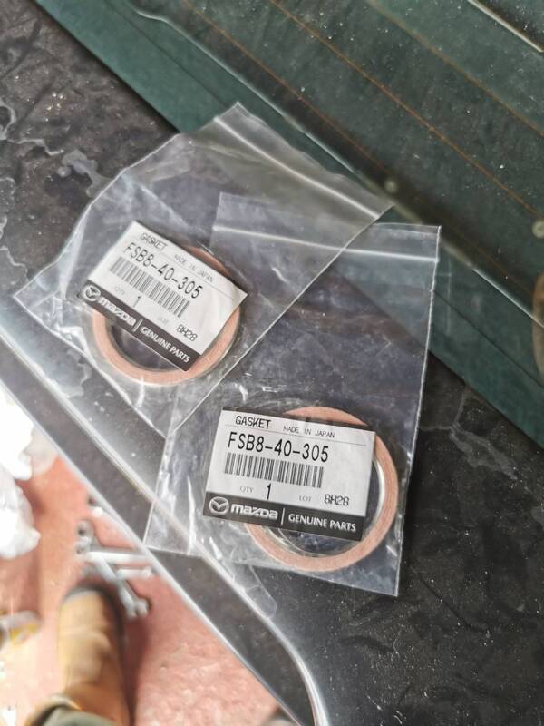

Yesterday afternoon, I pulled my finger out and fitted the correct gaskets to the MX5s cat.
Dropped it off the test station before they closed, as the retest window closed today.
Thankfully, whilst at work, I received the good news:

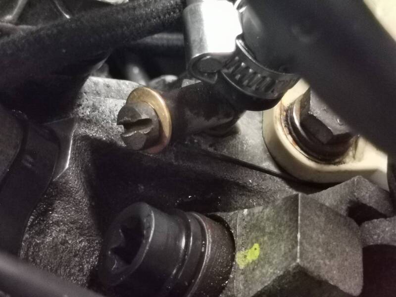

With that job done, it was time to re-bleed the cooling system, and it hasn't gone well. Despite replacing the copper washer several times, it still weeps from just under the screw thread.
I'm going to source some fibre washers to try and get it to seal better.
As an additional annoyance, the coolant temperature didn't go past 65, despite running for nearly 20 minutes until it ran out of fuel. Guessing there's still an airlock somewhere, the thermostat is new and it did get to 95 on Thursday so I'm a bit confused.

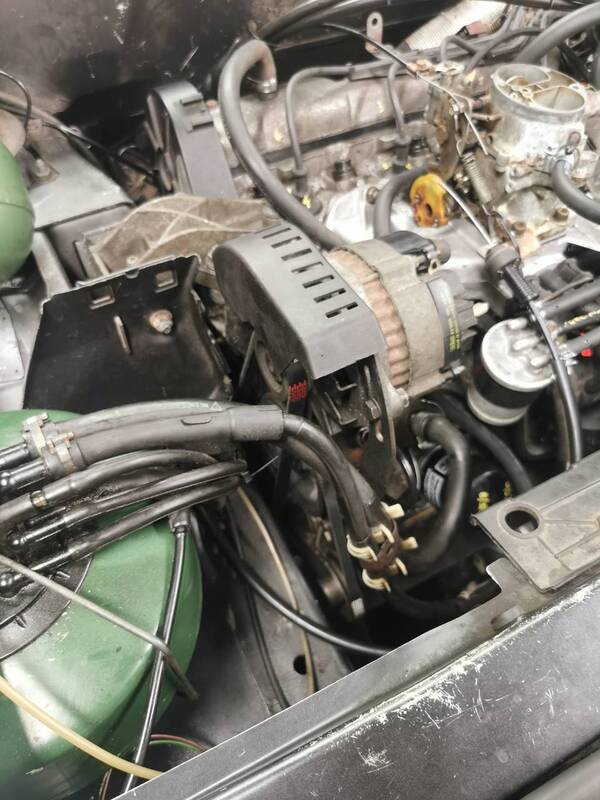

Anyway, now it's had a couple of heat cycles, I took the middle timing belt cover off, slackened and re-torqued the timing belt tensioner nuts.
Reassembled everything and cranked it over on the starter - thankfully no horrid noises!

First thing this morning, I hit the parts catalogue and called the main dealers - thankfully, they had some correct bleed screws and washers in stock, so I swung by after work.
Annoyingly, this STILL wouldn't stop weeping, so I had to resort to a wee bodge with silicone.
This ended up working, the coolant was successfully bled, wasn't leaking and the car reached the required temperature, with the cooling fan kicking in when required:

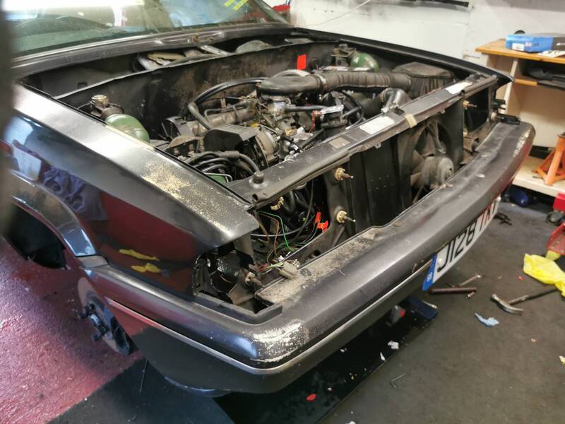

Finally, I could resume the rebuild.
Air filter housing and associated ductwork first.
Then the wings and inner trims:
And finally, the front bumper, bonnet, scuttle, headlights and wiper arm - this got a new blade.
The old front blade was moved to the rear as it was still okay and better than the rear:

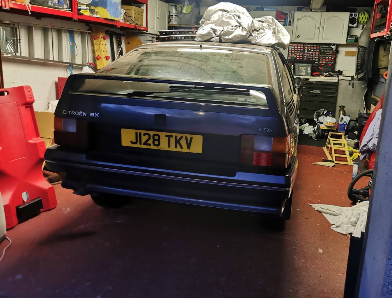

Then I spent a pair of hours tidying the garage up because it was carnage in there, before lowering it to normal height and driving it back in the garage for the night. I'll check the height tomorrow and see if there are any leaks again.
