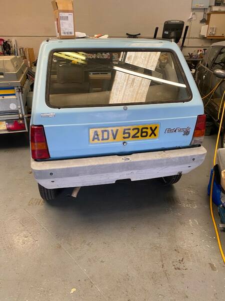

Set the mixture screw to roughly this and it started immediately and ran pretty well.  Took it around the estate where the unit is and it just randomly died out of the blue.
Wouldn’t restart, so cue the trailer’s first official outing about 300 yards away from the unit 😂
EC938F50-79F0-40CB-BF9D-CF75E1728AEC.thumb.jpeg.4f4591a9c480f5061ac9879737921762.jpegE72248FF-5300-47CE-9A4D-D84BBD286C4D.thumb.jpeg.37e4688bb81093e19a6a8800b37a8e10.jpeg
When it does it next time, spray easy start in the intake. Or carb/brake cleaner if you have none to hand. If it runs/coughs then it's likely fuel related. No difference then ignition related.
