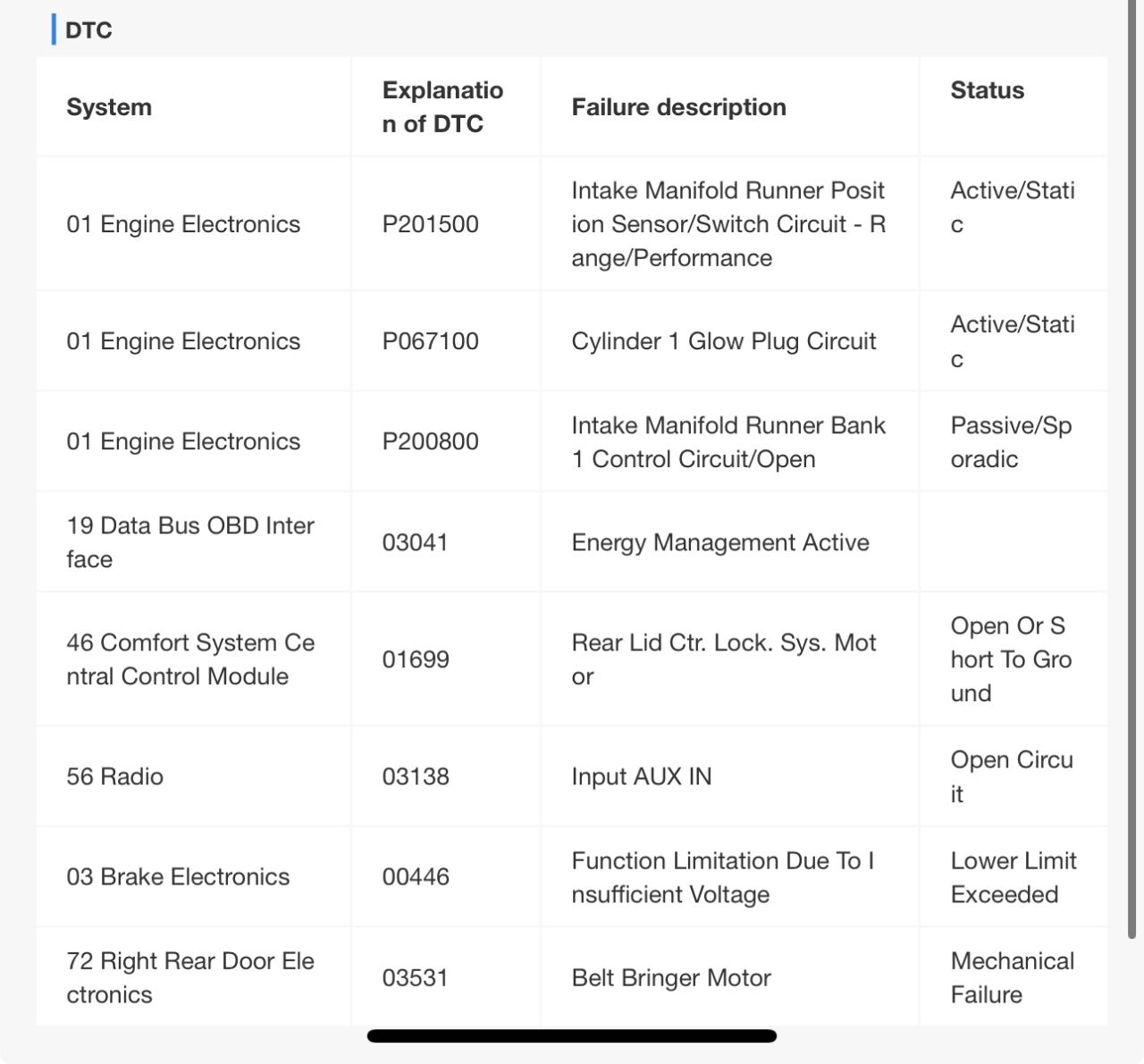

So… a diesel VAG product that has 142k miles up it and has an EML on… scanning for fault codes is going to be fun, right
All of these cleared fine apart from P201500 - so that will likely be our cause.  Looks like the swirl flap motor, rather than on the exhaust side as expected.
Looks like the stop in the motor breaks causing it to be able to go out of range, and a £6 repair bracket exists to fix it!
I’ll be keeping a close eye on the glow plugs though - losing a glow plug normally prevents the DPF regen from running, so it’s pretty important to fix.

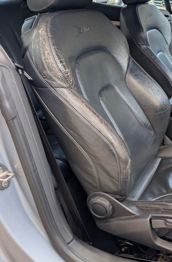

What do we reckon to this seat? The leather is in decent enough condition, it just has a load of this light coloured cracking all over the side bolster. Doesn’t feel worn out or damaged.
Do the various dyes etc available on eBay work? IMG_2231.jpeg.26a91d6dfe6590abb9aa1ed2d515c97d.jpeg

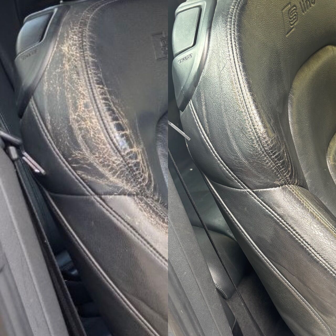

I bought one of these dabber things for my Merc's driver's seat which was similar and it did a great job: https://thescratchdoctor.co.uk/product/leather-repair-pen-10ml/
Really quick and easy to use too

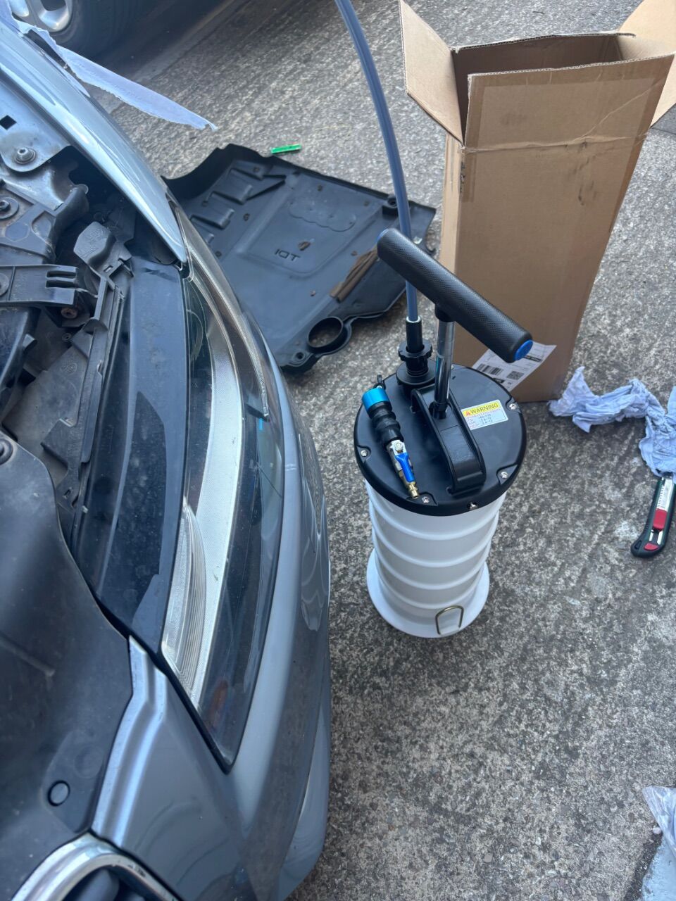

Oil change time. Can’t believe it doesn’t have a dipstick but still has a dipstick tube with a plastic cap on it 🤷‍♂️
IMG_2233.jpeg.92ba7a0b937a2faa58c050a8a08f0bc6.jpegIMG_2234.jpeg.74b09c02e502240b264e0a3e047d8797.jpeg
4.5l of oil out, 4.5l of oil in.
Changed the air filter and pollen filter too - I don’t think it’s massively overdue a service but also definitely due.

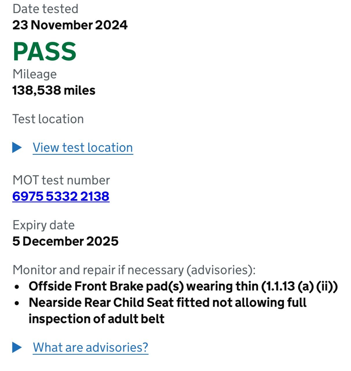

This prompted me to have a look at the brakes
pretty odd to have an advisory for just one side, but right enough, the outer pad on the OS is quite a bit thinner (just looked through the wheels rather then doing a proper inspection for now)
I guess it was binding at some point but it does seem fine now.
Oddly the same seems to be the case at the rear - OS pad is thinner than the NS, but they’re significantly newer so it’s not something that’d be flagged on the test presuming they’re not imbalanced.
Guess I’ll need to get it on the ramp and check it out properly, probably chuck both front and rear pads in.
