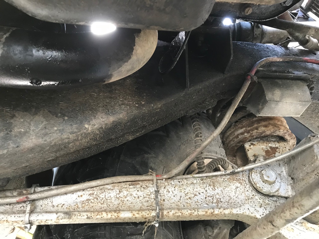

Had to go and look at a Land Rover today that had an electrical fault - apparently it was ‘fizzing’ - water boiling on a bolt in the chassis. The new owner had very sensibly disconnected the battery as soon as they saw it. A previous owner had added a shedload of extra wiring for lights, horns, radios, and the obligatory winch. There is also plenty of wiring for other stuff, bare wires all over the place that have no apparent purpose etc.
The main power feed to the winch went directly off the +ve battery terminal, down the following routing:
Yes, that’s a heavy gauge non-fused +ve cable wedged between the chassis and radius arm bush, then cable tied along the arm before jumping back to the chassis.
Luckily despite being fitted with huge mud terrains, a winch, snorkel etc it doesn’t look like this 110 has ever really been off-road - more modified for looks. It’s not the first time in the last month that it’s tried to toast itself - the dipstick tube was loose and it came into contact with the +ve alternator terminal. That made some pretty sparks...
For fuck sakes, if a job needs doing, do it right.
Those old sheddy land rovers and modded Discos are always old fucking nails held together with rusty nails and bits of twine. Doesn’t surprise me one bit.
That’s where this one is a bit weird. The PO clearly spent a lot of time and effort on the car, all of the bits bolted to the underside have been painted, there’s been good stuff like a Kenlowe fan and an oil pressure gauge added etc. It’s also mostly screwed together pretty well, overkill really in some places. But whoever they were I wouldn’t trust them to fit a sidelight bulb, let alone the Blackpool illuminations this thing has. I reckon by the time I’ve stripped out the excess wiring it’ll sit an inch higher and I’ll have made a fortune weighing in the copper.
Next step is to go around the vehicle thoroughly and check there aren’t any more bodges like this lying in wait...

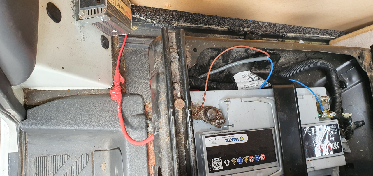

My wifes mate bought herself a "motorhome" which was basically the innards of a caravan fitted halfheartedly into a rusty transit.
Anyway, she said that the lights inside only worked for the first night she owned it and since then nothing has, so she was just running an extension cable off the mains hookup to an old desk lamp.
Here's the "leisure" battery:
Luckily it was 100% flat because there was no way to actually charge it!
The wiring was insane - The only fuse (that blue inline holder) was wired directly across the battery terminals, so obviously had blown.
I genuinely can't fathom what the fuck it needed all those wires for - the only electrics was three old labcraft lights robbed from a 1980s caravan, Half thw wires just sort of looped round or went nowhere - I genuinely thing someone just randomly connected things together until the lights worked and then left it exactly as it was.
The main battery used to go flat if she left the van more than a few weeks - She'd had the RAC out and they'd fitted her a new battery (at massive cost) twice.
Directly wired off the battery with 0.75mm flex and chocolate blocks was am unfused, unswitched chinese mains inverter that was just sat there making a loud whining noise and was always quite hot to the touch.
I was supposedly just fitting a new leisure battery for her, but it turned into ripping out and completely rewiring everything.
