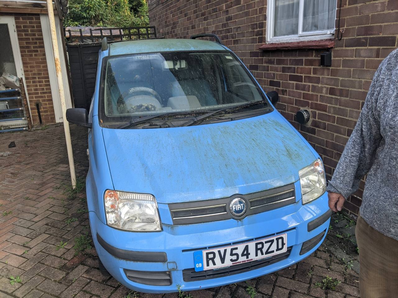

For the past few months I've noticed a very sad looking 54 plate Panda sitting by the side of a derelict house - but kept forgetting to knock- and never saw anyone living there, coming or going.
Fast forward a few months and on my way back from having lunch at home I noticed two big 'ol clearance vans outside the house.
So obviously I swung around and gave them my number to pass to the owner. Later that afternoon I get a call - it's his step-fathers car and he is now in a home and they are in charge of the car/house and it's future. Had a chat, had a look at it. Inside mouldy, outside covered in stuff but sub 35k miles (he only used it to goto Aldi and back) and the engine was spotless. Offered £100 as a punt.
He had to chat to his sister as she is next of kin/legal ownership now given the circumstances, she comes back with £200, I goto £150, we agree on £175.
Scrap is £130 or so - £50 for a punt is worth a shot.
I go back to collect the next day:

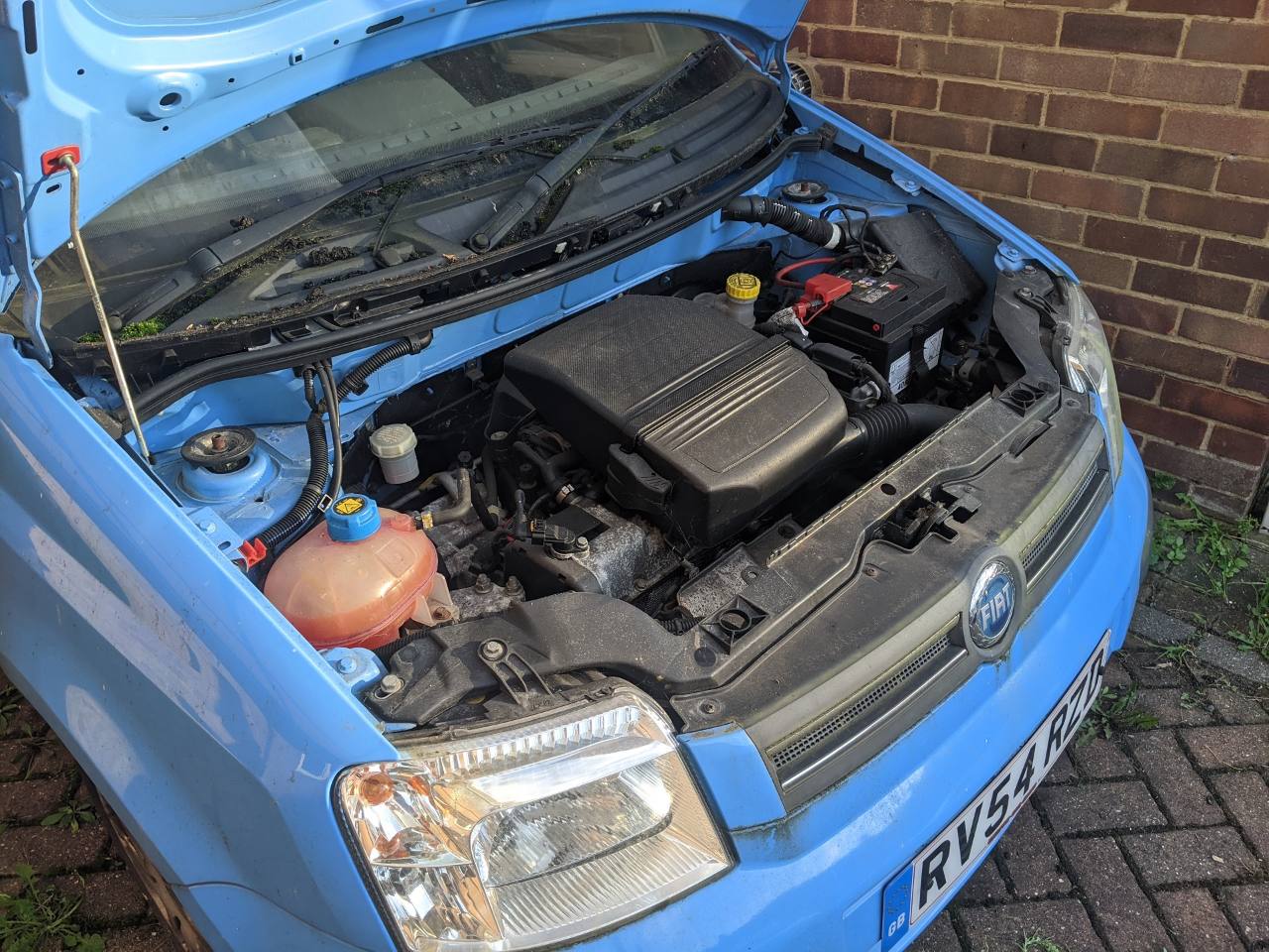

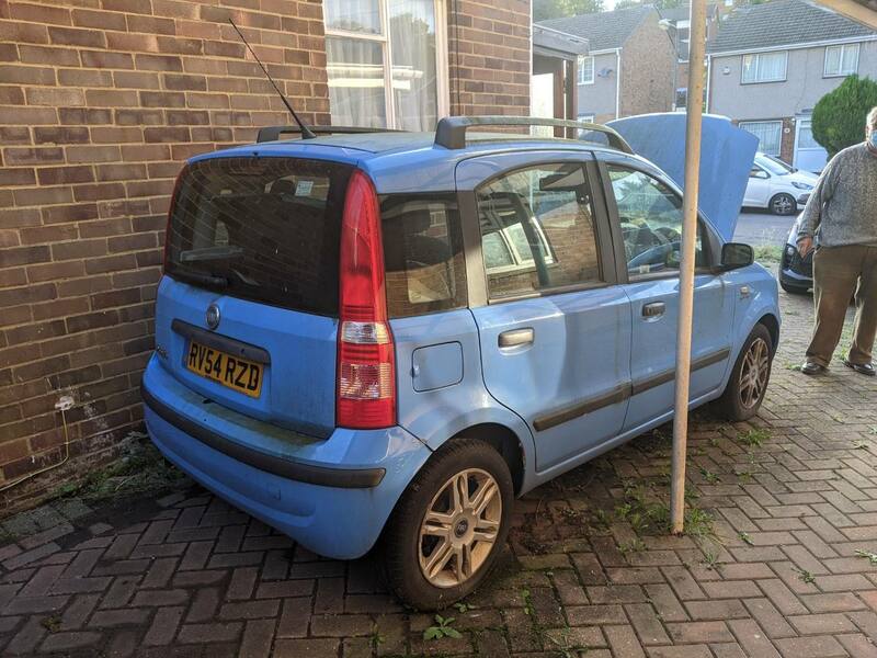

Hooked up some leads to my BX, after about 25 seconds of cranking and spluttering, it started. Engine sounded quite sweet, but an absolute Christmas tree of warning lights and bongs as expected.
Drove it the 20 seconds down the road to the back of my house on very perished semi-flat tyres and it actually drove okay. Power steering stopped working as I was parking but TATDS. Assuming all gremlins due to low voltages.

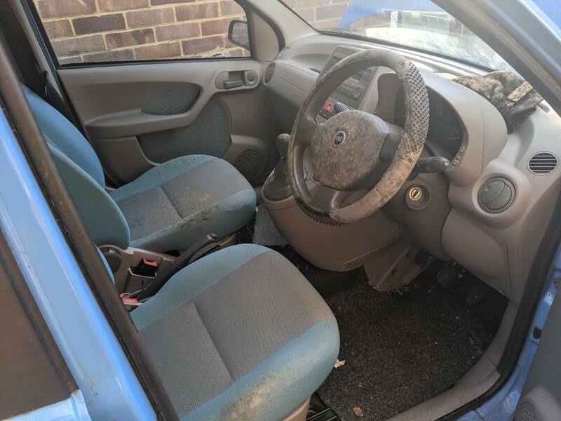

It's full of crap, and covered in just as much, hoping to get the battery charged and it running semi reliably - give it a wash, clear it out, service it and MOT it then who knows. It's got Air Con which is posh for a panda. I think it's quite sweet.

Charged the battery for a couple evenings, just tried it again today and it doesn't start and moans about ABD failure - so refuses to start.
Reading up this is something to do with the ABS, can be caused by a bad earth or low voltages. I'm assuming it's the latter as the battery has sat dead since at least Jan this year - although it looks like a fairly new Yuasa....new battery or more charging do we think?
Removed all the ABS fuses just for a punt - no dice.
Couldn't get my bluetooth ODB2 to connect either for some weird reason. It lit up and stuff, but couldn't connect to the ECU, maybe the car needs to be on...
They like a decent fresh battery.

I think a new battery will sort the steering issue. I reckon a lot of power steering columns were replaced when only a battery was needed.

It's the 1.2 - which I believe is still the FIRE engine and it's non-interference from what I can gather.
I've got a Bluetooth reader and a copy of Torque Pro (which lets me clear codes) on my phone that normally works a charm - if not I'll get an actual lead.

Not quite. Get the engine running and ticking over. Then, within 30 seconds you have to rev it to between 5 and 6k rpm and hold it there for at least 3 seconds. Let it return to tick over and repeat twice more. When it drops to tickover the third time the flashing eml should* clear. Did on mine.

Question to all: The old battery has been sitting for a year or so - I charged it for maybe a day and a half. It turns on the ignition fine but the aforementioned fault stops it from turning on.
Shall I stick it on charge for 3 - 4 days (this is the charger) and try again - or is the battery most likely scuppered?
The battery might recover sufficiently to start the engine, but you may find you'll need a different charger.  That one you linked is only a trickle charger and a very dead battery will probably need a 'repair' cycle (where it is pulsed) by a smart charger, like a Ctek.  Even after all that, it might be kippered anyway... but worth a go!
