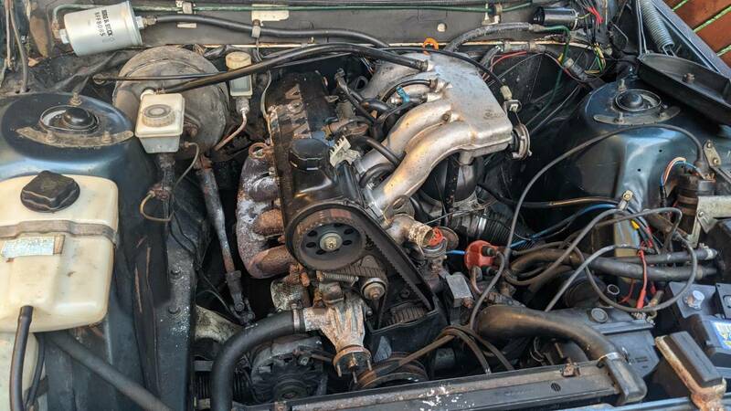

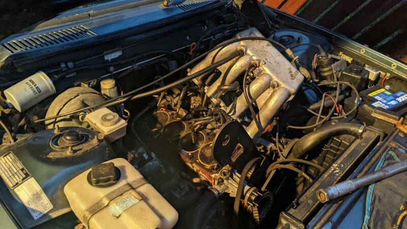

Sorting the 240s misfire before it goes to FOTU isn't going particularly well.
I replaced all of the injector seals and all of the remaining intake gaskets with genuine parts. Still running like shit.
I checked the valve clearances.
Everything was spot on.
I checked the fuel pressures. Again. All right on the nose.
I checked the ignition timing. Right where it should be and altering it makes no difference.
I dismantled the KJet system once more and cleaned the life out of it.
While doing so I noticed the little filter baskets that sit under the injector banjos here..
.. yes this is how small they are! They're all a bit fucked.
Thankfully they're available for £1 each.
I also thought the airflow plate looked off centre.
So I fixed that.
After putting all of this back in the car.. no change!
At this point it can only be ignition. I've changed the coil, leads, rotor, cap, spark plugs, and tested all of the wiring to and from the hall sensor and ignition module.
But what else can it be?
I decided to take the distributor apart to have a look.
I can't be sure but I thought one of the advance springs was hanging loose..
Did a quick test of the hall sensor and rotor - all fine.
Back in the car.. no fucking change!
Tried yet another coil and a spare set of leads.. nope!
I remembered I had @captain_70stiming light in the car so decided to test the individual HT leads. They all looked to be firing regularly.
I then had one final moment of "what if" and put the timing light clamp over the king lead.
That's it! You can see the misfire clearly as a blink in the light just as it stutters.
At this point it can only be the hall sensor or the ignition module as clearly it's not getting the signal to fire from either of those.
I've ordered a module. Fingers crossed.

Well, the module did nothing.
I think the next step may be to lift the head and have a look at the valves.
In the meantime I'm pretending I don't own a 240.

Here it gets more confusing.
I concluded I had an ignition problem because the timing light was stuttering. However I've since learned the same light stutters on other cars so I can safely say it's a quirk of the light and not conclusive.
I wired a led to be triggered off the hall sensor circuit and it seemed to be steady.
A new hall sensor essentially means a new dizzy as the old one is riveted in place and it's not a straightforward swap.
I've ordered another timing light and a spark tester to see what they show. If those don't show any issues I'll take the head off for a peek.

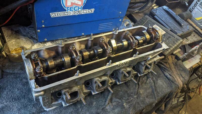

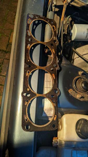

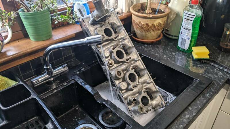

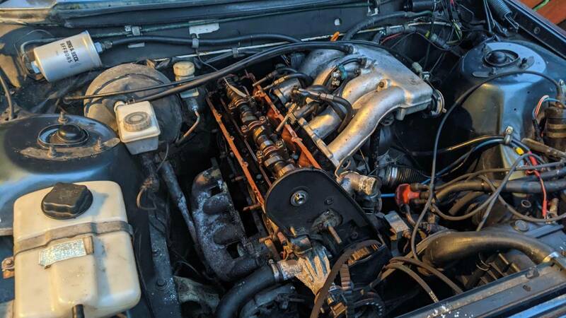

Summary of progress repairing the 240 is as follows.
My patience has run out a few times with it, but the abridged version is this:
- Ignition was checked over again, this time with a new timing light and a spark test light. The flutter I was seeing in the ignition before was definitely a problem with the previous timing light, because it's absolutely rock solid now.
- Compression test was redone. All cylinders bar #3 were at 175.
#3 was a little down but not by much.
So 160, which is still within the tolerance. Cue rather a lot of chin stroking and 'fur fuck sakes' hissed into the air.
- I unplugged each HT lead one by one while the engine was running. With #1 and #2 unplugged, you could clearly still hear the misfire in the randomness of the exhaust note.  However, with #3 unplugged it settled down to running on 3, but in a very regular beat.  AHA!  At this point I can zone in on the fuel, spark and air to this cylinder.
- I swapped the injector lines over between #4 and #3 to see if it was a fuel problem. It isn't.
- I swapped the HT leads over from another cylinder. No change.
This is really odd. Time to get serious.
So my current thinking is that #3 is either leaking air or there's a valve problem.  In the process of doing the compression test I noticed that the spark plug thread was a bit shit. It's possible that the plug isn't seating properly, or is leaking at random intervals.  My next job will be to stack some copper washers and see if messing with the seal improves anything.
If not, I think I'm back at looking at pulling the head and having a look at the valves.

Today I decided to crack on, and I'm not sure why I avoided this job. Looking at the timestamps on my photos, I started at 1515 and had the head on the floor at 1556.  Redblocks are so good to work on it puts everything else to shame.
Setting the crank to TDC and undoing the tensioner. Right as expected the tensioner spring flew into a garden a few streets away.
Cam cover and sprocket off, manifolds off.
Only two wires to unplug, and well that's it.

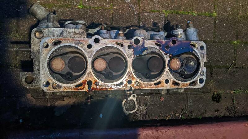

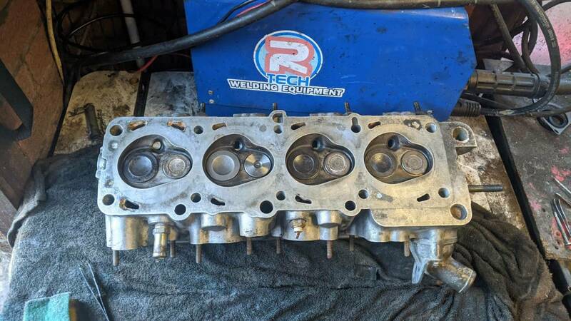

Let's have a look.
HG looks absolutely fine.
And the valves.
Well there we go. #3 is indeed doing very little in the way of actual work.
The cams are fine, the clearances are spot on. The next step is to remove the valves and see what's going on.

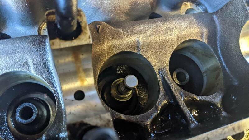

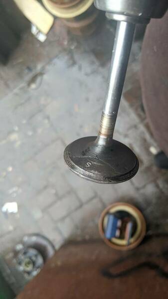

Amazingly that's the inlet valve that's burnt. File that under "there's your problem".
Not the end of the world, all parts to get it back on the road is around £75 which includes an oil and coolant change.

  • juular changed the title to Juular's Scandi Noir. Volvo C70, 240 &122. There's your problem.
Thinking about it.. this would explain why the engine was rocking so severely at idle:  The (small) volume of air and fuel in that cylinder was likley being pushed back out into the inlet manifold to be drawn in to the next cylinder on it's intake stroke, so not only was Cyl 3 not (or barely) firing, but also cylinder 4 was drawing in a larger volume of air and fuel than either 1 or 2, meaning the idle was even more uneven than had it just been running on 3 cylinders.
All makes sense now.
It does now. Hard to believe I've been driving it like this for a couple of years including a few thousand miles on road trips. I always thought the 'shoogle' was a tired engine mount as all the symptoms disappear as soon as you give it any right foot.
What confuses me is how the compression figures on that cylinder weren't much worse than they were, being only 10psi or 6% down on the best cylinder.

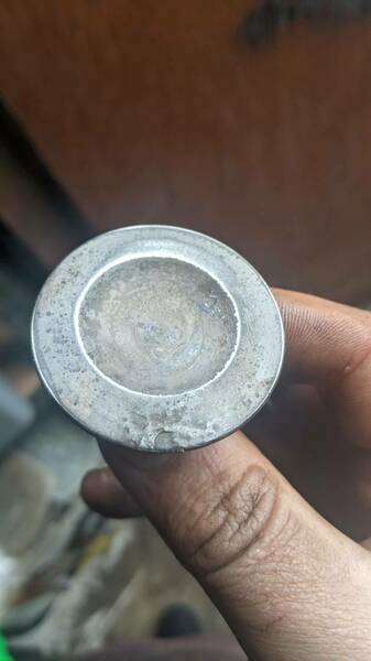

Intake valve arrived.PXL_20231223_133731636.thumb.jpg.0feb51a119bc75ef8eac5d85f5456e51.jpg

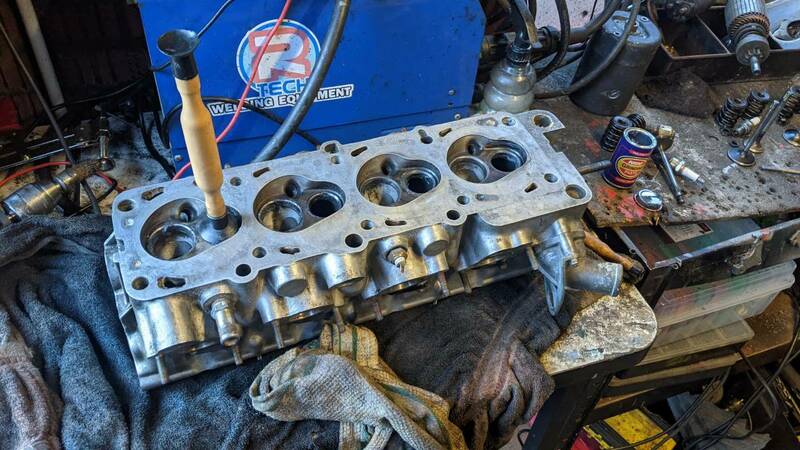

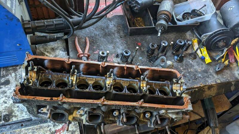

Continued to dismantle the rest of the head, since while it's off I may as well replace the intake stem seals, hushers, and re-lap the valves.
The good news is everything else is fine.
Scrubbed up the head.
I need a dishwasher for this.
Started lapping the valves back in.
Ah, shit. New valve Vs old. Not helpful!

The right bits finally arrived, so that's the 240 head back together and ready to go on the car.
New stem seals on the intake valves.
New intake and exhaust valves on #3.
New valve hushers on the stem tips.
Camshaft back on. I'll need to check the clearances but I'll do that with the sprocket attached as I don't want to damage the cam shaft thread.
I just realised that all 3 Volvos have now had their engines in bits, not because they are troublesome but from unrelated and unlucky indirect failures of some kind. In this case I'm certain it was caused by the mix being far too lean as it was when I received the car, and the ignition being too advanced to run on 95.
