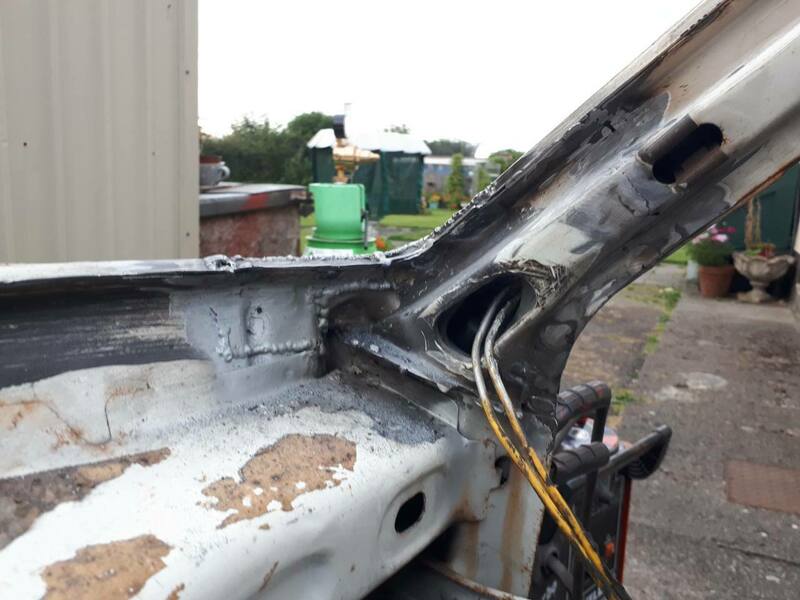

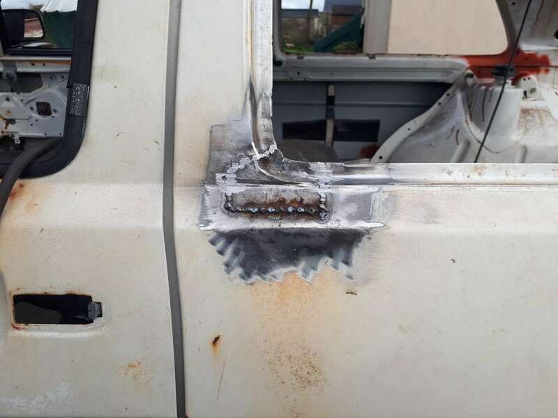

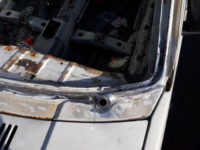

Then it was onto fixing the windscreen surround.
That took me three days,was knackered after the first day,but gradually felt better.

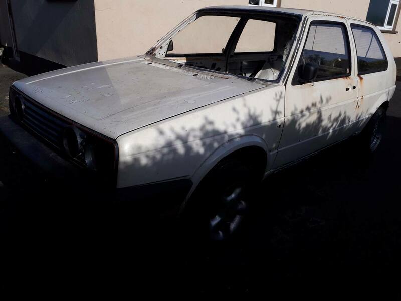

Work has restarted on this heap.

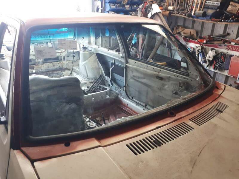

Today's endeavour was to fit a windscreen to make sure the repaired surround was the correct shape.
I didn't have a spare screen,so had to buy a new one.
Thankfully they are still readily available,went for one with a top tint.
It fits!

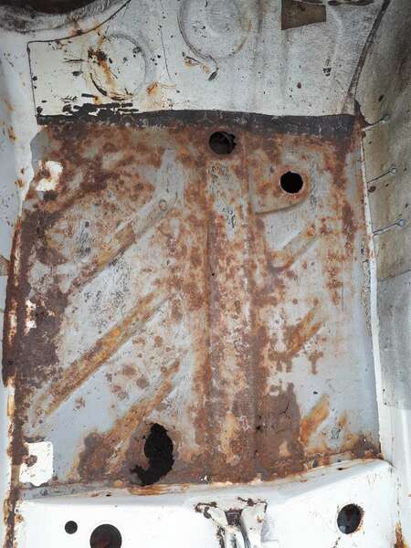

Started on the passenger side front first.
Bit scruffy,but not too bad.
Some wire brush action revealed more holes.
Welded up and welds dressed.

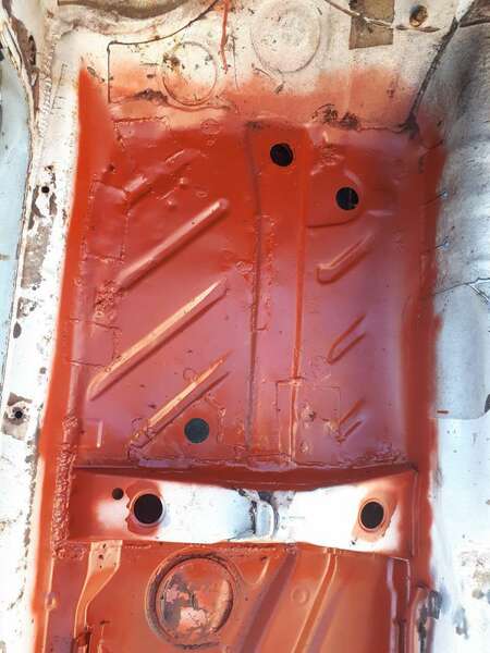

Rear passenger side Floor pan next.
Wasn't too bad.
Long strip needed under the seat rail.
Then gave it all a squirt of red oxide primer.
One side done.

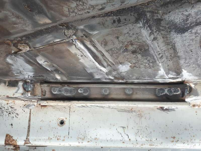

Seat rail has rotted through,luckily had a good one on the doner vehicle.
Just have to weld it in the correct position!

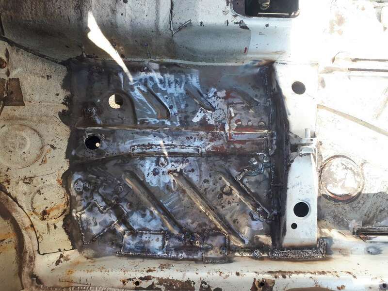

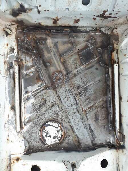

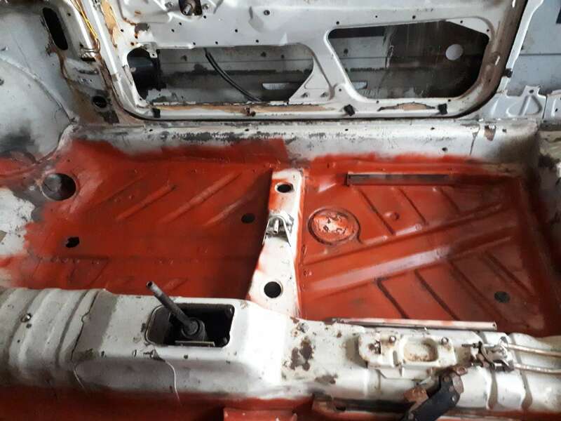

Overview of the whole floor pan.
Welded in the seat rail first.
Then patch the rest up.

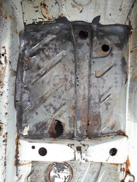

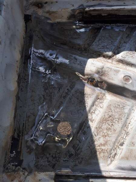

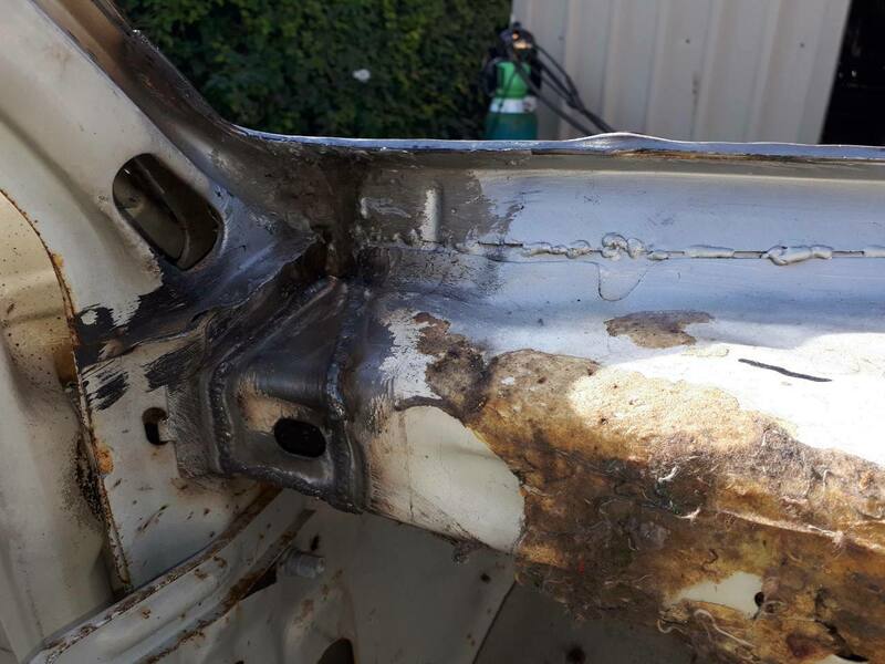

Drivers floorpan next.
This one needed the most work.
Managed to get quite a chunk from the doner car.
Chassis rail needed a minor repair too.
That done,time to tackle the rest.

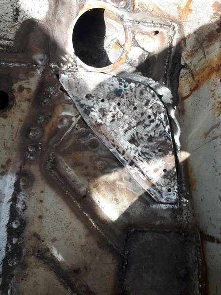

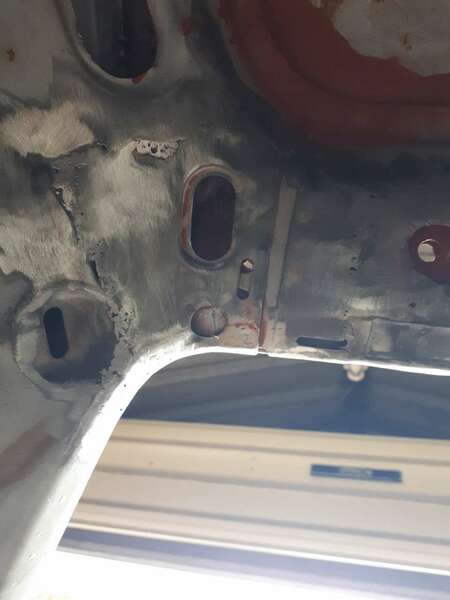

Next was the front corner.

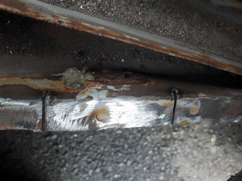

Underneath this is a jacking point.
So I chopped out a bigger section to see the condition of what lay beneath.
I had thought I'd have to repair this from underneath,but the rust was very localised,so it could be repaired from the top,result!
Ground the rot out then fashioned a repair patch and welded it in.
Then welded the floor section back in.
Then make up another patch.
Then weld it in(was a bit of Vauxhall Viva once upon a time)
Time to make up a few more repairs then clean up the welds.
Done.

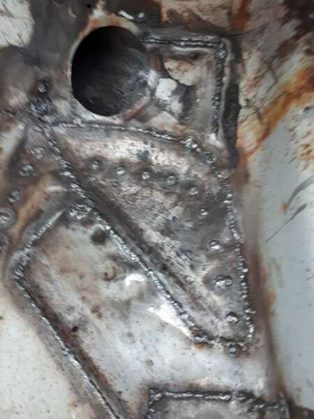

Next was this cheeky little rust hole in the front wheel arch.
Doner car came to the rescue again.
Welded in.

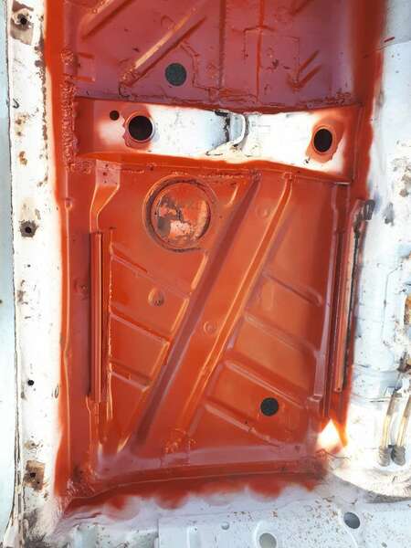

Cleaned up the driver side floors ready for a squirt of red oxide primer.
Floors in the cabin are finished.

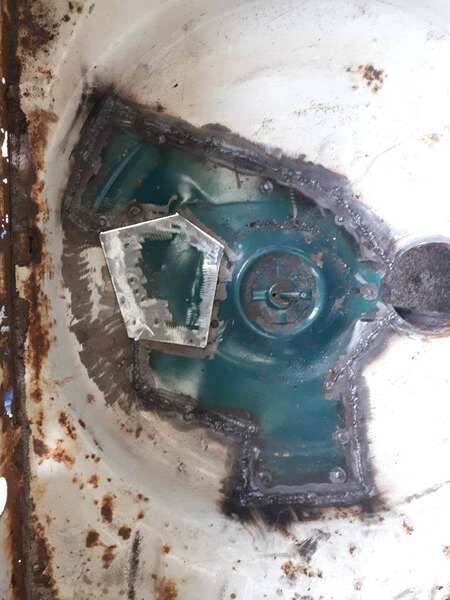

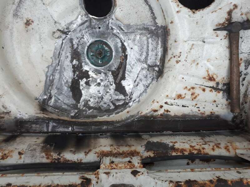

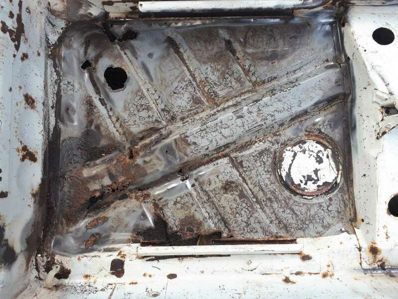

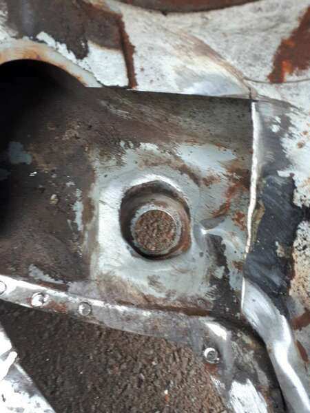

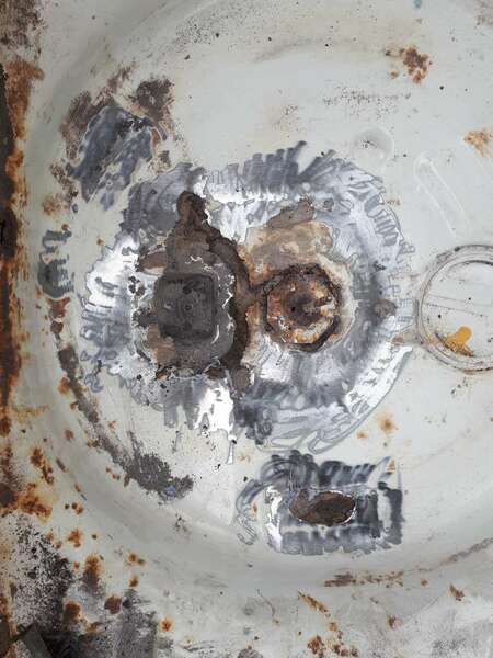

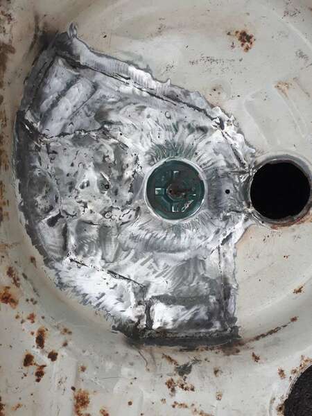

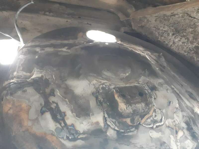

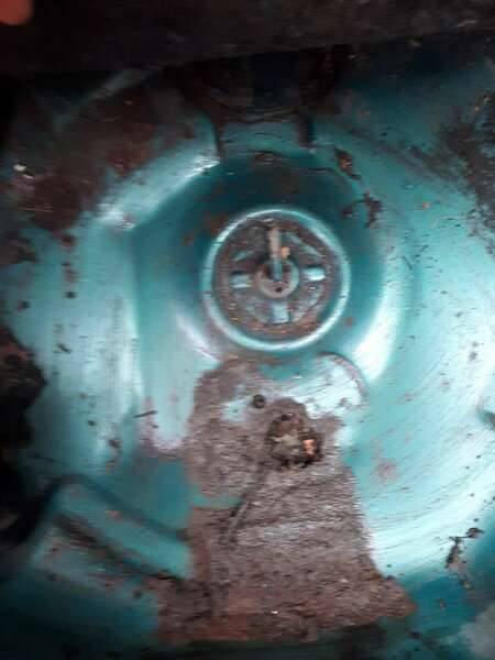

Spare wheel well.
Rotted around the retaining bolt to hold the spare,and also the fuel tank strap that is on the underneath.
Mmmmmm,rusty.
Fortunately the Mk3 I bought recently had a reasonably decent spare wheel well,unfortunately the tank strap bracket has rusted and been plated up before.

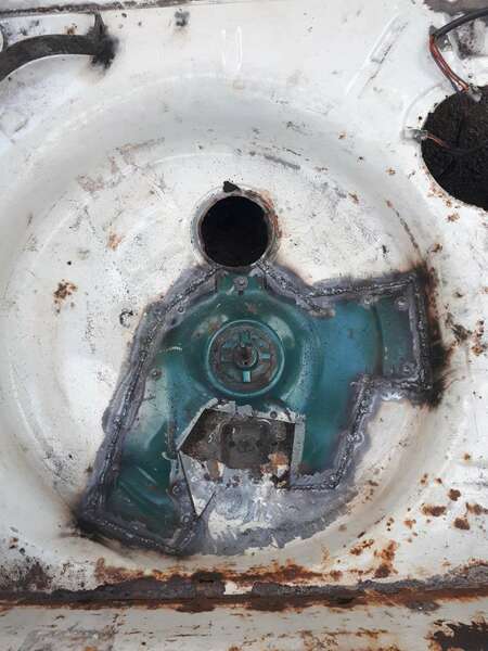

Time to chop out the grot.
I was going to make several smaller patches,but decided to chop out as much as I could in one go.
Doner cut lined up.
Welded.
Still got to do the tank strap bracket.
I left the old one on to maintain its position for the time being.
  • Like 9

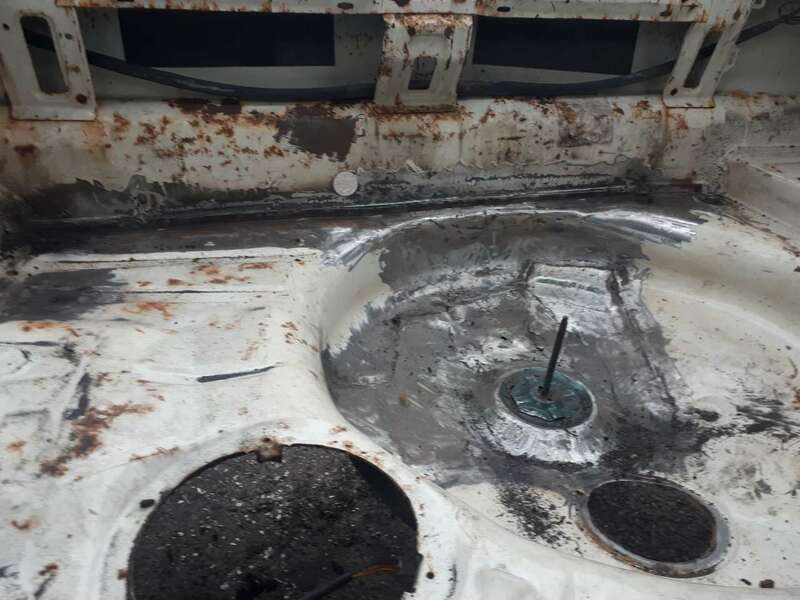

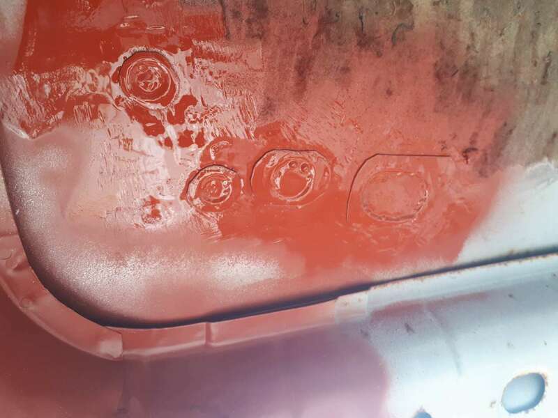

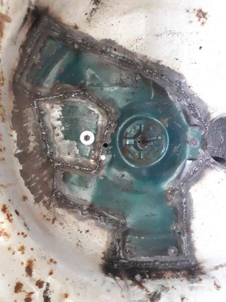

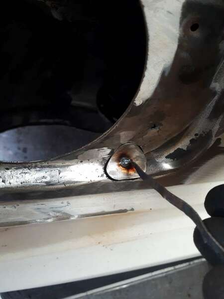

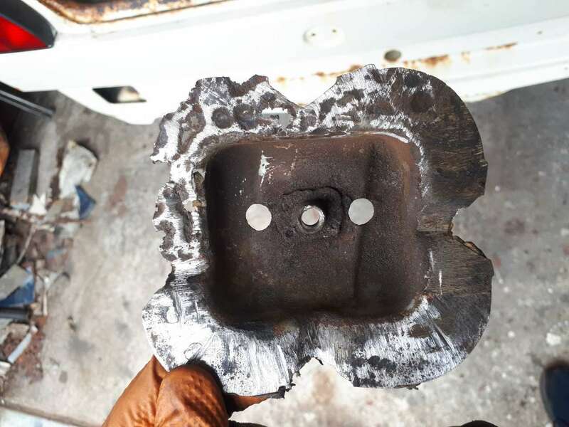

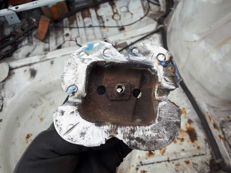

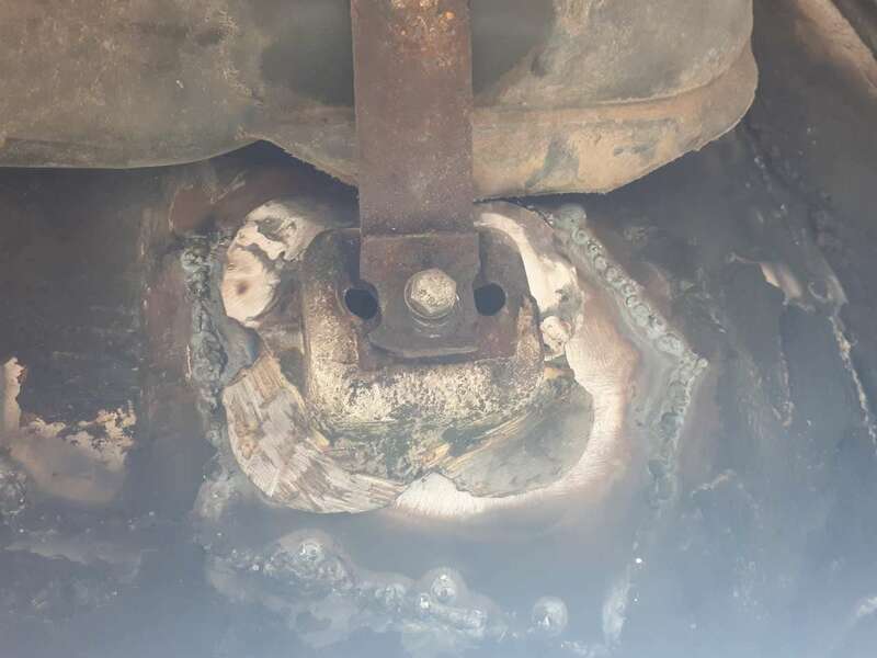

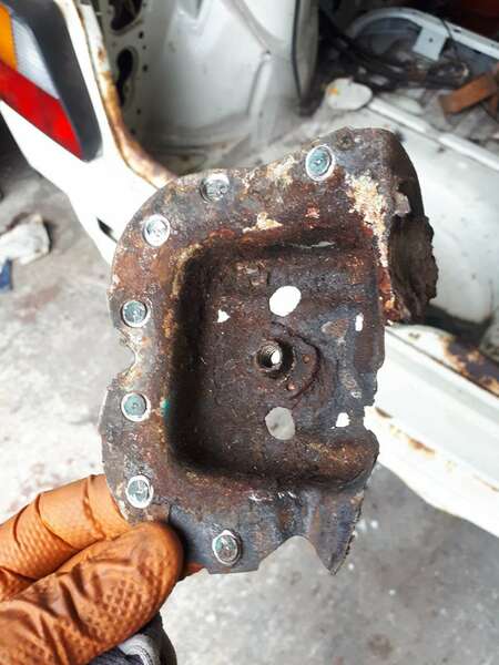

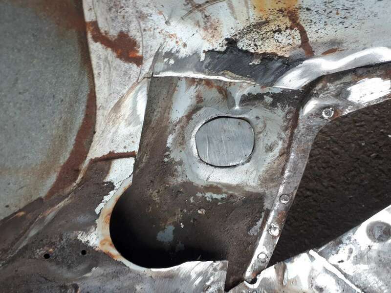

Next was to finish the fuel tank strap bracket.
First make up a patch for the top of the bracket.
Then  drilled a hole in the panel and threaded a bolt all the way through the bracket and floor to preserve the location point,the original had this too,it doubled up as a drain hole.
Next I could remove the tank bracket.
Hmmm,needs a tickle of the welder.
The doner mk3 bracket was in worse shape.
But there was enough material between the two to make a useable one.
So it was time to refit the fuel tank and double check everything still lined up.
Time to weld it all in and clean back the welds.
Done.

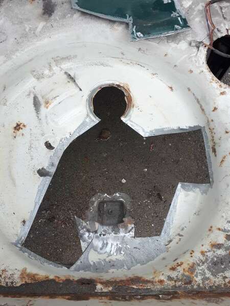

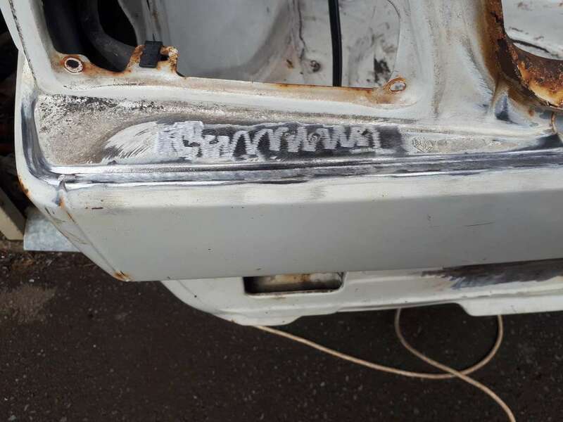

Boot floor where it joins the rear panel next.
Weirdly looks like the outline of an alterboy.
(As an aside, I served on the alter till I was 16. In that time no priest ever laid a finger on me. As a result I grew feeling somehow unattractive 😆)
Well I guess it is a bit Holy(holey)
  • Haha 3

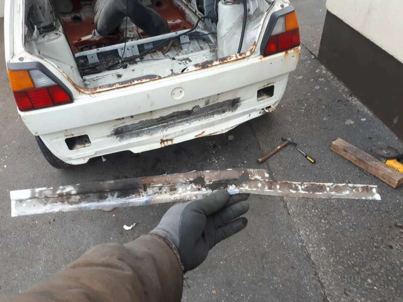

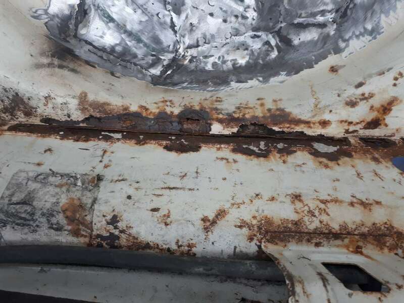

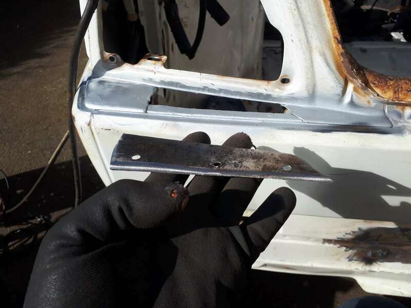

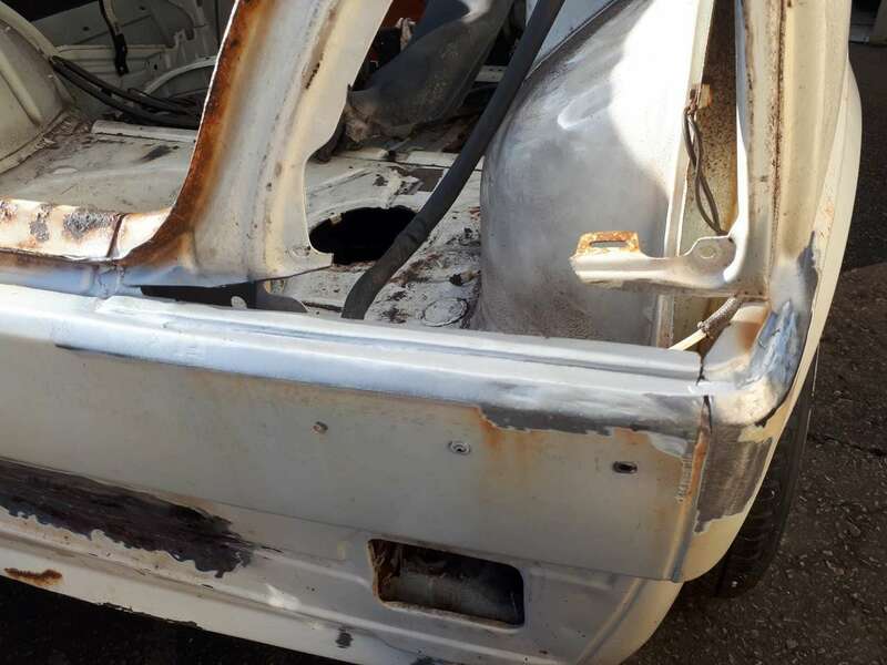

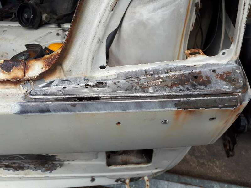

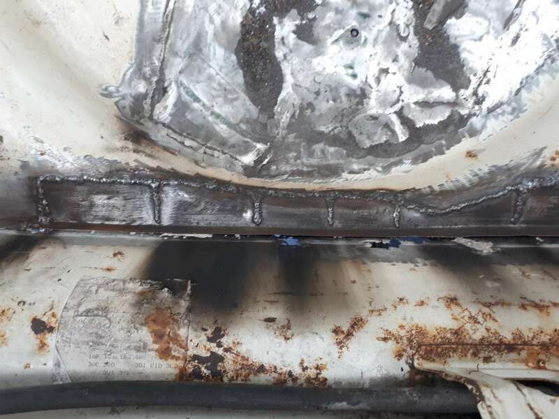

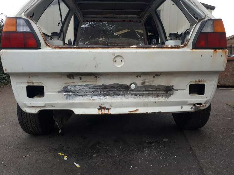

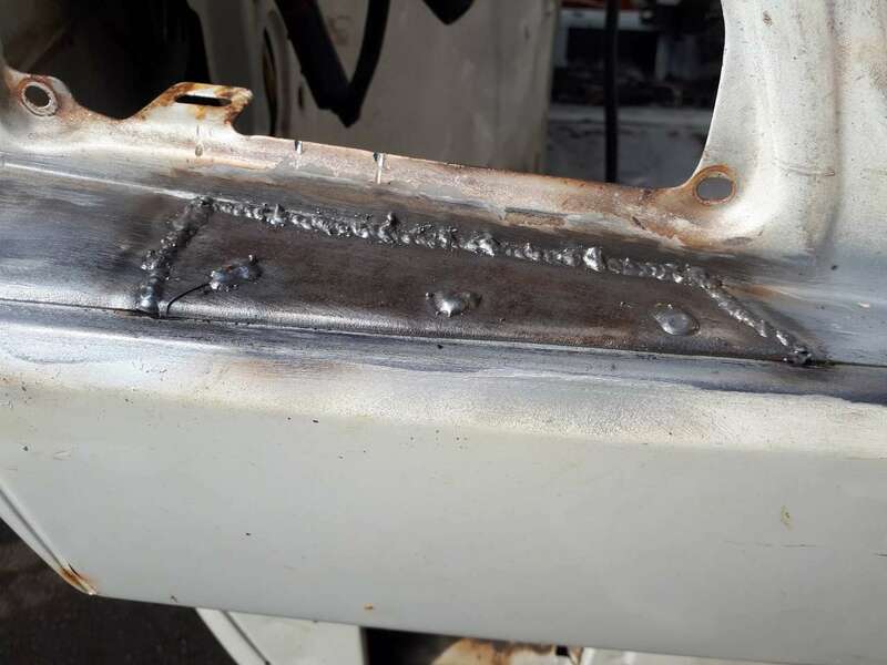

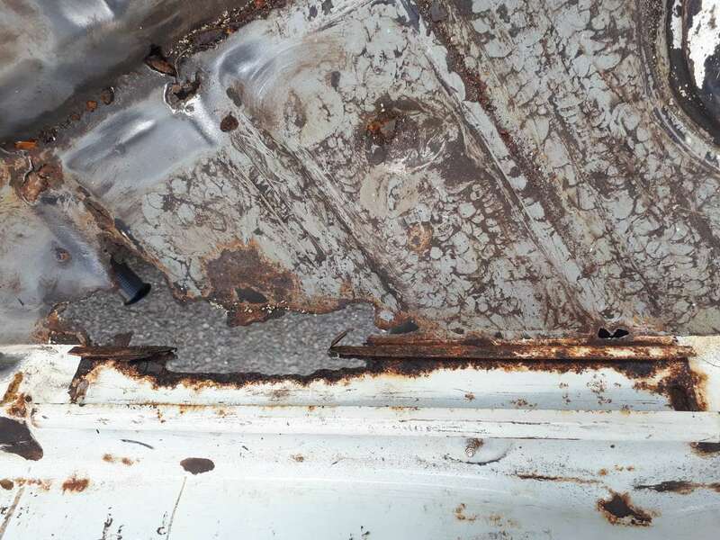

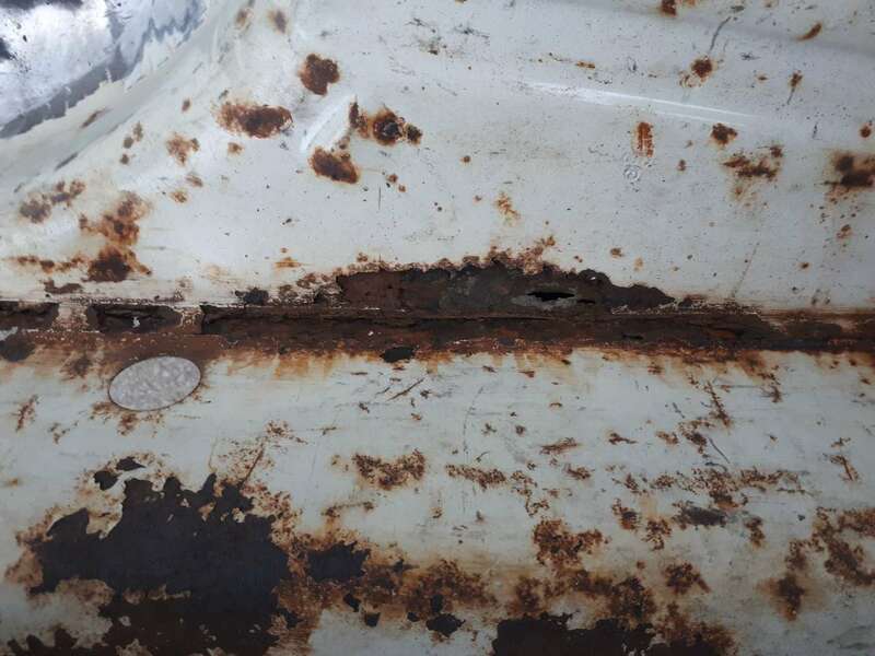

Next was the rear edge of the boot floor where it meets the rear panel.
The seam between them traps moisture with the inevitable result.
Rot.
Great.....

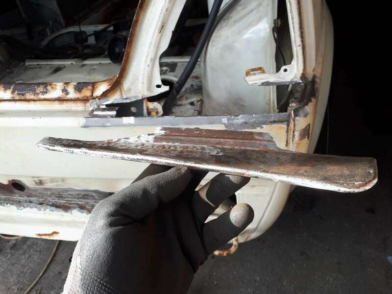

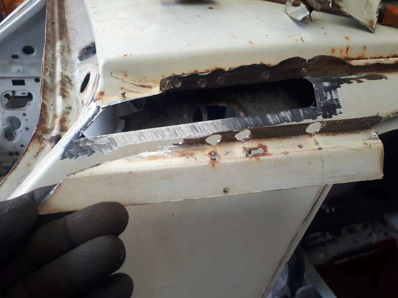

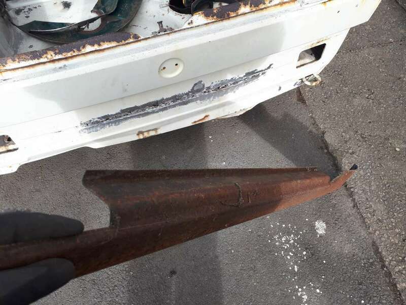

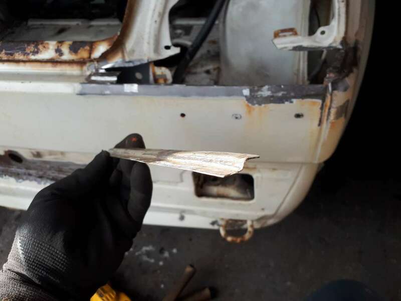

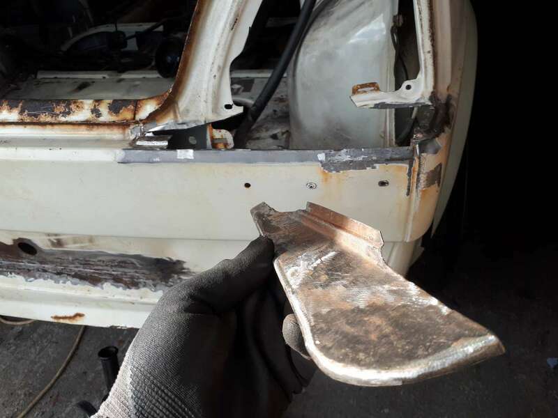

I needed a folded edge for the boot floor my metal folder isn't big enough to do the the fold in one go.
A rummage in my shed turned up this sill,for a mk1/2 Fiesta,but of surface rust but otherwise perfect!
Chop chop, weld weld.
Despite it looking straight, there is a curve to the rear panel, so I had to slit the patch in a few places to suit.

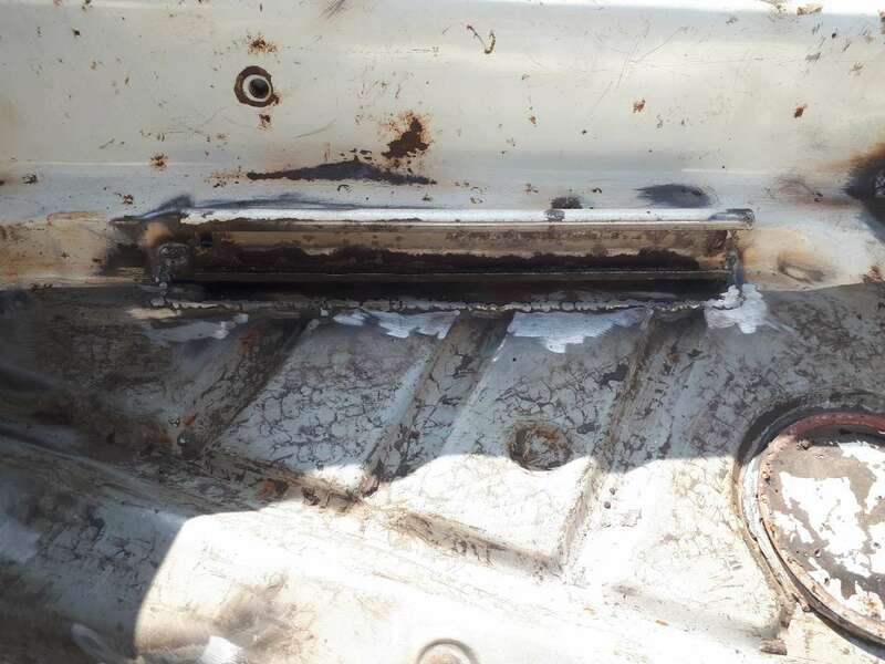

Time to make up the rear panel repair.
Bashed a groove into it with a bit of square section steel bar.
Trial fit.
Weld.
Removed rotten section.
Time to clean up the welds.

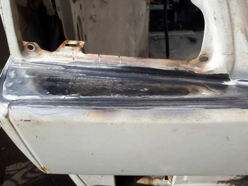

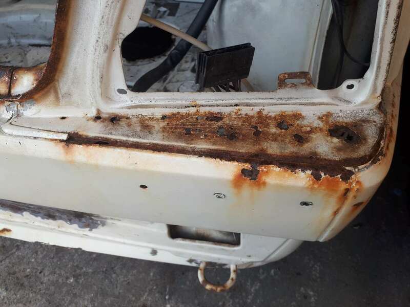

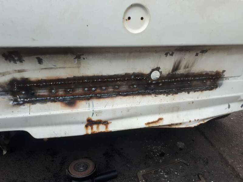

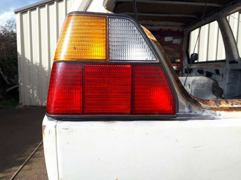

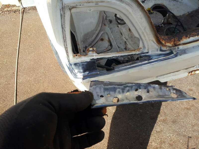

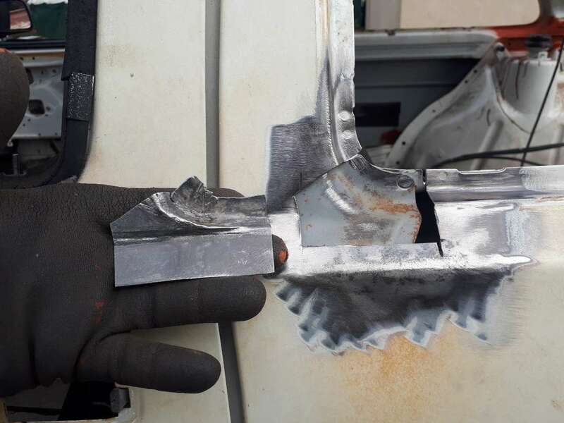

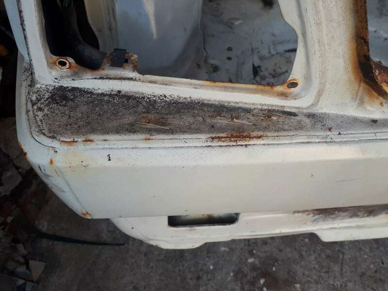

Another common rot spot.
Under the rear tail lights.
Some rust appearing under the seam sealant too.
Cleaned off.
Grot chopped out.
minor repair in the lower flange.
Ground down.
Patch made.
Patch welded in.
Welds cleaned up.
Taillight still fits,time to do the other side.

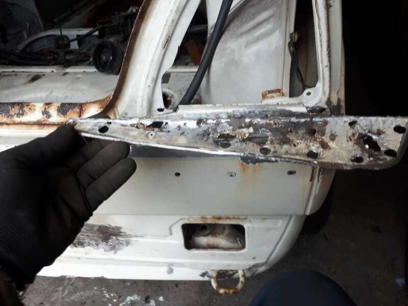

Time to do the other side.
Was much worse.
Chopped out.
Lower mounting edge had rusted through too.
Never mind,it can be fixed.
First repair welded in and being cleaned back.
Ready for the top repair now.
Made from the same old sill panel I had used to repair the boot floor edge.
Welded in.
Check the taillight fitment.
Squirt of red oxide primer.
Done.

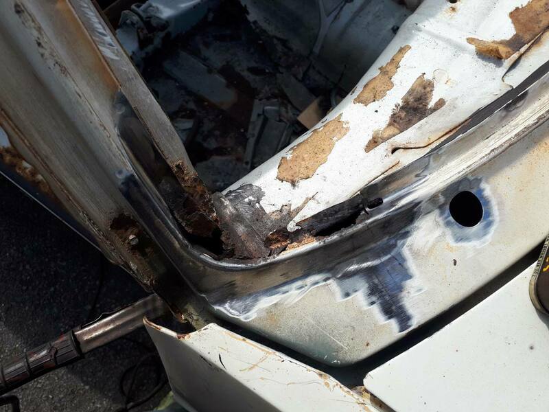

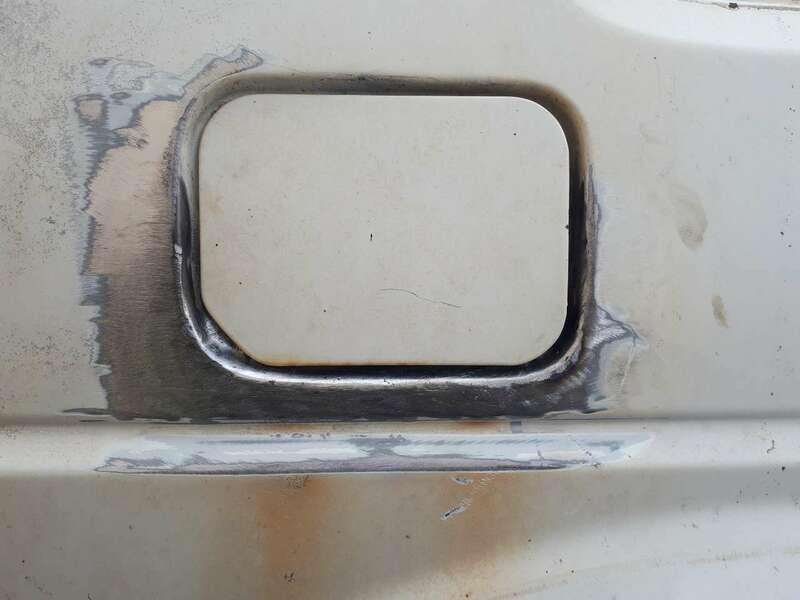

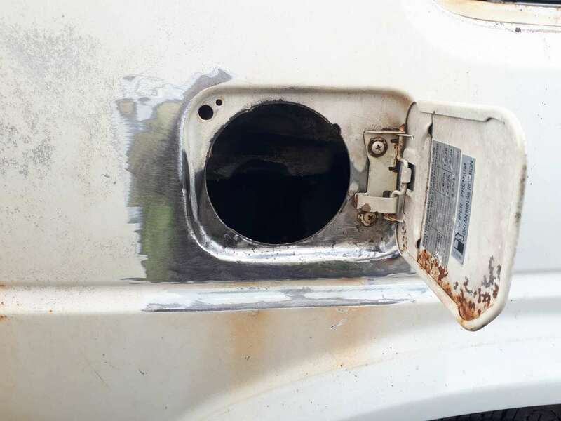

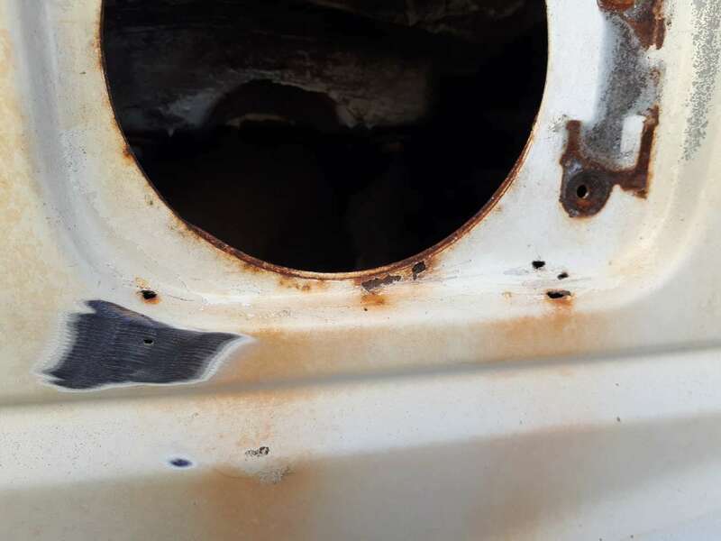

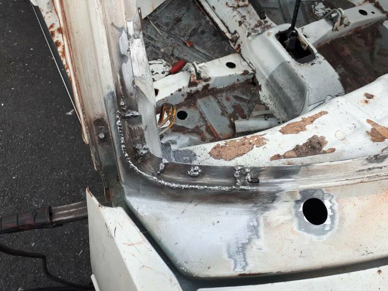

Next was the fuel filler surround.
Surprisingly good on this,it's a common grot spot,my 5 door was really rotted here,both inside and out.
The inner on this is mint,no work required at all.
The outer has a few pin holes though.
Ground out the worst of the rot and let in a small patch.
Ground down the welds and test fitted the flap.
Done.

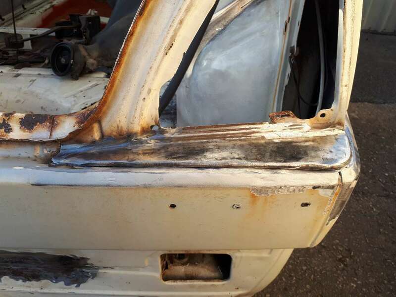

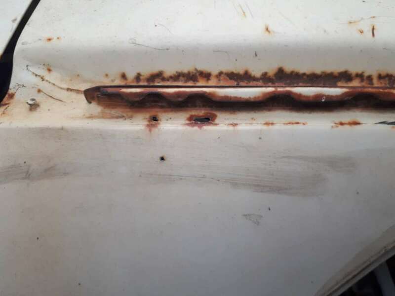

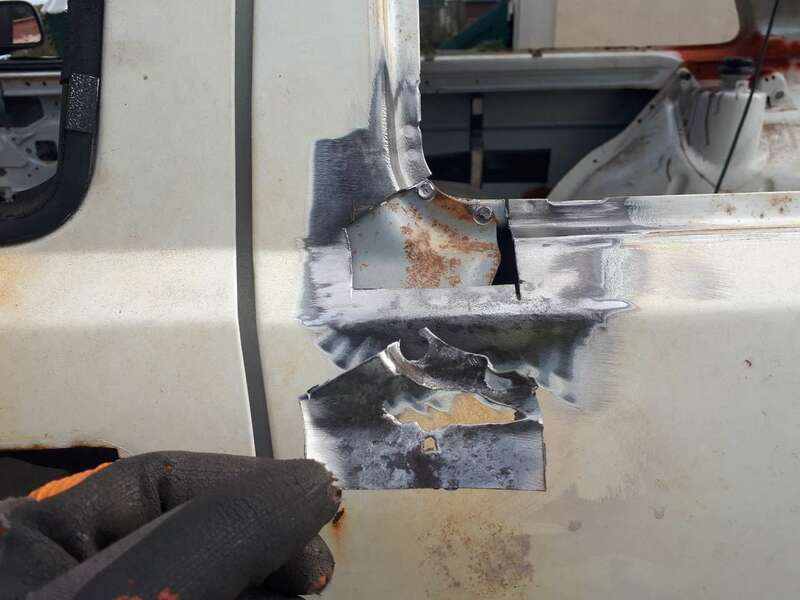

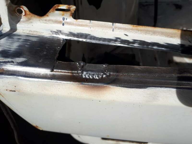

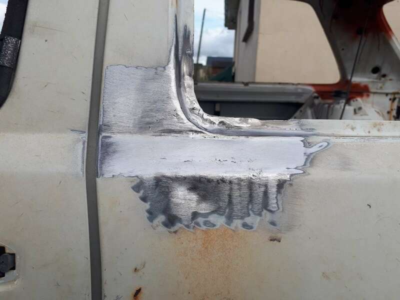

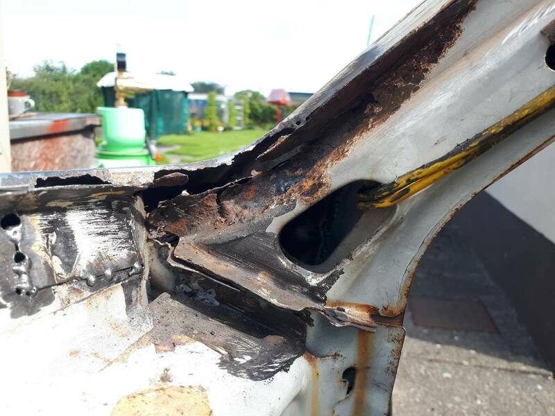

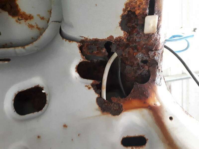

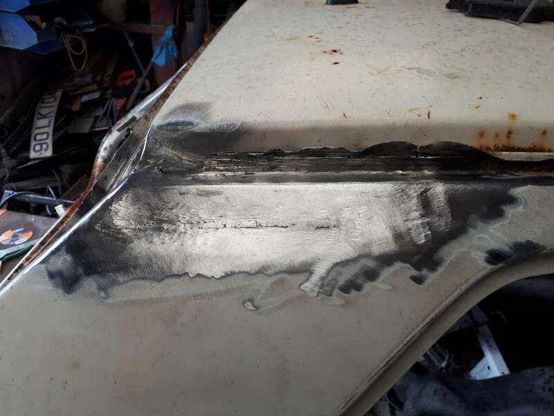

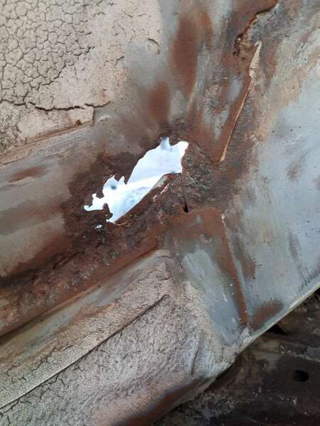

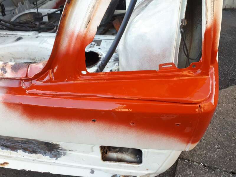

More rot,this time the top of the offside rear 1/4.
Underneath too,never seen one rust here before.
FML.
Chopped out the top,donor car helped here once again.
Same underneath.
Welding upside down is such fun*
Some surface rust was ground out around the wiring grommet hole too.
Squirt of red oxide primer and we're done.
Such fun.

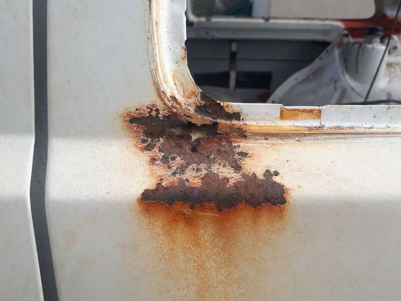

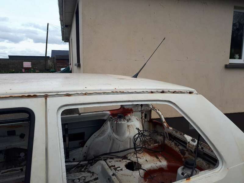

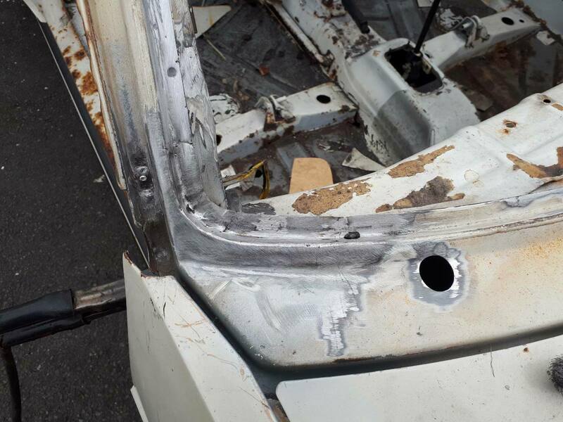

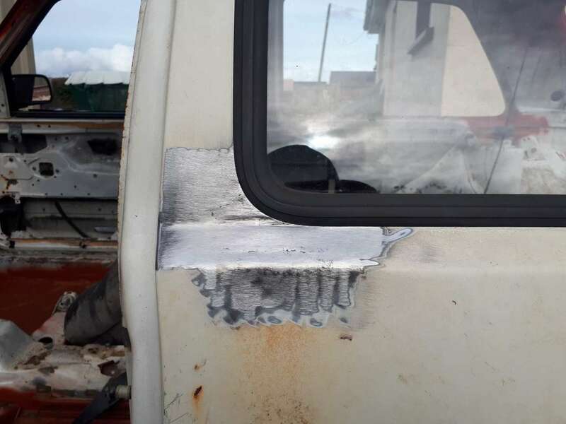

Surprisingly good on the rear window seal channels,I've often seen 3 door Golfs totally rusted through here.
This is the only grot in this aera on this shell.
Cleaned up.

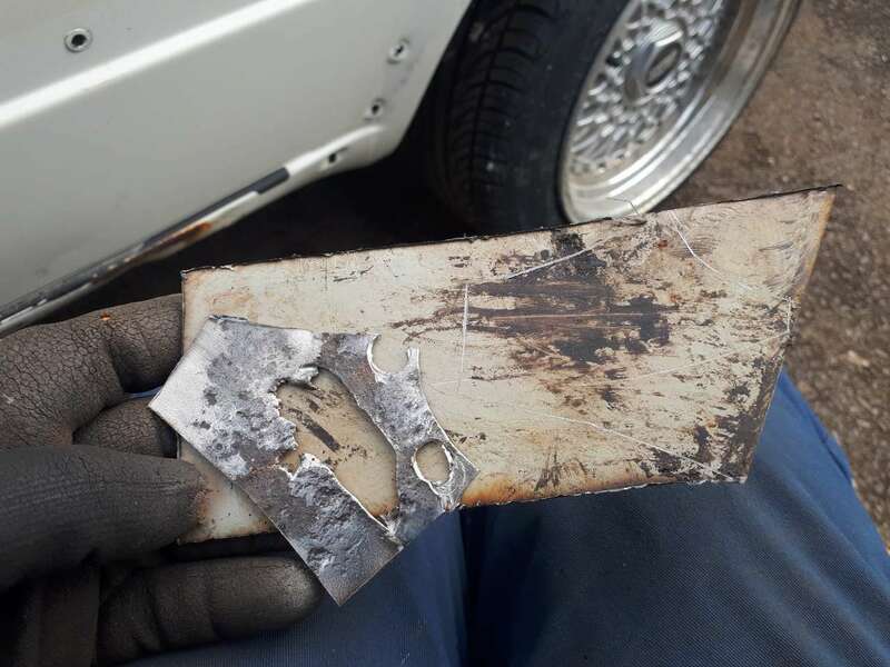

Chopped out.
Flattened out.

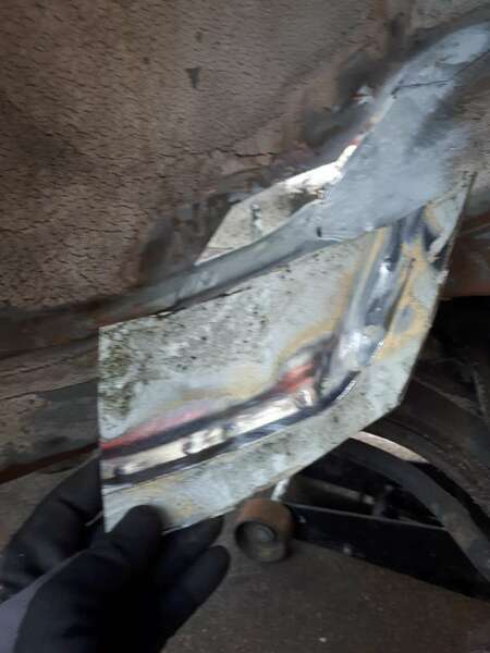

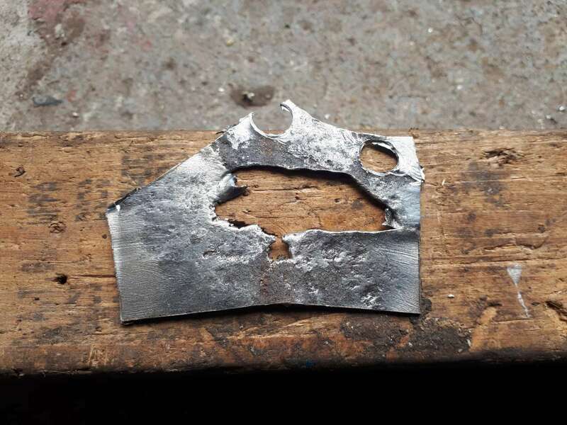

Scribed around it on a leftover piece of metal.

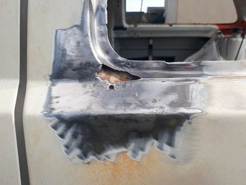

Much twatting and bashing later,This slightly misshapen patch.
Welded the flange on with the spot welder then seam welded in the rest.
Ground down,had to add some weld to the curve to get a good smooth match.
Its a miracle,the glass still fits😂
The body line under the repaired aera still needs a bit of work as the body was dented,will sort it when doing the paint prep,that is a while off yet.

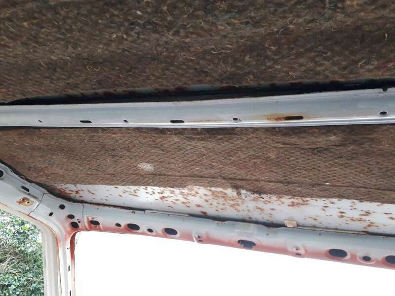

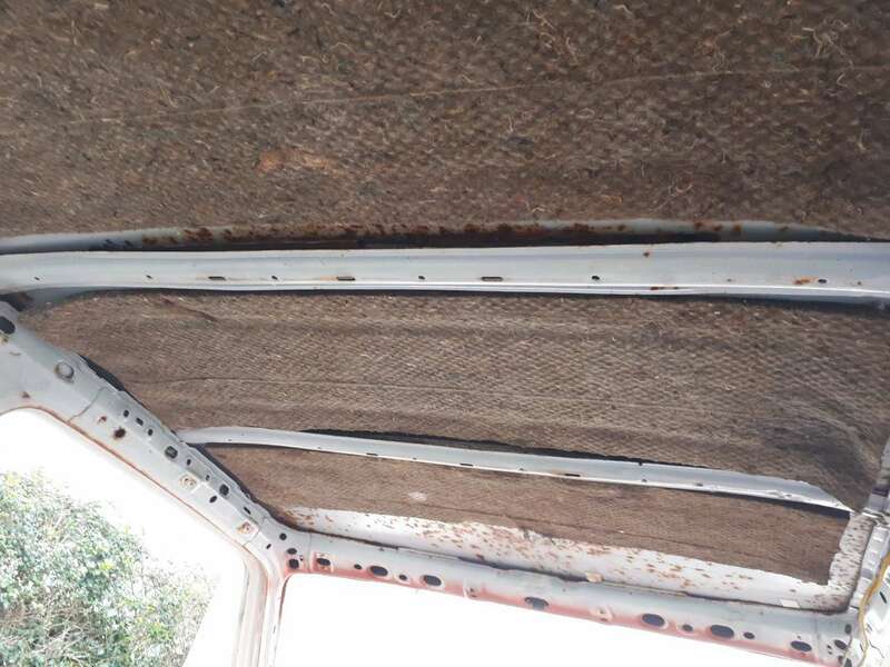

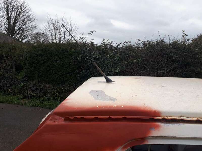

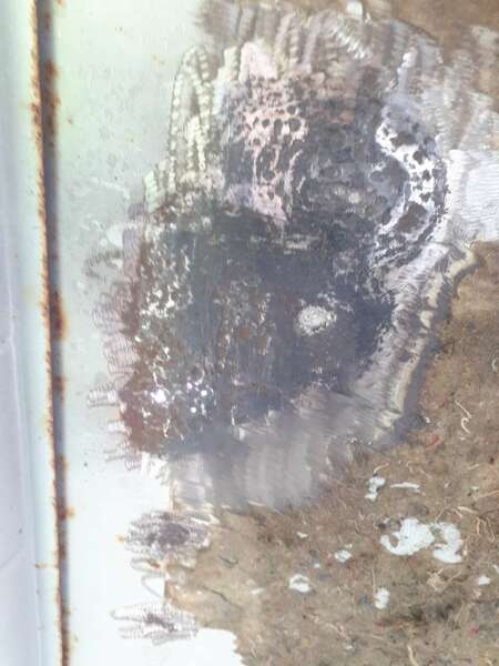

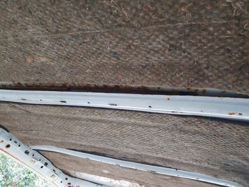

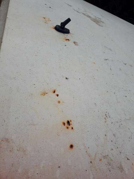

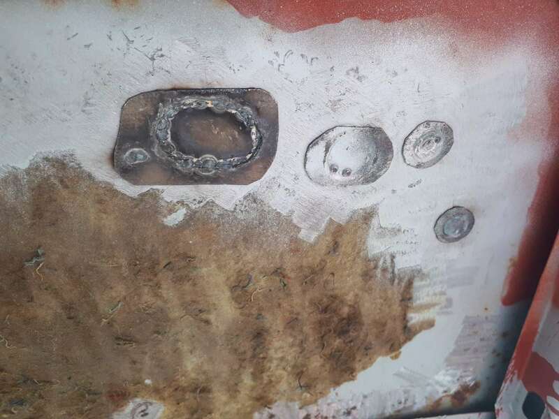

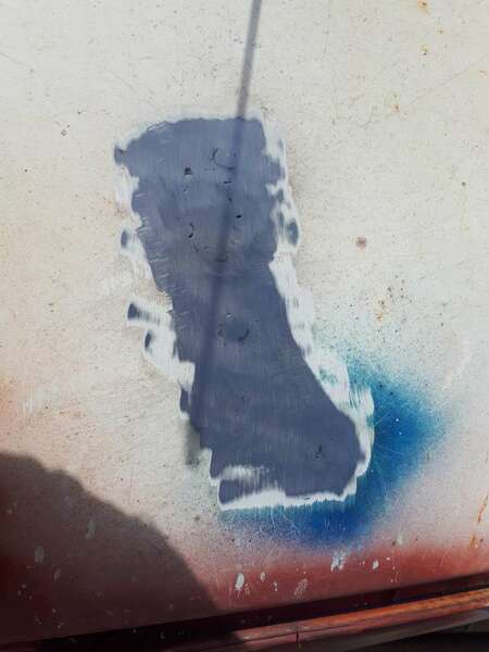

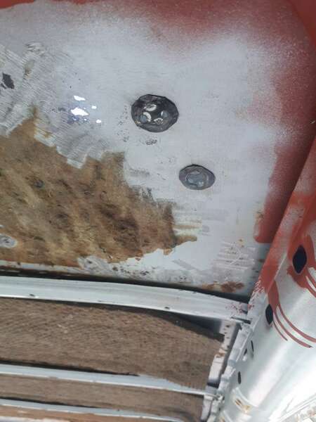

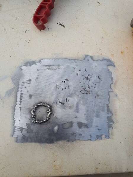

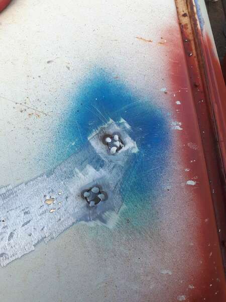

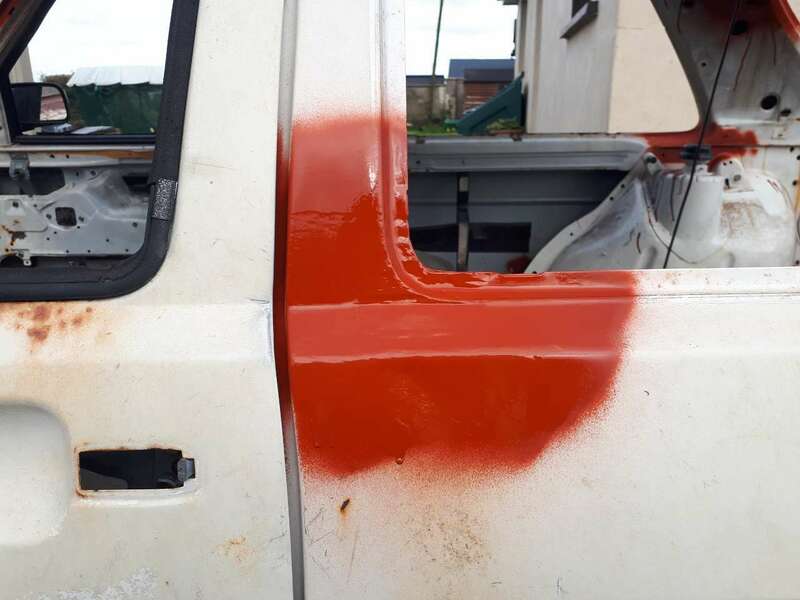

Roof skin repairs next.
This had a 'Bee Sting' aerial fitted at sometime,and had let water through into the sound proofing material below with the inevitable result.
I did toy with the idea of reinstating it,but decided not to.
Grot!!

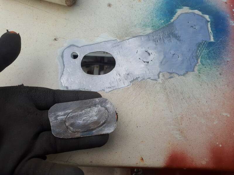

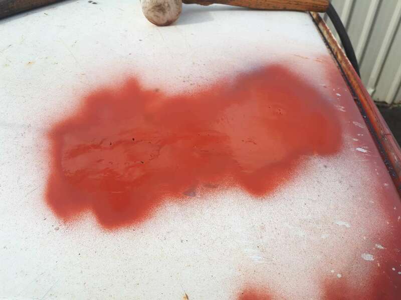

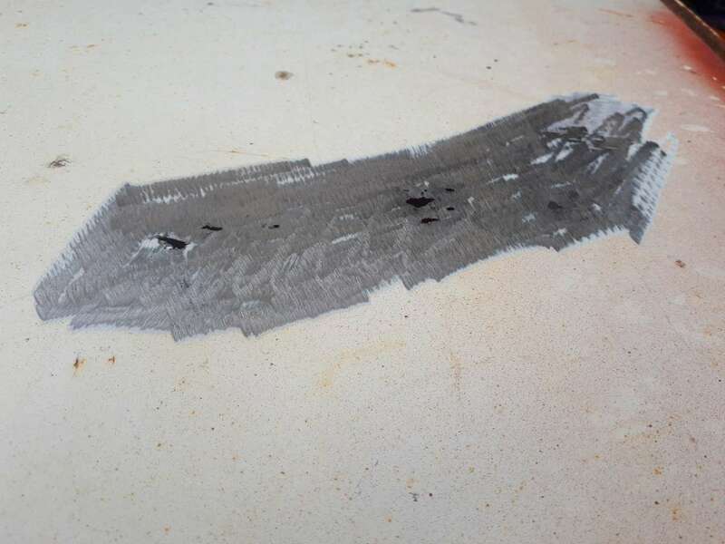

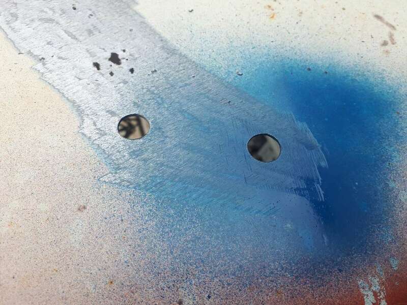

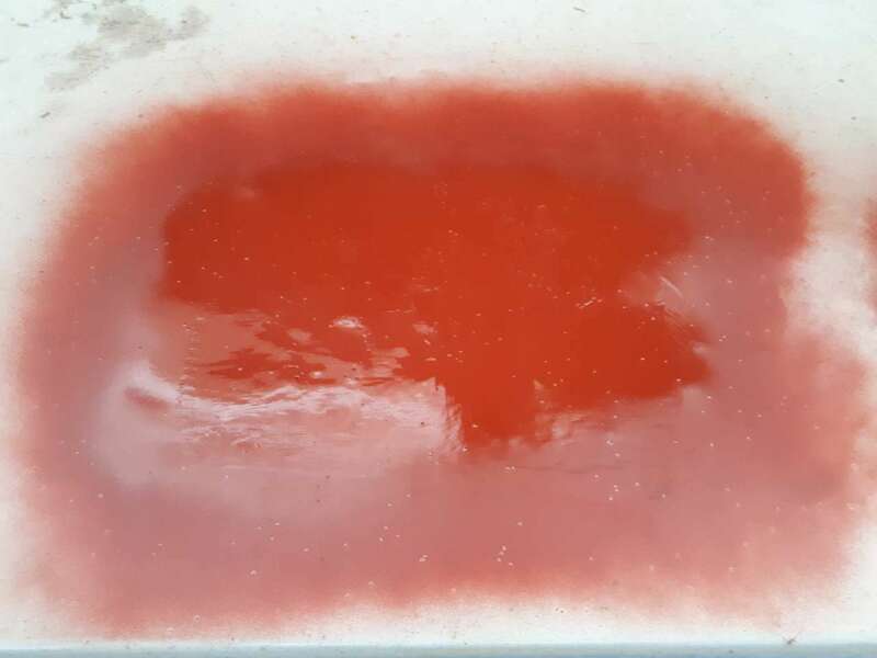

Decided to drill out the rust rather than use a grinder to cut out square patches.
Sprayed some paint to get an idea of size.

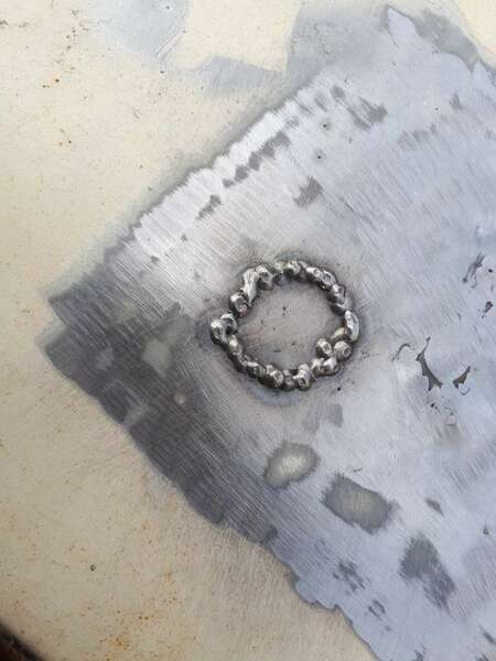

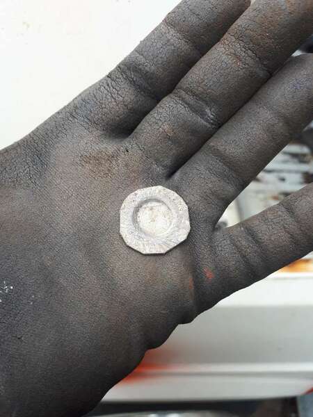

Whacked a dimple into the metal using a socket.
Nice fit!
Start welding.
Some tapping required to get everything flush.
Next patch.
Ground flush,happy enough with the result.
Squirt of primer and that section is done.
More of the same around the aerial hole.
Start by cleaning up the aera.
More of the same...
Welds dressed back with a flap wheel.
Primed.
Can't say I'm best pleased with this repair as the roof skin has warped,not hugely but enough,I'm guessing it being jumped on previously hasn't done it any favours,the strengthening ribs are detached from the skin as they are bent out of shape.
I'll get to this problem in time.
