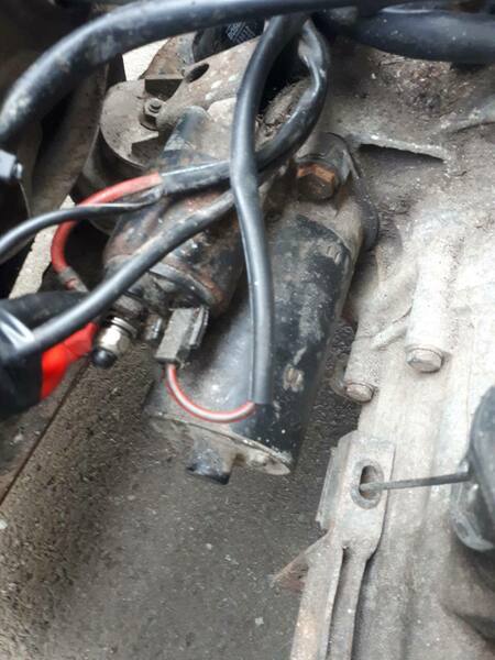

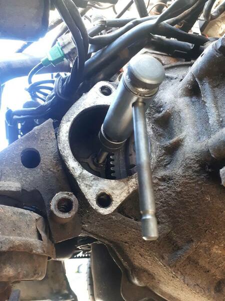

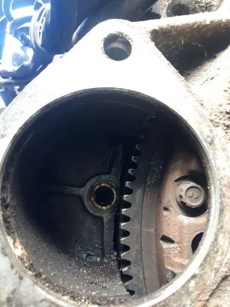

Next small task was to replace the starter motor bush in the gearbox,
So first remove the starter that Vw handily decided to also use to bolt on the front engine mount,so the engine has to be supported.
Wind out the old bush with an m12 tap.
Old and new comparison. Same as a beetle apparently.
JYD patented VW starter motor bush insertion tool!
Whacked home.
Starter refitted.
Starts much better now,

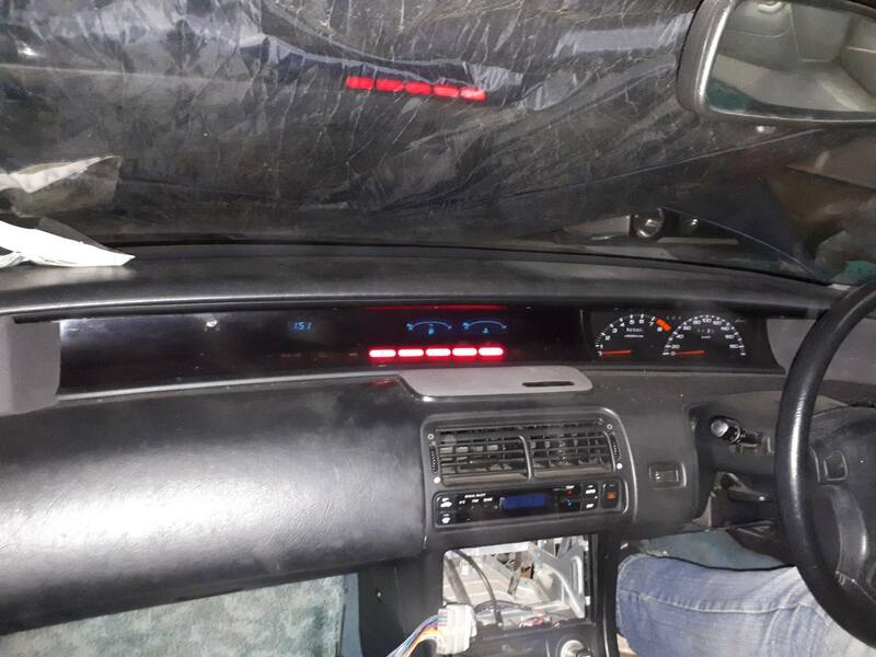

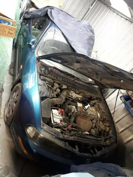

1991 JDM Honda Prelude Si 4th generation powered by the mighty H22A Vtec engine,unusually this doesn't have 4ws,an option in Japan apparently.
A splash of fresh fuel and a charged up battery and she started more or less straight away,I don't think it's run since 2009!

That's ace, mate of mine had a 4WS H22A 4g Prelude, the dash on them is one of my all time favourites.
Is that in the Dash at Night thread yet?
Nah, I just lifted it off my mate's Facebook, it wasn't my car so never posted it.
Mine needs to be cleaned.
They are one of the best dashboards ever though.
I wouldn't mind another Prelude. The dashes really are fantastic.

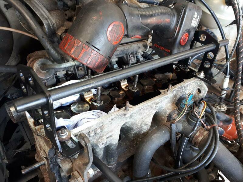

So far this has done 1,500 miles since being put back on the road,
One issue that came to light has been it liked to puff out blue smoke in stop/start traffic,and the associated oil consumption that this caused.
So,a set of valve stem oil seal replacement was on the cards.
I didn't want to remove the head to do this,so a cheap valve stem replacement kit was purchased online.
Time to delve in.

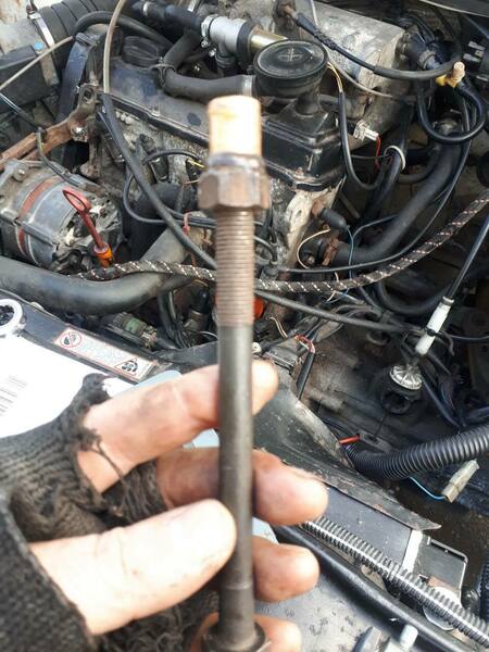

Cam belt off,and camshaft out,screw in adapter into the spark plug hole,and connect to the airline.
Then you can remove the valve springs and replace the seals.
Bit off a faff, but got there in the end.

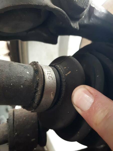

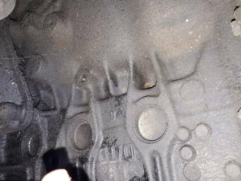

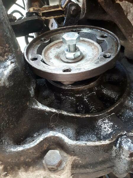

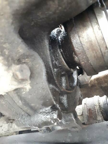

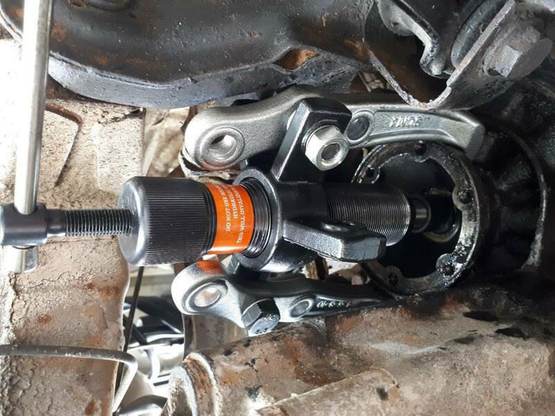

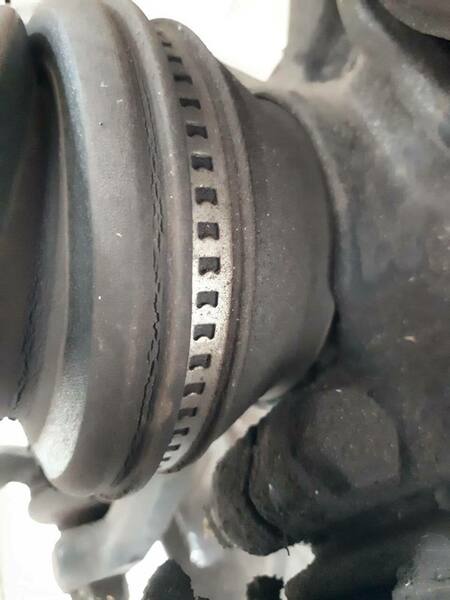

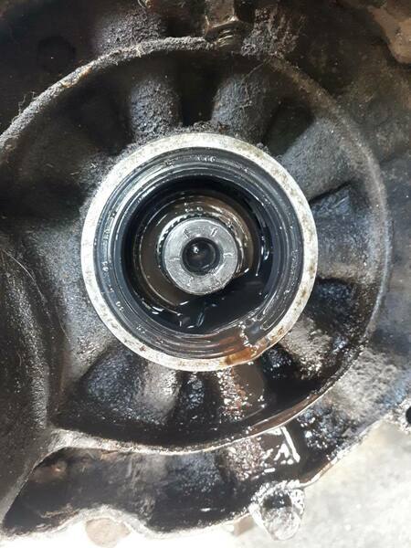

Today has been another battle with an oil seal,this time the nearside gearbox output shaft.
Drip on the lower gearbox casing.

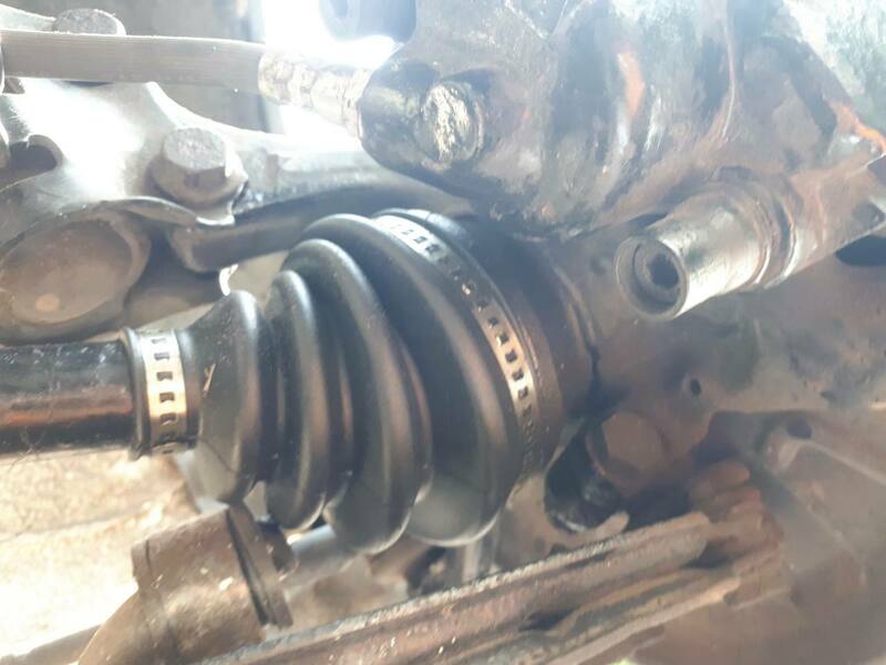

The new CV boot I fitted wasn't looking to clever either🙄
Less than 2 years old and a smidge over 1500 miles.The factor replaced them FOC,will see how long this one will last.

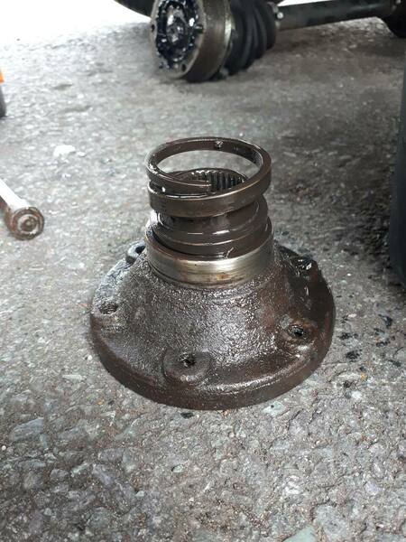

Driveshaft removed,had to use a puller to get the flange off the splined shaft.
Old seal.
Best make sure they are the same...
Driveshaft flange.
New seal fitted.
Time to wind in the flange again,used a nut,bolt and a large washer to get it in far enough to put the retaining clip back on.
Back together again.
New CV boot,I despise them.
And that's about it,seems to be ok,will check it again after a few miles have been done.
The other side looks a bit damp,but is not leaking oil,so will leave it be for the time being,I got another seal just in case.

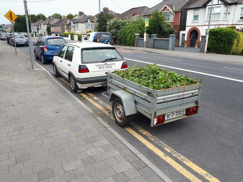

Not much to report on this,I hardly done any miles in this at all this year.
I did use it to take some hedge clippings to the tip though.
It currently resides in my cousins garage.

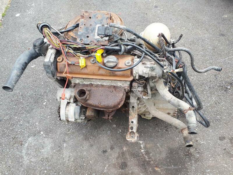

I bought this year's ago,it had a blown up engine, so I converted it to a 1.3 carb,no idea why I just did.

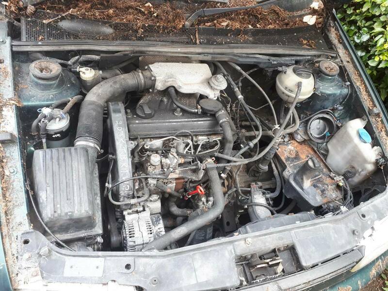

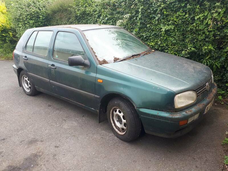

This rotten Mk3 is the doner
Its a 1.9 straight diesel,but I have all the parts to turbocharge it.
Will see,lots to do beforehand though.

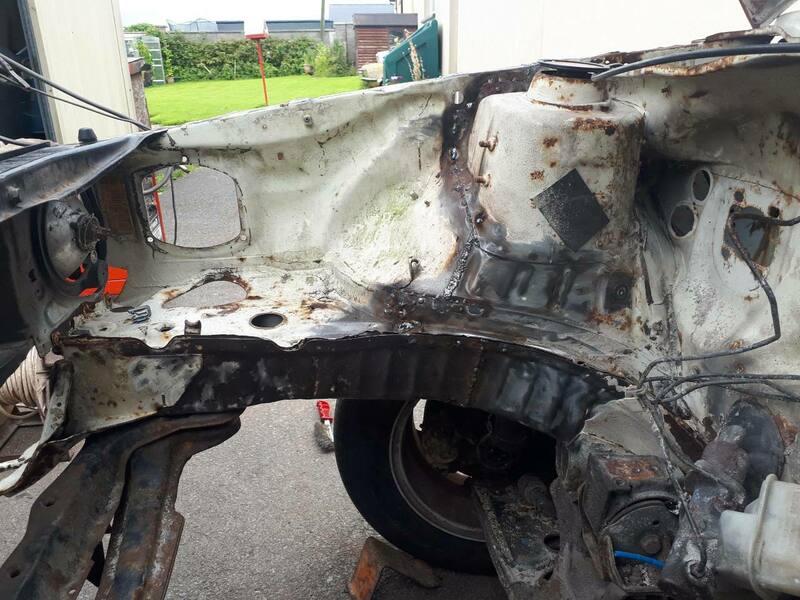

First job was to remove the 1.3 engine and gearbox.
This had approx 70k on it,advertised it online and it sold within a couple of days to a guy who wanted it as spares for a Polo,that put a little bit of money back into the coffers.

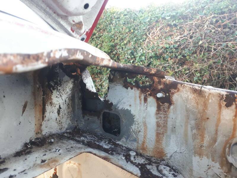

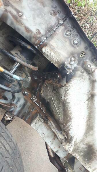

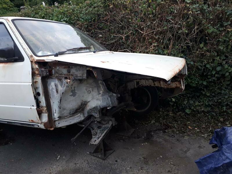

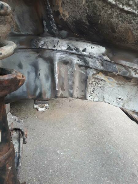

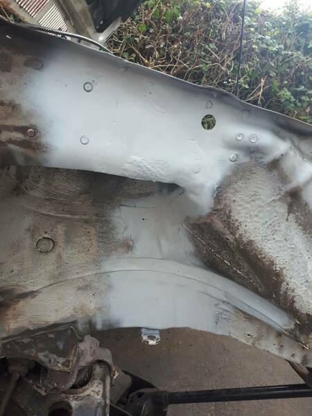

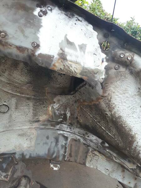

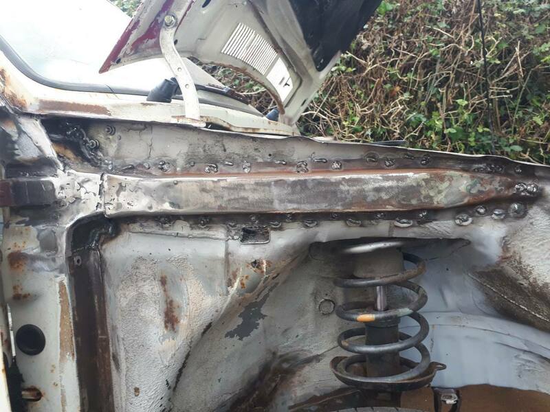

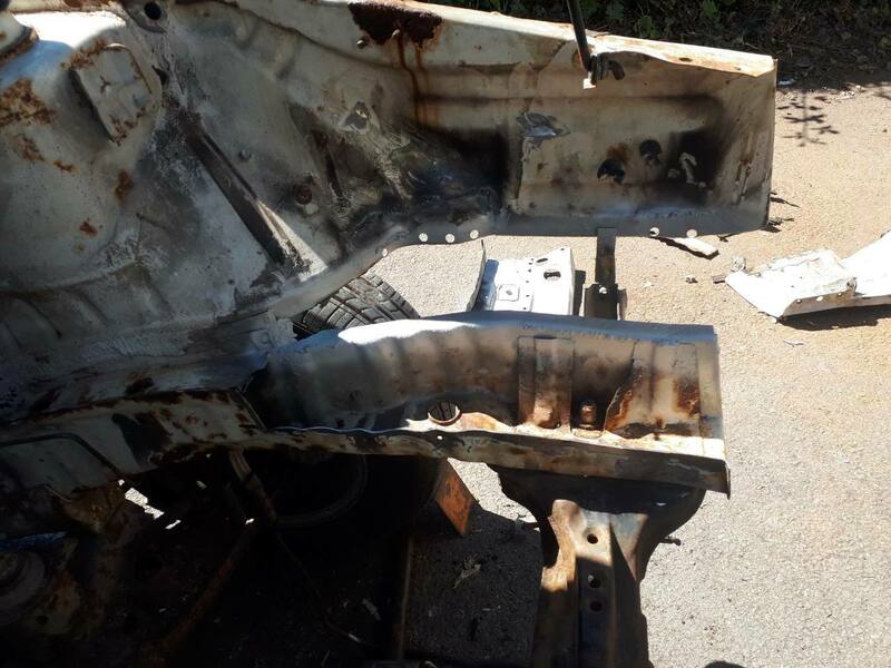

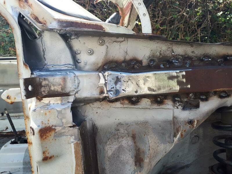

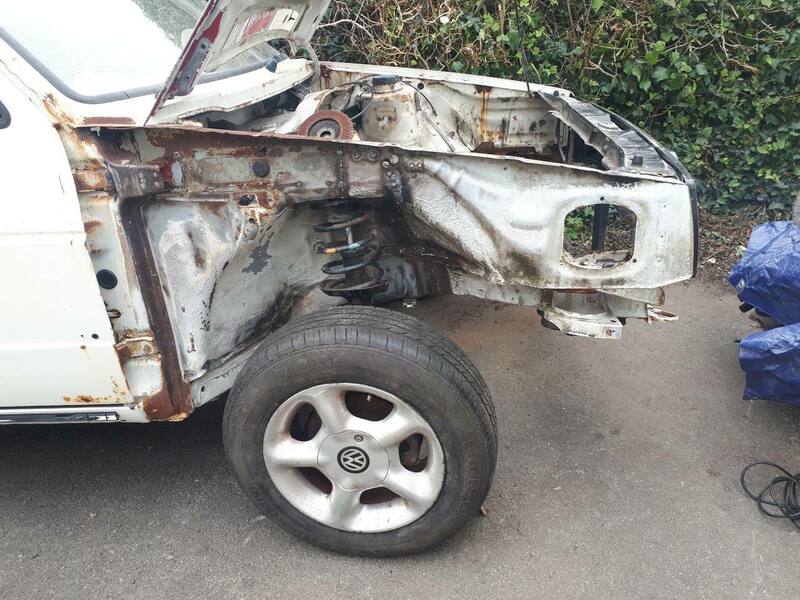

Then it was time to start on the most daunting part of the resurrection, the front offside chassis leg and valence.
This had been damaged sometime in the distantpast and not repaired very well,resulting in the chassis rusting through,inner wing/valence was a mess too,so it was chopped off just forward of the strut tower.
Quite scary.

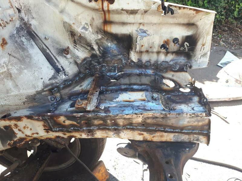

Time to stitch in the doner part.
IMG-4496552919a5d676b4e430ce43ee1211-V.thumb.jpg.5edcc7405fa076d58cfbe067a1e7a526.jpg
Welds cleaned up and a squirt of primer applied.
First shell repair completed,you've got to start somewhere I guess.

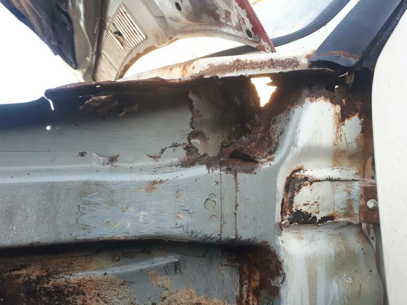

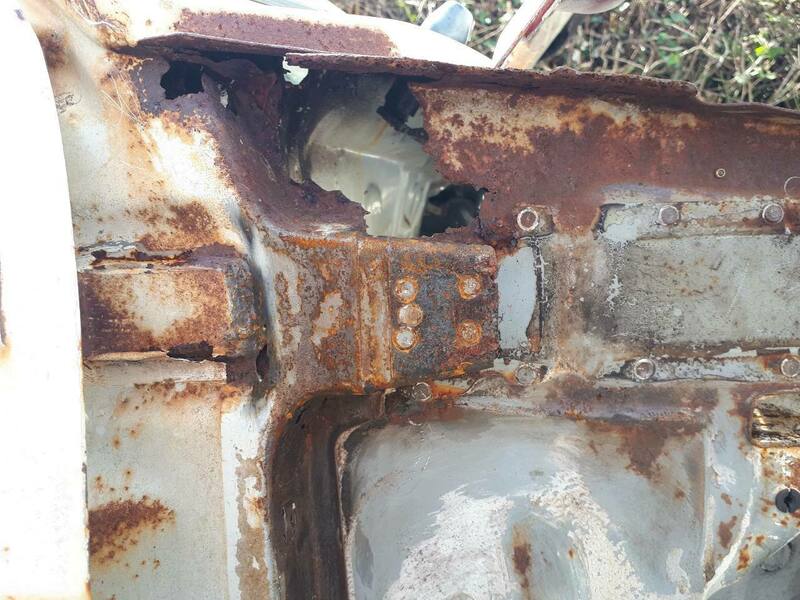

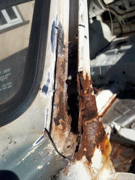

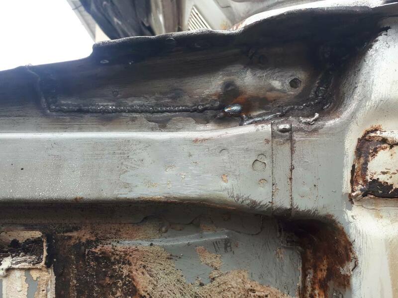

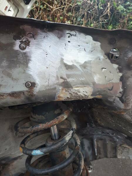

Next,time to repair the drivers side bonnet hinge panel.
Start by offering up a repair panel.
Chop out the grot.

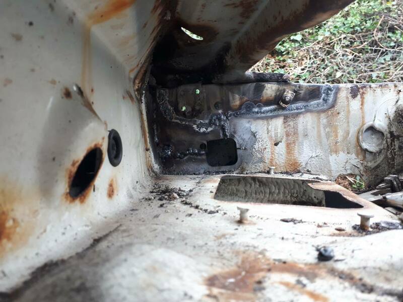

Start to weld in the main patch.
Strengthening panels welded back on.

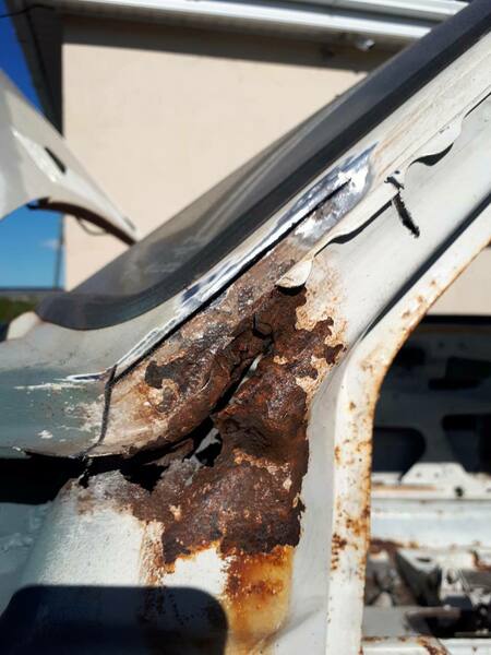

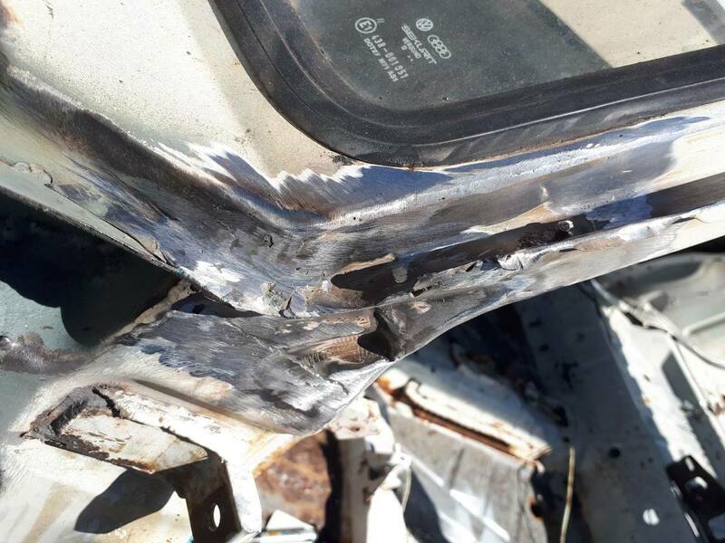

Replace the outer skin on the A pillar.
Give it a squirt of temporary primer.
Another bit done.
Just the other side to do🙄

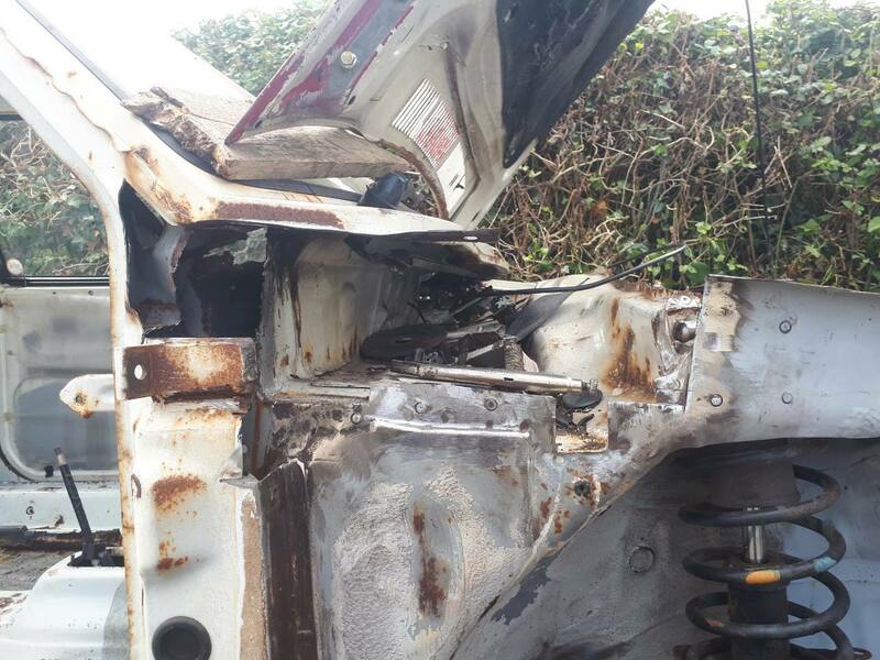

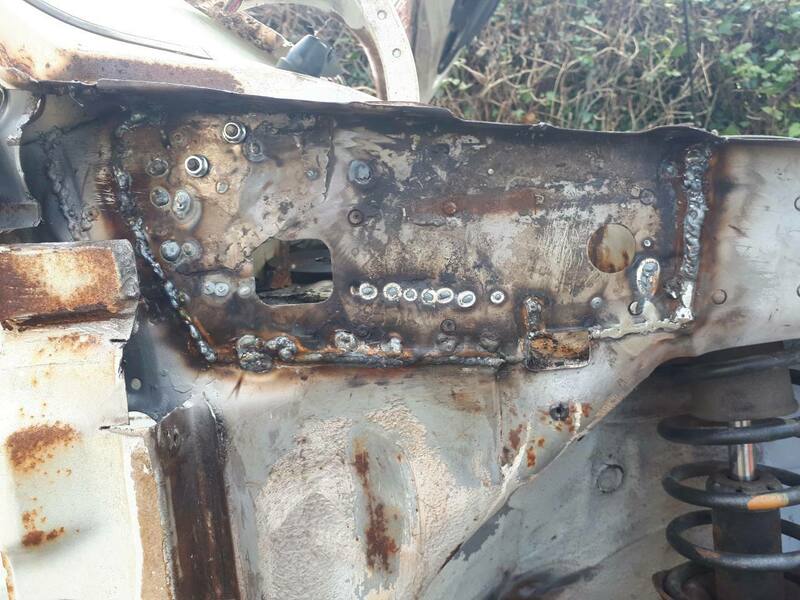

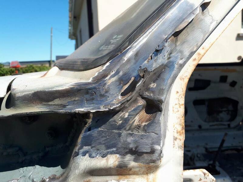

Passenger side hinge panel next.
Now at least the bonnet can be reattached.
Bit of grot around the A pillar to deal with too.
Done.

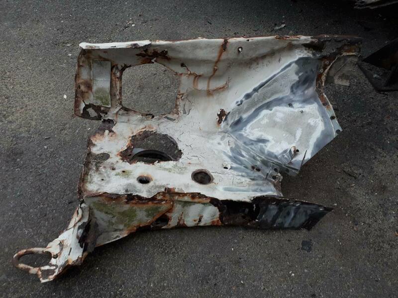

Battery tray next.
  • Like 9
7 minutes ago, Tickman said:
Excellent work again.
Thank you,It does all feel a bit deja vu though!🤣

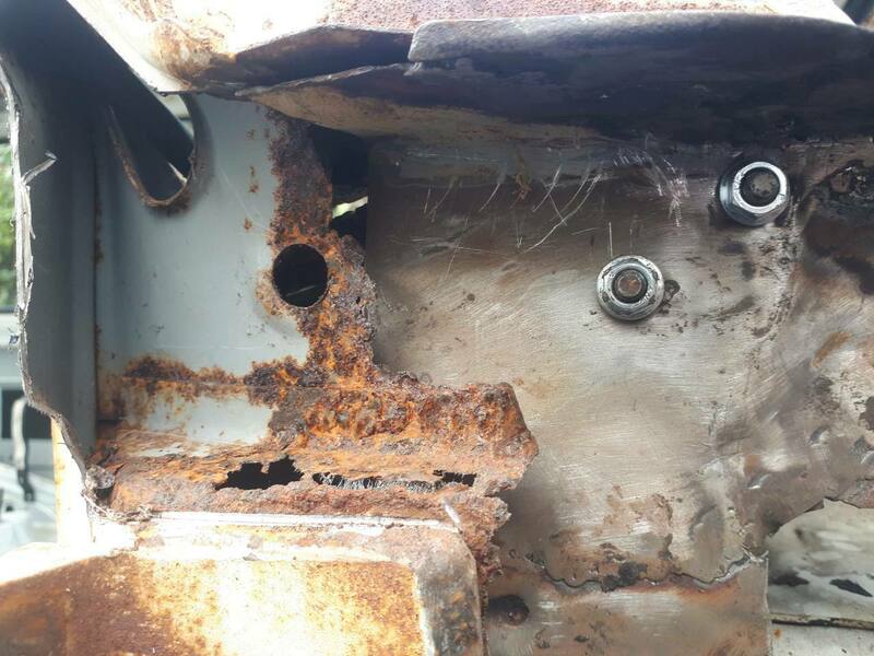

Battery tray next,
I forgot to take a pic of the before, but there wasn't a whole lot left of the original.
You can buy a repair panel for this,but where's the fun in that,so I repaired an old doner one.
Old metal trimmed up,and a squirt of weld through primer added.
Repaired battery tray welded in.
Welds cleaned up and a quick coat of primer,still needs seam sealer adding but for the moment it's done.
