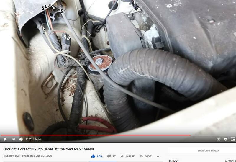

If it's a more modern coilpack, any idea what method it uses to send a crankshaft position signal to the coil? You could be hotwiring the car all day and still have no spark because the crankshaft position sensor or its wiring is duff. Does it still use a dizzy?
Got any close-up pictures under the bonnet and of the associated plugs for the coilpack, etc? Would help to check continuity to ground so you can rule out some of the pins before bashing 12 volts down 'em. 👍
Edit2: Just re-watched one of the Sana videos, i assume the module under there is the coil pack? I numbered the wires to make discussion easier. Follow the red wire (number 2, not 7/8) back to its source, you might find something. Is wire 5 the HT kinglead to a distributor? Where does wire 6 go?
Edit3: Just realised you said its a fiat engine, you could find a haynes manual for a fiat that uses the same engine and look for the wiring diagrams, it will help you identify what wire is what, most likely. 🙂
I would want to see a bit more of the system(and the hotwiring) before commenting too much but AIUI there is a distributor with some form of electronic trigger, so 5 is the HT king lead.  I would be looking next for 12v at the coil pack.
