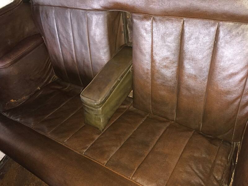

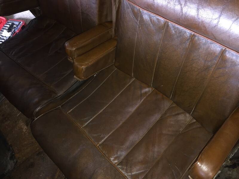

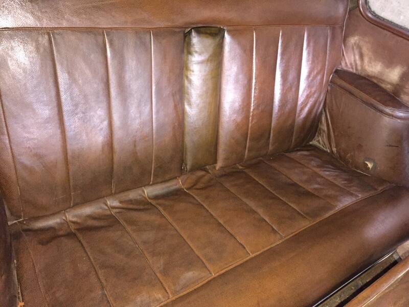

Conveniently ignoring the piss poor state of my bodywork, hopefully one area I can make Mr @vulgalourEsq. jealous in is the condition of my seats.
I did them today with Gliptone liquid leather intensive cleaner, then with the conditioner. I’ve given them three thick applications of Gliptone conditioner and they’re getting softer with each application. Very pleased with how they’ve come out, they feel and smell amazing, and they’re extremely comfortable as well!

They look wonderfully comfortable. That's a satisfying job, I did my 164 with hide food from a tack shop and they went from biscuit to supple in about a week and several applications.
The back seat should certainly be comfortable with 6" of dunlopillo supporting your posterior. 13.4/10 wood reed agane.
Those seats are rather nice.
I would genuinely take those front seats indoors and use them for viewing my TV until such a time that they were needed back in the car.
Great job. They look seriously comfortable.

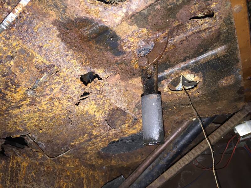

Here’s the rusty bulkhead looking up from below. That’s the bonnet release lever you can see sticking out, totally seized solid! The cable is broken too, fortunately there is a manual override on the front of the car. I’ve lubricated this and it now works ok.

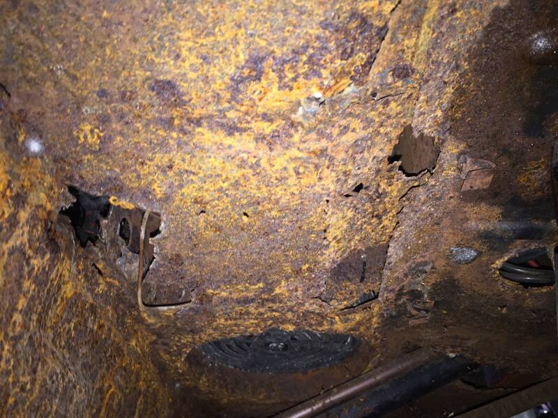

I think this side is solid, this just seems to be surface. This is looking up from the passenger footwell.
Crusty centre section.
You can see that hole from the engine bay side.
