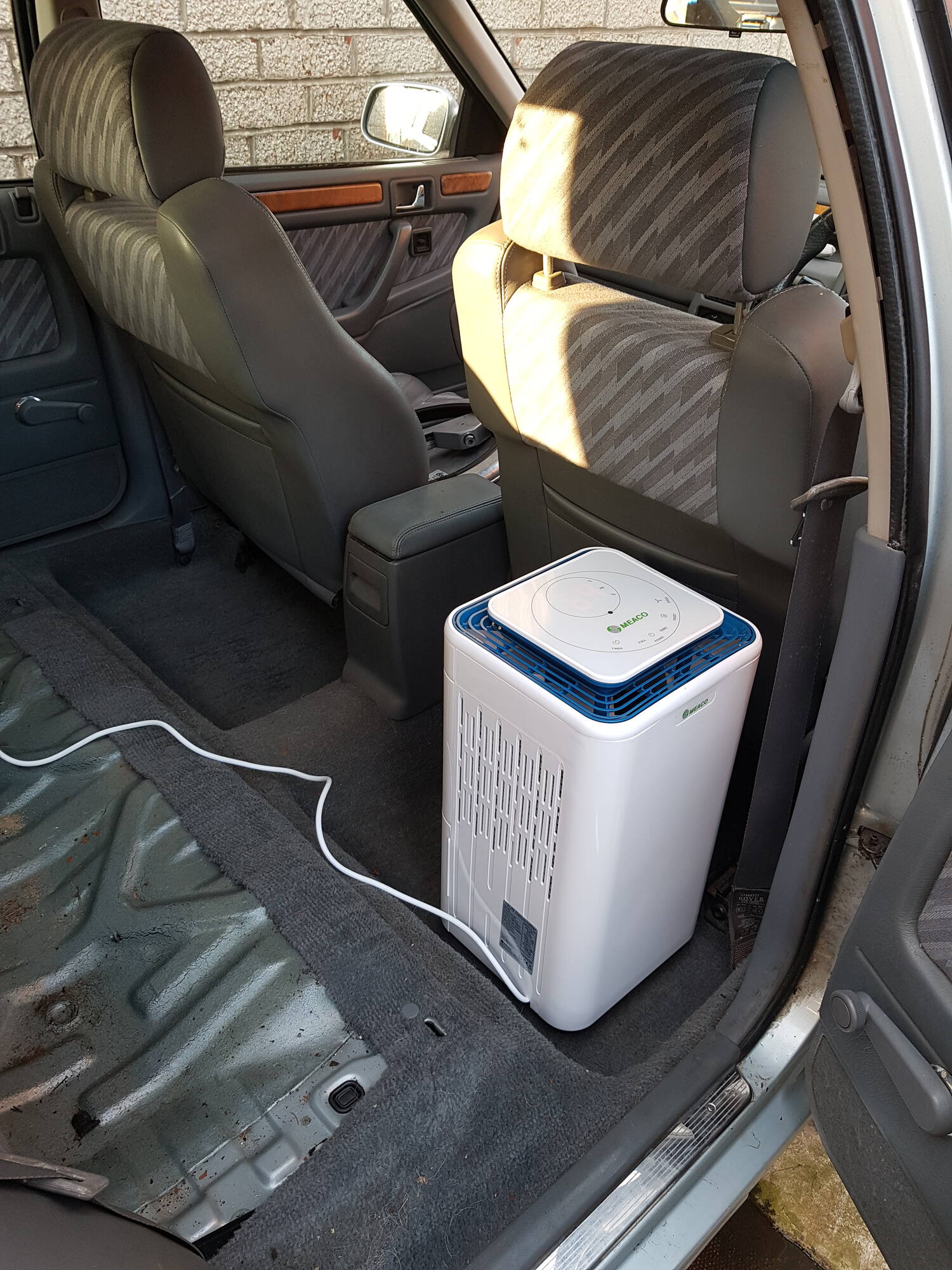

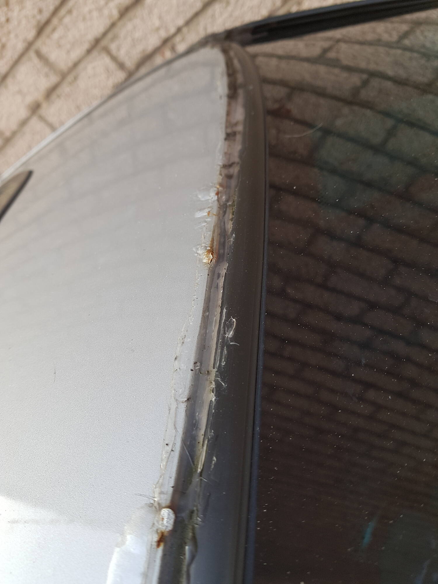

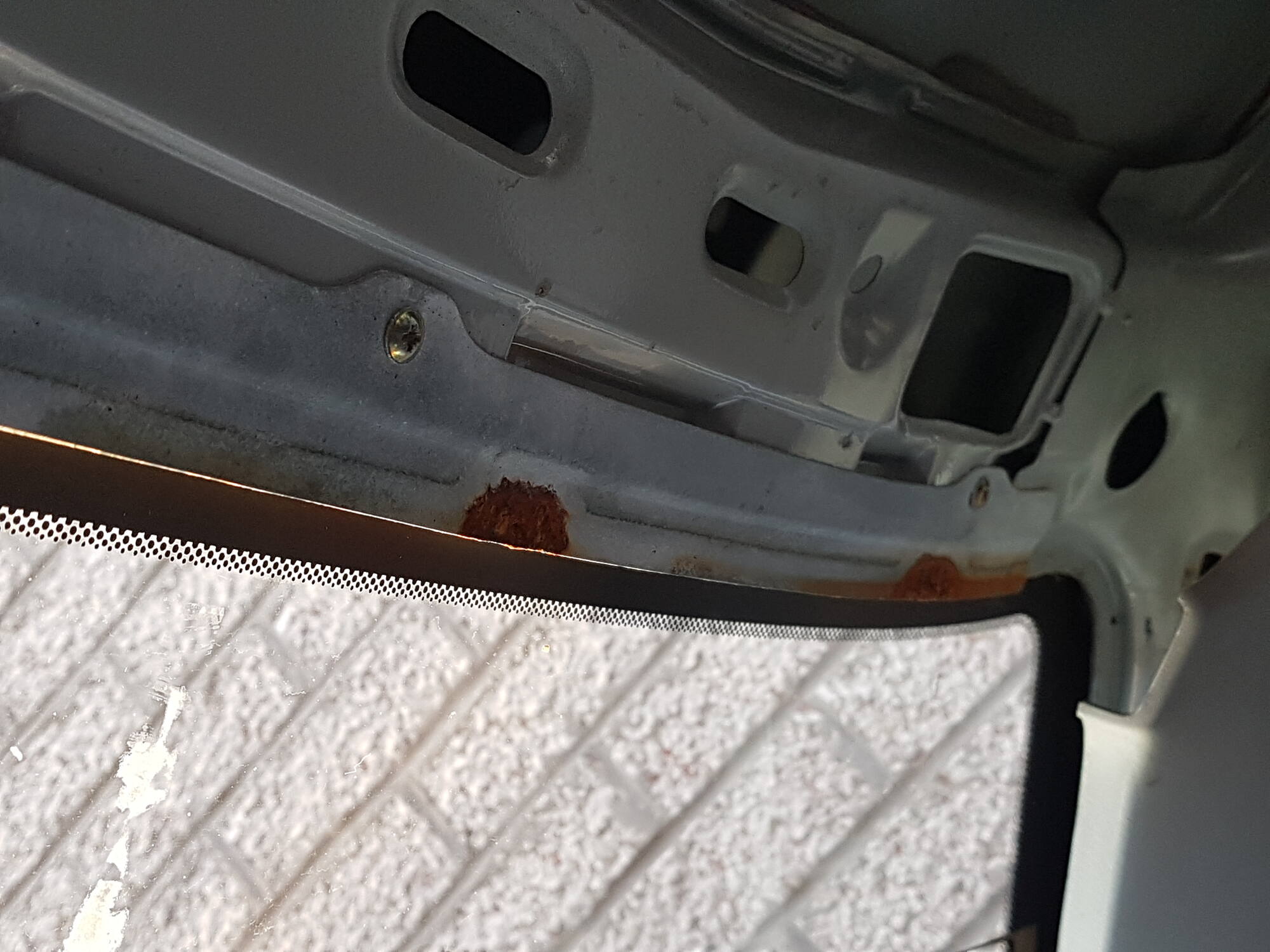

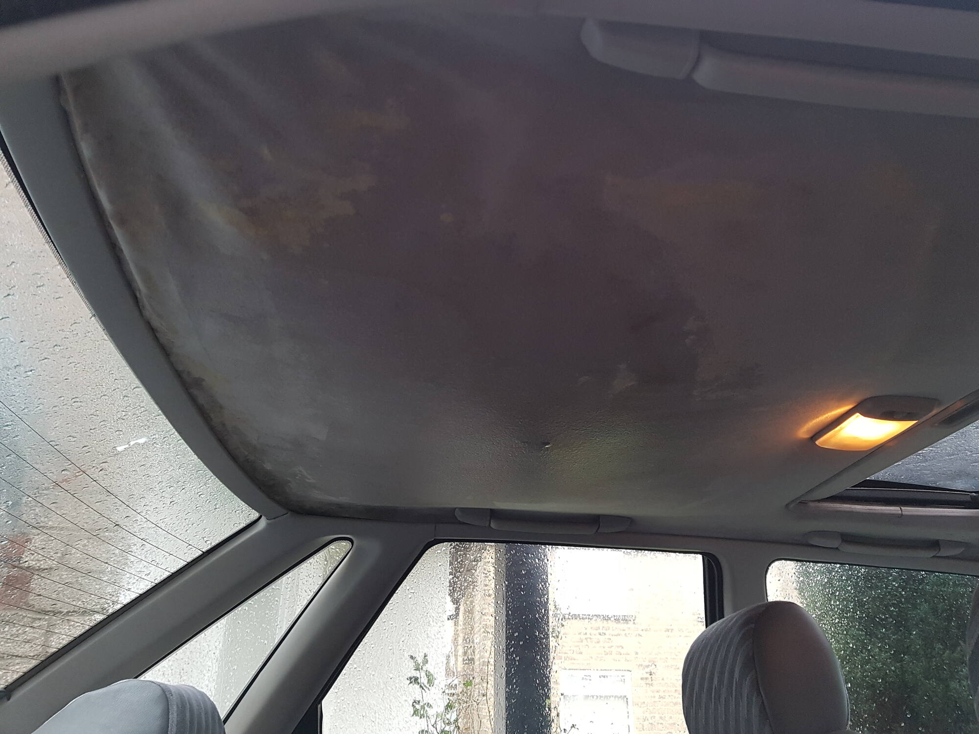

Austin-Rover Posted January 23, 2020 Author Posted January 23, 2020 The drying out continues; I've run a strip of tape along the top of the rear window and - as a temporary measure - seem to have stopped water entering the cabin there. It's a window-out job ultimately. No leaks apparent from any of the sunroof components. Since the last update, it became apparent that to speed things up, the front seats were going to have to come out, along with the carpet and foam pads underneath. Saturated foam pads are HEAVY! This car'll be even quicker when it's dried out! ? In other developments, I've started cleaning up the removed interior plastic parts ready for reassembly. Take a look at this grab handle to give you an idea of just how gross the inside of the car is! Skizzer 1

rusty998 Posted January 24, 2020 Posted January 24, 2020 Have you removed the metal strip with the rust on it ? It just needs the screws removing and then you can see if the rear window aperture has rust on it, If you can see black foam the window could well be original, If the foam is not present and or damaged it might have had a replacement at some point, The front screen top seal was always a hard rubber/plastic and would chafe through the paintwork causing rust at the front, Also the front screen side trims are clipped on to the bodywork and if the screen has been replaced but the clips on the side trims not then that can cause water ingress, Personally I would be checking the front screen at the top because of the obvious rust that is showing first, The rear screen has trims that are clipped on with many different types of clip all the way around, the bottom ones go through the bodywork iirc, they came new with foam seals on them but the seals could well have turned to dust by now, I've spent many an hour in the boot of a 400 whilst it was being hosed with water from the outside, Also I would remove all the door cards to check the plastic membranes as they can shrink which will let in water, or might be damaged by someone who worked on the door, I've seen many membranes that have just been punched through or cut , That should give you plenty to be getting on with for now, hope my advice is helpful, And I'm not in one bit envious of your TURBO Rover, it's a lovely motor.
