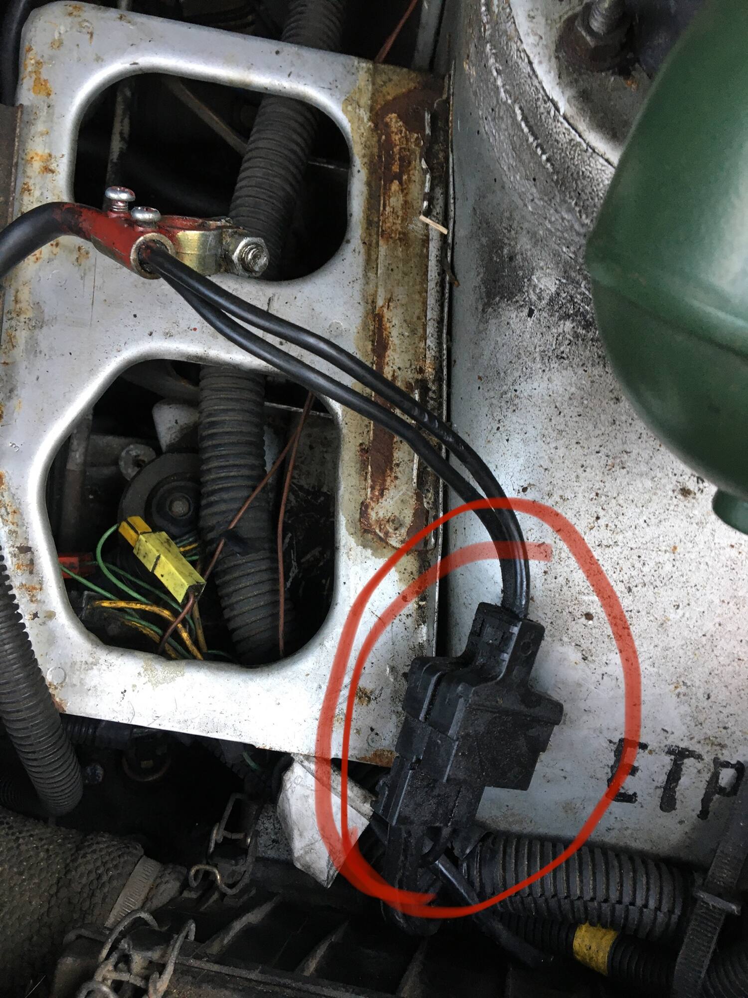

This is the solenoid wire in near the battery tray. Note the abundance of that green cable which doesn't look kosher.

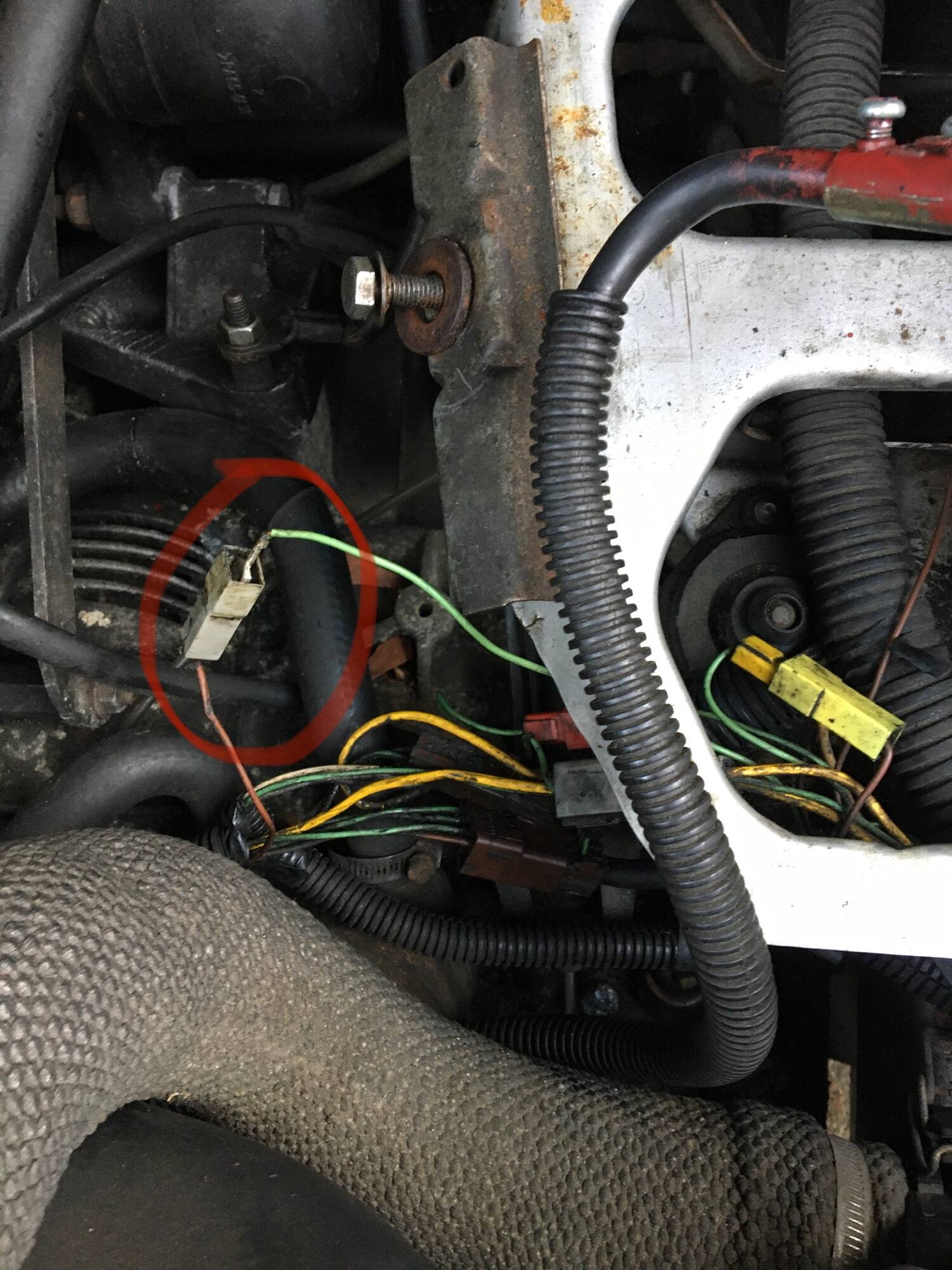

Are these OE? Coming from the + terminal. I'm guessing glow plug 12v feed?
I reckon this must be the glow plug relay and maybe solenoid relay. Abundance of green wires arouses suspicion. There's another relay behind the headlight in a little plastic waterproof sleeve.. anyone else got this?
Basic I know, but is there a good earth from the engine to the body?  Try it with a jump lead from engine block direct to battery negative?
Good shout, I haven't tested that, though I'm not sure it would explain the glow plugs coming on with the solenoid shorted?
It just might.  If there is a bad earth from the engine, the power tries to find another return route and you can get some odd effects.  Good that you sorted the immobiliser - progress!

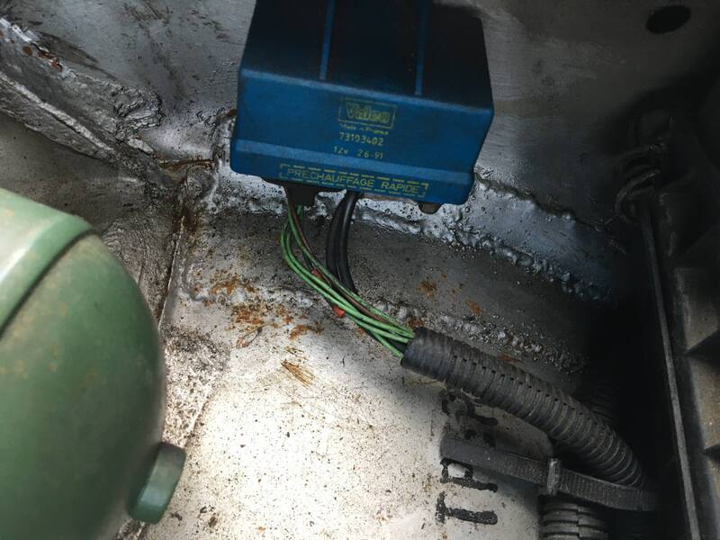

That's the glow plug relay below - good luck getting it sorted! You could try just running a new wire from a switched live to the stop solenoid to see if it behaves itself?
Edited by Tepper
Edit: see you've already tried that with 12v to the solenoid. Never mind!
The blue box is the glow plug relay, yes. None of the wiring looks non-standard - Citroen seemingly had a surplus of green, yellow and brown wires.

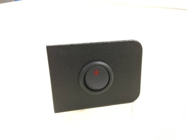

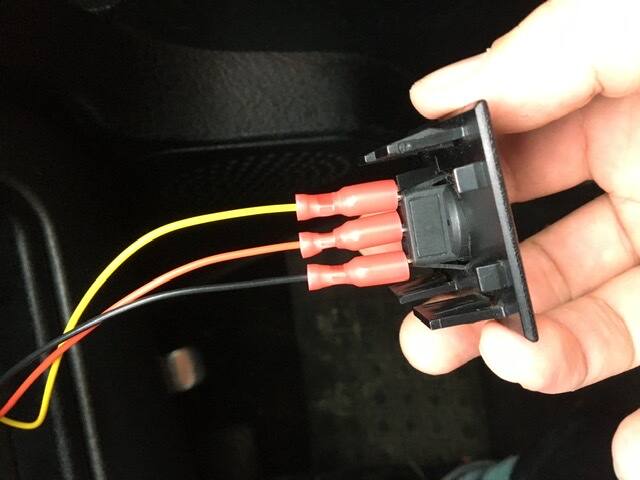

Overcame what I suspect is a dodgy ignition switch with a switch on the dash that can override the occasional loss of power to solenoid when starting. I hate to treat a fault in this way, but hey, there’s lots of blanks in the dash, and it’s got a neat little light to tell you it’s engaged. Starts like a champ every time now.
