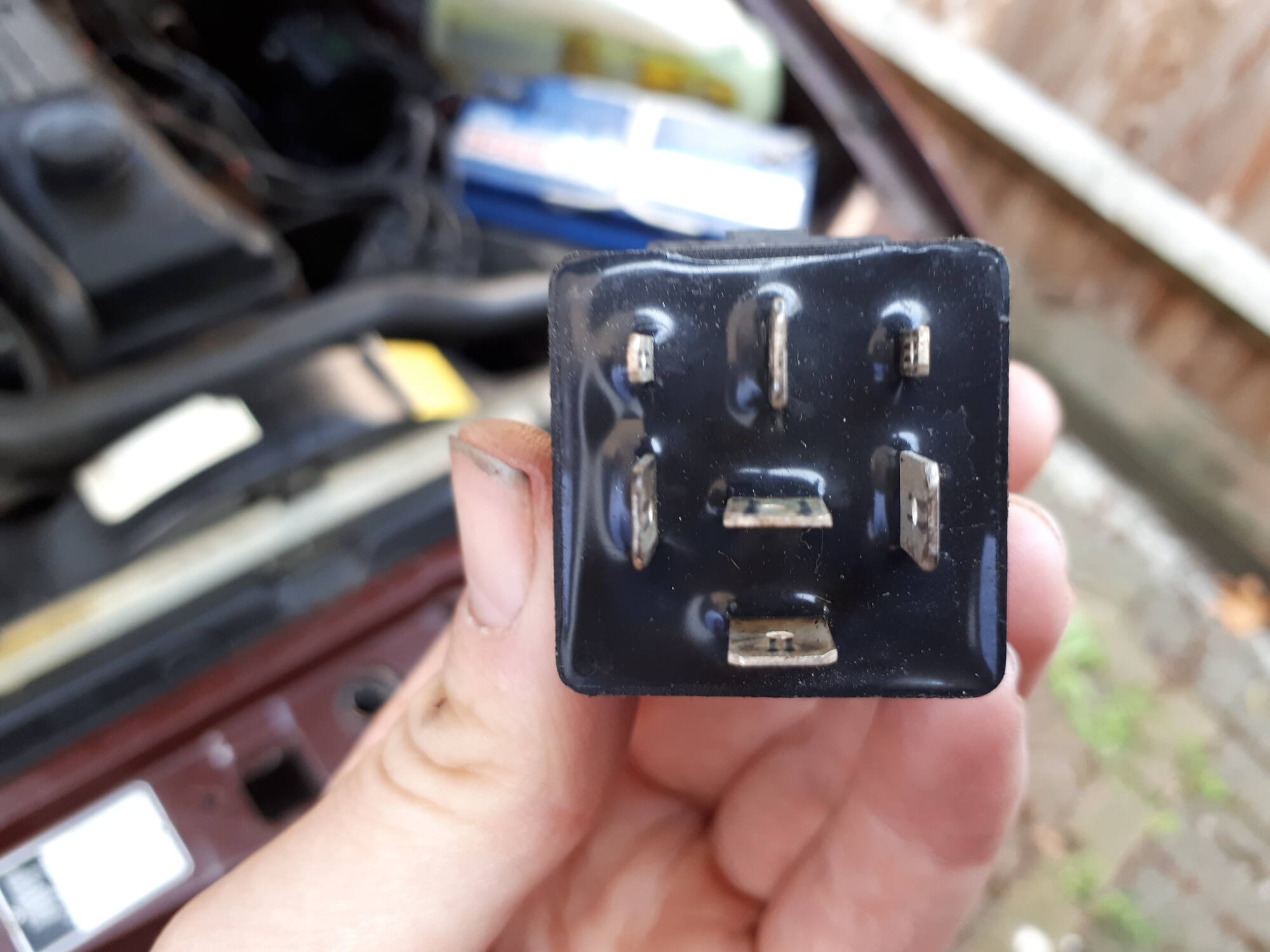

The battery was dead now, so a tad dejected we located the fuel relay and gave the contacts a clean.  Jump pack on and it fired up!  Faces agog at this point.  So egg took it for the brief drive around the green, and I followed later.  Aside from the exhaust it drives well, so either the fuel pump relay needs testing and monitoring (with a spare kept in the glovebox) or the fuel system has cleared itself out.  Who knows.  I did put some snake oil Redex in on Monday.  Either way, MASSIVE RESULT.
It's also really easy to work.  Stuff is accessible, the fuel pump and filter are in a bracket under the boot floor, with loads of room in the engine bay.

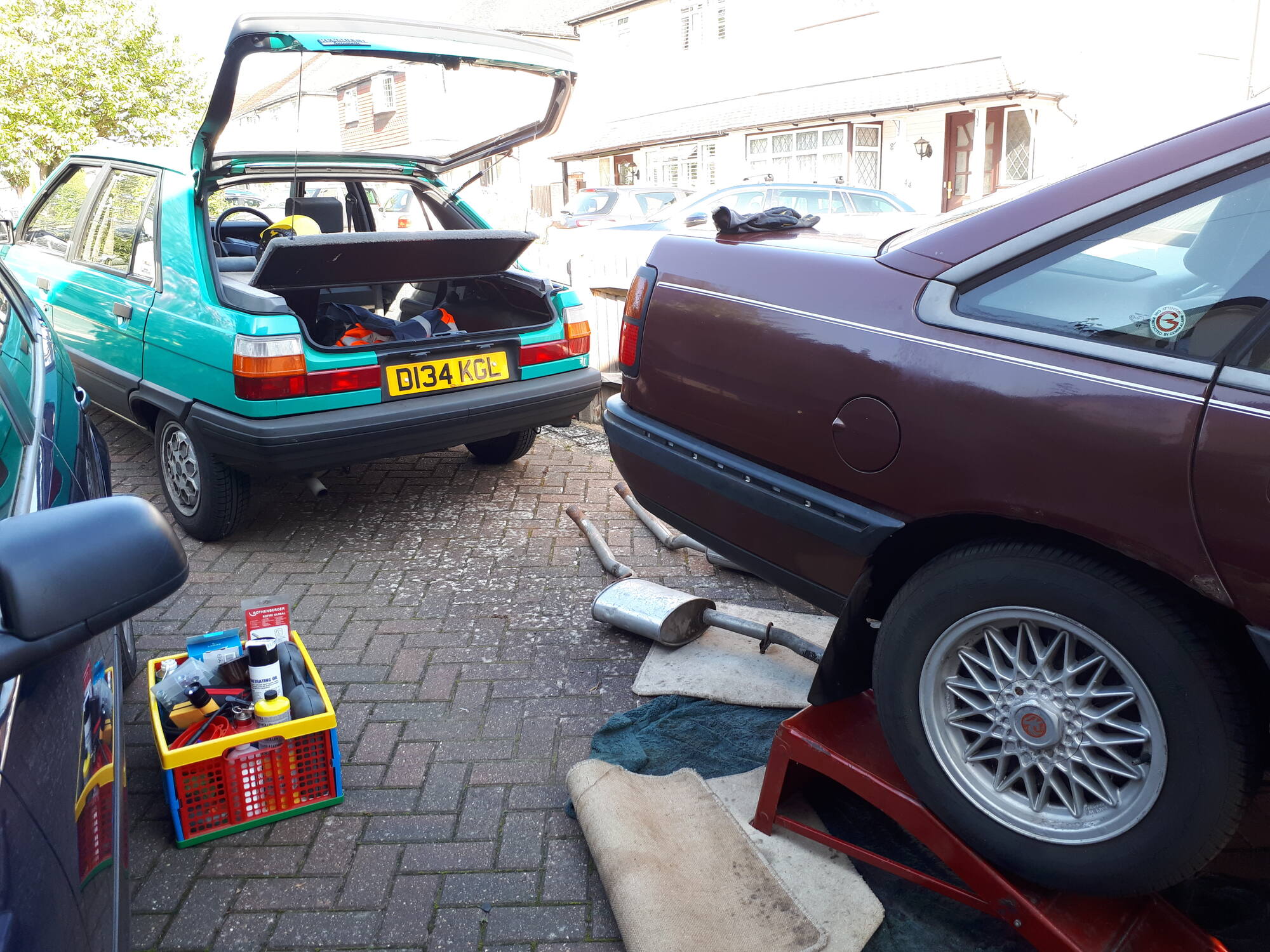

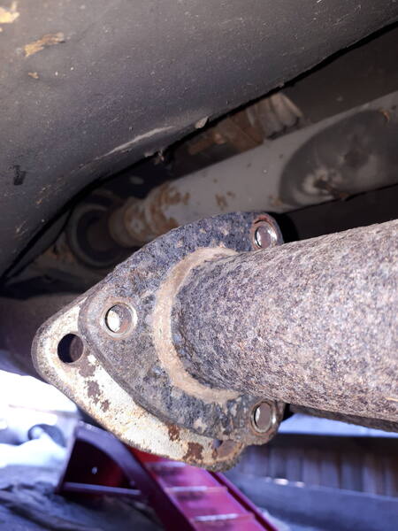

This morning I had a go at changing the middle exhaust section that has blown (there's two on this).  Parts and assorted crap assembled.
HSE note.  I got the car fully on the ramps after this shot.
The three bolts here were relatively easy to shift with heat applied.
Shifting it off one hanger was a faff, but fortunately my Dad was on hand to help pull the exhaust aside.  The rubbers have neat retaining washers and were very pliant and in good condition.  31 year old OE probably as they have a GM stamp on them.
Interesting pic of an exhaust rubber at full stretch...

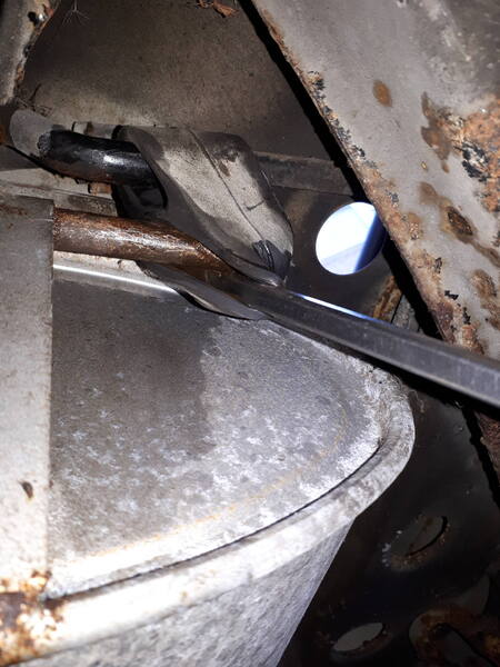

Here's where things stopped.  As I anticipated separating it from the back box will be a PITA.
Flaring the end was a futile gesture, but that can be fixed later.  I tried MAP heat and twisting it from the far end in an attempt to crack it, but nowt.  A YouTube vid suggests re-attaching the clamp lower down beyond the join, heating the two married up parts and bashing the hell out of the clamp with a lump hammer.  I'll try that another day as it was too hot and I was starting to flag and get irritated.  Only problem is  the limited hammer swinging room.
Or grind it off and sleeve the new one on, but that sounds convoluted and might not seal properly unless I get a tight fit.
Also, fully underneath with it up on ramps I found some more rot.  Chassis rail yellow MoT chalk candidate too.  Never mind, I suppose that's the nature of a project, finding new joys each time!
It had crossed my mind yes. Considering how relatively easy the bolts and rubbers were, puckering up and buying a back box might be more sensible.  I can then swap over both mid sections as sods law that'll blow soon.
Edit: also lying on your back doing exhausts is painful, dirty work.  Got rust flecks in my eye despite goggles.

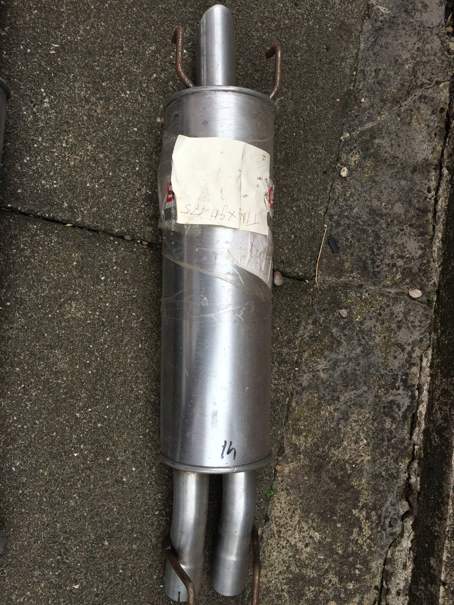

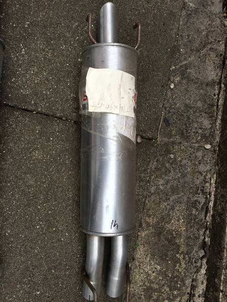

Take a picture of the back box, I’ve got a double piped back box brand new in my shed I’ve no idea what it’s for
edit. Here’s a pic I took of it years ago. Yours if it’s correct.
Such a swish car these, been yonks since they were seen relatively frequently on the road. Nice work Rob McGrEgger
The difference between a genuine and cheap shit exhaust is astounding. I paid £170 for a genuine system in 1995 from plp in Warrington. You got a hernia carrying the bits. Had it fitted at a local tyre place.
^^That looks like it. Urgh, 110 sovs? I suppose split between us it isn't tooo bad.
Thanks for the offer sutty, but the tailpipe is too short on yours unfortunately.
heres Another picture. I don’t think the part number is on it but I’ll double check for you tomorrow, get the magnifying glass out and investimagate ....
