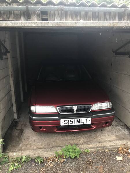

Kiltox Posted July 13, 2019 Author Posted July 13, 2019 Tucked away in the garage whilst I try and organise a HG repair. Outside of the header tank is covered in sticky glittery coolant BL Bloke 1
