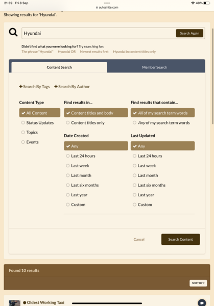

Aston Martin Posted September 8, 2023 Posted September 8, 2023 Am I on heroin, or is the search function not really working? bunglebus 1
High Jetter Posted September 8, 2023 Posted September 8, 2023 39 minutes ago, Aston Martin said: Am I on heroin, or is the search function not really working? It is, so you must be. Rich git

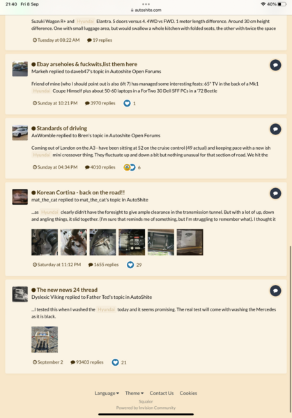

Aston Martin Posted September 8, 2023 Posted September 8, 2023 36 minutes ago, High Jetter said: It is, so you must be. Rich git It doesn't search anything before Sept 1st. 🤷♂️ High Jetter 1
bunglebus Posted September 8, 2023 Posted September 8, 2023 I can't get it to work either. Thought I was going mad
brownnova Posted September 9, 2023 Posted September 9, 2023 Yes unfortunately search function is slightly broken atm and will only search the last week. It’s one of those pesky difficult to diagnose faults. But it is being diagnosed. AnnoyingPentium, Aston Martin, bunglebus and 1 other 3 1

SiC Posted September 9, 2023 Posted September 9, 2023 Yeah there is an issue with the search. I first discovered it here: Then LBF discovered it above. I've just unhidden his post as I didn't want others to readily discover it as doing it enough will cause 502 Bad Gateway errors. Originally it would lock it up hard for many minutes until it got back with a result. I've reconfigure the server so it will timeout after 30s. Yesterday someone else must have discovered it as I had reports of 502 errors again. It sorted itself as the 30s timeout kicked in. To stop it happening completely I reduced the search period to 1 day. Then I increased it to 365 days this morning as that seems a happy medium. Basically it appears the forum software isn't really happy about searching the (literally) millions of posts on here. Normal text searches are fine but stick a non alphanumeric character in there and it'll spend absolutely ages (tens of minutes) going through every post. A bit crap imo. A simple text search is very quick. I plan to use a different search indexing backend (elasticsearch) that is better suited to performing searches. However it's quite resource heavy (runs on Java *shudder*) and I need to figure the best way for it to coexist. I might have to spin another small (cheap) instance up to run it on a separate server. Also depends how much people really use the search. Going by the notice on here, it does get used frequently. Problem is I've simply not had the time recently. This doesn't help either at home... So for now the search period will have to stay relatively short. Otherwise someone will break the server for everyone else! CreepingJesus, Snake Charmer, Coprolalia and 5 others 8

flat4alfa Posted September 12, 2023 Posted September 12, 2023 Only happened in recent days though and I probably use search history a few times a week Searching the forum for specific I know exist, nothing returned as older than March this year. Adjust the time line, still nothing earlier March this year.
bunglebus Posted September 12, 2023 Posted September 12, 2023 Hope this can get fixed as AS actually had one of the most user friendly search functions I've found on a forum. It's a bit of a PITA as I often search for threads I regularly post in and now have to scroll through several pages to find what I want - if it's been updated fairly recently
SiC Posted September 13, 2023 Posted September 13, 2023 It's definitely something I want to get fixed. I've upped the search period to 365 days and it seems that the non alphanumeric searches aren't cripplingly slow at that. Basically if you use any non alphanumeric characters in the search (e.g. -+,!;:/. etc) it causes it to take ages. If you repeat that enough times, it will cause the server to run out of connections to process. Then everyone gets 502 errors until those searches finish. My plan is to move to Elasticsearch. This should make searches a lot more accurate and hopefully quicker. But it's not trivial to setup and secure. I've spent a brief bit of time already but need a bit longer. It's also a big resource hog which complicates thing and may need additional compute resources added. I may put out a call out on here or ask some colleagues at work to double check the config is right. GrumpiusMaximus, Tickman, Snake Charmer and 1 other 4
