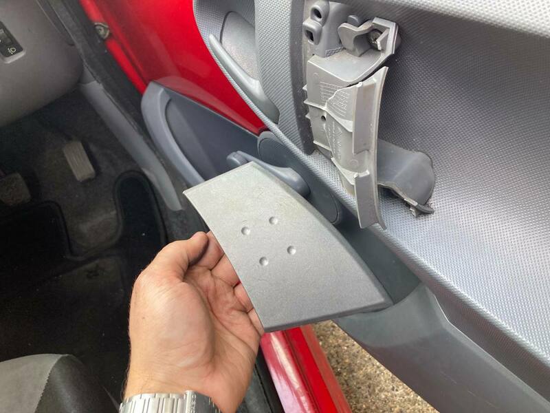

Today I replaced a load of smal things to make it a nicer car overall. This included.
*Replace missing weather strip on driver' side roof
*Replace cracked hazard warning switch
*Replace manky hand brake lever trim
*Replace driver's side interior door handle which broke
*Replace delaminating rear view mirror
*Quick T-cut of headlight before I get round to wet-sanding and laquer
*Small clutch adjustment

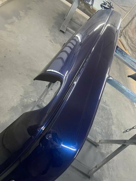

In other news the paint-shop messaged saying the XJR manual is finally going in for final paint!!

A very nice Christmas present, the XJR manual is now back from paint. To kick off I'll just leave you with some photos...

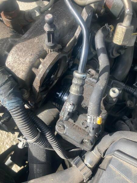

Fitting the clutch hydraulics was a bugger in my garage and in the cold. The kit supplies new hydraulic lines due to the change in fitment in the slave from 3/16'' to 1/4''. but I opted for an adaptor on the slave. This worked well in the end and with a little bending of the exisiting lines. The slave looked pretty ropey but moved ok. The master cylinder was clearly sticking when moving the pushrod up and down and I think the main cause of the sticking pedal (you could see from the old, recently flushed fluid that the rubber was breaking up on the seals). The clutch is nice now. Weighty but not heavy. The next weakness down the line are the rubber bushings in the gear selector mechanism. I'm pretty sure they are tired because second gear in particular takes a load of reaching for. The way the gear selector mechanism works is that the lever is in a tower which bolts to the gearbox. The rubber bushings attaching the tower to the box get tired and a load of flex is introduced to spoil the fun. I'm eyeing up a poly bush kit to fix this.

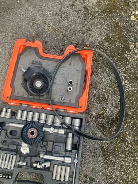

Another small job was replacing the supercharger idler pulley which suddenly went bad. It's a five min job to replace, all sorted now.

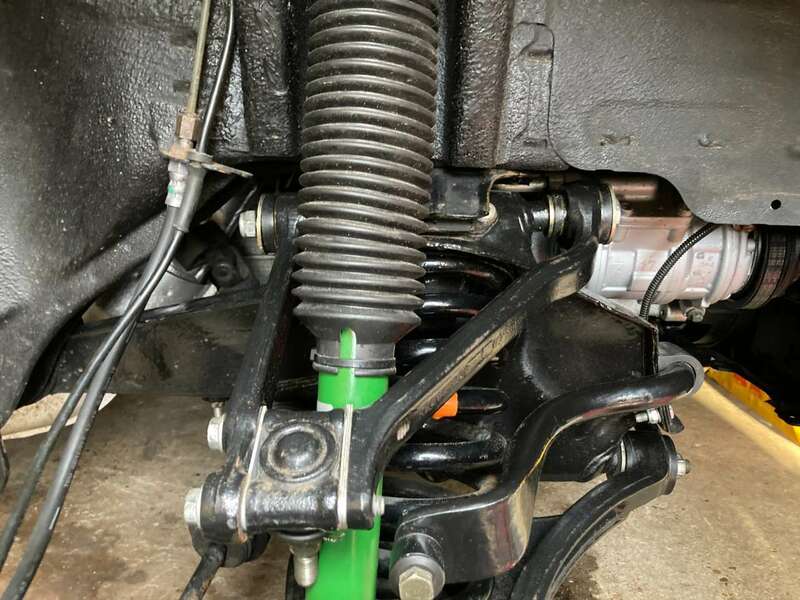

Interesting progress on the XJR manual. Ever since it went back on the road following the extensive rebuild, it has felt both really tight but also wayward. What with the respray and various other bits and bobs I never really investigated it in massive detail. I didn't really know where to start with the issue. When the wheels got alinged, the guy was quite cross with the car and said something was wrong. It was banging like the exhaust was knocking.
Really it should have been very tight vis a vis the front end and steering thanks to Powerflex upper and lower wishbone bushes. Fast forward to a couple weeks ago, I discovered what you see in the video below...
That there is your expensive Powerflex upper wishbone bushes allowing several mm lateral movement. Basically they aren't doing the job of a bushing. I couldn't believe it. A friend said he had experienced the same. I got on to Powerflex direct and they have admitted the part has been designed wrong. AND THEY ARE STILL SELLING THIS JUNK!!!
Next step was to order some OEM front upper wishbone bushes and get them fitted pronto. Pretty exciting really because I was certain this would finally make the car drive as it should. The job took a while this weekend because I had to press the buhses in, which was a faff for an inexperieced operator but I got there in the end. Just as the sun was setting yesterday I got the Jag on the road. It was a revalation. The car is totally transformed on the road. It used to be ok in a striaght line but with an unpredicatable rear end, not as much grip as you would like, vague steering and occasional bump steer. I previously thought it was the steering rack, but I was wrong. The car has no rattles or bangs anymore (yep, the front end was banging it was that bad), I now have masses of mecahnical grip. The rear end can actually be kept in check and the steering is an absolute delight. It handles far better than a 28 year old 2 tonne RWD barge ought to. It's an absolute weapon at full throttle.
More driving around this weekend followed by rechecking every bolt on the front end an retorque everything. Then another wheel alingment will be in order.

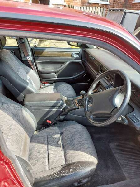

This car purchase came basically out of nowhere. It’s rough but solid in all the right bits. The paint is ruined as are the front wings and wheels, but I now have a trusted place for paint and two good wings came with the car to help me along. It has a whole three days MOT left! I have the weekend to get it back up and running.
What is the main problem? The bit I care about most of course… the gear shift feels broken and the clutch sticks. For the latter there are all new clutch hydraulics in a box on the back seat so I can sort that out easily.
The gear shift is strange. It was as if the linkage was falling off. I had only replaced the gear linkage bushings on NLW a couple weeks ago so was able very quickly to get the centre console out for a look. The first photo is of NLW with fresh polyurethane gear linkage bushings from Simply Performance, lovely. The second is footage the red car. There are no bushings on that. I don’t quite understand how. Look at that against footage of the refreshed linkage on NLW.
Finally we need to discuss the very heavy knob.  No really it seems to be pivotal to the linkage (pun intended). NLW doesn’t currently have its original gear knob. The red car does and I realise now that the knob itself is very very heavy to help with the ponderous gear shift (quote Auto Car review of the XJR6 manual in 1994). For whatever reason the linkage on the X300 manuals is flawed in some fashion so Jaguar in their infinite wisdom thought that having a approx 400 g solid steel knob would be a good fix.

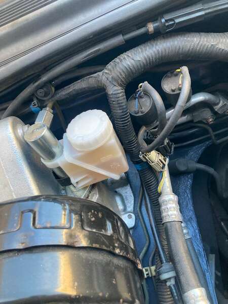

Next the clutch hydraulics. I was very suspicious of the master cylinder. Not for nothing. It was rusty on the inside. Once the old master was off I thought I’d be clever and bench bleed the brand new replacement that came with the car. I had a cap for the hard line to blank the system off while I swapped things around. Everything came off easy and bench bleeding the master was a breeze. I was expecting to be driving the car by mid afternoon. Then I realised the new master cylinder is 180 degrees out from the old one, and the line wouldn’t fit. Bugger! A trip to Halfords for some a pipe cutter and bender got me back on track. I just about managed to reroute and re-flare everything and get the system buttoned up as the sun was setting. It still needs bleeding but there was a pedal.
