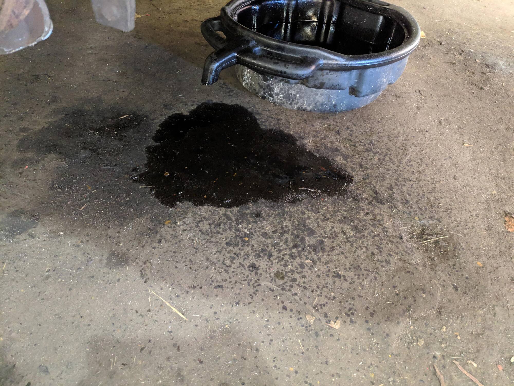

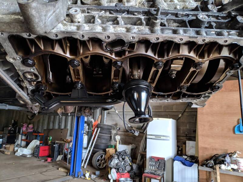

Still struggling to get my head round this, I had the sump off today and couldn't see anything wrong. The stopping points don't seem to correspond with TDC on a particular piston, I still haven't got a clue what's stopping it. Oil pump maybe? As a bonus, it all looks pretty clean in there.

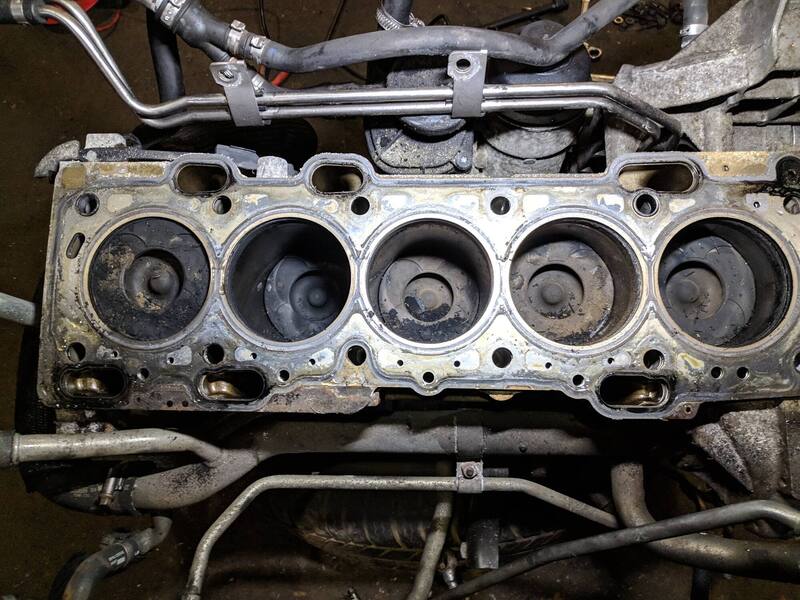

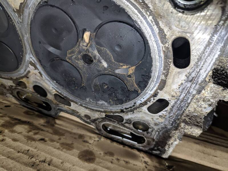

Happy festivities 'shiters! Got a bit done on this today and maybe figured out the mystery of why the engine locked up. Nothing says Christmas cheer like spannering Volvos in a cold workshop right?

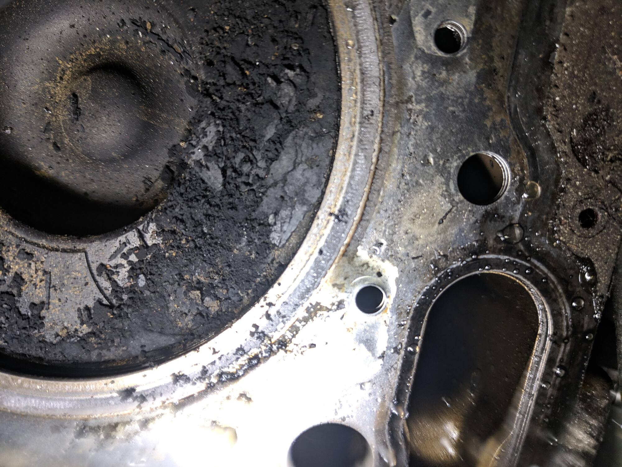

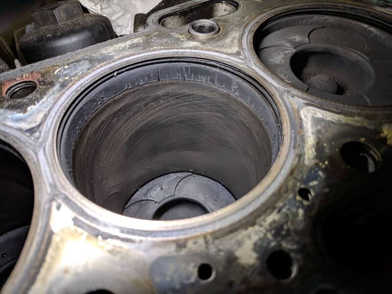

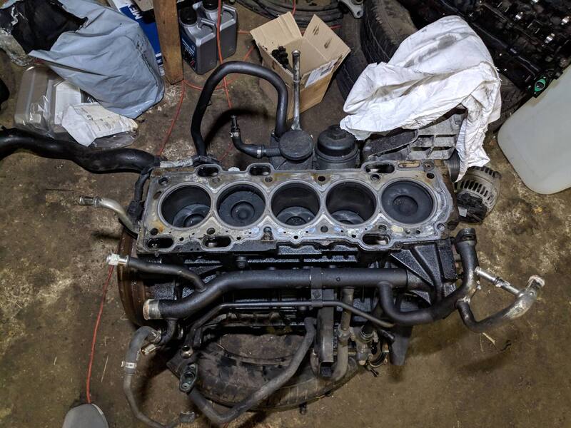

Got the head off the new engine which had a fair amount of clag from the manifold in it, as expected:
On closer inspection, there was a slightly shiny, crushed finish on the carbon in one of the cylinders:
And there was also clag stuck to the corresponding part of the head:
So that's my best guess as to what was locking up the engine, there was quite a bit and it was pretty solid. Who knows.

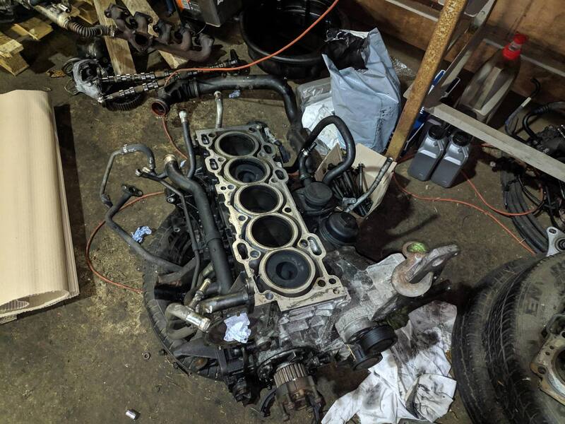

Block and head cleaned up, everything looks to be serviceable. Haven't taken a picture but the new head is on the old bottom end, I think I'll need a helper to hold the fucker down while I torque the head bolts. Stay tuned, more tomorrow.

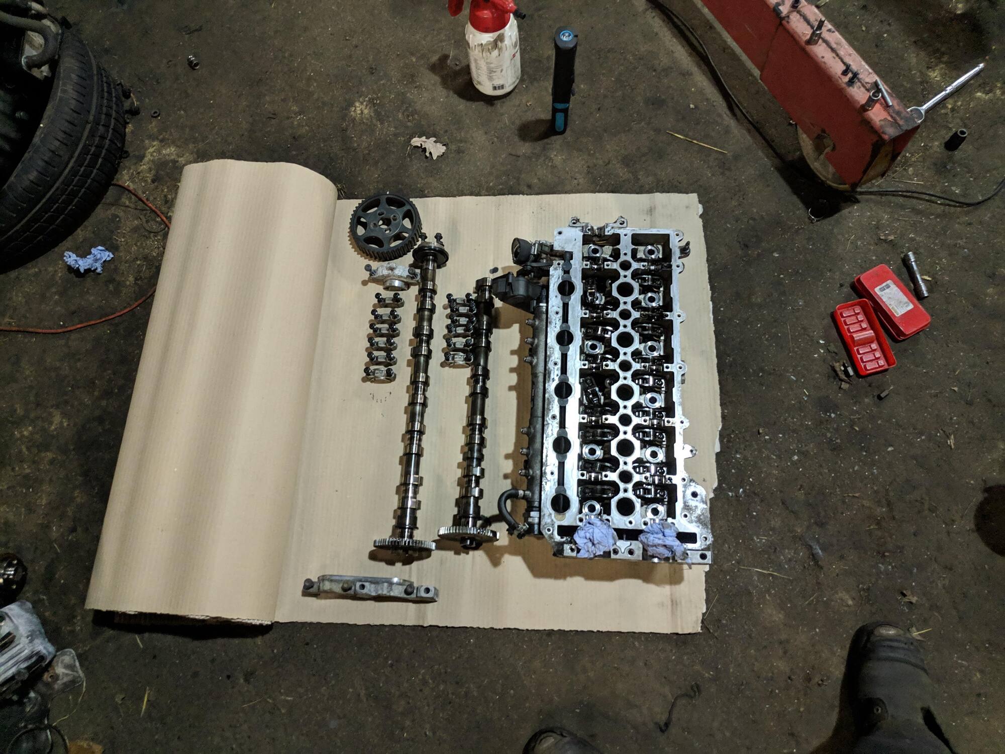

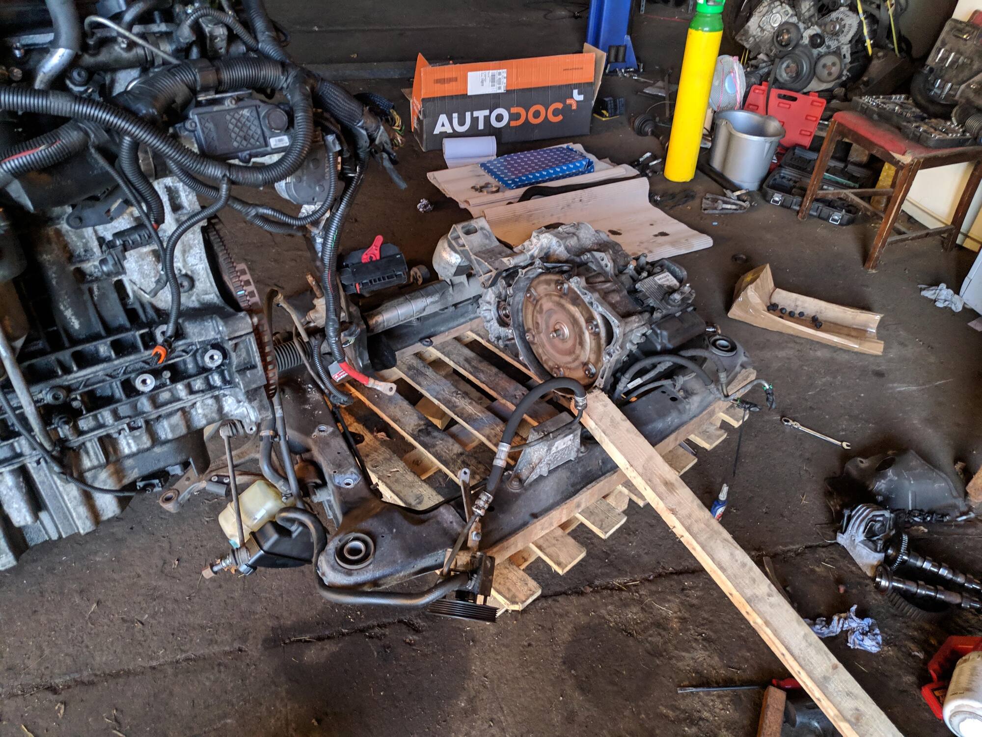

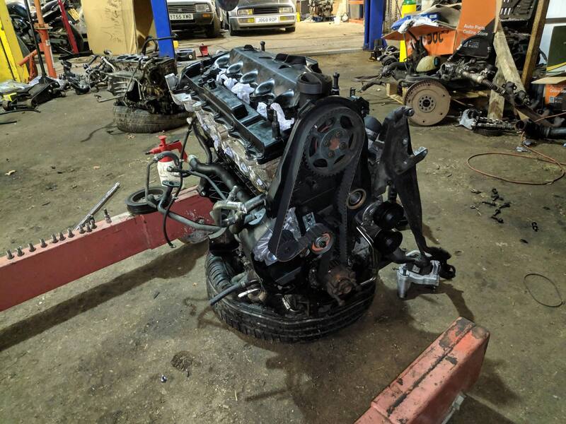

Today's state of play - engine back together, timing belt/valve cover/inlet manifold all on, cam and crank seals changed, turns over fine which is a relief:
Starting to look like I might get this done before too long. Turbo/loom/some ancillaries back on, engine dropped into subframe which was a bit of a pain - fortunately I had help, otherwise it would've been a nightmare.

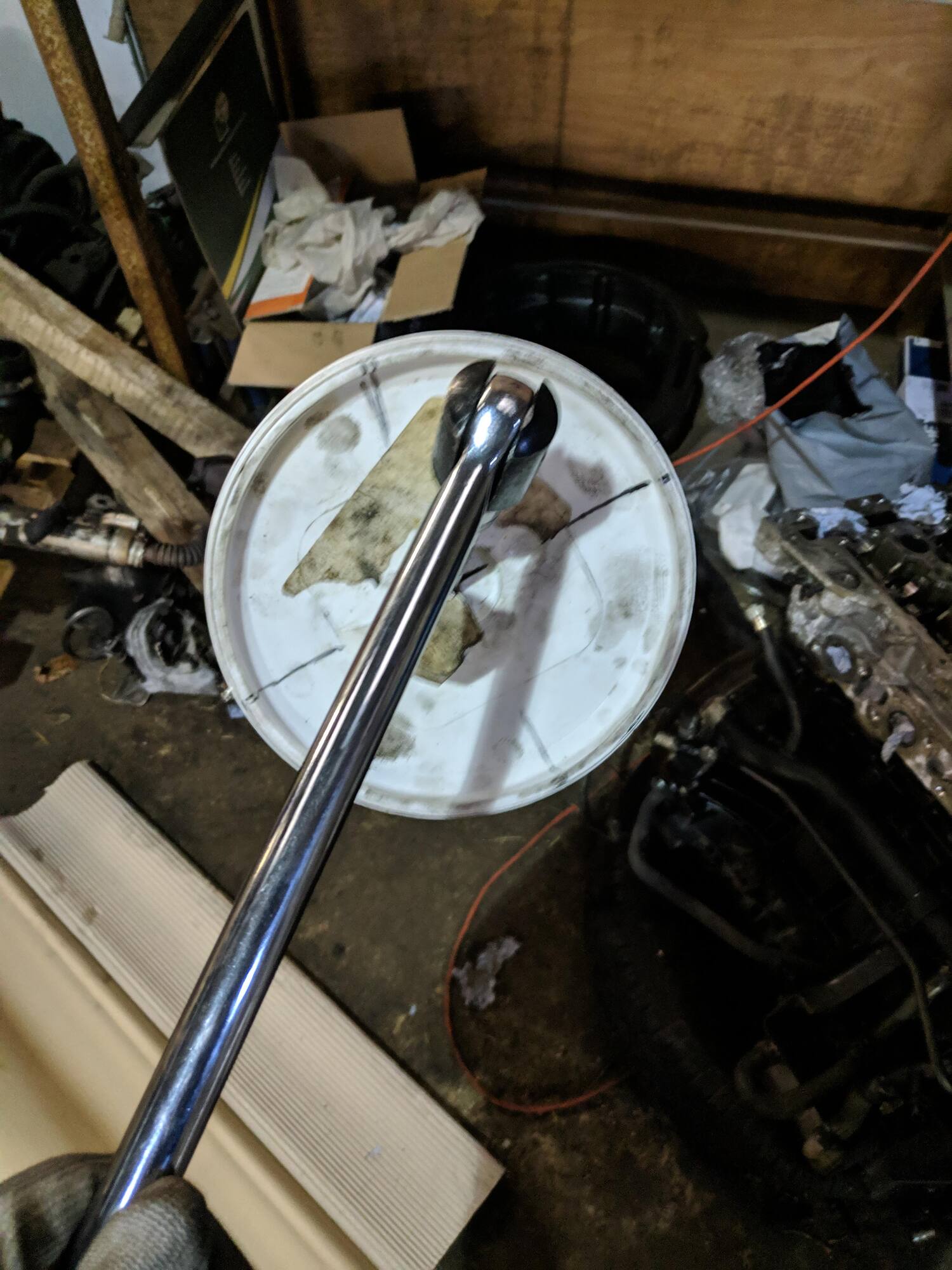

Turns out I just needed practice. When I went to turn the engine over today it was locked solid - here we go again I thought. I had something in the back of my mind from another forum post that I read in the distant past when installing the torque converter, but I checked VIDA and nothing special was mentioned so I carried on. When the engine wouldn't turn, I located that post - an extract is supplied below:
- ** WHEN FITTING THE TORQUE CONVERTER TO THE GEARBOX, rotate it clockwise whilst pushing it into the gearbox. You should hear and feel it drop TWICE. When correctly seated the gap between the torque converter bolt lugs and the bell housing surface should be 13mm. If you do not seat the torque converter correctly, the gearbox will be damaged. This is documented in the Haynes manual. Make sure you never tilt the gearbox when refitting in such a way that it could slide out again. **
IF YOU DON'T SEAT THE TORQUE CONVERTER CORRECTLY, THE GEARBOX WILL BE DAMAGED.
GEARBOX. DAMAGED. Fuuuuck.

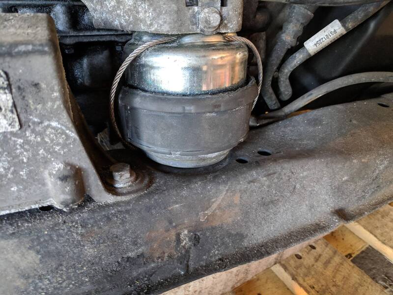

The net result of today is that I'm basically where I was yesterday but with a shiny new engine mount, the injectors fitted and a potentially borked gearbag. The old engine mount was cacked and not holding vacuum, so a Lemforder mount was bought - this appears to be OE, as it has very similar markings and seems like pretty much the same part.

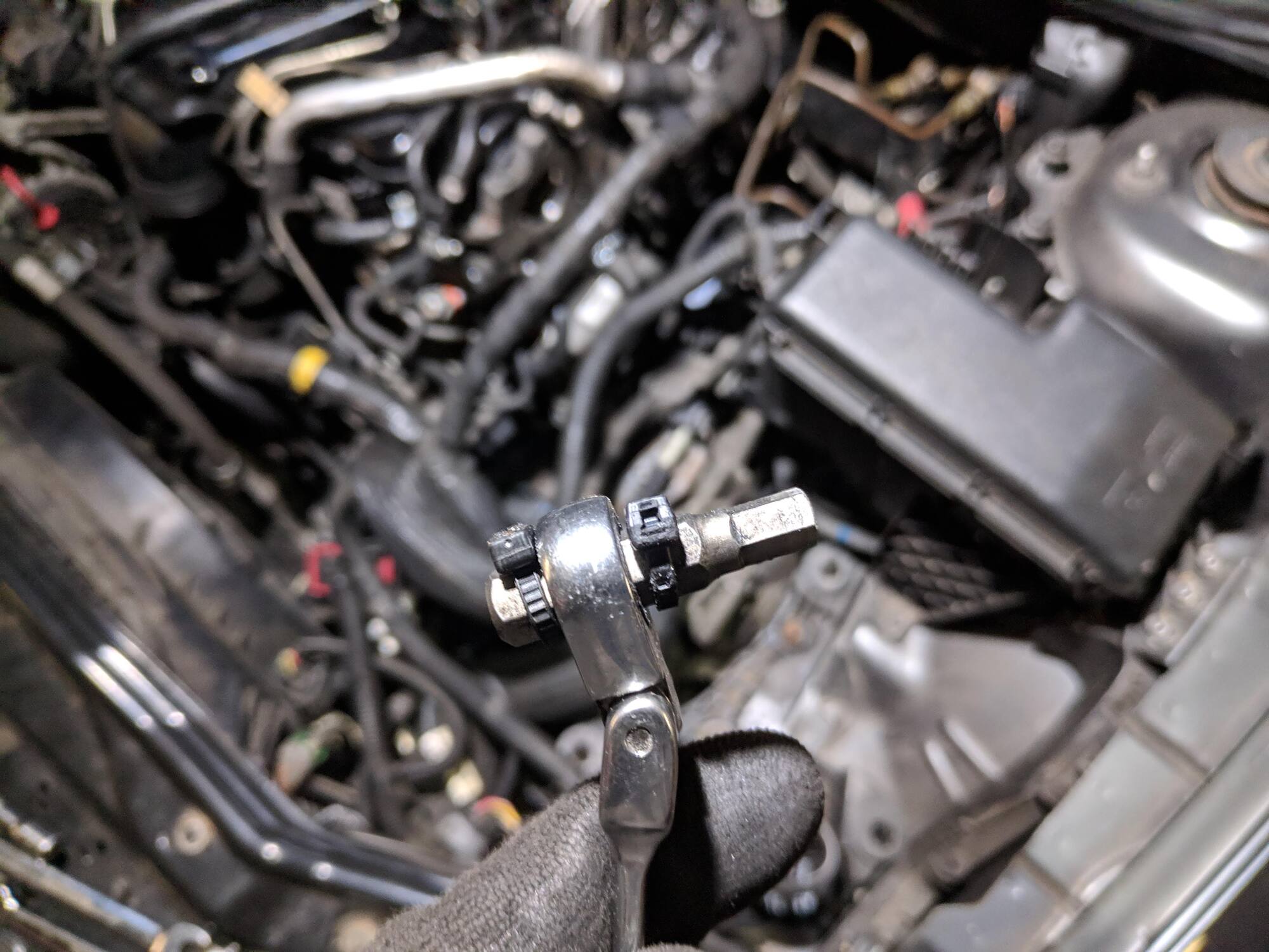

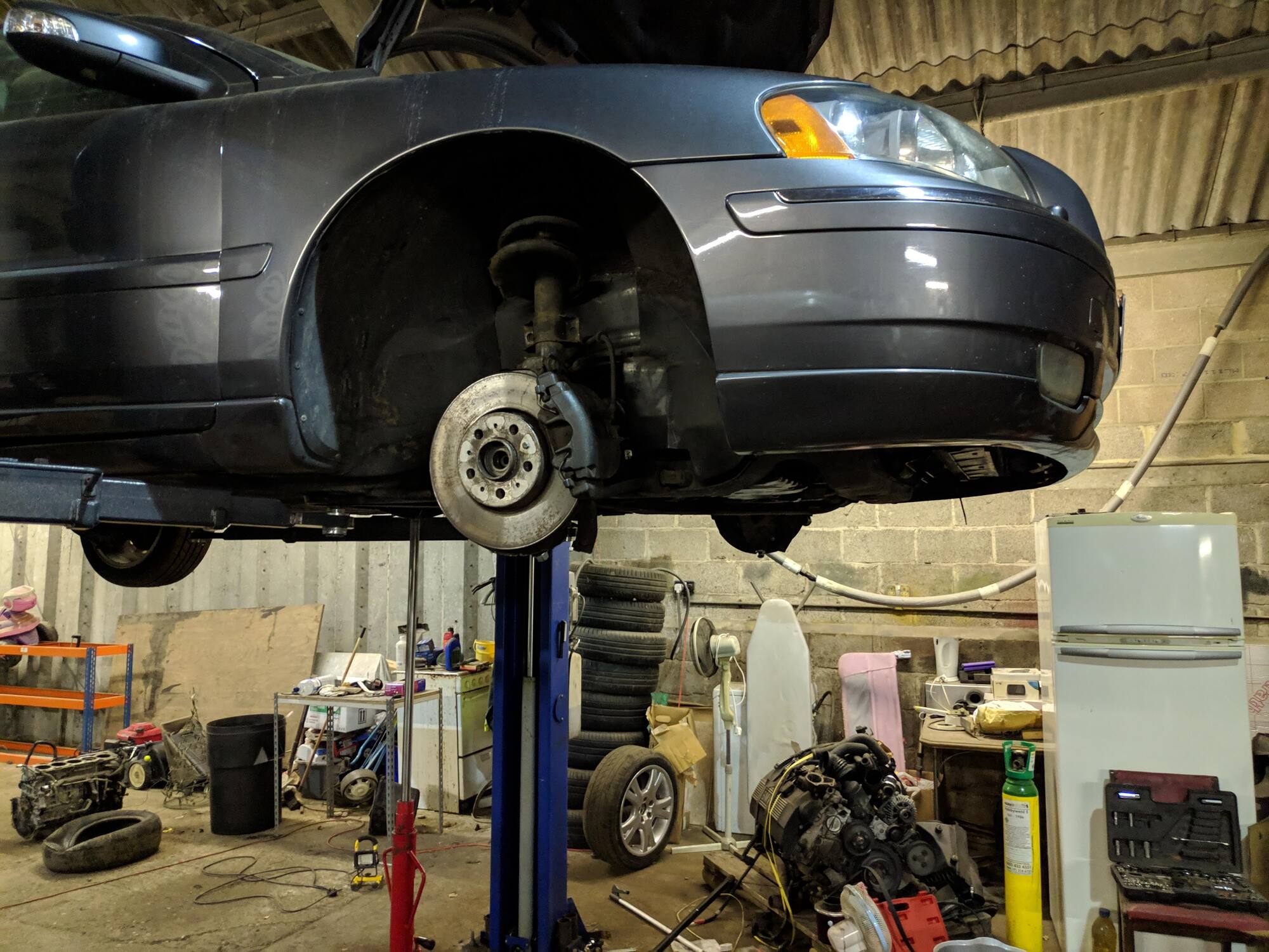

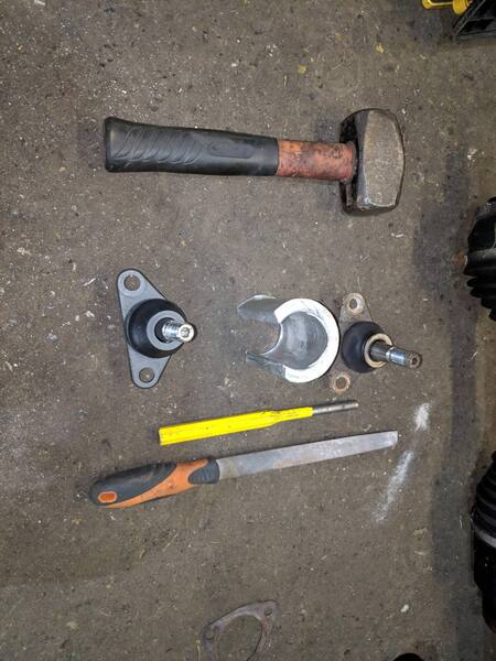

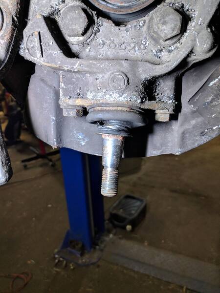

I busted out some more specialist Volvo equipment* to do the balljoints:
Out with the old:
In with the new:

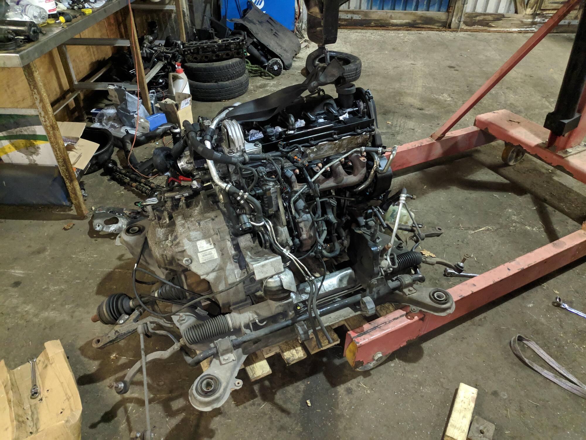

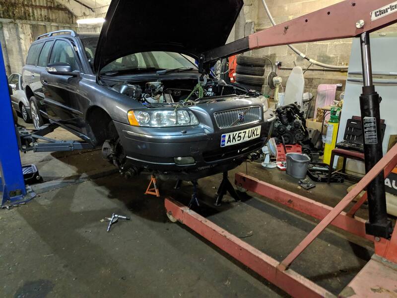

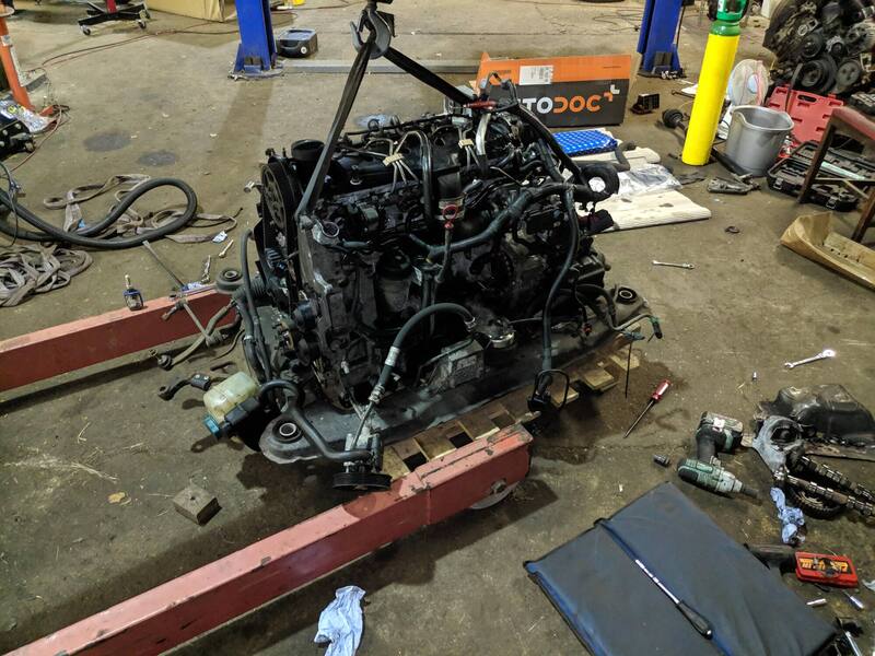

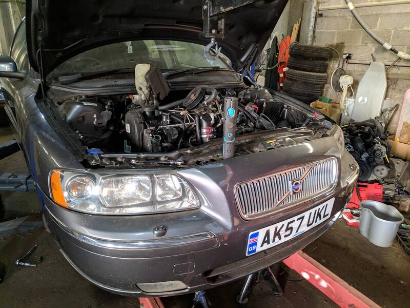

I was feeling brave so I had a shot at getting the engine in. Will it go?
Will it fuck. The angle of dangle using either the trusty piece of seatbelt supplied with the engine or my high tech lifting rope was unsuitable. Either a load leveller or some more creative use of ropes/straps will be required to get the whole thing to lift up straight.
This is where I left it because it's time for drinking now. So close!

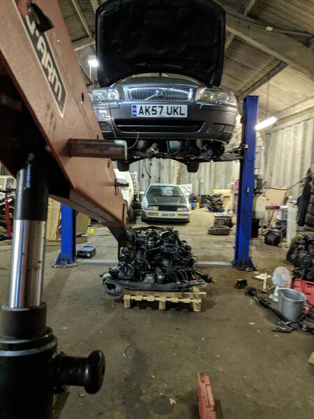

Yesterday saw the purchase of a Clarke Strong Arm load leveller. Today the Volvo faced the Strong Arm of the law:
This piece of machine mart's finest is fuckin' legit and is way nicer (and probably safer) to use than a rope or a piece of seatbelt. It's also red which gives the crane an extra 10 horsepowers.
Success!

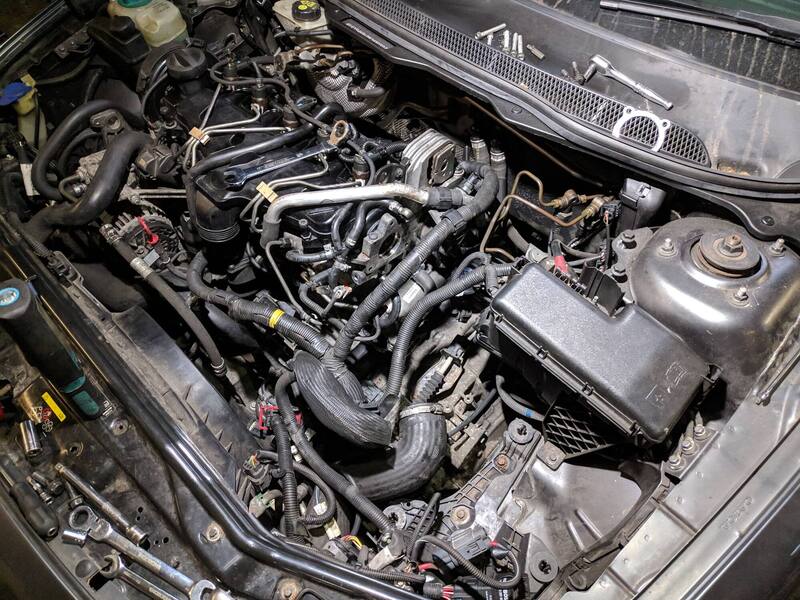

Just got a few things left to button up now, the suspension's mostly back together, ancillaries are on, fuel lines and steering (PITA) reconnected. Not much left to do, would be very surprised if I didn't make an attempt to start it tomorrow.

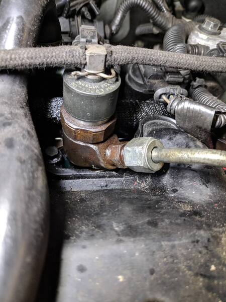

Turns out it was pissing diesel everywhere from one of the injector lines:
This filled all of the injector wells and made its way along the freshly cleaned engine before dripping all down the timing belt end of the engine. Ugh:
Once I had that nipped up, this happened:

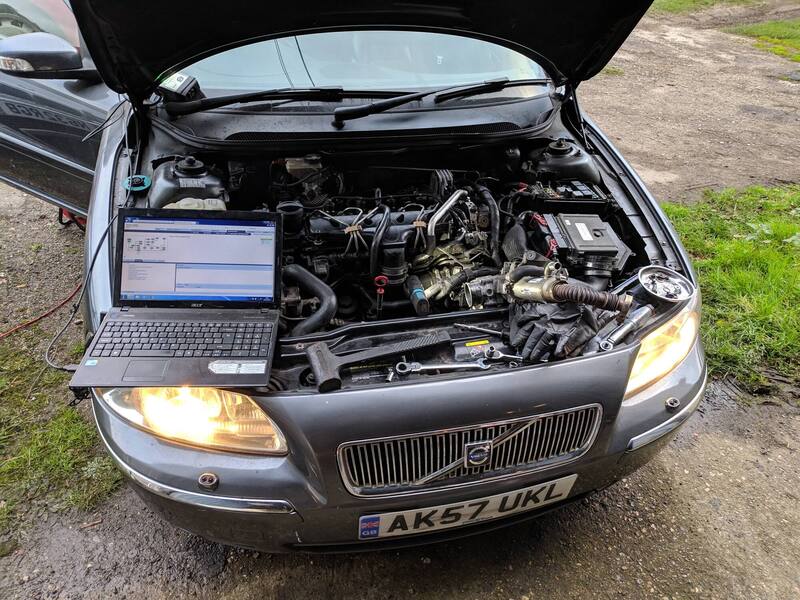

What's next? Well, fault codes galore, along with getting the injectors sealed. I might try the original (slide hammered) injectors to see if they work, which would avoid having to go to a specialist to get them coded. Also the DPF needs a regen, which I might do to see if that helps. I was sorta hoping everything would be fine today but that was never going to happen with this car was it!

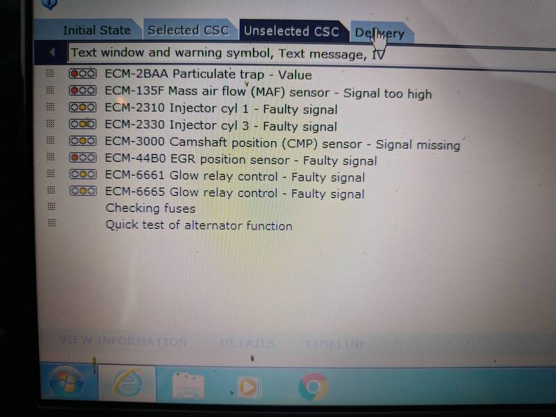

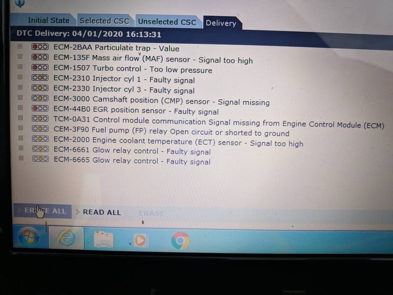

Right then, had a bit of a poke at this today in between helping with an E36 engine swap.

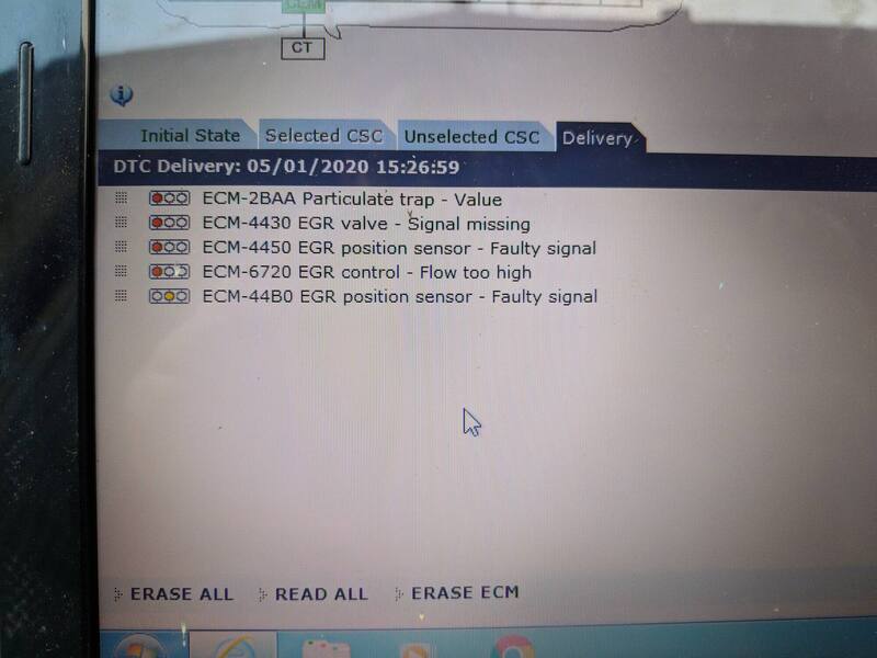

These are the codes that have stuck now that the dust has settled:
So: the DPF needs a regen, but it can't do that without the EGR valve, which is faulty. I ended up cleaning and fitting the EGR valve off the donor engine, which is not doing anything. I tried to actuate the one fitted on the car and it didn't make any noise, also its position sensor doesn't report any change when it's actuated so it's definitely goosed. I hooked up the valve from the original engine which is working fine -should've fitted that in the first place really.
Plan is next weekend to clean up and fit the old, working EGR valve, sort the leaking injectors and force a DPF regen which will hopefully see us out of limp mode and into turgid mode with all 163 raging Swedish ponies available for propulsion purposes. This isn't looking too bad now and I think I can see the light at the end of the tunnel - or maybe it's just a train.

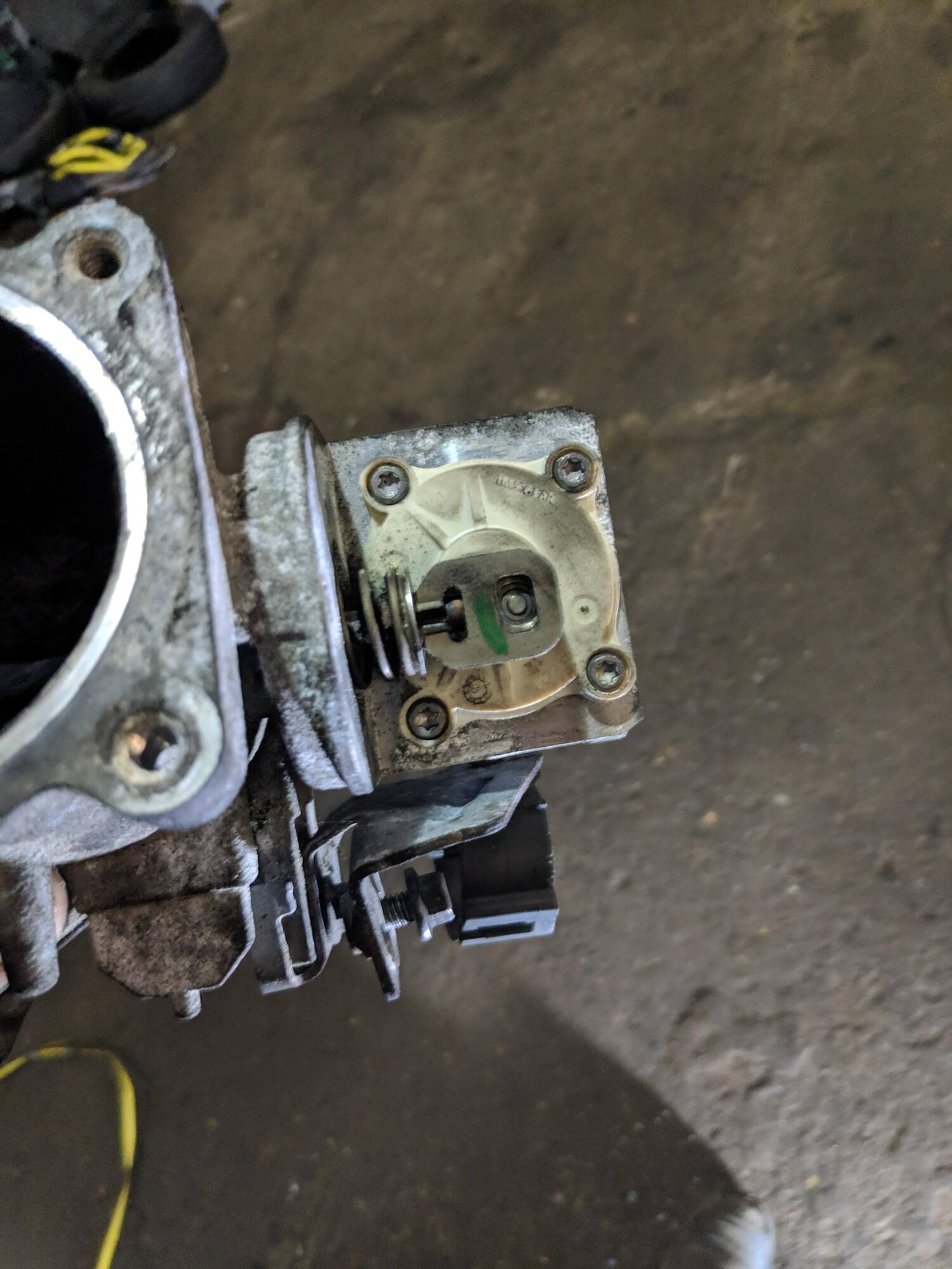

Today was EGR time. I was hoping I'd be able to just change the actuator without having to remove the EGR valve but sadly that was just wishful thinking. I couldn't see a way to remove the motor arm from the spindle of the valve and I didn't want to damage the working EGR valve, so away we went.
The way I chose to do this was remove the airbox and HP fuel pump, then remove the valve leaving the cooler in situ. This saved me having to drain the coolant and wrestle with the weird little V-band/jubilee clip hybrid attaching the exhaust manifold flex pipe to the cooler. Access to some of the bolts was a bit of a pain. I deployed cable ties to make another Volvo tool:
This is the bit inside the valve that I couldn't figure out how to split:
Anyway, the result of this is the car is now out of limp home mode. That's right: full powah. Finally. The car's driving nicely and I had a chance to test out the stereo which has a pleasing ability to blast out choonz - it is as good as everyone says it is. The DPF error was cleared just by resetting the counter, I did this rather than a regen as the differential pressure readings were low. If it comes back I'll do a regen but for now, we're all good. All I need to do now is reseal the injectors and fit all the covers, undertrays etc then it should be ready for an MOT!
