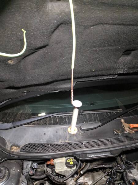

Tepper Posted January 16, 2020 Share Posted January 16, 2020 In a shocking turn of events the penetrating fluid did not magically fix the bonnet catches. This happened earlier: No bueno: I basically doused everything in WD40 then wiggled the lever back and forth for ages until both catches freed off, which took a surprisingly long time. They were so bad at first that I didn't realise they were sprung, it was only after a fair amount of cleaning and jiggling that they started to return by themselves. Then applied a load of spray grease to try to keep things moving. Normal service has been resumed - MOT tomorrow. paulplom, They_all_do_that_sir, Coprolalia and 1 other 4 Link to comment Share on other sites More sharing options...

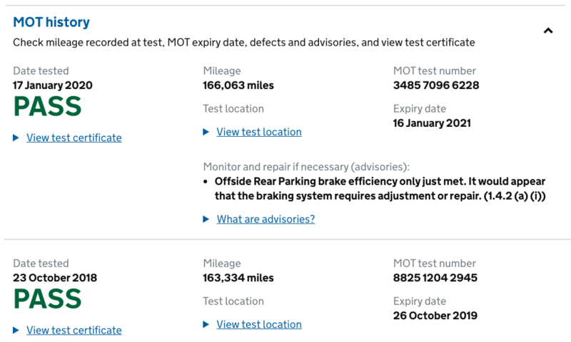

paulplom Posted January 18, 2020 Share Posted January 18, 2020 The handbrakes are invariably shit on these. You need to check the shoes don't delaminate. If they do they can write the hub off. I'd check them sooner rather than later. Link to comment Share on other sites More sharing options...
rainagain Posted January 18, 2020 Share Posted January 18, 2020 The hand brake was shit on my S80 as well, it either didn’t hold or dragged depending on how you adjusted it. It being an auto as well it never bothered me until it failed the mot. A hero on here suggested changing the return springs. I did this and it was like night and day. Link to comment Share on other sites More sharing options...

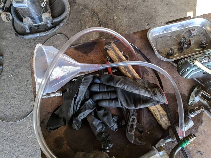

Tepper Posted January 19, 2020 Share Posted January 19, 2020 Hmm, I should probably get that checked out then. It still wants a few service bits doing so I might take a look next weekend. Having put some miles on the Volvo it seemed slightly incontinent. Here is some expensive Volvo coolant adorning my workshop floor: Boooo coolant leaks: At first it looked pretty bad but it turned out to be one of these jubilee clips needing to be nipped up: Result. I also did a transmission fluid change using the Gibbons method yesterday, I didn't take any pictures because my brother was helping me and we were in a bit of a rush. The Gibbons method involves releasing a number of angry apes into the gearbag and hoping for the best draining whatever comes out of the drain plug then refilling with the same amount of fresh fluid, then disconnecting the oil cooler line and using the transmission's internal oil pump to empty fluid 2 litres at a time, refilling in between with fresh fluid. This is the process recommended in the manual as it ensures that almost all of the fluid is replaced, rather than just what's in the sump of the transmission. As a certified Volvo mechanic* I needed a few tools for the job. Off I went to the Range where I scored this: Great for aquariums - I guess the back of the Volvo looks a bit like a fishtank? The reason I bought this is it came with clear hose that looked about right. Due to my high level of planning and engineering expertise, the hose fit nicely into this 59p funnel: But more importantly onto this stub of transmission cooler line from the scrapyard which was duly inserted into the cooler. This allowed the old fluid to be shat out in a semi-controlled manner: The fluid change was a success and I measured the final level with the transmission at 50 degrees as stated in VIDA. I also reset the fluid counter, adaptations etc. I'm glad I did this job as the box was definitely short on fluid after removing the cooler lines for the engine swap. The changes are smoother than before and are getting smoother as the TCM relearns the shifting. Another result. Finally, this car arrived with one of the driveshaft bolts missing, which is apparently fairly common. They're single use bolts (well done you Swedish bastards), which can work their way out - particularly if they've been re-used. I bought new bolts, but they didn't seem to fit. I double-checked with the nice man at the parts counter but they were definitely right - turns out the thread in both the driveshafts was crispy ducked. Not looking forward to having to remove the driveshafts again, I decided to try running a tap down them in situ: This is a pain in the arse, as you can't get a tap wrench on it and it's also difficult to keep it straight. More through luck than anything else, I managed to twizzle the tap with a pair of pliers on each driveshaft and somehow found the thread. Both threads sorted themselves out and driveshaft bolts are now installed. Silence from the drivetrain has been restored. Before you judge me for driving around with no driveshaft bolts and passing the MOT by putting one of the centre caps from the back onto the front to hide the missing bolt, it's actually fairly common on these and the shafts can't come out of the hub due to the suspension geometry. They just clonk a bit, but I'm glad to have it sorted for sure. The car's performing well and I think is settling down now it's actually being driven. I pressed it into service doing practical estate things today by running about 2 years worth of oil and coolant down to the tip which it handled admirably. We're pretty much there now, I just need to look at the rear wiper and do the remaining service bits (air filter, cabin filter, brake fluid). Shirley Knott, mrbenn, Lankytim and 4 others 7 Link to comment Share on other sites More sharing options...
outlaw118 Posted January 19, 2020 Share Posted January 19, 2020 Re: Rear parking brake woes....TADTS. My V40 was crap, as is my XC90. My mechanic bloke recommended buying an adjuster kit off t'bay, if yours hasn't had that done already. https://www.ebay.co.uk/itm/VOLVO-V70-2000-2007-HANDBRAKE-SHOE-EXPANDER-ADJUSTER-SPRING-FITTING-KIT-BEK0218C/264569861246?fits=Model%3AV70&hash=item3d9997b47e:g:T90AAOSwvd9d-MH5 Think this is it, don't quote me! Tepper 1 Link to comment Share on other sites More sharing options...

RichL Posted January 19, 2020 Share Posted January 19, 2020 Looking good. Fluid change on the box should see it fine for a bit. Driveshaft bolts are crap they often work loose and fall out. Definitely check out the handbrake shoes though the whole assembly can fall to bits and ruin the rear hubs Tepper 1 Link to comment Share on other sites More sharing options...

Tepper Posted January 20, 2020 Share Posted January 20, 2020 Thanks for the advice all, will get some handbrake shoes priced up and will get the handbrake suitably fettled. 14 hours ago, paulplom said: Bin those locking wheel nuts. They will let you down at the most inconvenient time. Volvo sell standard wheel bolts for not much. I had to get my hub nut tightened once a year at mot time despite using thread lock etc. I've got my eye on a pair of alloys from the same car the engine came from, complete with a decent pair of Yokohamas to replace the mismatched ditchfinders on the front and provide a fourth centre cap. Would've had them the other day when I was at the scrapyard but didn't have enough cash on me - would probably be wise to grab the bolts at the same time. Link to comment Share on other sites More sharing options...

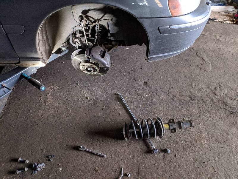

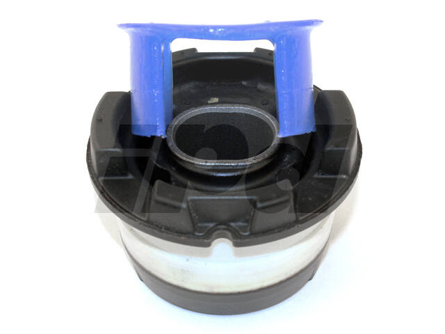

Tepper Posted March 23, 2020 Share Posted March 23, 2020 Been finishing off the last few bits needed on this, it's had a slight knock/creak from the front end since I've been driving it so have been chasing that for a while. First step was this, top mount/upper spring seat on the right hand side: The first time I did this job the noise actually got worse, despite using parts that seemed OK with a 5 year warranty. Second time round I stuck on parts from the local factors which simply got us back to where we started. Brill. Next up were the lower arms. These had a split in the bushings which didn't look too bad and went through the MOT no problem but were certainly a candidate for producing a creak. I came up with a cunning plan and managed to blag a pair of knackered lower arms that I had previously removed from a friend's V70. This would allow me to press in new Meyle HD bushes at my leisure and swap them over without having to have the car off the road. Lower arms brought into work to use the press: These were a bit of a pain in the arse to deal with because of the shape of the arms, it was a bit tricky to get everything fitted up in the press but we got there in the end. Arm with fresh bushes ready to go: Spot the difference: Fucksake. Turns out Volvo switched to steel lower arms for the last year or two of production during the Ford takeover. The steel and ally arms are not interchangeable. Balls. I managed to find a pair of steel arms off a breaker and was planning to fit fresh bushes to them, but when they arrived I was pleasantly surprised to find they looked fairly recent with bushes in good condition so I just chucked them on. I've already bought another set of Lemforder bushes so will probably get those fitted to the old arms at some point to keep on the shelf ready to go. At the same time as the lower arms, I also fitted some of these: These are polyurethane inserts to fill the voids in the original subframe bushes. Subframe bushes are another common source of creaking apparently and at £25 I figured they were worth a shot. I am pleased to say that all creaking/knocking is now gone, which I'm dead happy with. Just need to get it aligned again and we're all set. Finally I bought one of those 3M headlight polishing kits because the lights were starting to go a bit cloudy. Here goes: The kit could've done with more of the coarse sanding discs but has generally done a good job, the lights look a lot better than they did before. The car is more or less where I want it now, I'm just waiting on a replacement bluetooth adapter for the head unit as the first one from China was faulty, once that's fitted I think that'll be job done on this. Jenson Velcro, SiC, Coprolalia and 1 other 4 Link to comment Share on other sites More sharing options...
