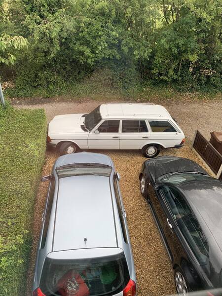

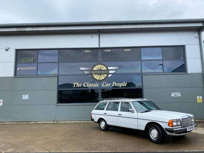

Made it!
Actually drives really well, not a clunk or rattle! But my God it’s shonky. That’s definitely the right distance from which to view! I shall reveal its finer features in due course.
Shall we have a look then? It's a 1986 230TE Auto. I've been half looking out for one for a while and quickly came to the realisation that I was going to have to adjust my expectations price wise. These are no longer £1000 shitters (even though by rights this one should be!) - there's one currently on ebay which looks similar to this, may be a little better for £3650 but with no MOT. A ropey 280TE also made similar money last week.

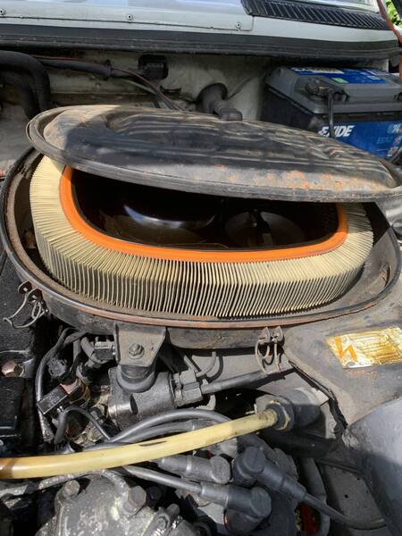

As one can see, it has not become the victim of over-restoration below bonnet and retains all of its workaday usability
Mercedes designed the rocker cover of the mighty, fuel injected 230 power plant to emit a fine mist of oil, all over every component in its immediate proximity in order to bolster their already legendary longevity. This particular unit appears to have had a professional repair to the exhaust manifold, eschewing the outdated gasket sealing arrangement forthe modern, paste jointing compound, sikaflex; a fabled solution on this model to those in the know.

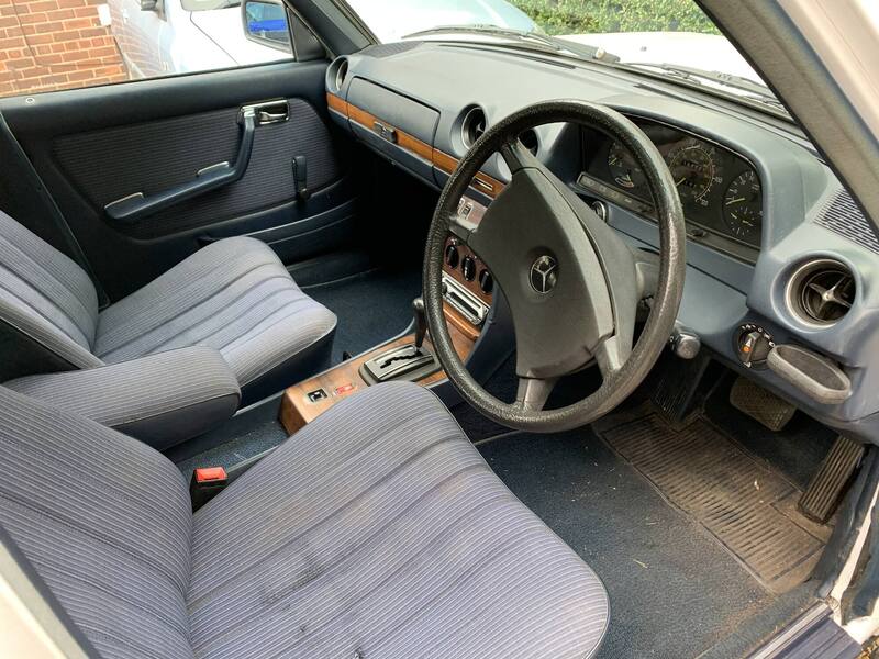

Internally, the model is resplendant in scrotal vein blue and provides whispers of a life lived. Mercedes' coveted, mattress sprung seating has held up well and in no way has the driver's seat base collapsed, meaning it's like sitting on a collapsing ironing board
The seat back benefits from an invisible reapir to the often problematic side bolster

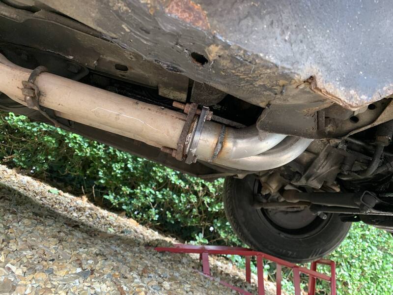

The exhaust manifold gaskets are like metal shims. I’ve never seen one fail, by which I mean split or burn through. If the manifold nuts and bolts aren’t completely seized, remove the manifold and give the mating surfaces a good clean and reassemble using small quantities of paste.

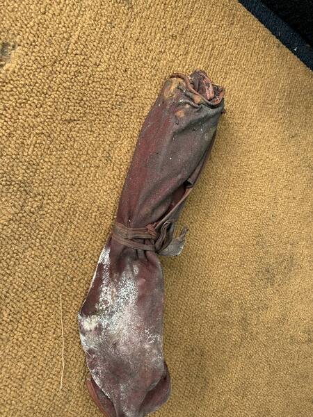

Was I the only one who thought this was a lovely Mercedes cravat, left by a previous owner

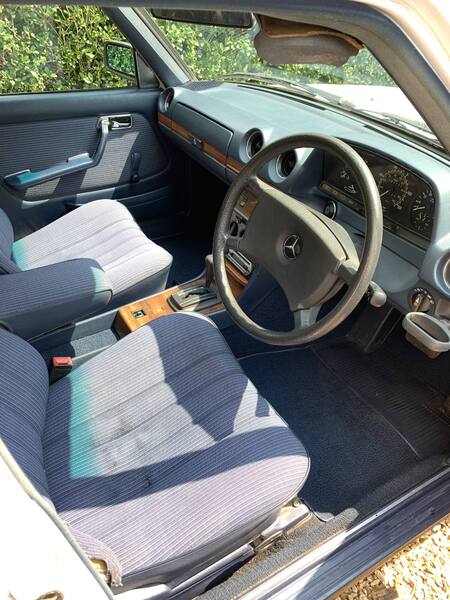

I spent all yesterday scrubbing the interior and shampooing the seats and carpet on this thing. It almost looks presentable in there now.

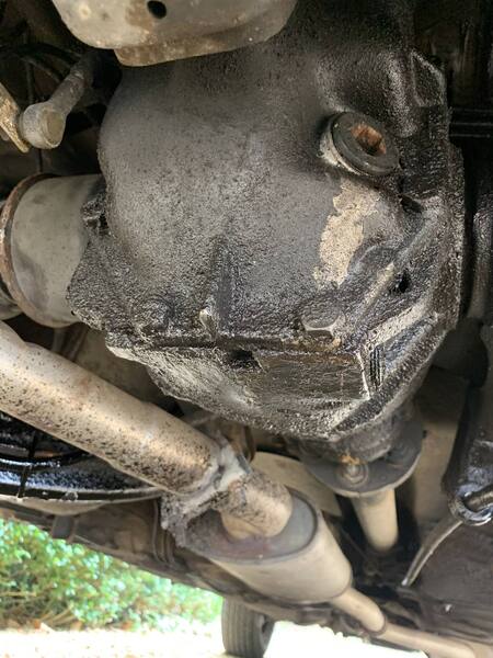

Also got it up on ramps and had a poke about underneath; there’s nothing too unexpected. It’s had some action around the jacking points, the rear of the sills and inside the rear wheel arch but the floor pans are good. Did find this hole above the tailpipe where the metal has ceased to exist behind the under seal
But it’s not near any suspension mounts so should get away with that. Brake lines etc look ok in the main, they’ve been greased where they meet the flexi in the wheel arch.
It’s had a new down pipe which may explain the manifold business (also note ‘tender’ looking patch to chassis rail)

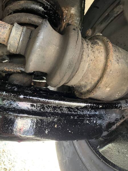

It’s also had a recent new alternator. The oil’s pretty black, the fluid for the rear suspension looks old (though the system doesn’t appear to be leaking) and the ATF looks old so it probably needs all fluids doing. Air filter doesn’t look too bad, but oldish
The oil cap isn’t sealing properly or the rocker cover gasket and there’s a slight weep from the auto box pan. It’s damp rather than properly leaking. The rear diff’s clearly been leaking for a while

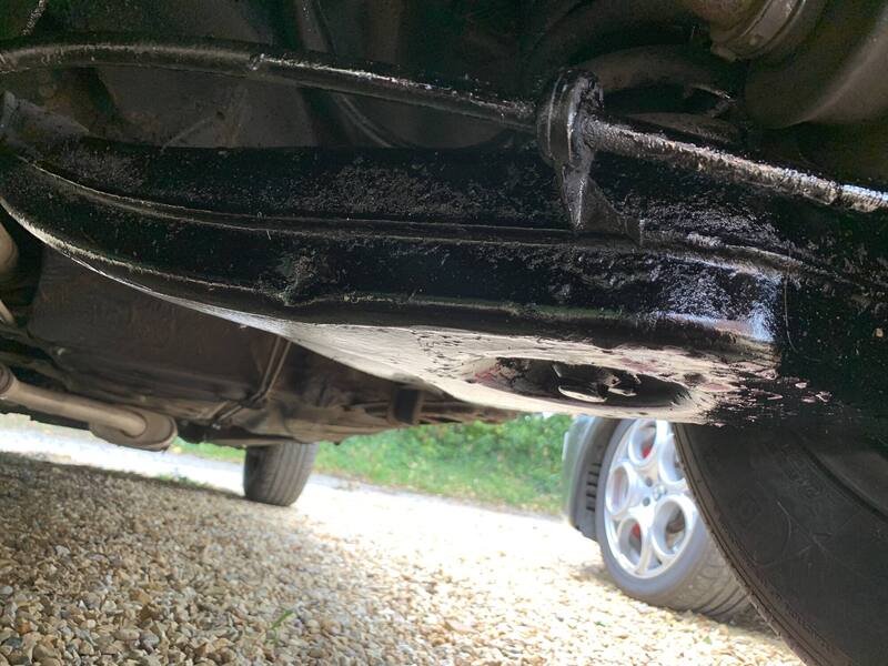

Someone has recently rust proofed the trailing arms/spring pans
The inner and outer CV boots are perished but not leaking (yet)

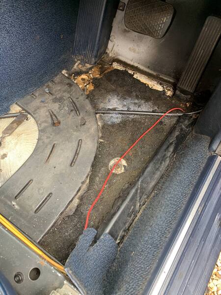

Driver's side seems much wetter than the passenger side, but the passenger's side is the only place I can find a definite leak, right in the corner of the windscreen seal as @Peter C predicted - you can just make out the wet area inside.
That's leading to water running down the bulkhead on the passenger side. The track in the middle looks to be from another source. That area houses the battery tray on the other side and there's what I presume is an intake grille for the blowers in the scuttle above so I'll have to have a poke about
The rear footwell on this side is dry
Driver's side rear footwell is the wettest area and looks to be flowing back from the front of the car via the channels in the floor and along the vaccuum pipework underneath the black covers
But the front is relatively dry
Except this area in the middle of the door
That loose bit of carpet in front of the seat rail is damp. It seems to correspond to this section on the door where the seal is hanging off because the channel that holds it is rotten. The doors also have badly perished window scraper seals.
The area around the accelerator pedal is slightly damp but I think that might be from the passenger side, leaking across, as I can't find any witness marks for ingress on that side.
These areas near the bonnet hinges drain the roof. I've not yet had a good poke about but I expect there's some issues there be it simply blocked drains or some corrosion
It also has a sunroof to complicate matters. The headlining is completely dry, but if the drains run down the A and B pillars then it could also be that. I think it's likely a combination of all of them. I'll start with the windscreen seal, try and get the door seal properly seated along the bottom and replace the scraper seals (these are already on order from Autodoc along with a load of service bits). If it's still leaking after that, then I'll just seal the sunroof shut.
It's not pouring in; there was probably about 1cm of water in each of the rear channels on the driver's side and it's sat through monsoon rain for the past 2 days but I'd like to get it watertight. Cars that leak and constantly steam up are proper miserable in winter.

I thought someone had left a banana under a seat for several months/years.
