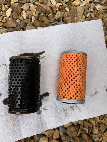

Oil & filter change. The old stuff was black and the filter didn’t look too clever

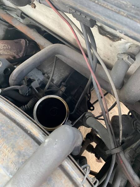

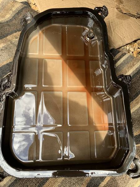

Got the transmission fluid changed. You know how most autos retain most of the fluid in the torque converter, meaning you need to drop the pan about 3 times for a complete change? We’ll enter stage left, a drain plug, accessible by a little service hatch in the torque converter. Simply turn the engine via the crank pulley to reveal
The ATF didn’t seem that bad once it was out. Someone had re-used the transmission pan gasket last time and stuck a load of sealant underneath it to try and make it work (it didn’t) so most time was spent scraping that off. Pan was relatively clean
Then it was re-filled via the dipstick tube. I also got the air filter & spark plugs changed. The air filter must have been proper clogged because it’s noticeably more sprightly now.

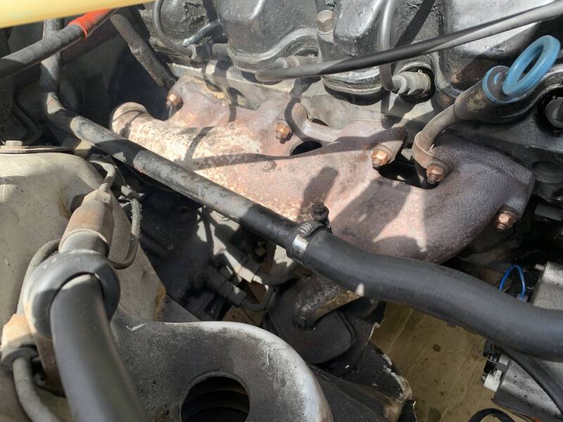

I’ve had a closer look at the exhaust manifold. This is the state of me nutz
I mean I’ve seen worse but I’m not filled with enthusiasm at the thought of shifting them. Current thoughts are a blowtorch and get some of those bolt grips that grab harder as you undo them. I’m open to further suggestions, I’ve never removed an exhaust manifold before
My nuts looked pretty much the same and all came off easily enough although I did give them multiple squirts of penetrating fluid before the main event.

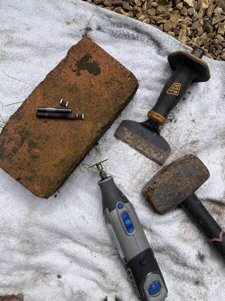

I decided to have a go at tackling this manifold job, gulp. I thought I’d do it at a leisurely pace over 2 days so I didn’t stress myself the fuck out...
I bought new studs and nuts in preparation and a set of nut extractors. I was fairly dubious about the latter but I’d have really struggled without them and can see them becoming a favoured weapon in the old arsenal so wud rekkomend. I first set about heating me nutz with a blow torch, which generated a highly *amusing incident whereby I set the fucking thing on fire. Turns out it’s not a good idea to lather everything in Plusgas and then apply an open flame. Who knew ??‍♂️. I was actually rather lucky as there’s enough oil on that engine block to make OPEC do a stocktake, so I put the blowtorch away after that!
I somewhat sensibly changed tack and gently tried a  12mm ratcheting spanner, which immediately rounded it. So I tried the 12mm extractor which didnt break the rust seal on the nut but gripped it so hard that it just wound the stud out of the head. It did that  for about 6 of the 8 and a couple stayed in. This took a while as the bottom nuts are a bit tricky to access and needed various combinations of spanners, extractors etc.
Got it off eventually but I couldn’t fully remove 2 of the studs from the manifold as the nut was stuck on and the casting didn’t allow enough room to extract them. Wasn’t too bothered as I had new studs so I could just cut these. This was the gasket that was leaking
It was flat as a pancake and very clearly leaking. I then began to build it back up and realised my new studs were too short by about 5mm as the internet had lied to me. Sigh...that meant salvaging the old ones, which didn’t seem in a bad way but most of them had a nut stuck to them. I didn’t have a nut splitter so had to get a bit creative
I actually got quite good at it by the 4th/5th one! System was, hold the stud with mole grips, cut a slit in each side of the nut until you could just see the threads, then lay it on the brick and twat it with a hammer and cold chisel until the nut broke off. I am genuinely proud to say, I managed to salvage them all. Even those two on the car that wouldn’t come out of the manifold. I had to do those in situ as I didn’t wanna remove the manifold from the down pipe and risk another leak, which was tricky as one was underneath, but I got there eventually.

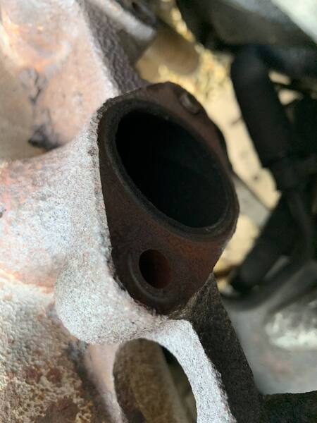

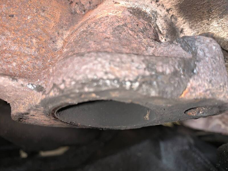

Unfortunately it seems that gasket wasn’t sealing because the face of the manifold on that port has sort of eroded away
You can see at the top of the port above, when you compare it to a “good” one below
Annoying as that left very little chance of the new gasket sealing either. Then I remembered I had this in the shed
So I got it all built back up, using the old studs with new nutz and gaskets and applied a smear of that stuff between the face of the problem port on the manifold and the gasket and tightened everything up
I started it up and...NO MORE NOISE!!! It only fupping worked. Now I’m not very hopeful that it will stay sealed, I’m 99% sure that as soon as I start razzing about in it, it’ll start blowing again as that stuff is meant for sealing holes back boxes and I don’t think it’ll stand the temperatures at the manifold. To fix it, I think I’m gonna have to get the face of the manifold skimmed. But for now I’ll celebrate a battle win, if not the war! And at least I know it’ll come apart next time.

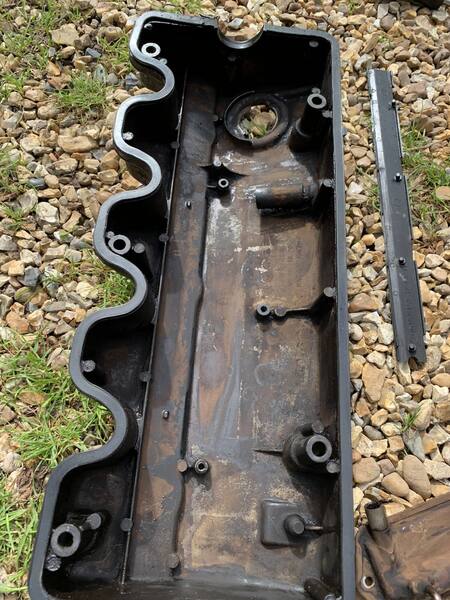

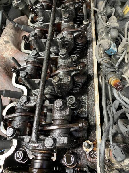

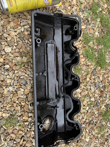

Spurred on by that little victory, I changed out the rocker cover gasket as the old one seems to have been leaking for about two decades. Thankfully this was much easier. It gave me my first look at the valve train
Grim! The oil in there is 1 week old and fully blackened again. I reckon it’s gonna need about 3 changes in quick succession to get it any better. It’s a bit sludgy in the crevices, I’ve heard putting oil formulated for diesels in is good at cleaning this, so I might try that next. I don’t fancy running engine flush through it in case it clogs the pickup or something. The rocker cover wasn’t much better
So I gave that a clean before it went back on

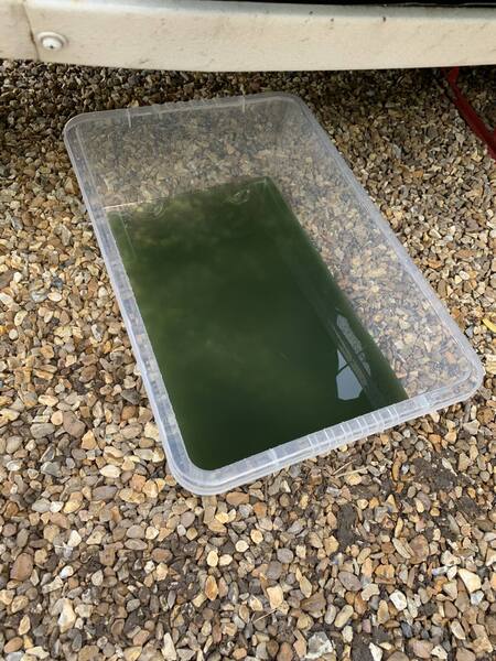

Coolant change and flush this morning. I was expecting worse than what came out
All went smoothly apart from initially forgetting to reinstate  the drain plug in the block before filling up and wondering why I could hear trickling. DOH! I also gingerly tried the bolts on the thermostat housing but they all came out no bother, so I swapped the stat as well. All bled up and it sits dead on 90 now, where it used to waver about a bit.

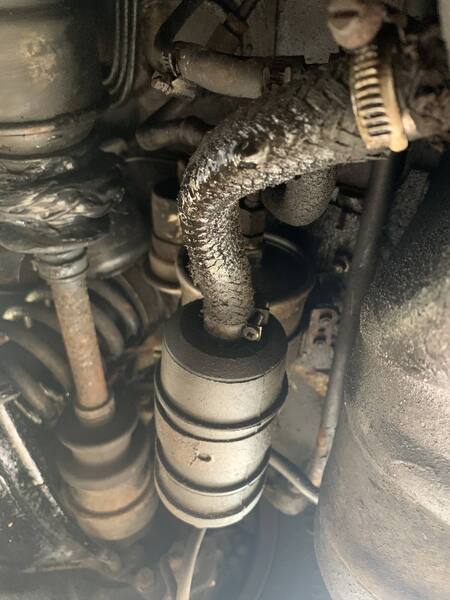

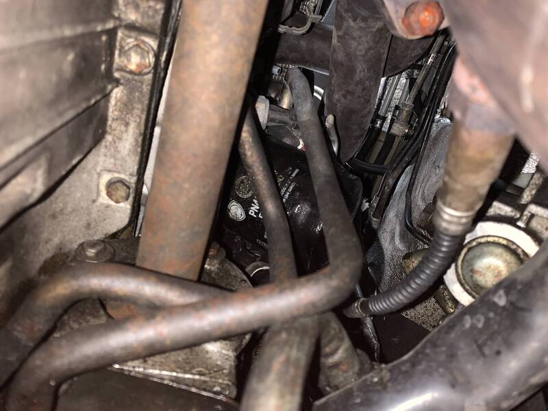

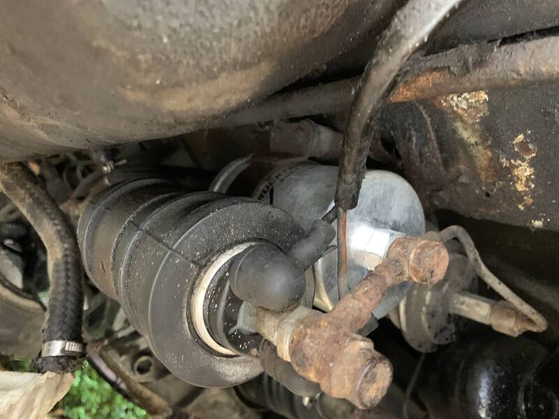

I then started to poke around these fuel hoses. The main feed from the tank to the pump looked suspect and sure enough, with a slight squeeze...
Shit. I didn’t have any fuel hose in that size and it had now ruptured good and proper. I wanted to take it with me to the motor factors so I got the right stuff, so I planned to try and pull one end off, cut a bit off and quickly reattach it to stop me losing too much fuel. As I did this though it properly split, so I ended up having to drain the sodding tank. It had just under a quarter of a tank in it so I then had to race round looking for a suitable container. I couldn’t find one, so I turfed out the bedding that was sitting in this plastic box and used that.
I also had another 5l in an actual petrol can. I got fucking covered in it, then had to pour it into some old screenwash bottles to store it. I then spent about 90mins driving to 3 different motor factors, none of whom had the right size hose, so I’ve had to internet order it and the car is now laid up until at least Monday. SIGH. I did, however realise why I could never find a setup that looked like mine on any parts diagram...

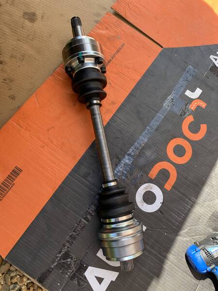

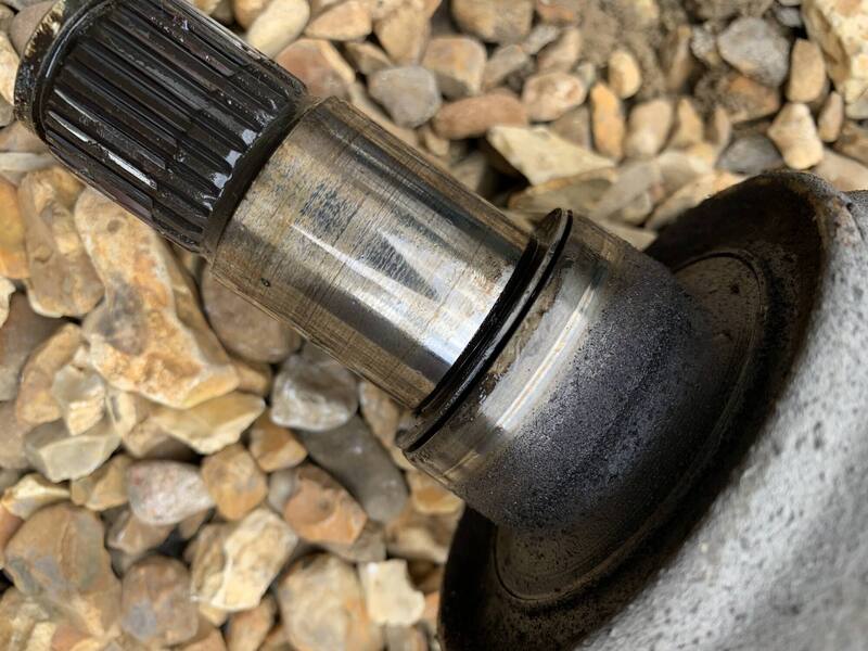

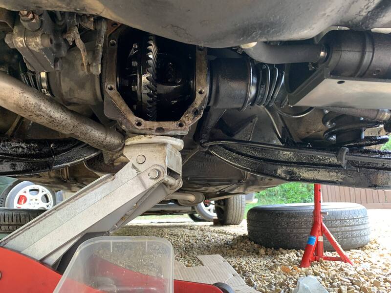

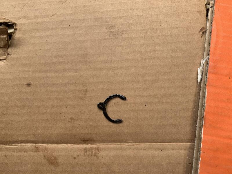

I mean, it was inevitable really, wasn’t it? FFS. I tried the syringe thing, which did work but the sticky boots were a shit seal so were leaking after a few days. The driveshafts were gonna have to come off. I looked at getting proper Mercedes boots and rebuilding them, but the CV joints don’t just knock off on these, you have to slice the can open and re-crimp them which is a massive faff and I don’t trust stretchy boots to seal either, so I looked for some new driveshafts. I found some decent branded ones for £111 the pair on amazon that were quite a bit dearer everywhere else so gave them a go, and ordered new driveshaft seals for the diff which took about 2 weeks to come. The shafts seem pretty good for the money.

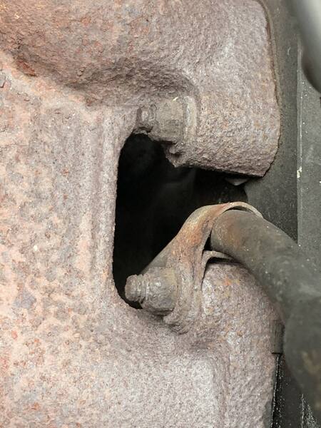

The shafts are held in by a bolt through the hub and a little C clip inside the diff
To access those means dropping the diff slightly, removing the mount and removing the cover plate. This involves jacking it up and down several times to make enough room to get all the bolts out past the ARB and self levelling stuff. I got all that done, everything bolted back up and re-sealed the cover plate. Turned out the driveshaft seals were the wrong bloody ones anyway so I couldn’t use them, which was a little irritating after taking forever to arrive. After torquing down the diff bolts, the driveshafts didn’t feel quite right though. Then I saw them
Those shims are on the end of the old driveshafts, sat on the floor. They should be on the end of the new ones, on the car. FUUUUUUCK ?
Don’t you just love working on cars eh? The above had just taken me about 4hrs and I needed to re-do about 90% of it. I went in, sulked for a bit, had my tea, then plucked up the enthusiasm* to go back out. 2hrs later, the shims were fitted. I’ve just had to leave it all overnight to let the sealant set on the diff before I can refill it with oil. After which, I hope to be able to leave this alone for a while!

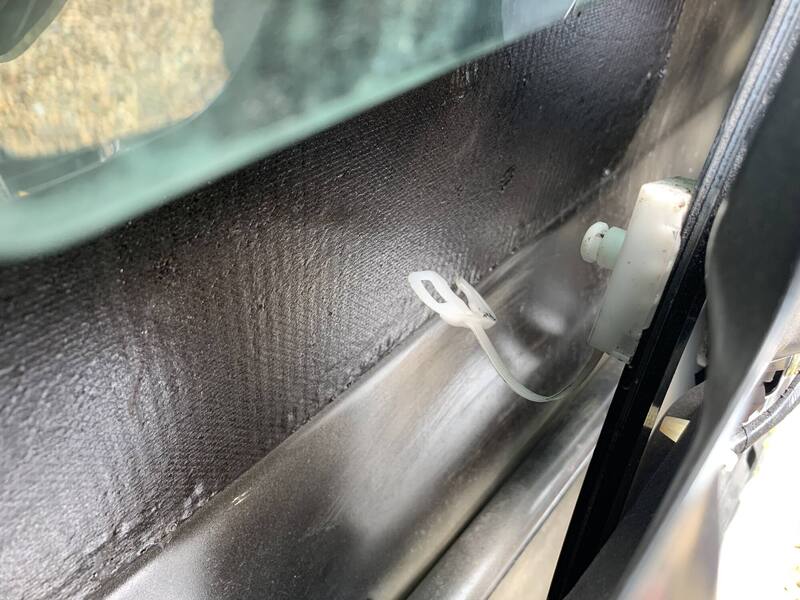

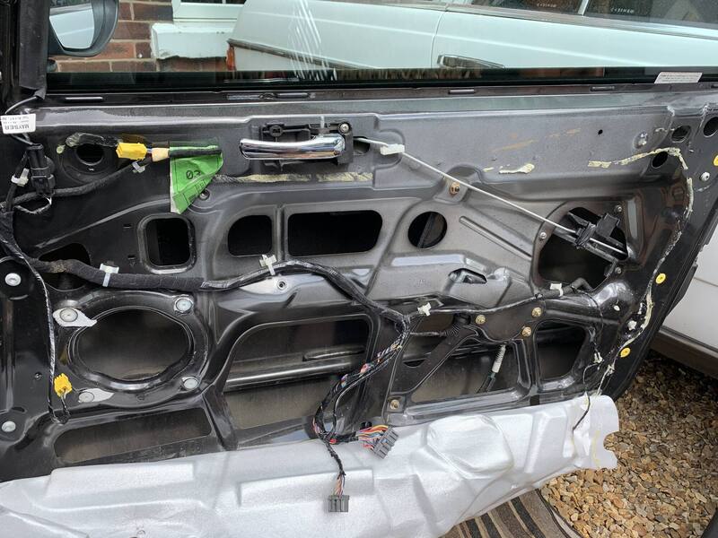

Getting the door card off on these isn’t too bad, but for the sealing strip running along the top edge. They get stuck after a few years and it turned out someone had already had fun with that, and broken the handle mount from the back of the door card by trying to yank it upwards. Great.
I had a root round the bottom of the door and found these 93406B7D-1171-4DF4-BE28-B12C0F6DC9B3.thumb.jpeg.c5810f3b0881315814983d0a495ca911.jpeg
The broken bits were from this clip
And the grommet from this hole in the glass that the clip should pass through to raise and lower the window
The broken bits were what held the clip to guide rail so it was just working in free space. As I was manoeuvring the regulator assembly out of the door, I inadvertently released the white clip from the cables. It turned out you can buy a replacement clip, which I intended to do as the rest of the regulator was fine. However I started reading tales of woe on the internet about getting the clip on as the cables come pre-tensioned, so thought I’d have a go with the broken one first. Yeah, they weren’t wrong! It’s virtually impossible without a vice which I don’t have and even then it would be a world of pain. I wedged a block of wood under the glass so I could still use the car and priced up a new regulator. A genuine one was about £115 which I thought was pretty salty so I ordered a pattern part of eBay for about £40. What arrived was the biggest pile of shit I’ve ever bought. Utter Chinese shite. It didn’t even have a frigging plug on it, just some crimped bullet connectors and two awful pin adapters to shove into the female end of the plug on the car! These adaptors didn’t even fit the connectors so I had to chop them off and modify it with some stuff I had in the shed. I forgot to take any pics unfortunately but I’ll probably be seeing it again fairly soon as I’d be surprised if I get 6 months out of it! I should have just sent it back.
Oh and once I’d got it all back together, I realised I’d fitted the pins the wrong way round, so it lowers when you pull the switch up and raises when you push it down. Dickhead. It can stay like that now until it breaks again.

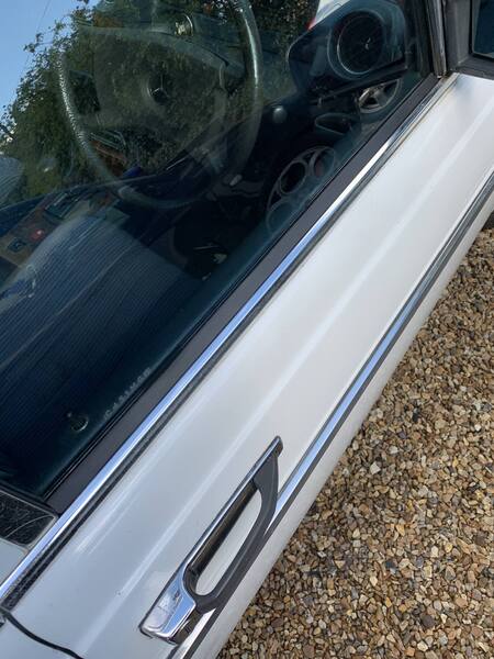

Whilst I had everything off the door, I did a job I’ve been meaning to do for ages. The soft touch coating on the window switches turns to a horrible sticky goo and mine were particularly bad E222D5B0-A28C-45DD-8DB5-F55953509ED3.thumb.jpeg.376d10e628125bd04e5d560a33681d00.jpeg
I’d read a few methods for removing it on the internet including pure alcohol, anti-bac wipes, baby wipes, none of which seemed to have any effect on mine. There’s a video of a guy taking a heat gun to it and rubbing it off but that seemed a bit overkill. I tried some meths on a cloth, which did the trick very nicely and got them looking presentable again.
So there’s my top tip. Meths!

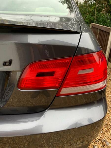

Obviously it’s knocking on now so it’s not all sweetness and light. There’s a rust bleb on the boot lid, which appears to be going all along that seam
but overall that’s the worst mark on it. The inner rear lights had gone milky in the way that headlights often do and someone had stuck a stupid badge on the back (why?!), so that was jettisoned and I polished up the lights earlier today. Before:
After:
