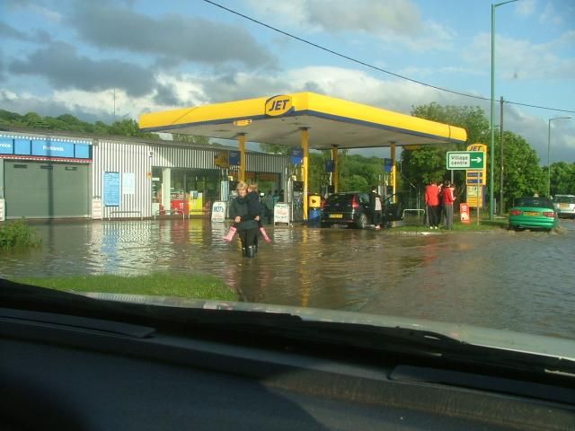

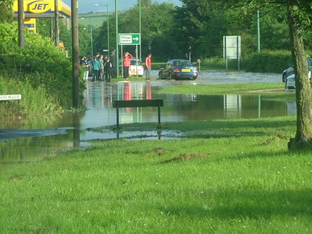

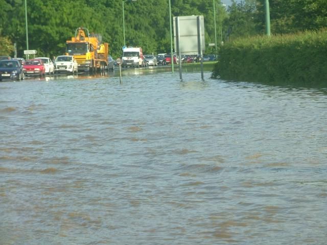

Even Land Rovers aren't immune from morons driving them into floods:
If that's BER and going for scrap, I know a good home for it!
