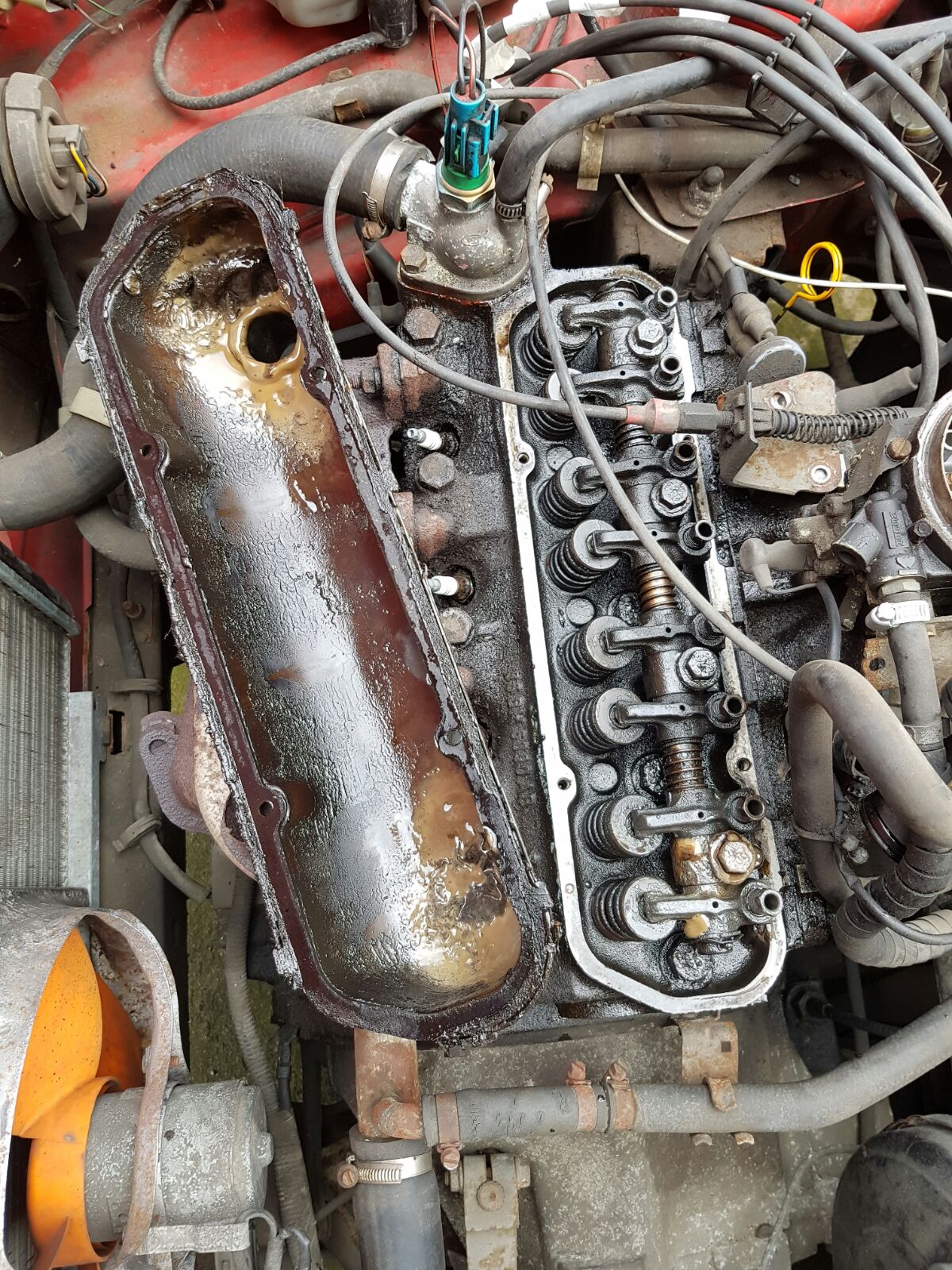

So now I'm confused. Took off the rocker cover today and found some gunk but not loads
Isn't a head gasket failed meant to be a lot worse than this? I've seen this before in my other 950 and it was just condensation (it had already had the gasket done).
But with the car getting hot and the heater only blowing cold I don't know what's best.
had that engine in a mk4 escort and it was always full of mayo...think its just something they do unless youre doing lots of miles
I know it's a thing if they don't do a lot and at the moment mine isn't but apart from being blocked with crap why isn't the heater working?
Saying all this there's no oil in the expansion tank or on the dip stick.

I would be checking the thermostat and flushing the cooling system on that before assuming the head gasket has failed.
