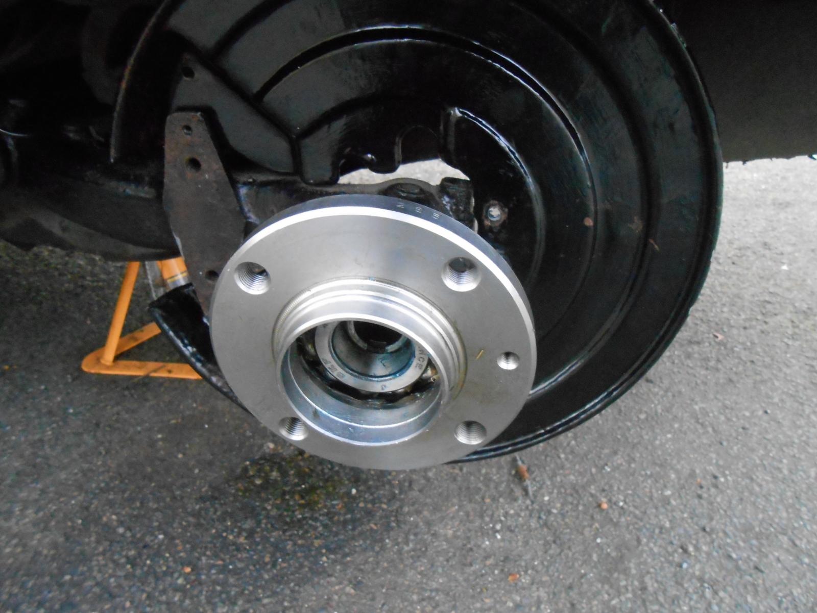

Cleon-Fonte Posted February 24, 2017 Posted February 24, 2017 So, a question about wheel hubs. Currently fitting new rear ones to the BX, and the Haynes manual helpfully states 'engage hub with stub axle until hub nut thread is visible'. Easy enough, you might think, except that merely 'engaging' the hub onto the stub axle that far doesn't seem to happen, whatever I do. I've tried heating up the bearings to no avail, and using any kind of force merely results in a pile of broken ball bearings on the floor (luckily I have twice as many hubs as I need). What am I doing wrong?
scaryoldcortina Posted February 24, 2017 Posted February 24, 2017 get your thumbs in to help the inner race of the outer bearing over the stub axle, it looks from the pic like it's catching the edge and not pushing over. Failing that, find a big socket and a hammer to tap it home with.

twosmoke300 Posted February 24, 2017 Posted February 24, 2017 On the bx hub - sounds silly but have you taken the inner race off the stub axle ? They usually stay on and need to be cut off . To the unaware it looks like part of the stub . Sorry if I'm teaching granny to suck eggs
scaryoldcortina Posted February 24, 2017 Posted February 24, 2017 ^ lol, that's a good point. hadn't thought of that!
twosmoke300 Posted February 24, 2017 Posted February 24, 2017 Every single bx rear bearing I've done the inner race stays on the stub axle
scaryoldcortina Posted February 24, 2017 Posted February 24, 2017 Yeah, I know! I hadn't considered the possibility that someone might mistake it for part of the axle.
3VOM Posted February 24, 2017 Posted February 24, 2017 Yeah, I know! I hadn't considered the possibility that someone might mistake it for part of the axle.Good point. Mr Cleon-Fonte, remove new part from view and post picture of stub axle as is.

Cleon-Fonte Posted February 24, 2017 Posted February 24, 2017 I can confirm the stub axle is bearing race free, and using scaryoldcortina's technique of hitting the inner race with a socket I now have one bearing successfully placed on the stub axle. No hub breakage occurred during the proceedings. Thanks for the advice chaps, it's saved me a lot of annoyance and hassle. DeeJay, DodgeRover and scaryoldcortina 3
twosmoke300 Posted February 24, 2017 Posted February 24, 2017 Glad you got it done and hope I didn't insult you with my suggestion
