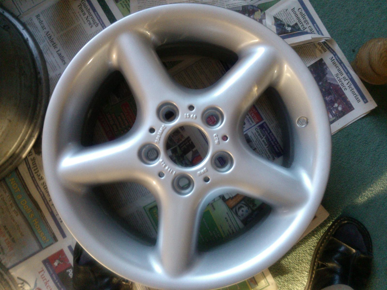

SQ: Do alloys degrade once they've lost their lacquer?  Can I either sand / paint or have them refurbished and then they'll be as good as new?
Yes and yes. Exposed metal corrodes and you can get good results with rattle cans and laquer.
Simple wheel designs are much less fiddly to rub down, the finish reflects the prepation.
Aluminium don't degrade constantly the way iron does, it forms a hard skin of oxide (the dull powdery look) everywhere the air gets to it, this skin prevents the rest of it from oxidising. Even left bare the worst you can expect from a wheel is it going a bit chalky on the surface.
Stripping and painting usually works fine.
