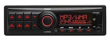

On one of the Audio threads on here I'm sure somebody posted about a modern stereo that doesn't look offensive in older cars. Can anybody remember what kind it was? I don't think it was any of Sony/Pioneer/Blaupunkt etc.
Clarion FZ102 ?
