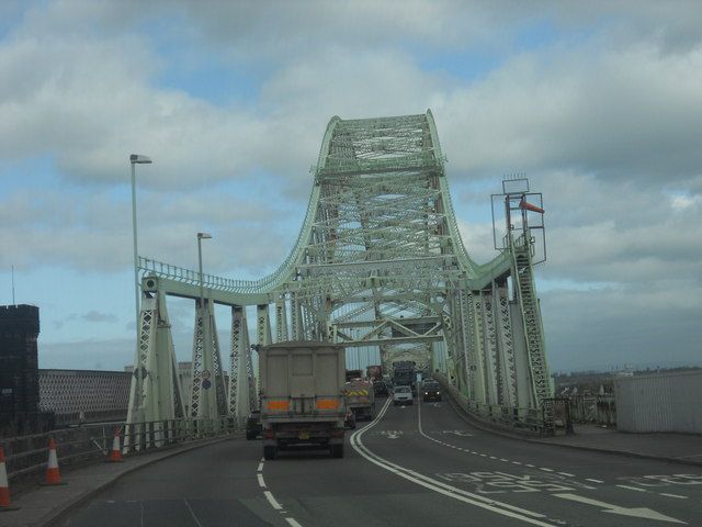

Bucketeer Posted January 16, 2015 Posted January 16, 2015 Is it possible to cycle/push a bike across the Runcorn bridge? Not much help and certainly not a definitive answer but in the picture below there seems to be a footpath/cyclepath on the right hand side of the bridge. willswitchengage 1
Bucketeer Posted January 16, 2015 Posted January 16, 2015 ^^^^ Also - It carries the A533 road and a cantilevered footway. willswitchengage 1
