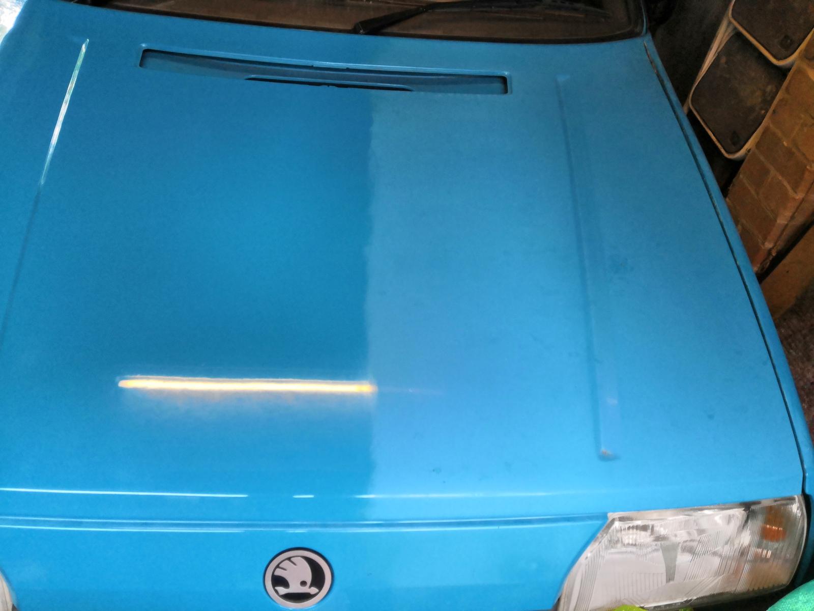

Have to say this is the reason I don't offer much advice from my rusty knowledge bank on jobs like this because it really is either don't do it at all, or you have to do it properly!
4 grades of pad, 4 grades of polish and a paint depth gauge and a weekend and you would have it looking mint.
But you would have to re-polish it (although only lightly) every month or so to keep it from not fading
Add in your iffy paint job...
It's why I've never actually fully machine polished a car, I just cant be bothered. I'm sure it would look lovely, but I'll never do it! I've got damage out before, and saved my stepdad from a bollocking from his fleet manager, and I did the bonnet of the puma which did look sick, but took all day...
Did I hear right that your using a rotary? Get some Autoglym super resin polish or ultra deep shine, and a spray bottle of water. Rotary the SRP in, it's very filler heavy and doesnt have much cut, so you can work it more. You'll need the water because it will dry to a horrible chalky mess, so when it starts to dry out a squirt of water on the panel, then run the pad over it will keep it going.
Then buff the SRP off, then find a glaze, my usual Poorboys Black Hole is my recommendation. Then a wax.
Then stand 7 paces back to admire it! Should only take a day. But in this weather? Pffft. Shame, because the 406 is looking utterly hanging!
As your finding out, it's either do it VERY properly, or just wash it!
It's a dual action 'wobble all over the place' job, which has mostly left me realising I have absolutely no clue about how much compound to use, what to do to the mop heads, how much pressure, how much speed etc. However, the results with the mop are certainly no worse than me just doing it by hand, and it was a lot quicker. Every pass has just revealed more and more paint damage though. Maybe I should try and wrap it myself. That couldn't possibly go wrong.

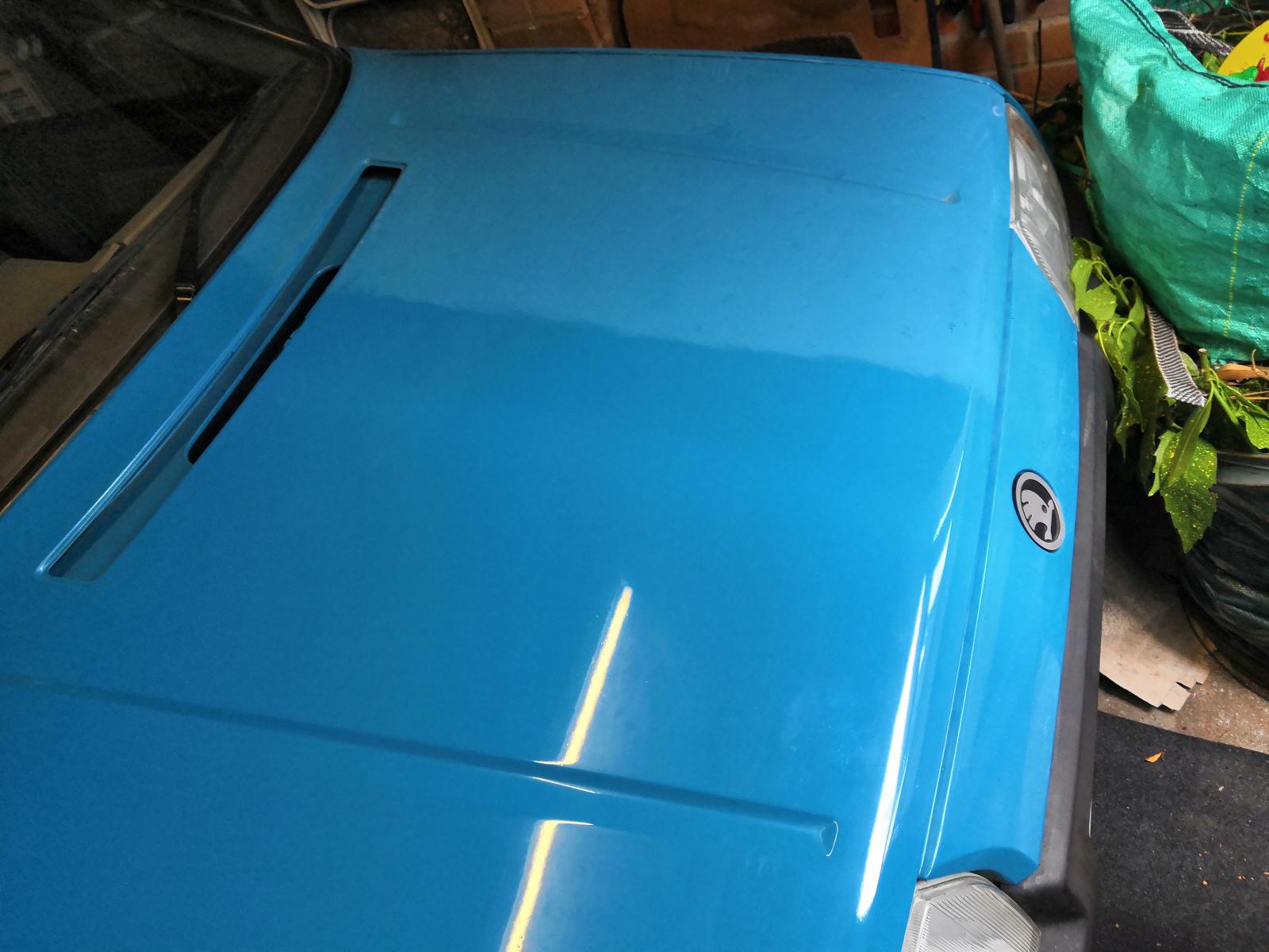

Machine polishing is just about the most boring time consuming job there is.
I must admit i do find it satisfying once complete but my back doesn't like it much nowadays.
The trick is to just take your time. Each pass with the polisher should be slow and even with only light pressure (but I use a rotary polisher so different technique)
Keep topped up with compound but only small amounts at a time and keep working it.
I use a medium pad and a medium grade compound for most stuff but do often finish with a fine pad and a fine compound.
Mind you, the polishing I do is on cars that I have just painted so the amount of effort is much less than trying to revive faded red paint.
I wonder if tinted T cut might be a temporary solution? I seem to remember my stepdad using it on a faded red mk2 Fiesta when I was a teenager and it came up ok except he got it all over the black plastic trims and the rubbers which just looked terrible.
