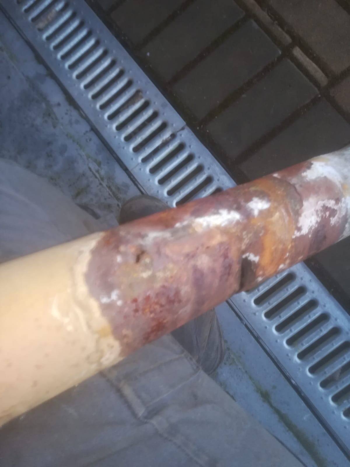

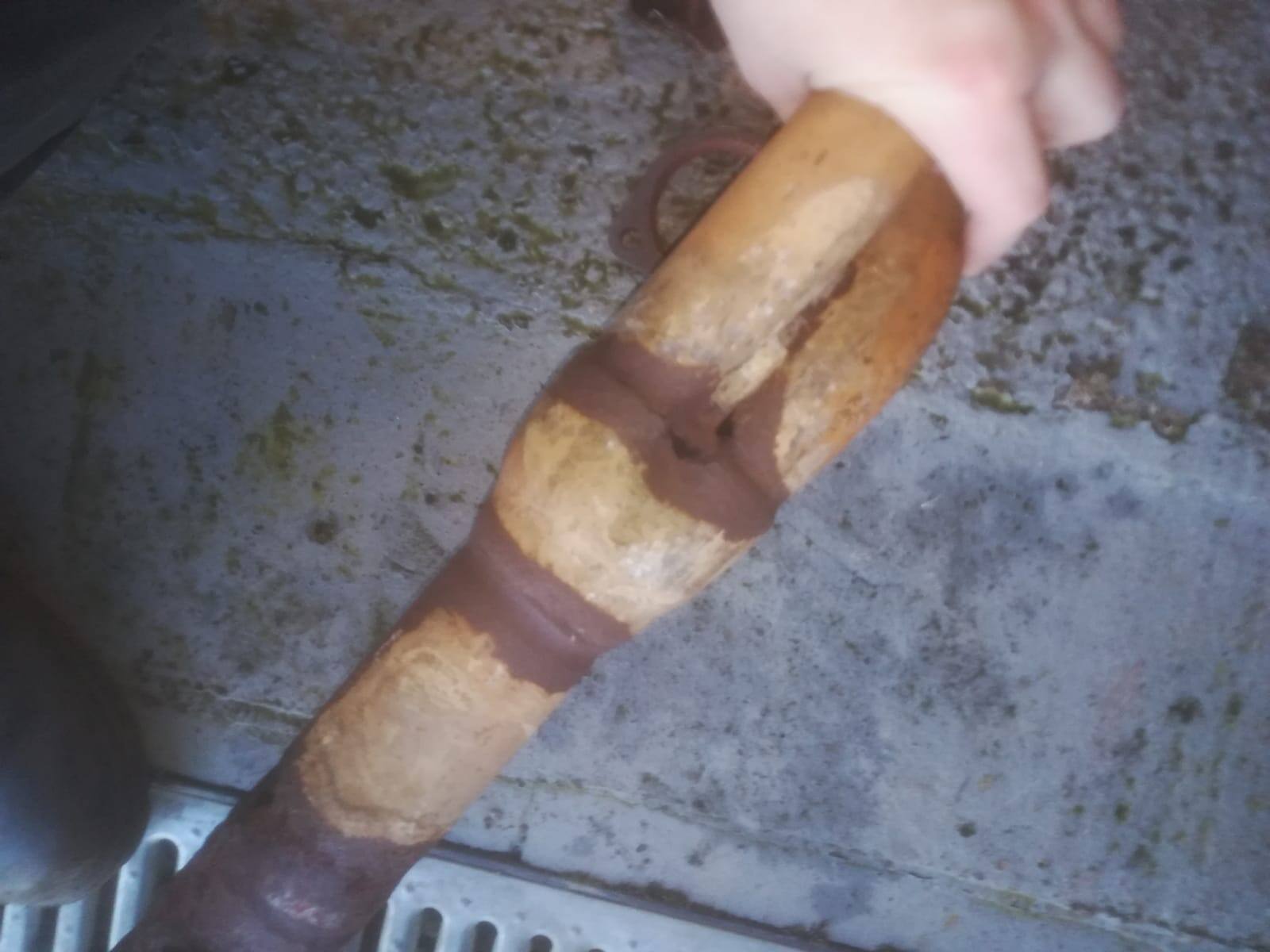

The car has done at least 220k running on veg oil - which has a higher moisture content than DERV..
Subsequently, the exhaust has suffered some* corrosion
IMG-20191230-WA0017.thumb.jpg.bb3aabe9e1d072938aa366c77548fa9a.jpgIMG-20191230-WA0020.thumb.jpg.e1d37045b719b018ca572d7f6794fa2d.jpgIMG-20191230-WA0021.thumb.jpg.b013ebff2aebe88dcb899835fa6a2ab8.jpgIMG-20191230-WA0016.thumb.jpg.d0d01fb962be21d61b4d5b27e16caf03.jpgIMG-20191230-WA0018.thumb.jpg.7d157468e01371eae1cddf9ceb930b6f.jpgIMG-20191230-WA0019.thumb.jpg.d6e790283ec65ab995961373c10841a0.jpgIMG-20191230-WA0015.thumb.jpg.58102ab5ca9d0c07361adf12ed4132a6.jpg
as can be seen, it was somewhat overdue replacement. He already has the system from the downpipes back, but needs to order a downpipe.

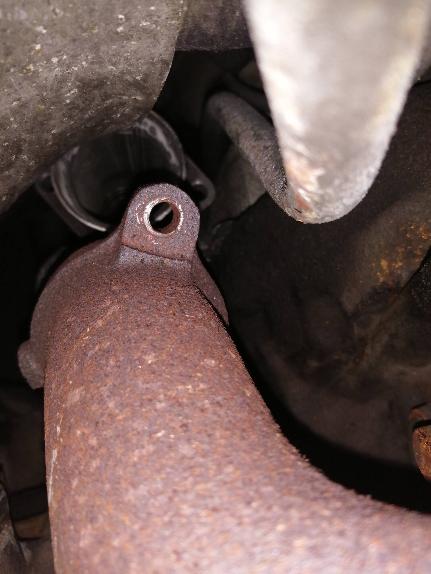

Unbelievably, all 4 downpipe bolts (2 per pipe) came off without fuss - we reckon it must be the original system.

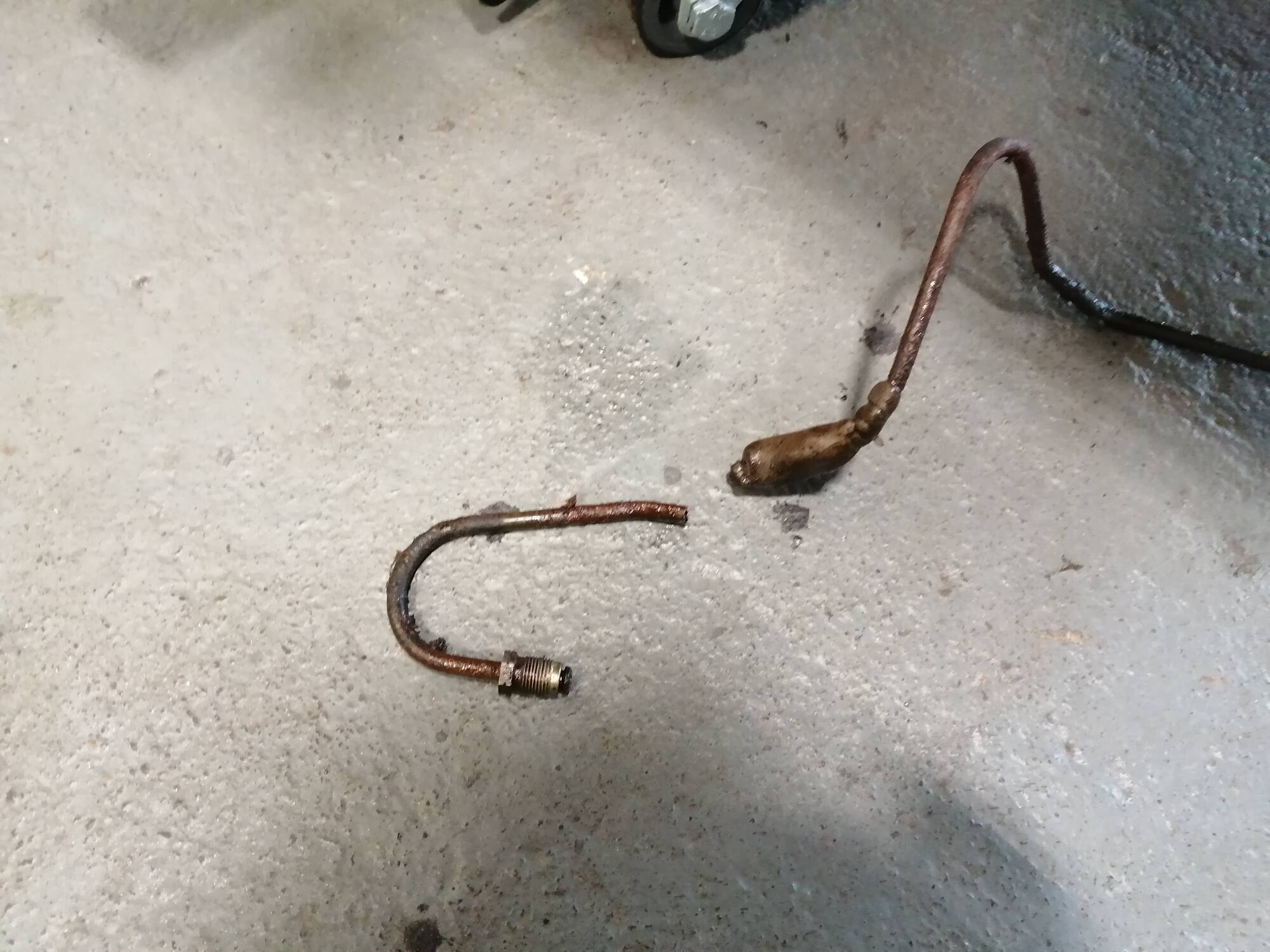

Replaced the front to rear suspension lines, as they were holier than a holy thing.

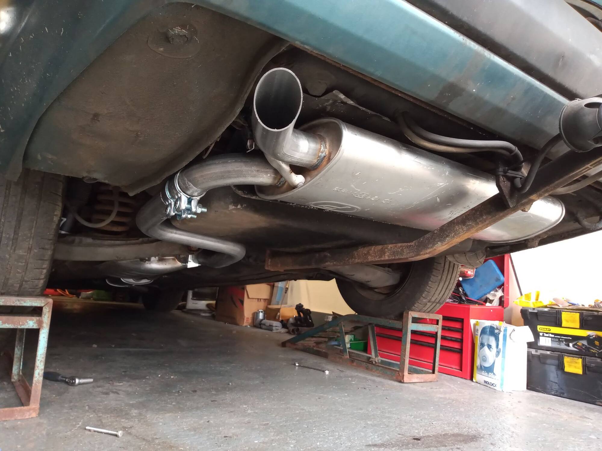

Removed the remnants of the exhaust, and replaced it with a new system (at the second try)

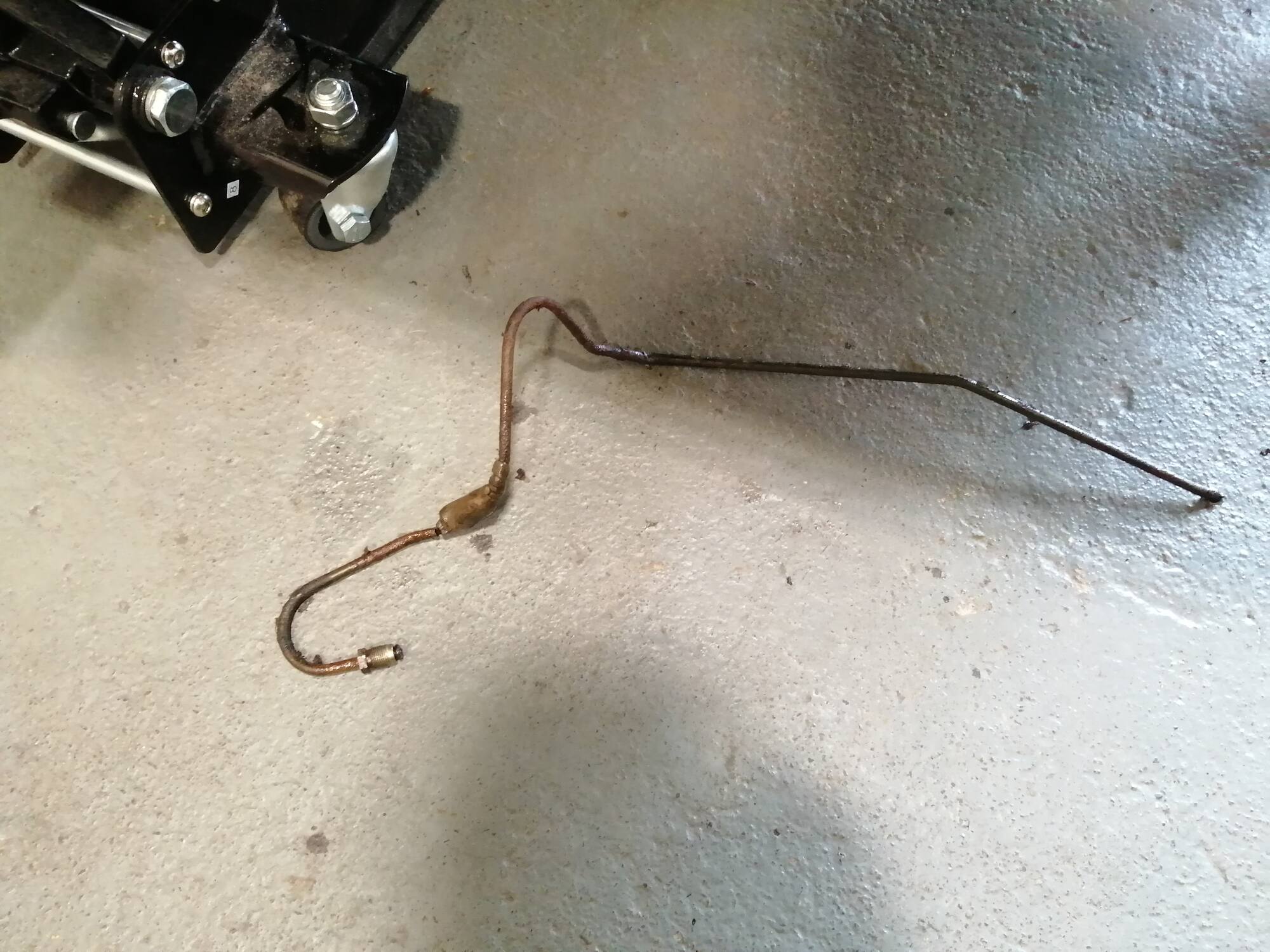

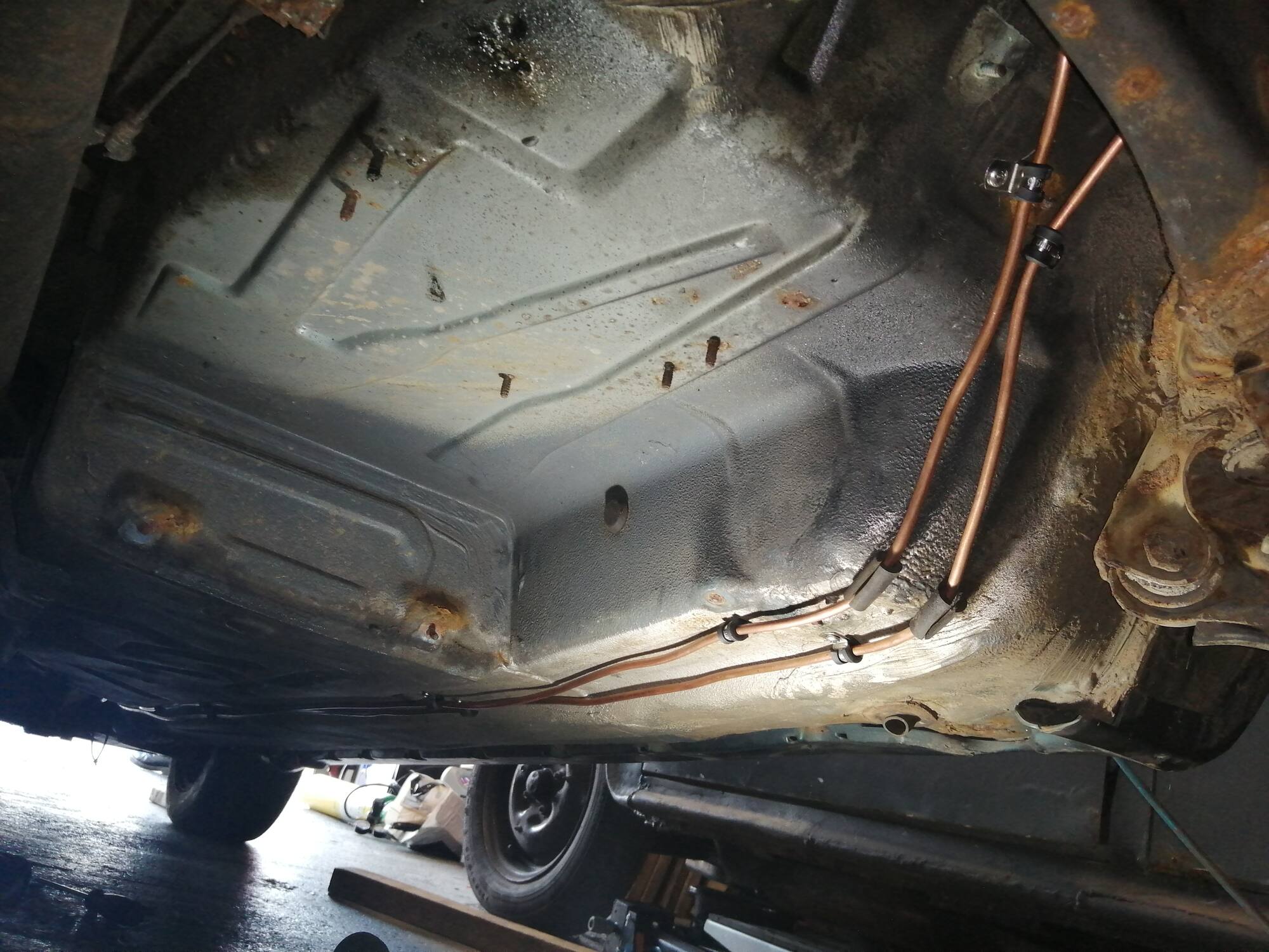

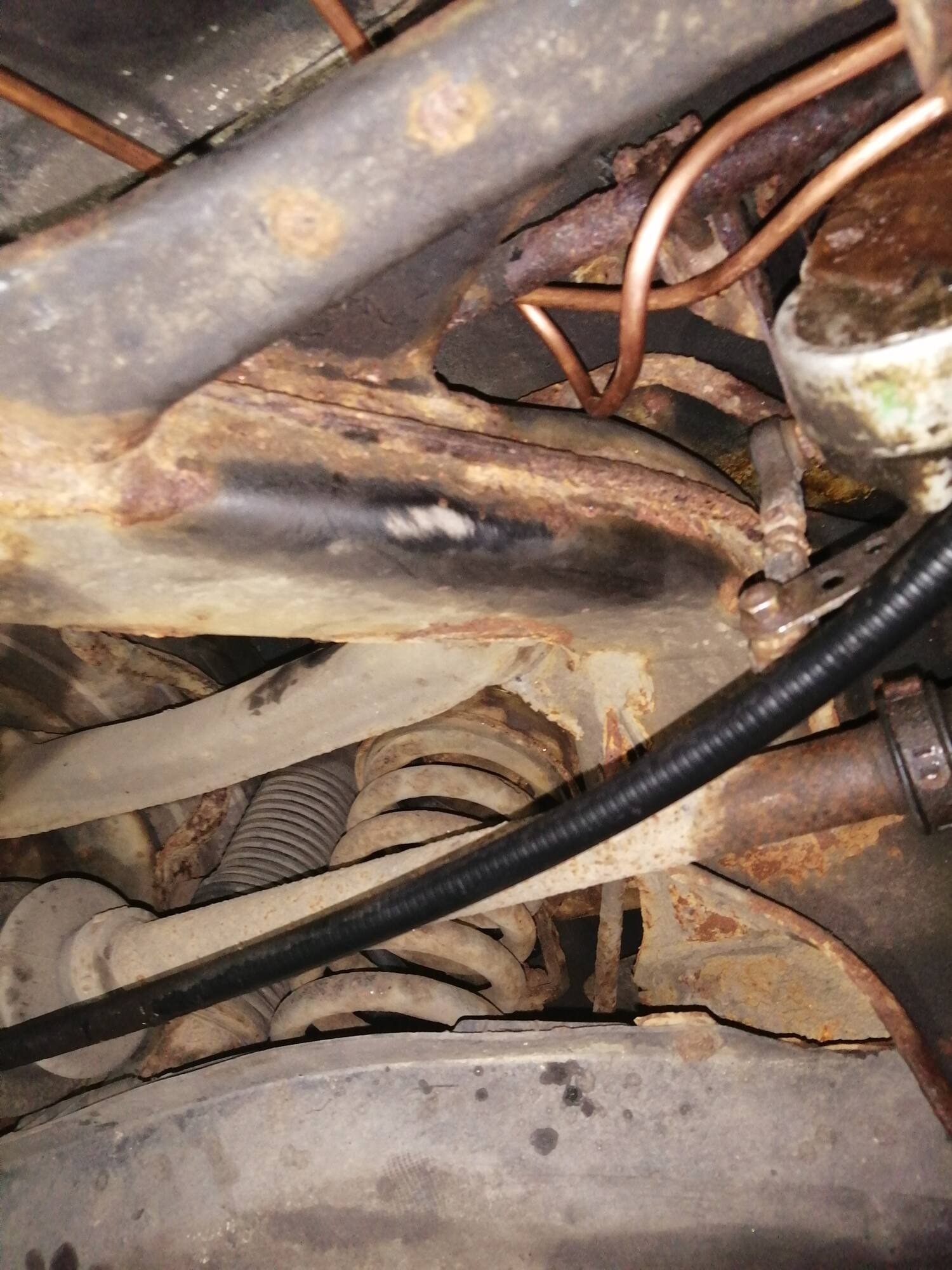

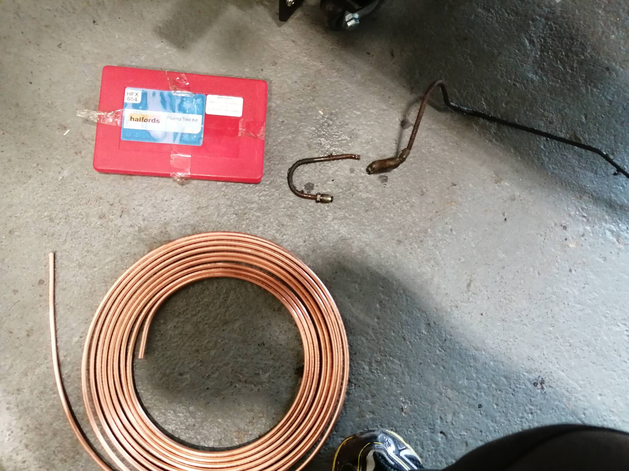

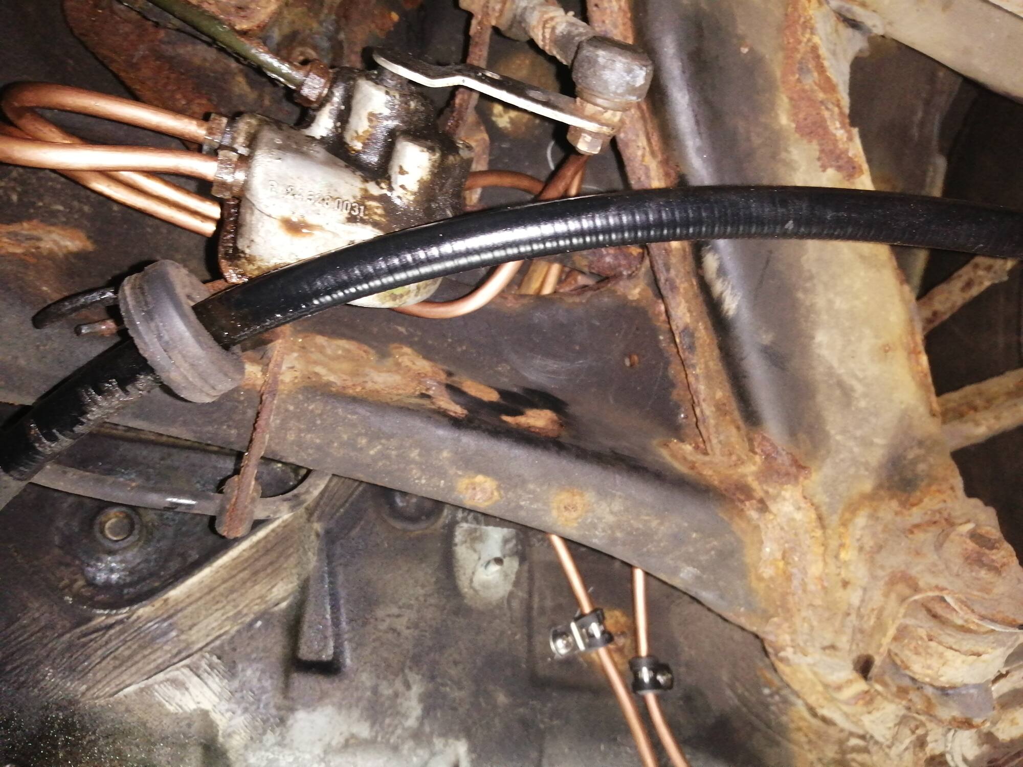

First part of the plan was to change the suspension pipes, so, off with the old. I initially only looked at replacing the feed line, however, once I did that, and filled the fluid back up, then started the engine. It burst the return line! #joy. So that was replaced too. I used some 6mm copper pipe to replace.
Fear not, the pipes were later secured with P-Clips and self tappers, as the original brackets had twisted out of the floor. IMG_20200815_120604.thumb.jpg.3560c50ad3a2edec2677d758464122b2.jpg

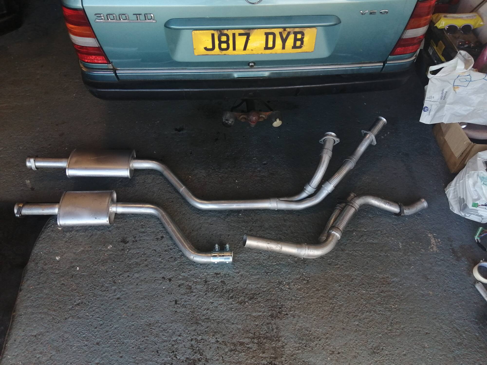

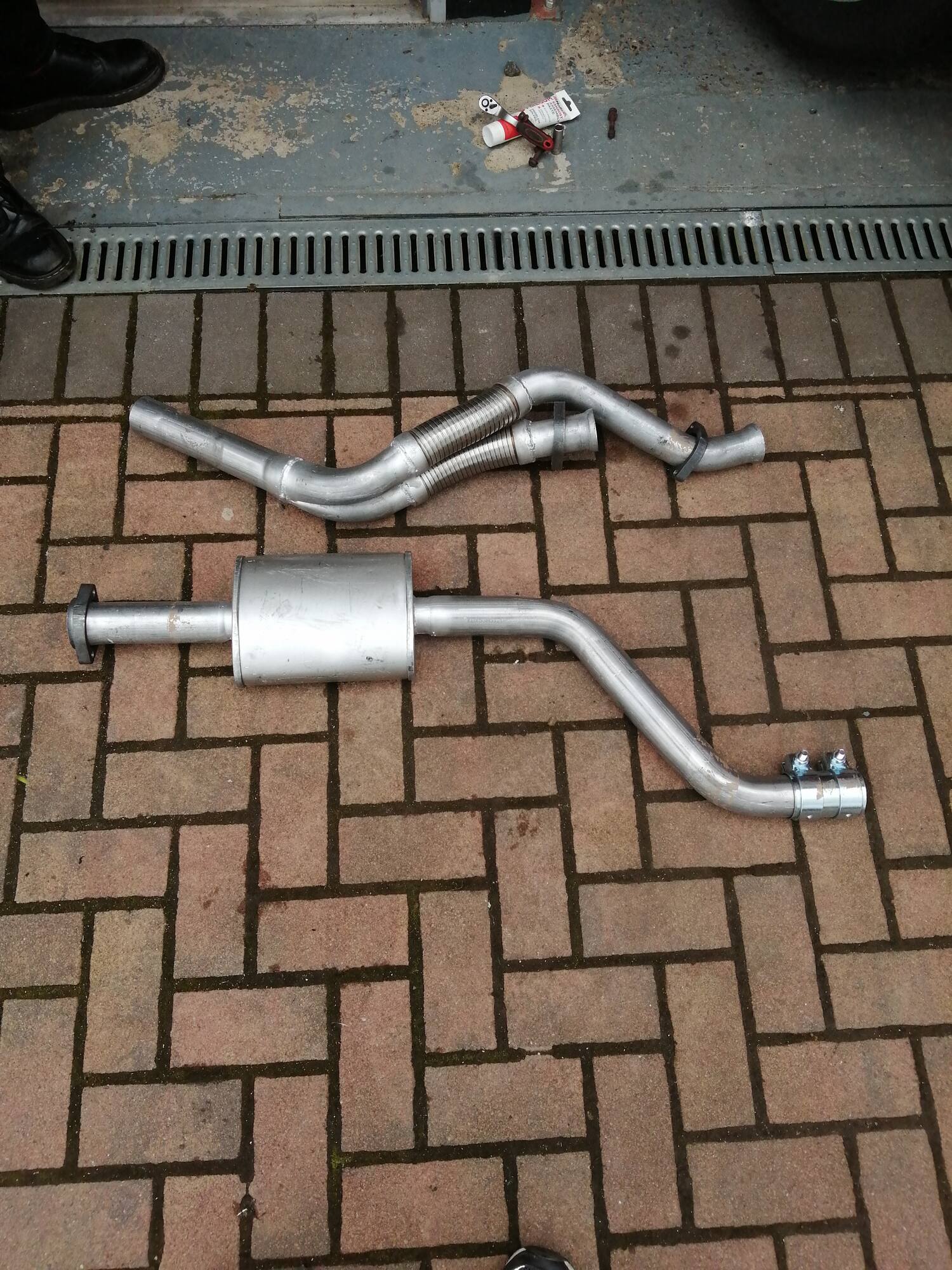

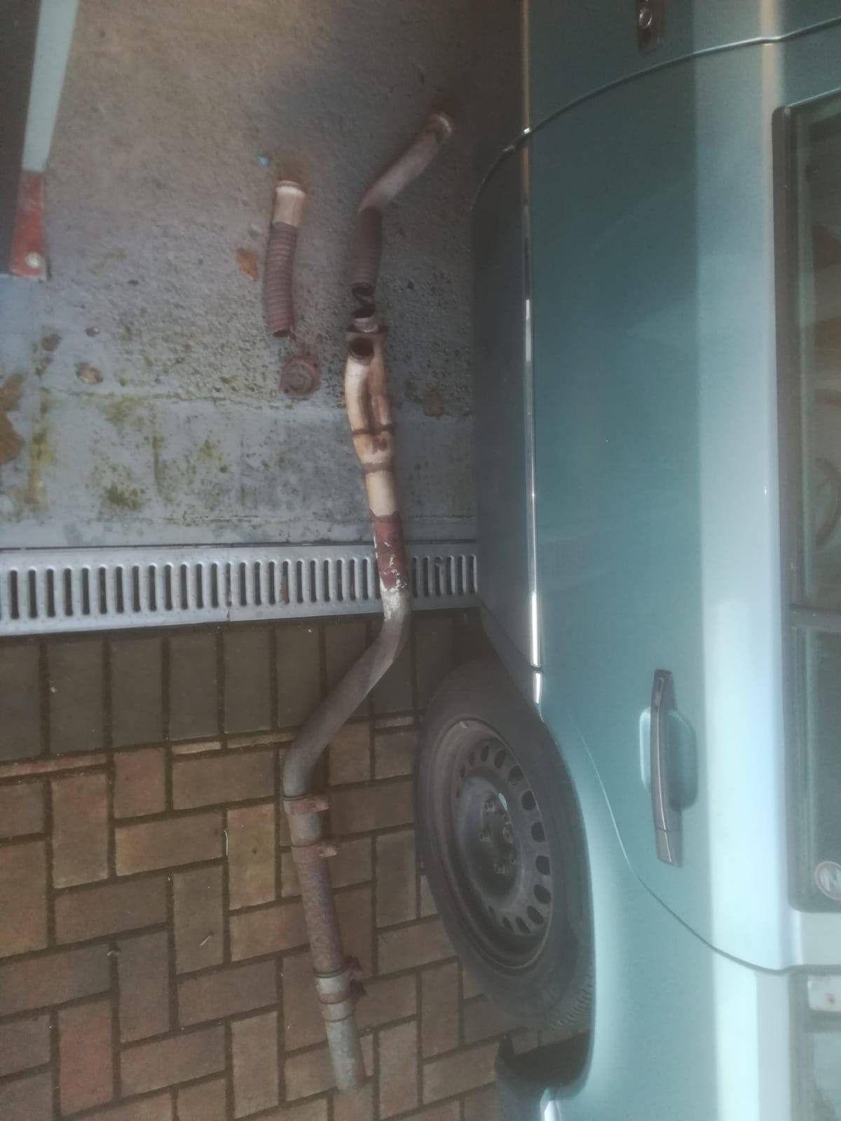

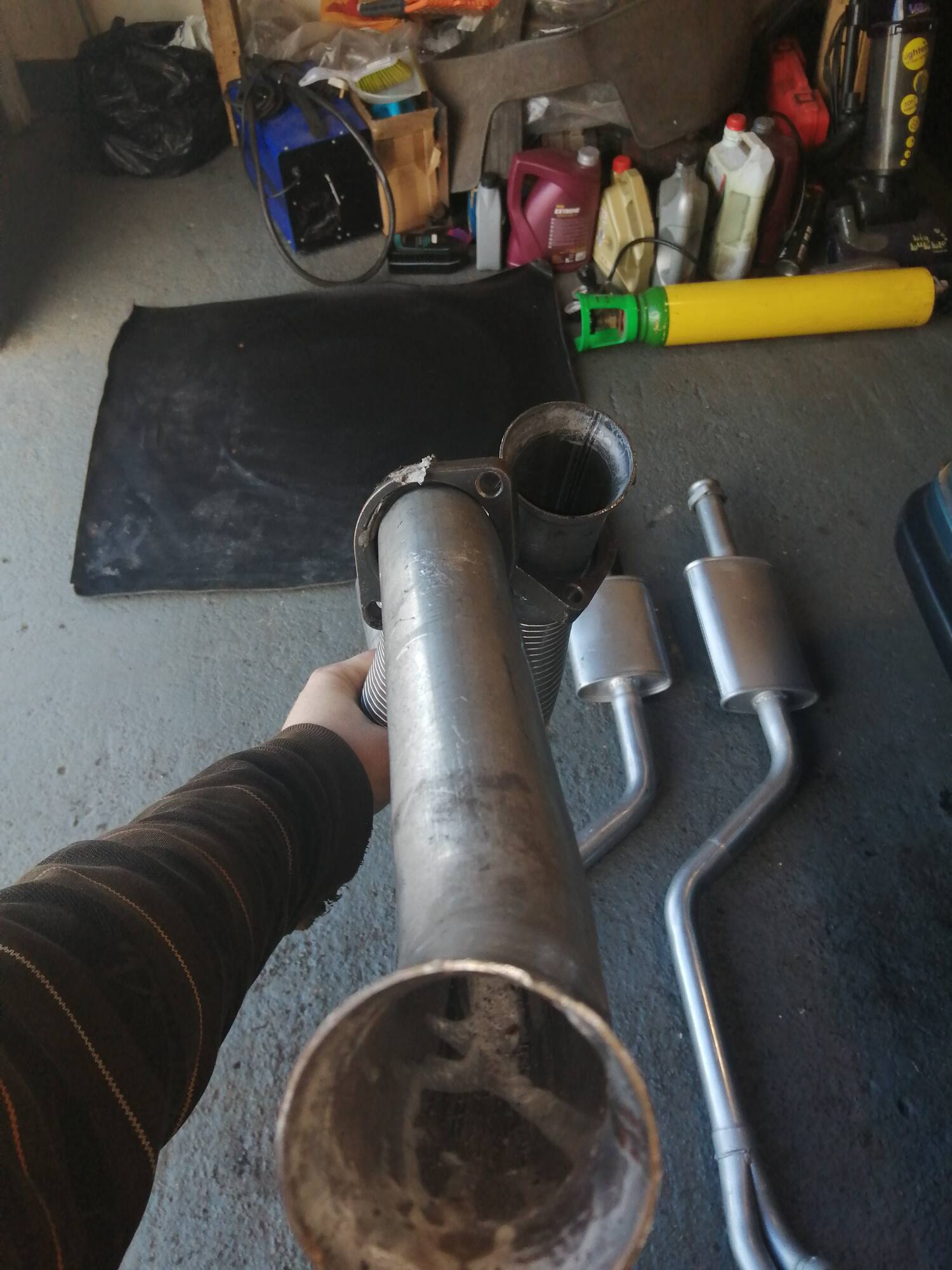

The first try was usurped by the exhaust supplier sending me a downpipe for a LHD W124, this made it super* fun* to try and install, as it kept getting hooked up on the steering box. Eventually, after a couple of hours, I got the front pipe onto the manifold, then realised that the rear pipe wouldn't reach the rear manifold. This made me extremely* happy* and I said such things as 'I am certainly glad, that I was given this opportunity to figure out potential engineering solutions to this problem'.
It's the wrong downpipe Gromit.... IMG_20200821_153506.thumb.jpg.6c9aa1af408460abc42fa345b776522c.jpg
And it's gone wrong.. IMG_20200821_174225.thumb.jpg.8a0d81b39a48e2fcb1c365f1b880f538.jpg
FLIP*
To further improve* my mood, I then dropped the centre section of the exhaust onto my middle finger, trapping it between the exhaust and a hammer. At this point, I gave up for the day.

Round 2.
It's the right downpipe Gromit (it fkn btr b m9) IMG_20200829_103158.thumb.jpg.52aed2a5e33787d51d70f56e013a0622.jpg
Clearance for the steering box.... YAAAS IMG_20200829_103206.thumb.jpg.b3aad5752832ec564aa3218371af5abe.jpg
Some comparison shots.
1st downpipe
Correct downpipe
Thankfully, fitting the correct part is far easier. So with some @captain_70s assistance at the front, and @dome at the rear (oooh err) it was snipped up in no time at all.

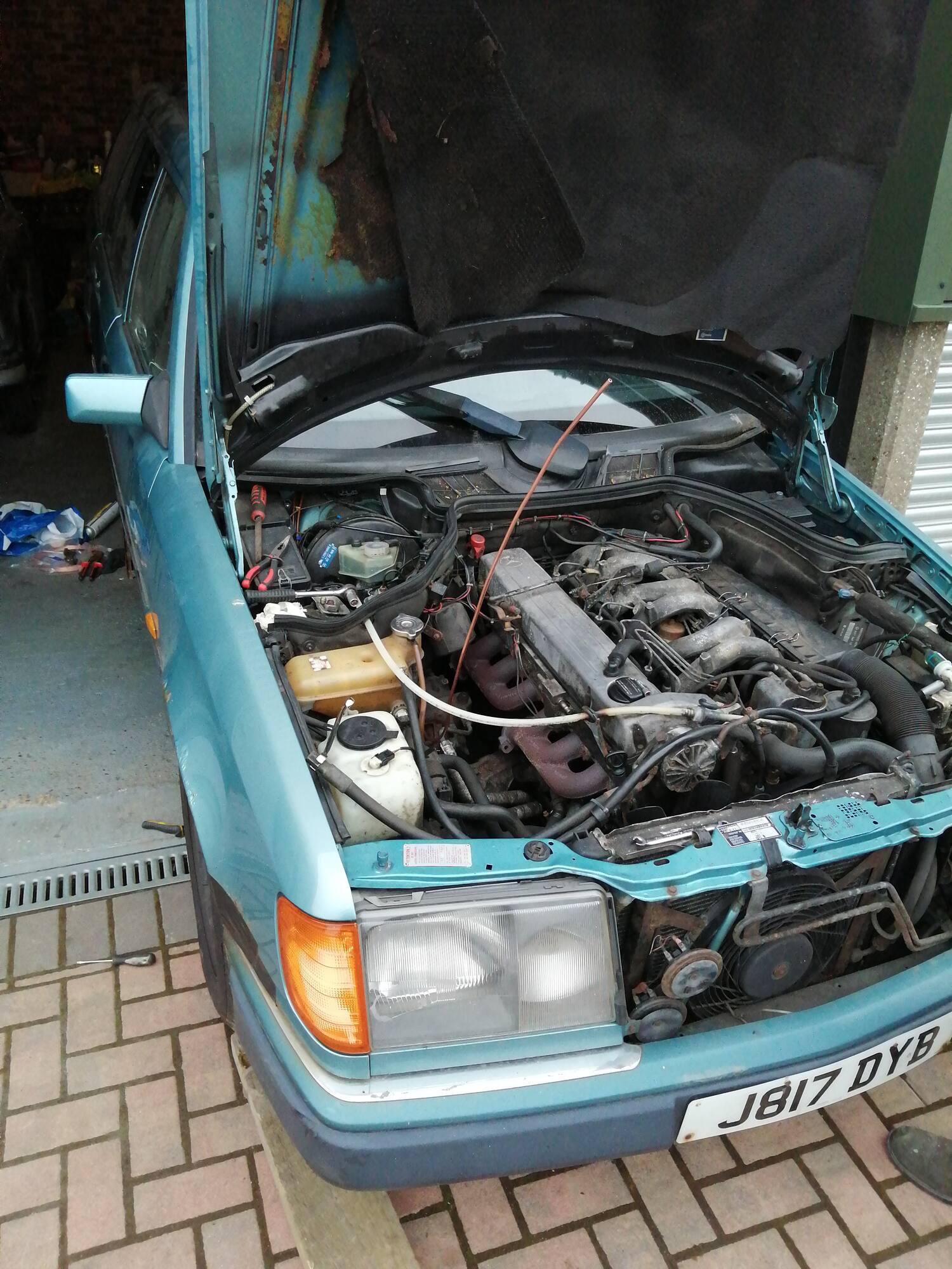

Then it was time to start the machine to see if it had been a worthwhile endeavour. Thanks to @320touring for the video, as you can see and hear, she started on the first* turn of the key, with no throttle, nor* did she require a quick loan of @dome's newly purchased battery for the Jag.

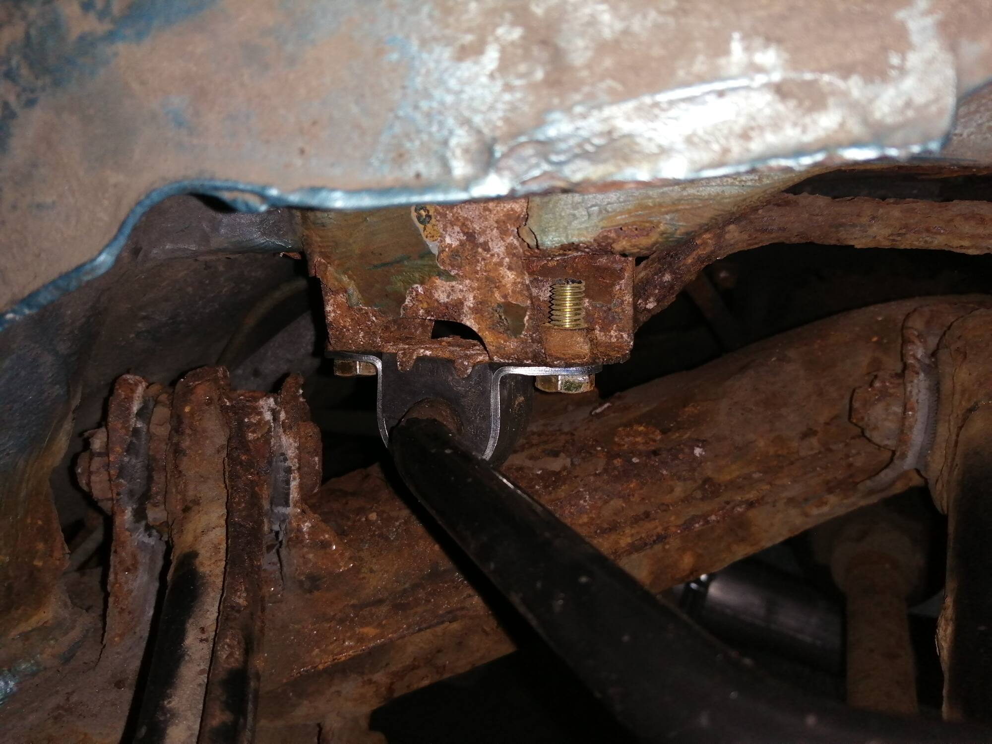

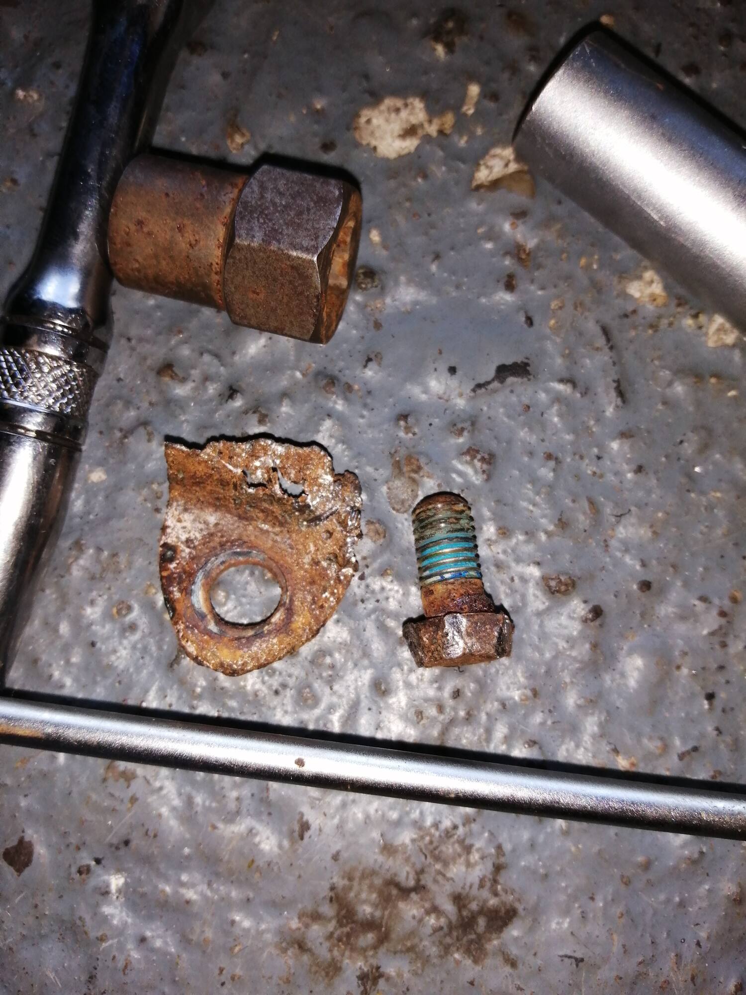

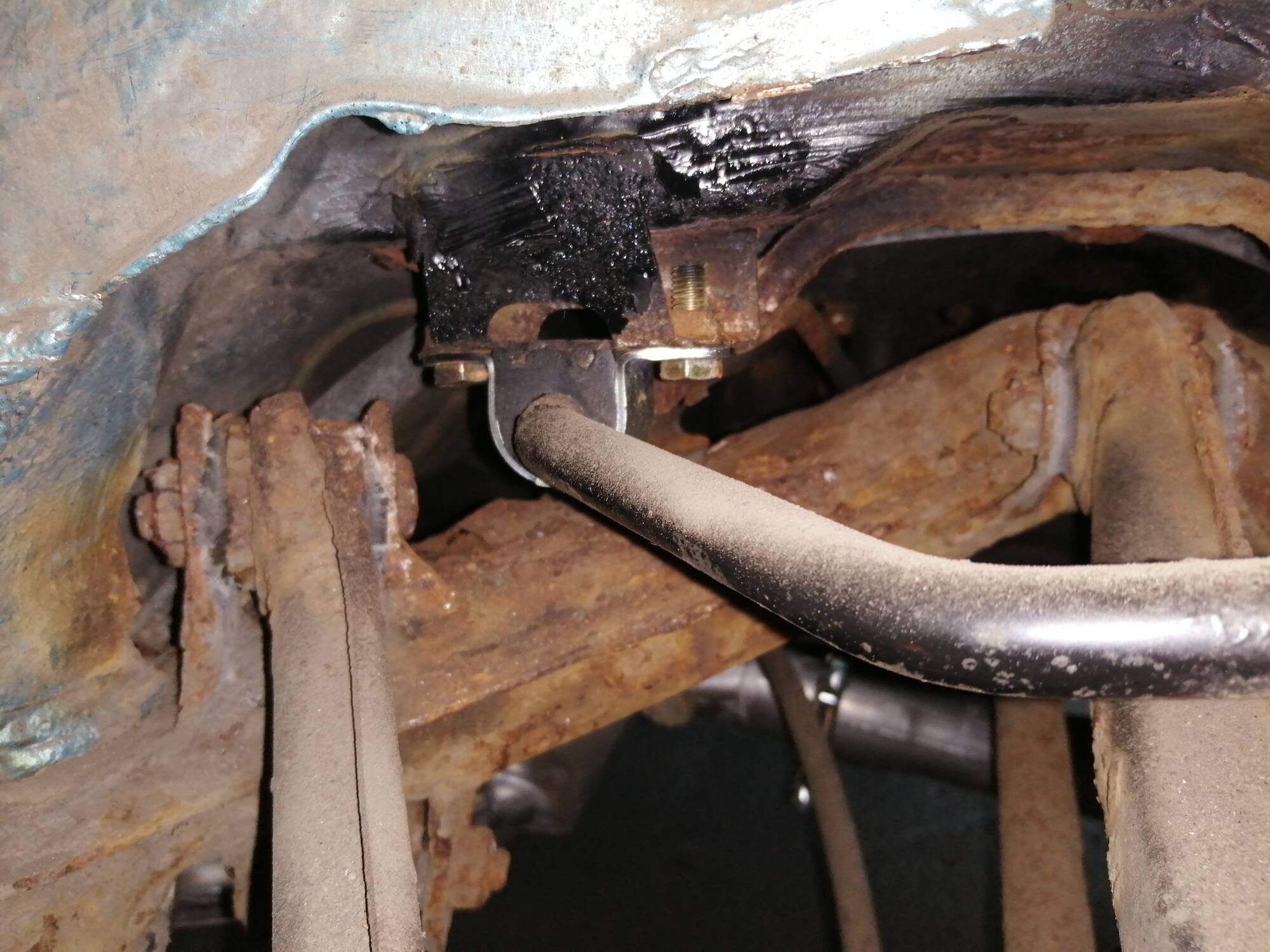

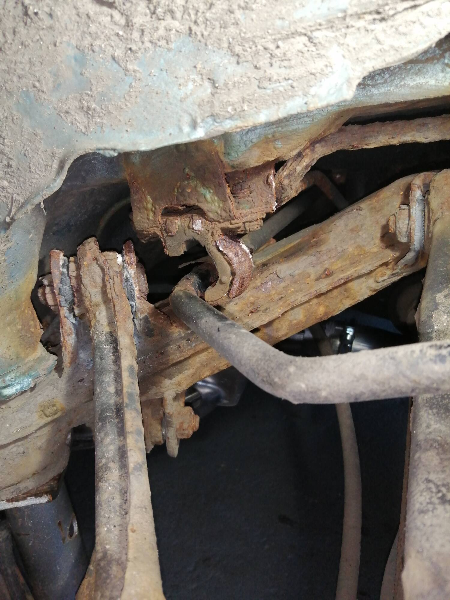

Well, today's fun*was replacing the rear anti roll bar brackets and bushes.
As can be seen, they were in factory*condition.
Much wailing and gnashing of teeth later, we managed to get the rear bolt out.
Helpfully* they were loctited in.
That got the easy one out of the way, then onto the front bolt. Which was even grottier and had much, much, much better* access. Especially coupled with the arb, and trailing arms in the way! My tiny* mitts didn't really help either.
Judicious application of the hammer, screwdriver and various pokey things enabled the crusty remnants of the bracket to be wiggled out before unbolting.
Here, father Touring displays the total material left!
We used a little scissor jack to raise the trailing arm and align the arb. Which worked well. I used some longer bolts with nuts on to help get the bracket lined up. That also worked splendidly.
Once lined up, I measured a couple of these to the correct length, marked with the nuts, then zipped them off with the deathwheel. No pics of the shortened ones.
All that was left to do was replace the long bolts with these shortened ones.
A little skoosh of rattle can black too.
Looks like it just rolled off the production line!
We then flicked onto the other side, and were met with similarly crusty bolts, however, the bracket was solid, as was the bush. The consensus was that the representative from The Ministry can decide whether it's an issue.

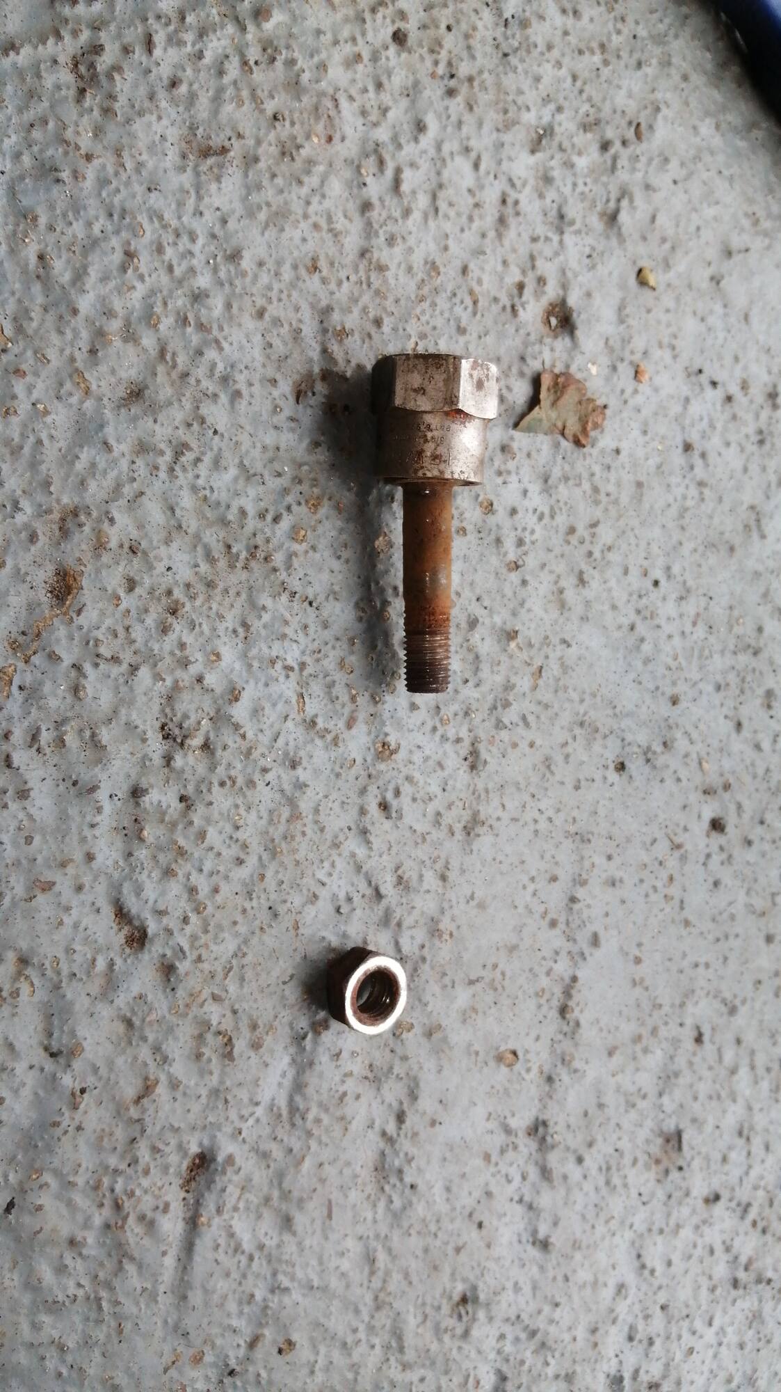

Bouyed by the successful endeavours to this point, we thought that we could start to look at the ball joints... Well, well, well, it turns out that the bolt is as tight as a very tight thing, we had a breaker bar, with my not insignificant weight upon it, to no avail.
So, again after consulting with the assembled company it was decided that we tidy up and head home!

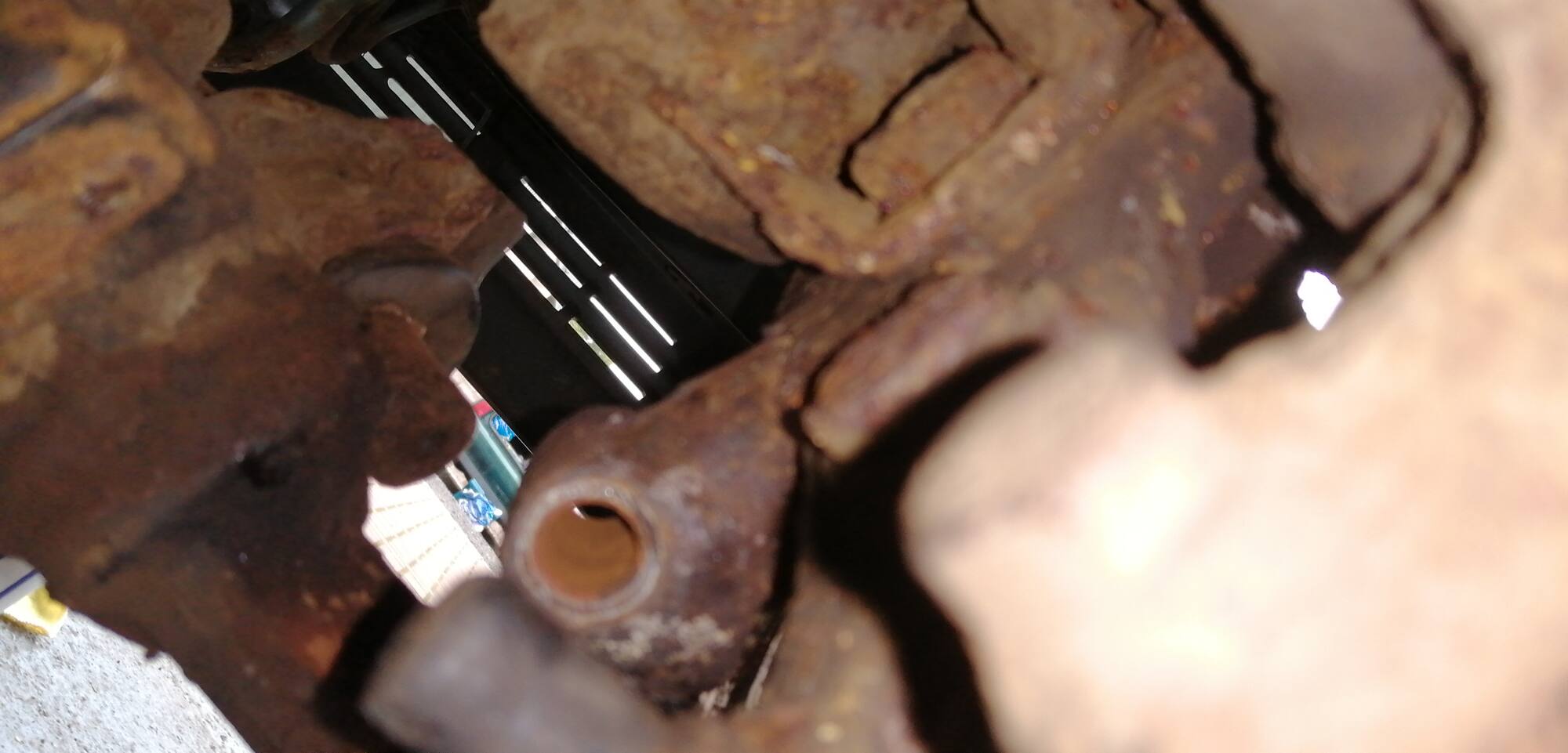

A wee bit more done on this today. The ball joint bolt was tighter than a tight thing, previous attempts to remove were fruitless.
However, after judicious application of, heat, hammer, bar, socket, impact gun, Irwin (repeat ad infinitum) the bastard actually moved. This is only added to, by the peril of working on Merc front suspension, with a spring rare of 1 billionty hundred pounds per square mm! *sphincter clenching*
IMG-20200913-WA0007.thumb.jpeg.fdf4568ecb68f213262ceaae90a27daf.jpegIMG-20200913-WA0010.thumb.jpeg.821d789a64f0c4bfe5ca768ae77c4b98.jpeg
This was met with great joy and rapturous applause..
The remaining hours of the day were spent trying to get the farking ball joint out the lower arm, heat, hammer, heat, hammer etc.... To no avail.
That's next weekend sorted then!
