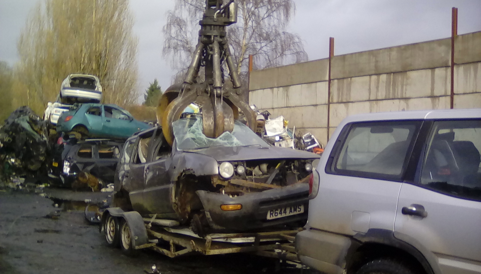

£100 plus postage? I paid £228 for it, plus £150 surcharge that I didn't get back because the old unit was never removed. It comes as a complete manifold and was for a Saab 95, so it might not fit. I really would advise against it though, even if it does work it'll just mean the car lives on long enough to get another four figure bill.
It's possible that the turbo has been crushed along with the hateful piece of shit it was bought for, which would be for the best tbh.
