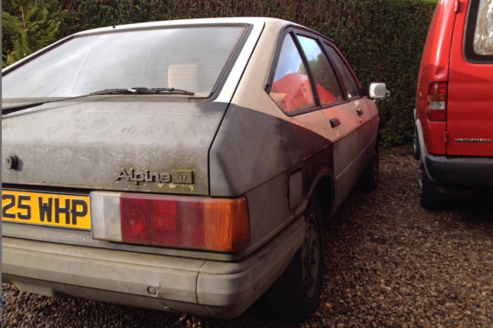

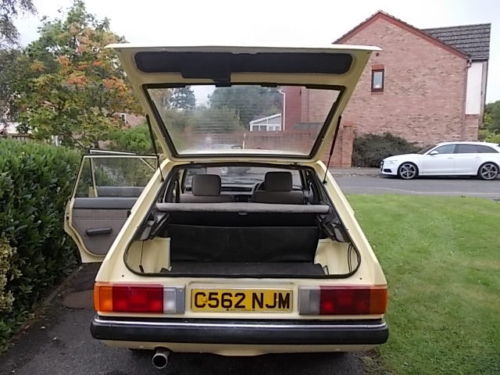

There’s another C plate bouncing around the Internet, which started life the same colour as yours. It was notorious on RR for a while. Yours is a new one to me - first time I’ve seen photos of it.
NJM (Before, during and after)
WHP
And to finish, I’m undecided on whether this one is NJM or WHP...
Edit: Grille looks different to yours, so I’m going to guess NJM. Looks as though both cars would have been pretty much identical when new, regardless.
WHP
 I do have the original grille, don't know why someone took the time to buy an older grille, considering the older one is a much better fit. they have painted it with black louvres though which I'm keeping because it's a part of the car's history & I think it adds character. As for that last minx
I'm guessing it's this one which served as a background vehicle in a few Ashes to Ashes episodes
WHP had the same grille as that when I owned it though - although I'm not sure it's ever had alloys.
